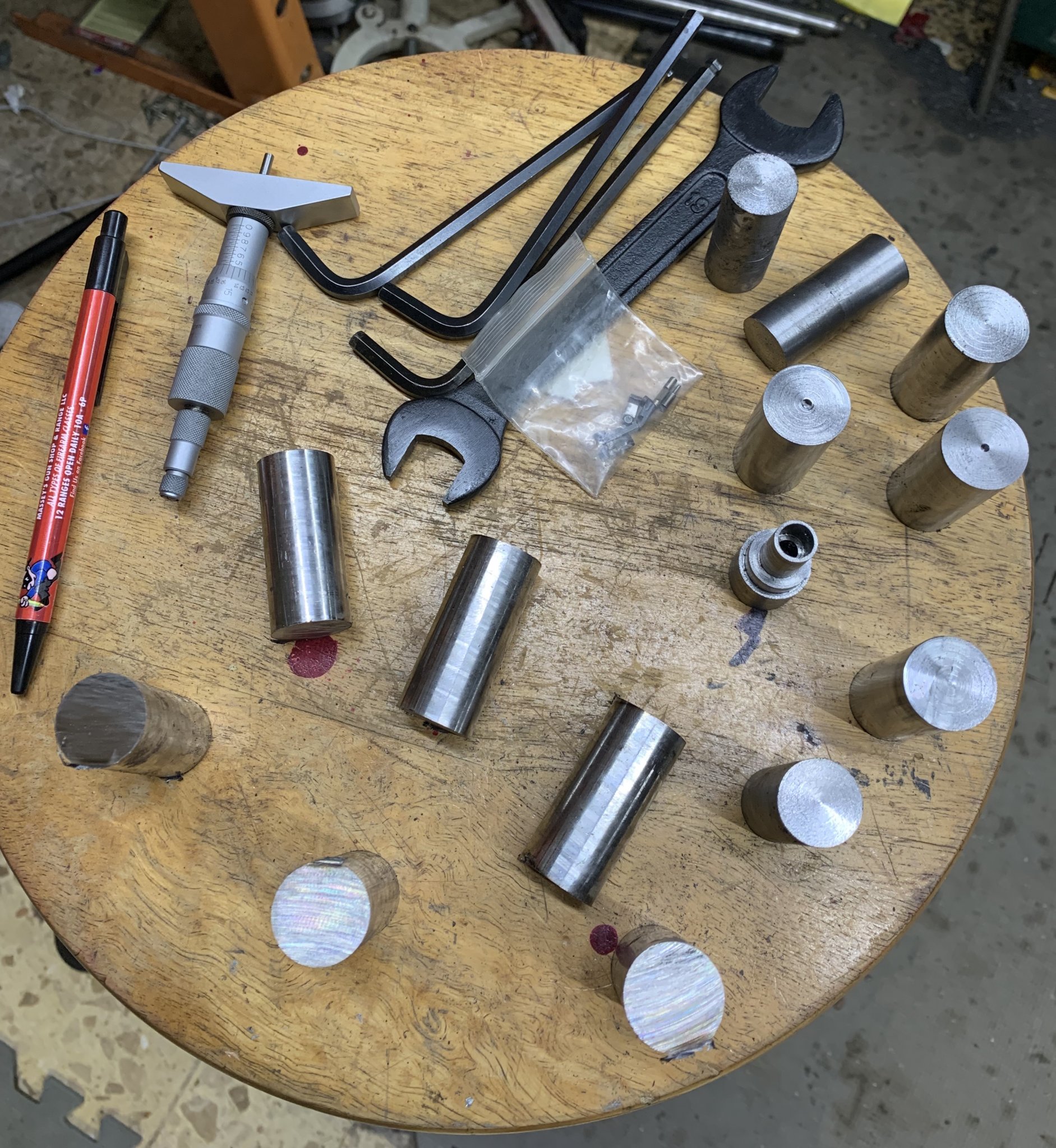

And WSM is the next on the list... as in chucked in the lathe now ?

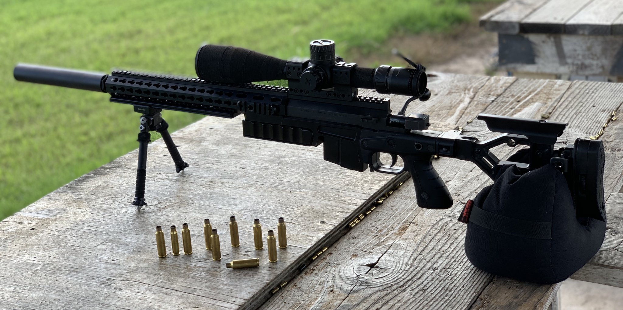

The good, these past few days and tomorrow I’ve been demoing this conversion at a regional SWAT competition. Besides the desire to get a 223 conversion for a few of the departments that are lucky enough to have AI’s, it ran flawless. In the hands of someone other then shooting a rifle has no prior coaching on how to run a bolt, wether fast or slow, the conversion has run flawless. I swapped the conversion over to one of the guys AT with small pin. He shot 5rds of his 308, pulled the barrel & dropped the firing pin assembly, slapped on the 223 barrel, put his firing pin in the 223 bolt body, loaded the mag, 1st round impact, dialed in the correction, ready to rock & roll. The cool part when the lieutenant said, “you can get ALOT more trigger time if you shot 223 instead of 6.5”.

Kits ready to ship? ?

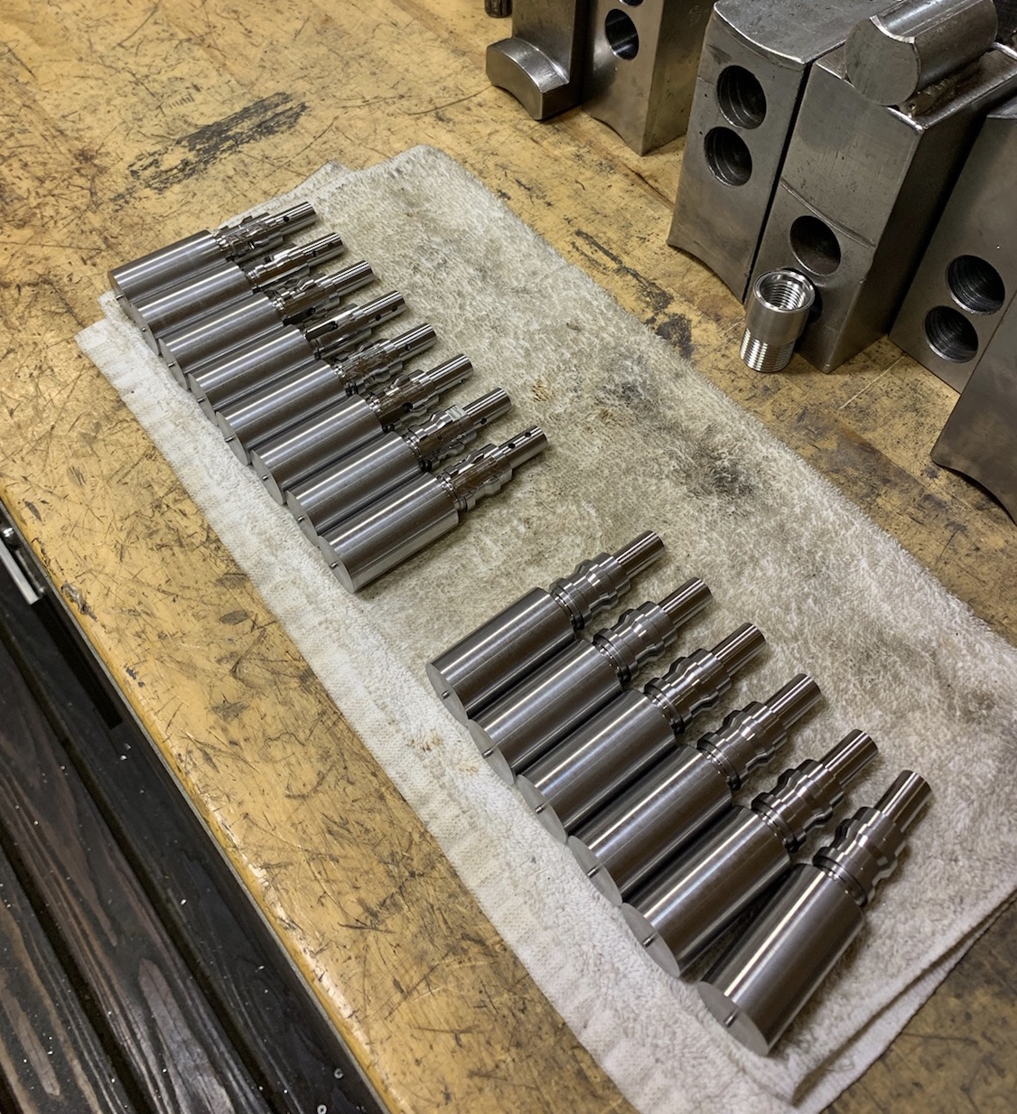

currently working with a CNC to ensure everything is perfect and matches the 3 prototypes we have. The 3 testers were done olde school, mill, lathe and files. In order for the kit to be able to get to people without a long wait time we need to come into the 21st century, but getting prints drawn out for CNC isn't exactly simple, and unfortunately cheap either. So that is whats holding up the kit production timeline.

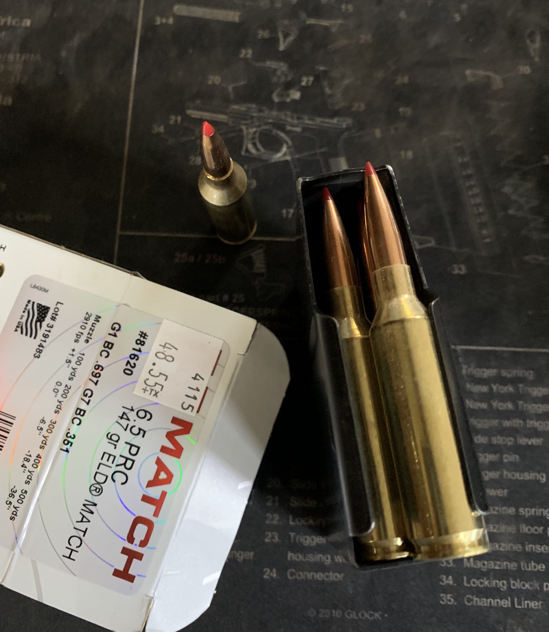

Actually yes, that’s been thought of, just this weekend I picked up a 30cal barrel that’ll be used for testing 300wsm. 6.5prc is longer, might have issues out of a short mag unless you handload. Even then the 6.5prc does nothing a 6.5creed can’t do in a 27” barrel under handloads.

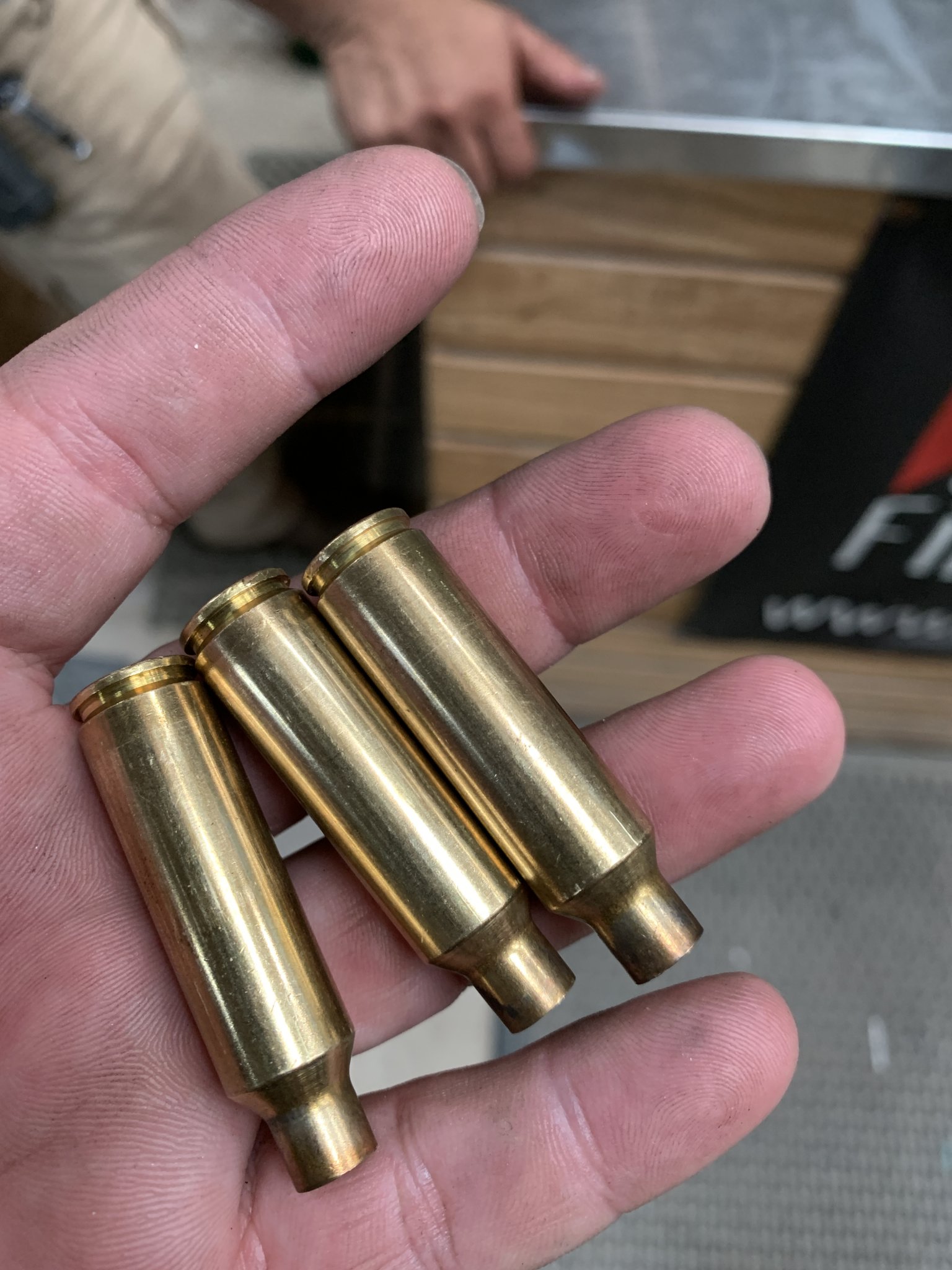

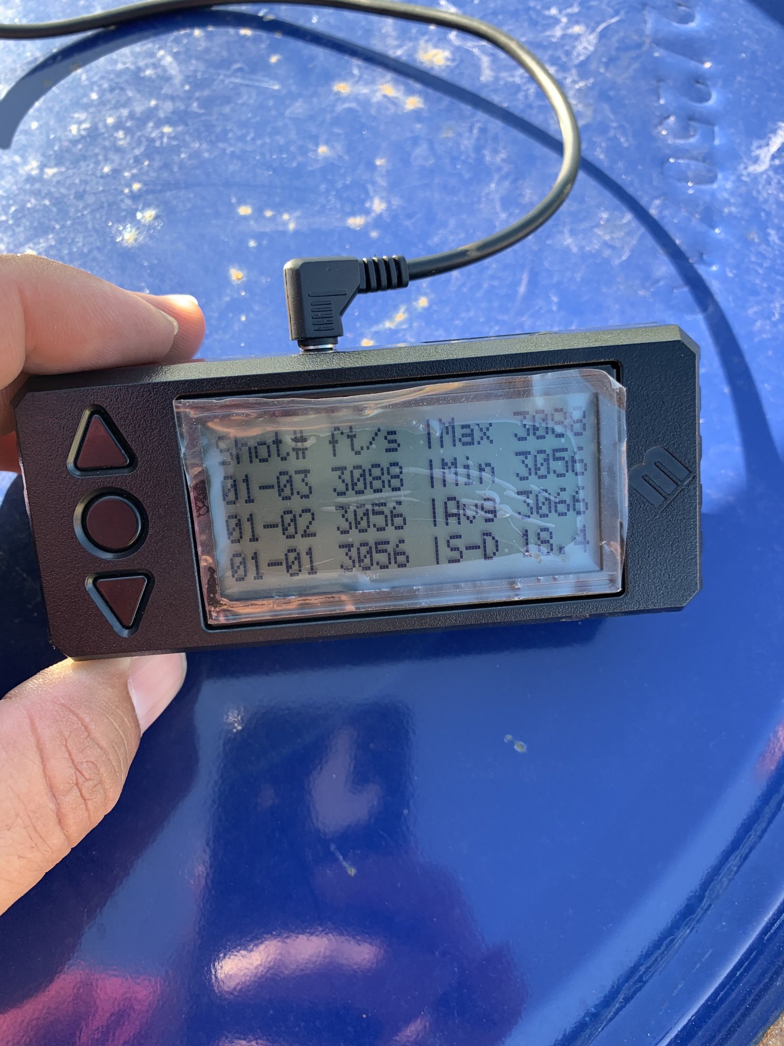

You can get 6.5 creed to 3000+ with 147 safely and not trash brass, tell me how. In all seriousness, I'd definitely be down for a prc/wsm bolt head for an at.
Now i didn’t say it wouldn’t be hard on brass, but with a longer barrel you can be real close to it. PRC factory ammo is stated at 2960fps. Most of the guys I know are pushing 140 at 2750-2820. I guess I didn’t see a huge benefit to push a 7gr heavier bullet 150fps faster. Especially in South Texas ?. Now that 300wsm...that booger is cooking at win mag speeds 180gr at 3000 ? or 150’s at 3300 ?.

What exactly are we looking at ? Bolt head?
If you mean the 223 conversion, it’s a system, several key parts to ensure a 223 feeds & fires.
For the PRC/WSM it was a mod to the bolt head to allow short mag stuff to fit and then having to mod the extractor to not hit the lugs in the receiver and still go over the rim of the case to extract.
