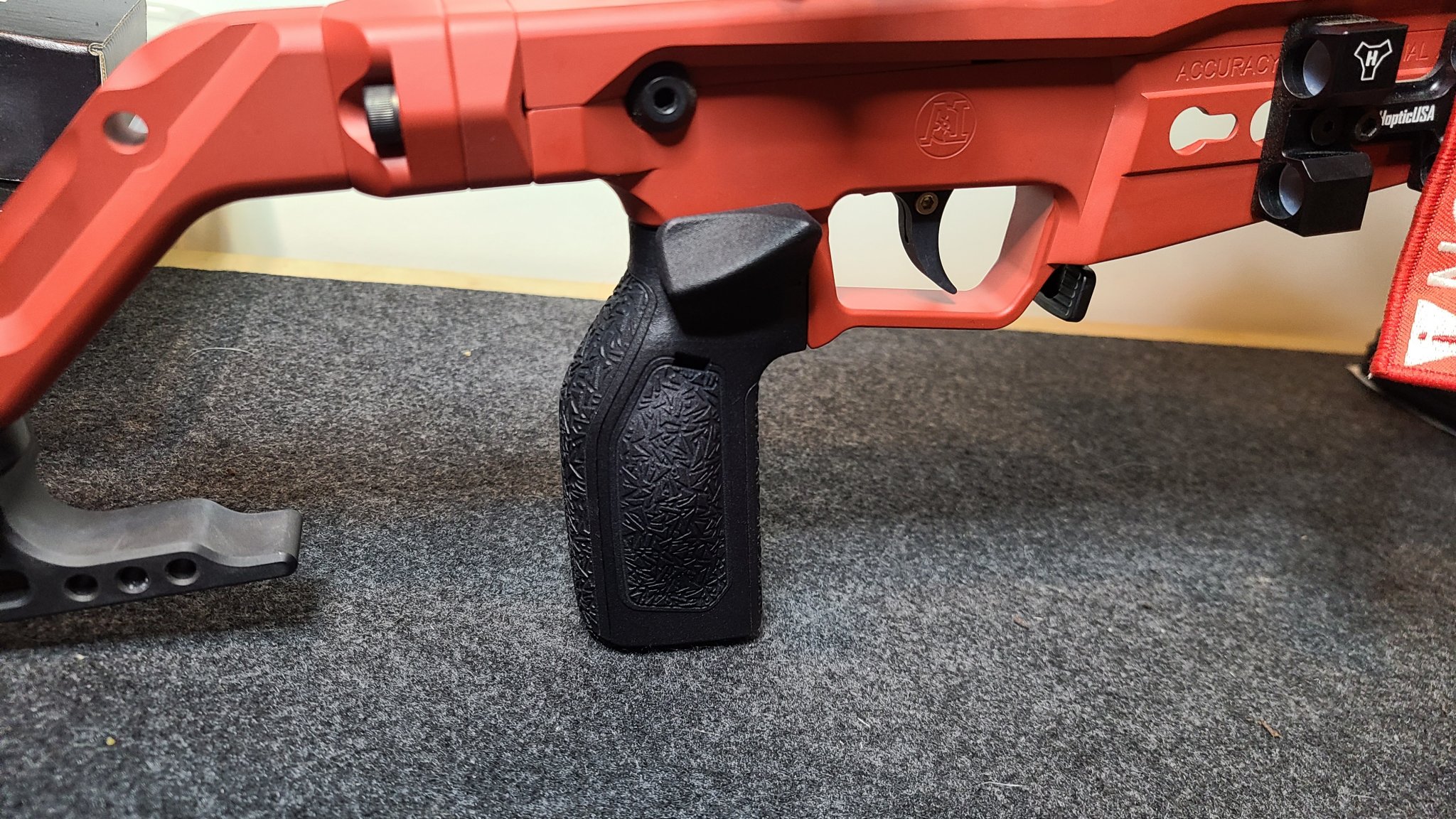

@Scott Seigmund Can you say why AI chose a more angled grip for the AT-X than they did with the AXSR? It seems like most of the PRS style chassis are moving to a more vertical pistol grip. It seems with the AT-X that AI is going a different direction. Not complaining.... Just curious.
Reactions: deersniper
Pretty sure at the time of the AXSR development, ergo hadn’t released their vertical grip. So to use a regular ergo and be more vertical, the interface was arranged in such a way to cant the angled grip forward.
Dthomas3523 in post 1092 did a commendable job of answering this question, but I will add some further commentary.
The AXSR/ASR grip interface is basically a standard AR15 interface rotated 10 degrees placing standard AR15 grips in a much more vertical orientation. By the time we were designing the AT-X (which was always focused towards the competition shooting community) vertical grips were being introduced to fit the standard AR15 interface and we felt it was better to stay with the standard non-rotated interface to allow use of many of these newer grip designs.
-Scott

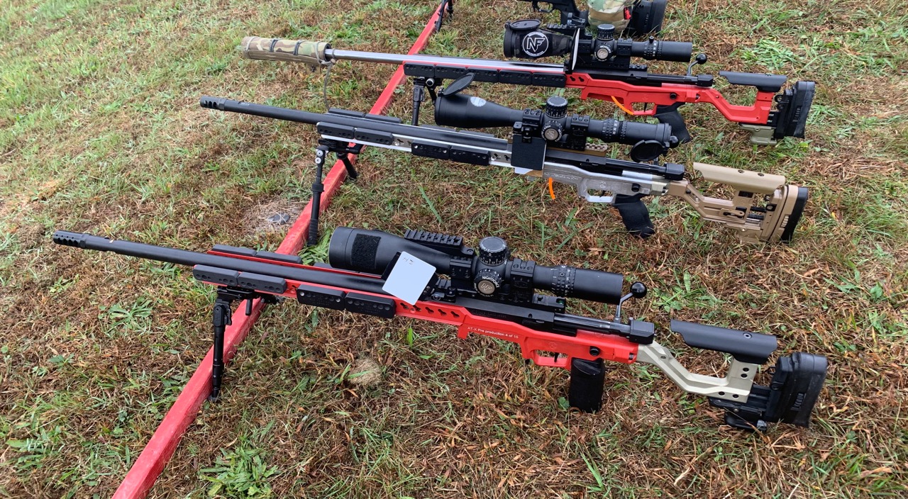

AT-X and barrel contour question? I have an AT-X on order and would like to have an additional barrel chambered for the AT-X. I have two Bartlein blanks, one is a M24 and the other a Heavy Varmint contour. Will both of these contours work in the AT-X?? Any suggestion for one contour over the other?? This will be my first time having a barrel blank chambered as a pre-fit. Who would you recommend for the work to do an AT-X pre-fit?? Long time shooter but new to this level of equipment and appreciate any help.
The AT-X forend will accommodate a barrel of 1.250" diameter with the forend bridge installed so either of those profiles will fit without issue. With the AT-X you may find that you don't need a truck axle barrel profile. We have had amazing performance shooting some very light barrels in 6.5mm to make weight for NRL Hunter matches. You can balance the rifle with weights much more effectively vs putting all the mass in the barrel.
The two nearest rifles in the attached image have two pair of weights just forward of the magazine aperture. These weights at 1 pound per pair also provide an increased footprint when the gun is supported on a bag. The forward weights are for balance tuning. The weights are .5 inches wide and provide a good purchase for "pinching" the rifle and bag together even without a forend bridge.
Any number of reputable shops can thread and chamber you barrel blanks for an AI.

Can you add weights to the rear of the chassis like on an MPA for example ?
The way the gun handles you really don’t need to. The ATX is unlike most other rifles I’ve ever shot in the balancing department. A lot of it has to do with how deep they were able to get the bore center line in the chassis. While it is a bit of a circus trick, there are plenty of videos of Rhett laying the rifle on a barricade and not touching it other than the trigger and getting consistent impacts at distance
-Scott
