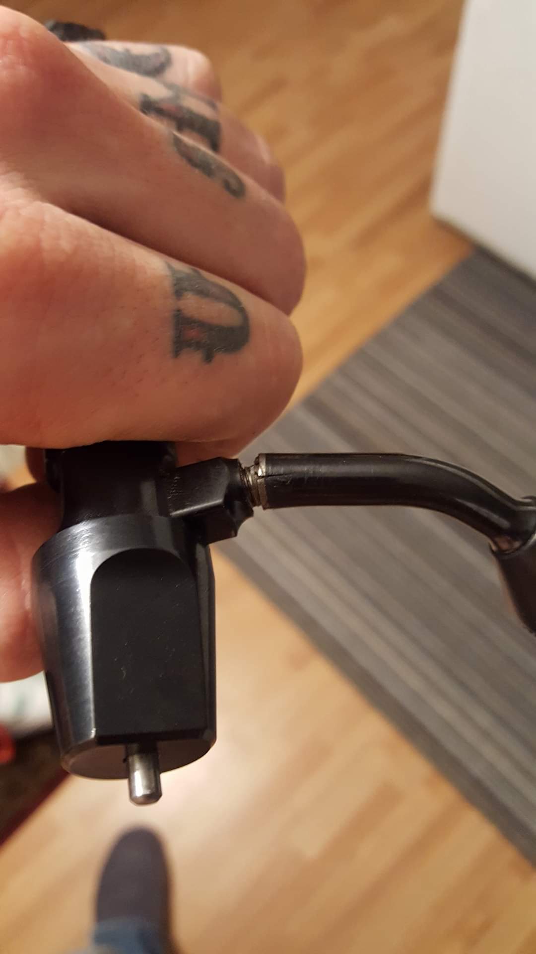

Everything else looks out of place on an AI![]()

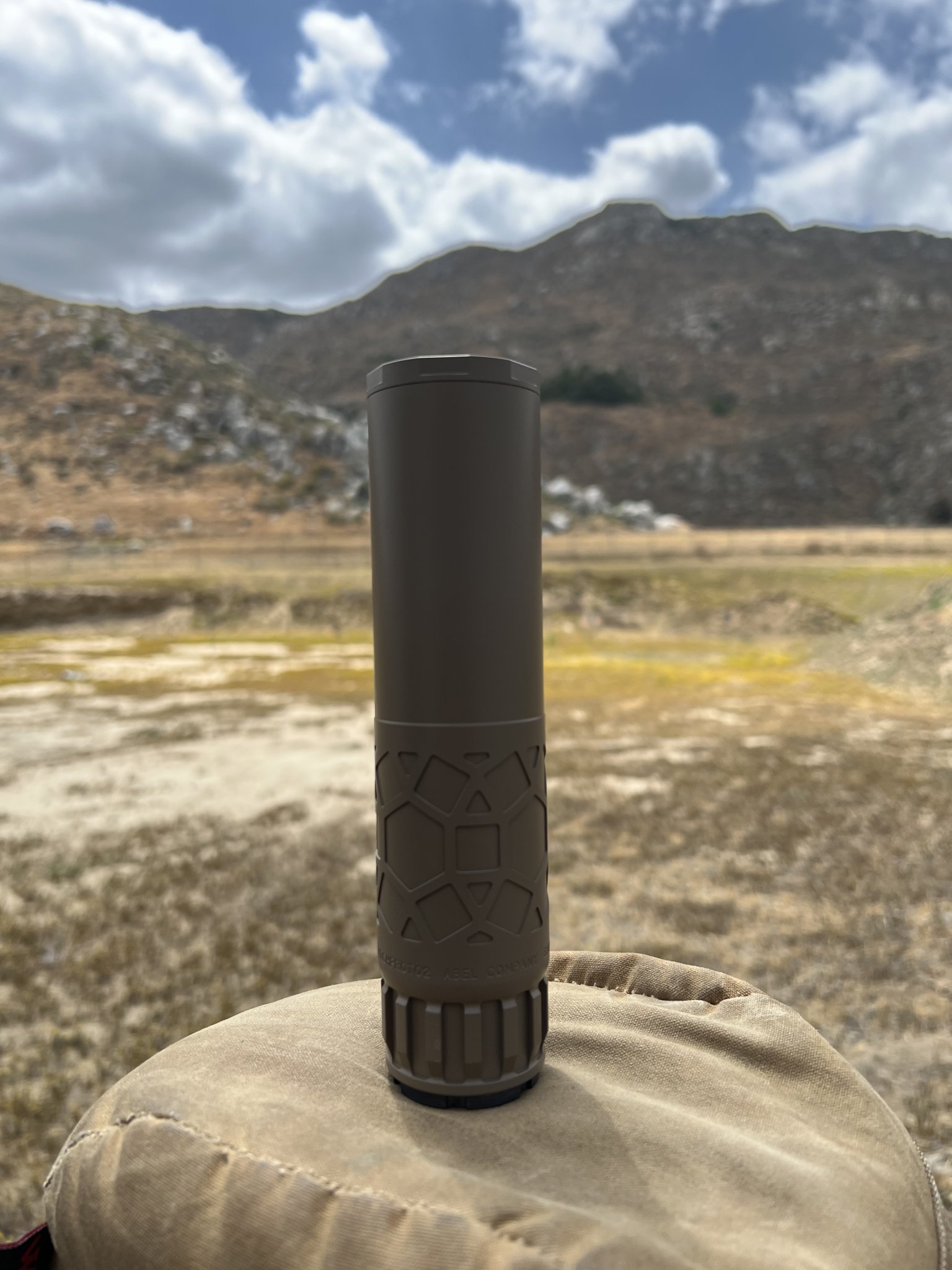

New Abel titanium can - In final testing now should be on the market in a month or so.What suppressor is that?

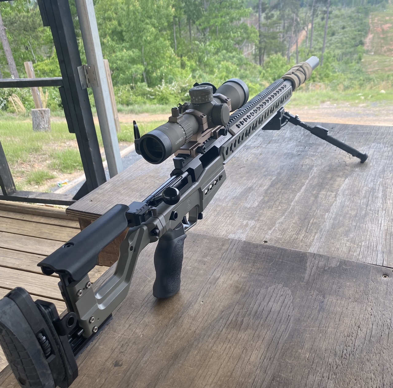

Now I know how Scott Siegmund feels.Just being pedantic @Defender3 But you have your Spuhr rings on wrong.
The ring with the lower number with the lines is the back one, helps you visualize that your optic is in line with your mount.
The ring with the threaded mounts is the front one, for accessories.
At least you have the bubble level on the right side! LOL

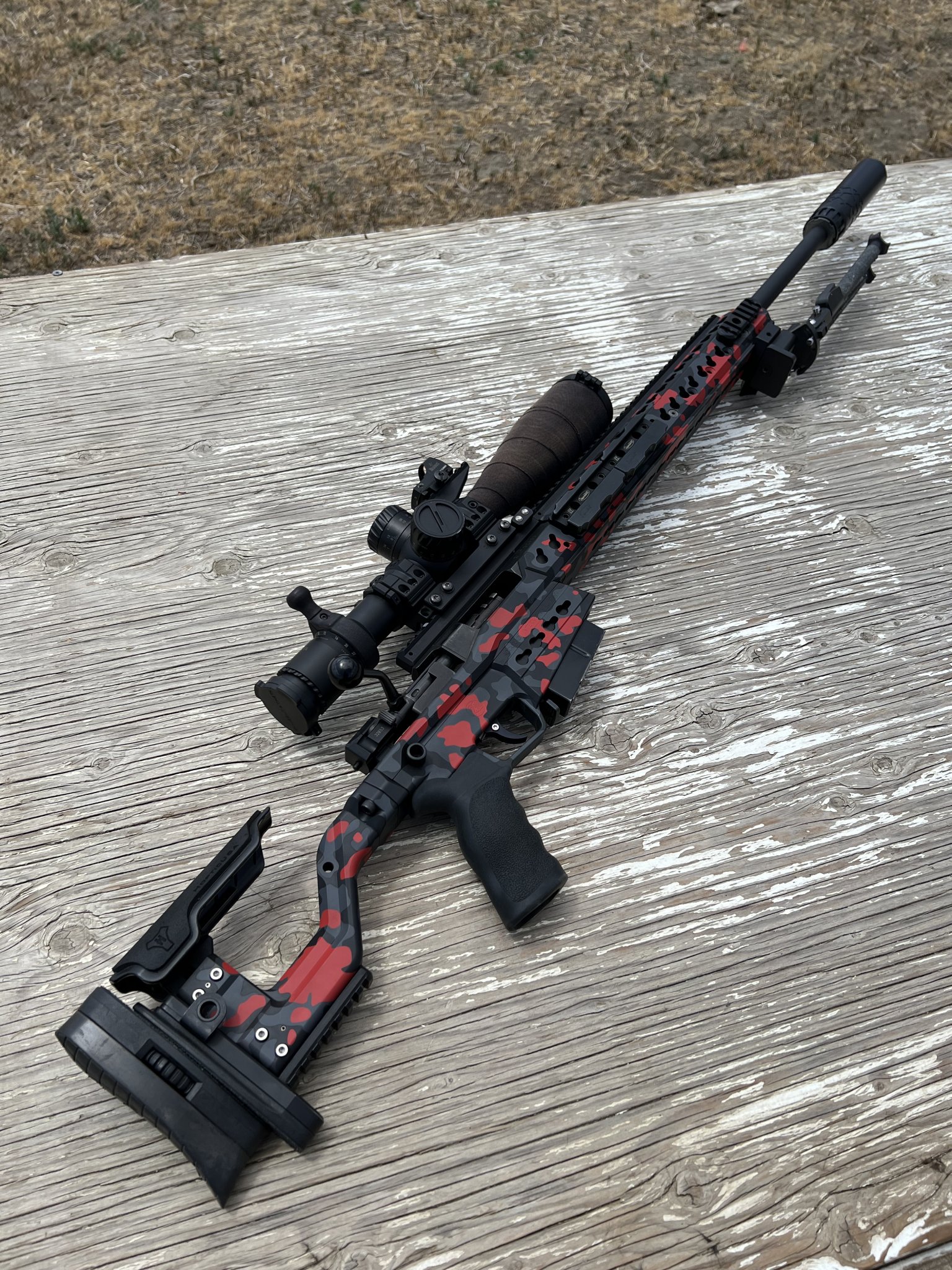

Kryptek is gross, dont do this.Thanks. You should get it tungsten.....or maybe tungsten base with Kryptek pattern on top.

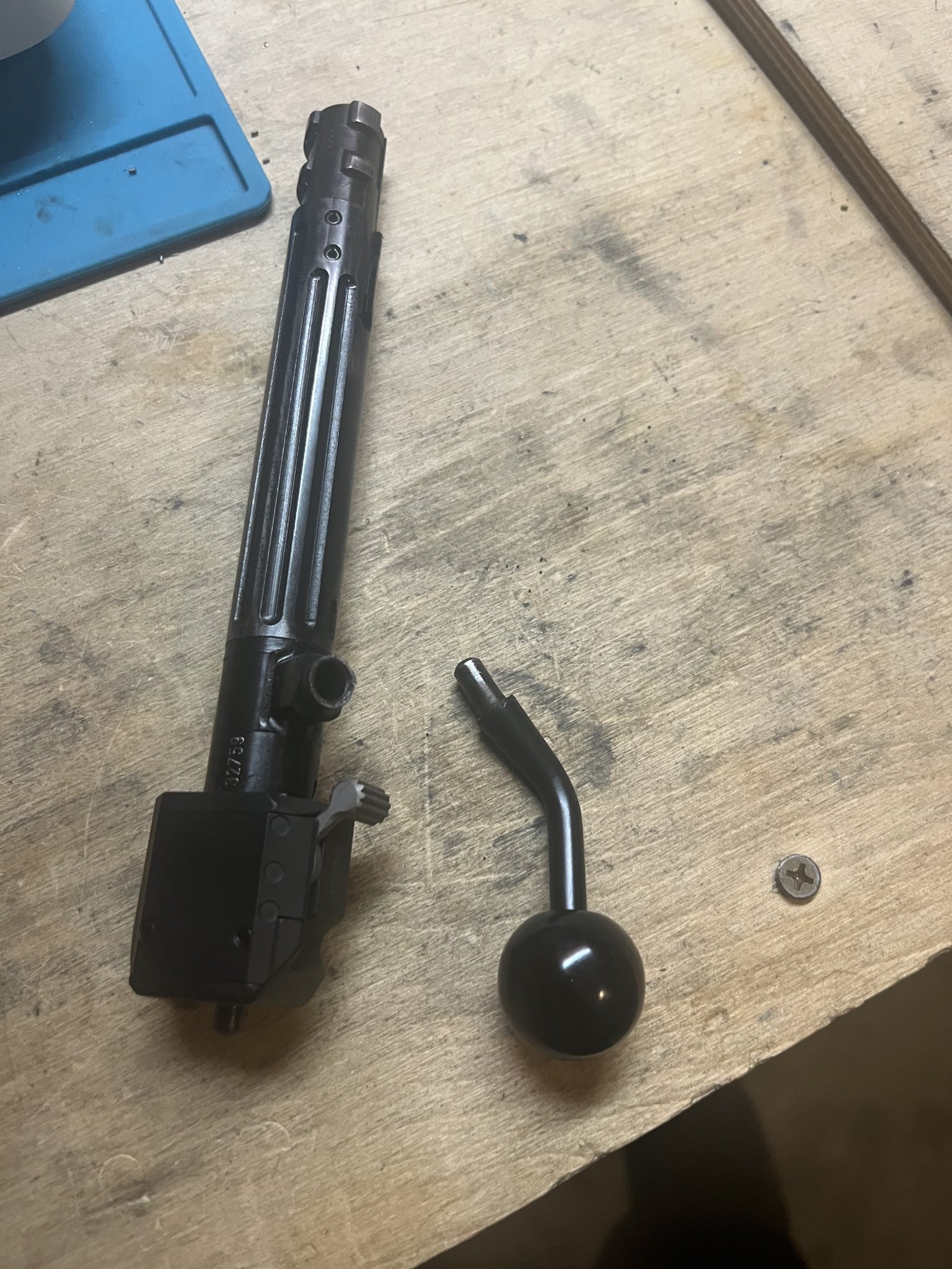

Neither have I. And I was only dry firing just now. Guess my kung fu grip is strong!I have never seen that before, ever in an AI
I’m in MI. I think I have a guy but need to ask. AI is usually very good at getting stuff back out so fingers crossed.@Darkside-Six Where are you located? Do you have someone you can borrow a bolt from?
If not, hit me up - I'll loan you mine...just don't tear any lugs off or anything. LOL
I imagine that’s what they’re gonna have to do cause this is pretty broke.I would ask for a bolt body replacement they can ship that same day
And love the avatar, homey.I knew the bolt lift was heavy, comparatively, but damn!!

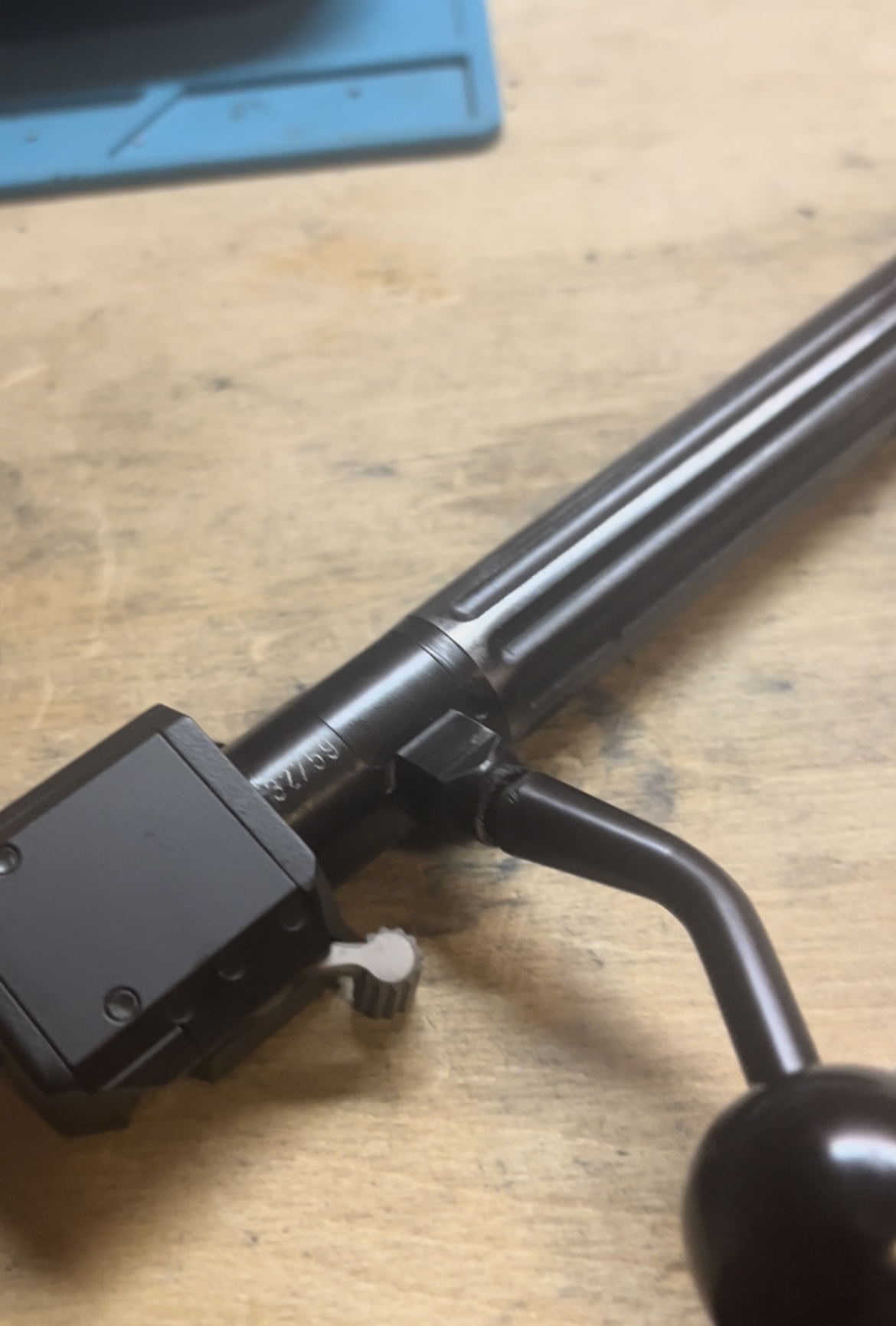

I can see now how it fits together. My guess is the weld was weak but who knows. Hopefully nobody else has the issues.Lawd have mercy, that aint good.
Been there... but with a Gap Tempest
I swear I was only dry firing. Lol. This gun is like my baby. I take care of my shit. Just glad it didn’t happen at the match this last weekend.I feel like I remember someone posting on the hide last year or maybe 2 years ago with the same thing. Might have dropped the gun and landed on bolt handle or something. That's probably the only other time I've heard of that happening.
Nah, I remember it being used in the argument that Ais aren't as "bomb proof" as advertised by their owners in arguments. It was def an AI@clcustom1911 a Tikka
Maybe that was it and I misremembered it. Dude. You're like a walking SH thesaurus.A bolt shroud fell apart....
Is that how its attached....welded to the body? Maybe (most likely) its my old eyes, but its hard to see a bead from welding at all???I can see now how it fits together. My guess is the weld was weak but who knows. Hopefully nobody else has the issues.![]()
I remember that rifleI've seen em bent, almost bought a very marked down LE demo AXMC with a slightly bent bolt handle. Guess it's time to make the first and only straight bolt handle AI known to man.![]()
Couple more pics so people can see kinda how they fit together. I’m not a machinist so not really sure. I’m confident they’ll take care of me in the morning. Just kind of wild that it happened.Is that how its attached....welded to the body? Maybe (most likely) its my old eyes, but its hard to see a bead from welding at all???
