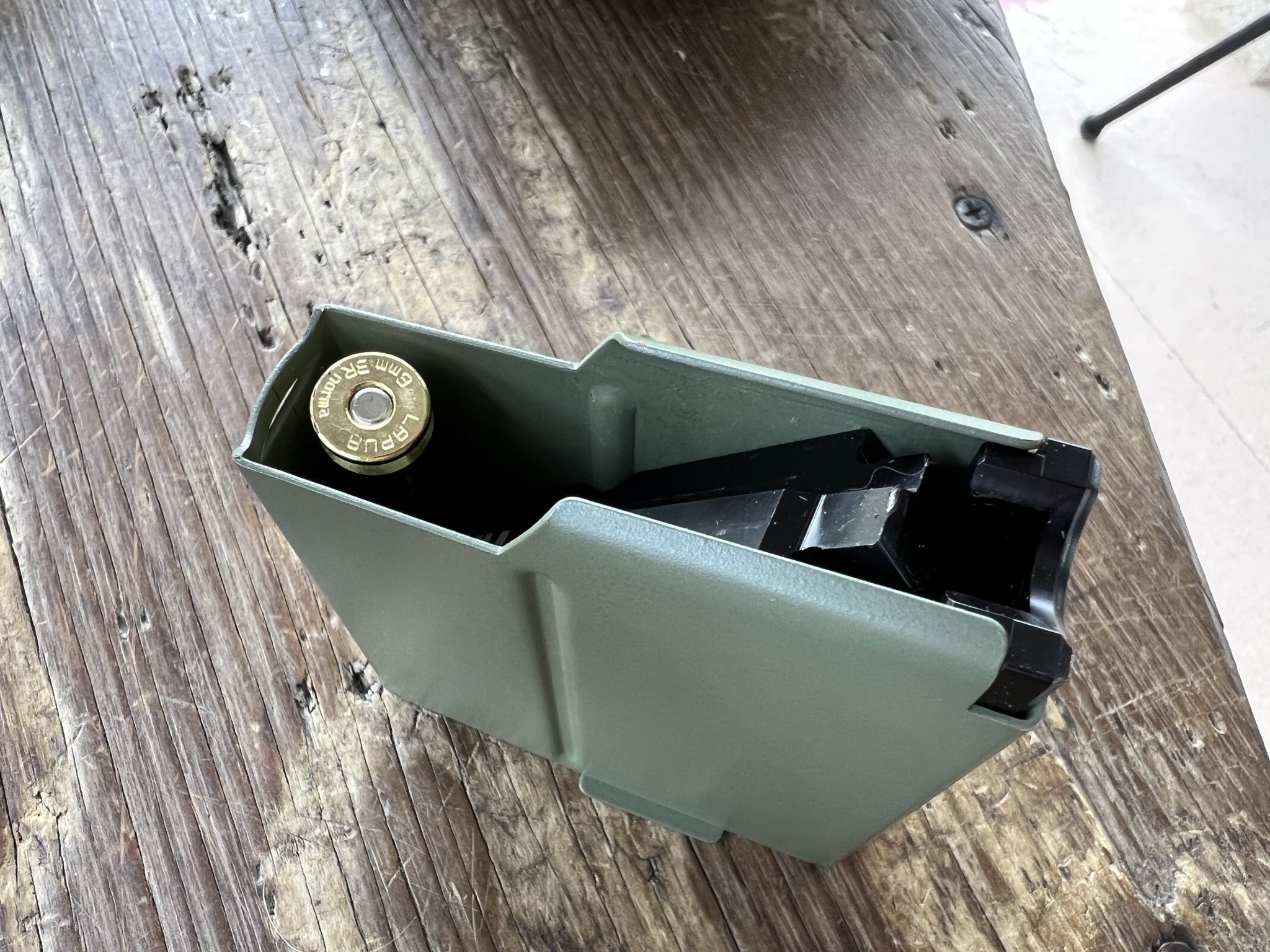

More fun with the AT-X. This happened multiple times with factory Lapua 6 BR 105 Scenar ammo and the HRD kits. AX mags.
I’ve tried emailing @Scott Seigmund and calling AI about that other AX mag that didn’t work after they fixed it, no replies.
To be fair, this looks like more of a mag/ammo issue than an AT-X issue. Modification of a factory mag, albeit reversible, for use with a short BR round.
Have you tried to run this in an AX?
I had the same issue with both my AW mags running HRD kits for 6BRA in my AT. The second to last round would nosedive under recoil. I tried stretching the spring, but ultimately ended up making an anti tilt by cutting the follower and adding a sheet metal tail (mimicking a magpul m4 mag follower).
This is the reason I got rid of my BR and Dasher Barrels…
Would nose dive after 7th round, in 2 AX’s.

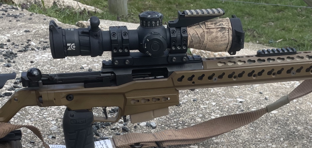

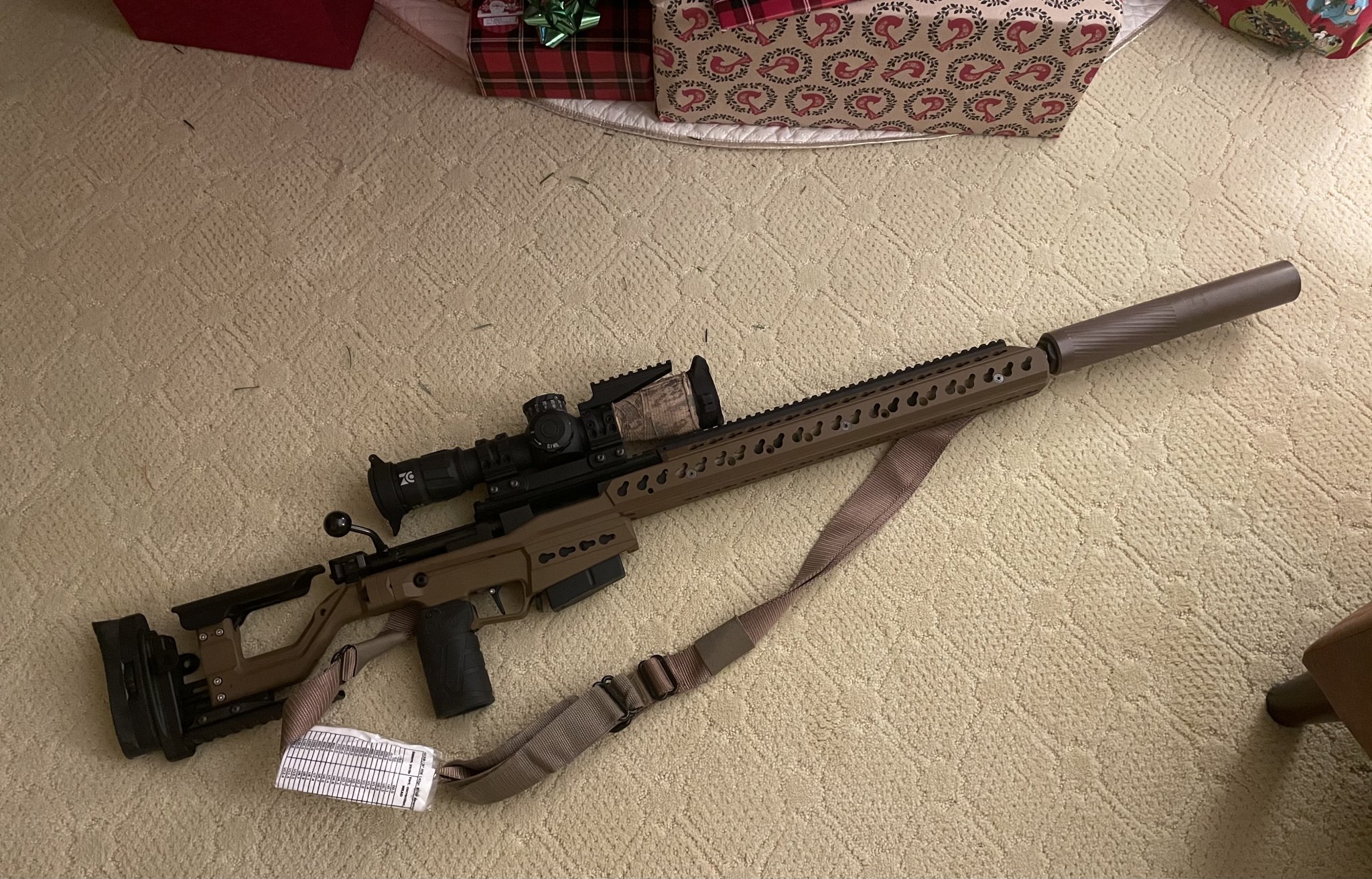

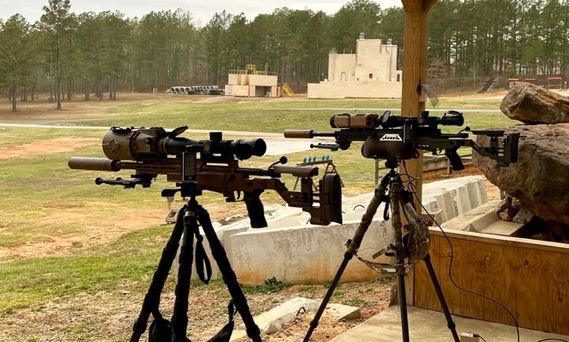

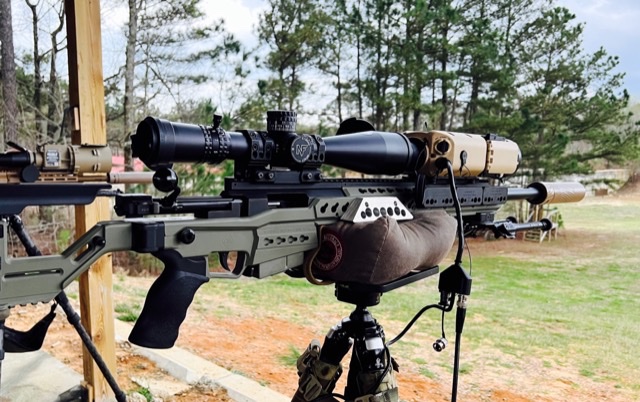

Scott, I'm gonna plagiarize a couple of your pictures from Range 37 just to illustrate the point.
The below is a lot harder to do with an AT rifle than AT-X. Note how even with the extended forend length, there is no remaining rail space left up front with the ADUNS and HISS.

I wholeheartedly disagree. Modern tactical applications require the use of long NV clip ons, which require a long forend when used in conjunction with a modern full-size scope.
You could maybe make the argument that AT rifles are more practical for casual, daytime shooting, but that's just not the case for actual tactical applications. Every rifle I've been issued and used professionally (Remington M2010, MSR, and a couple of other specialty bolt guns) use chassis that look a lot more like the AT-X than legacy AT rifles. The design is driven by contract requirements, not style.
For every example you can give, I can show you a .gov/.mil or agency running an AT or shorter forend.
I also qualified several times that speciality rifles were excluded. Most agencies and other such entities aren’t running a HISS.

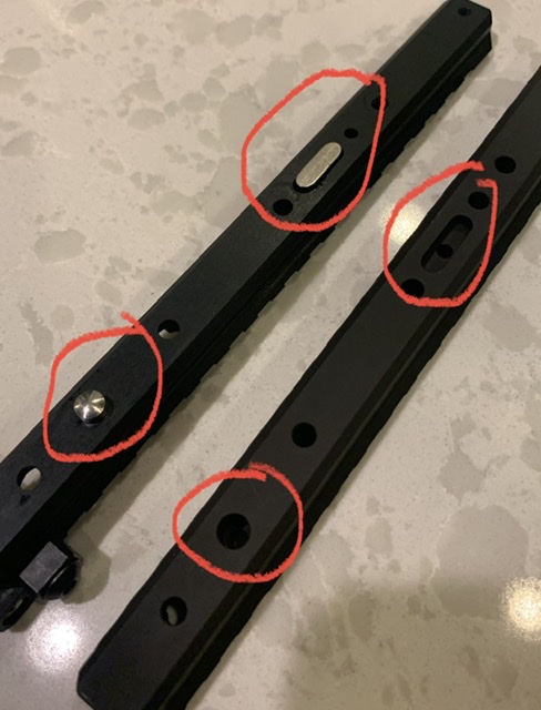

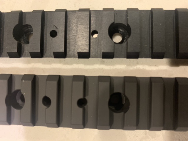

Is it not pinned like the stock rail?
It is, but the pins are easy to swap.
My AT-X high rail didn't come with the pins so I swapped them out from the low rail. All you need is a punch small enough to fit through the top holes, easy peasy.
