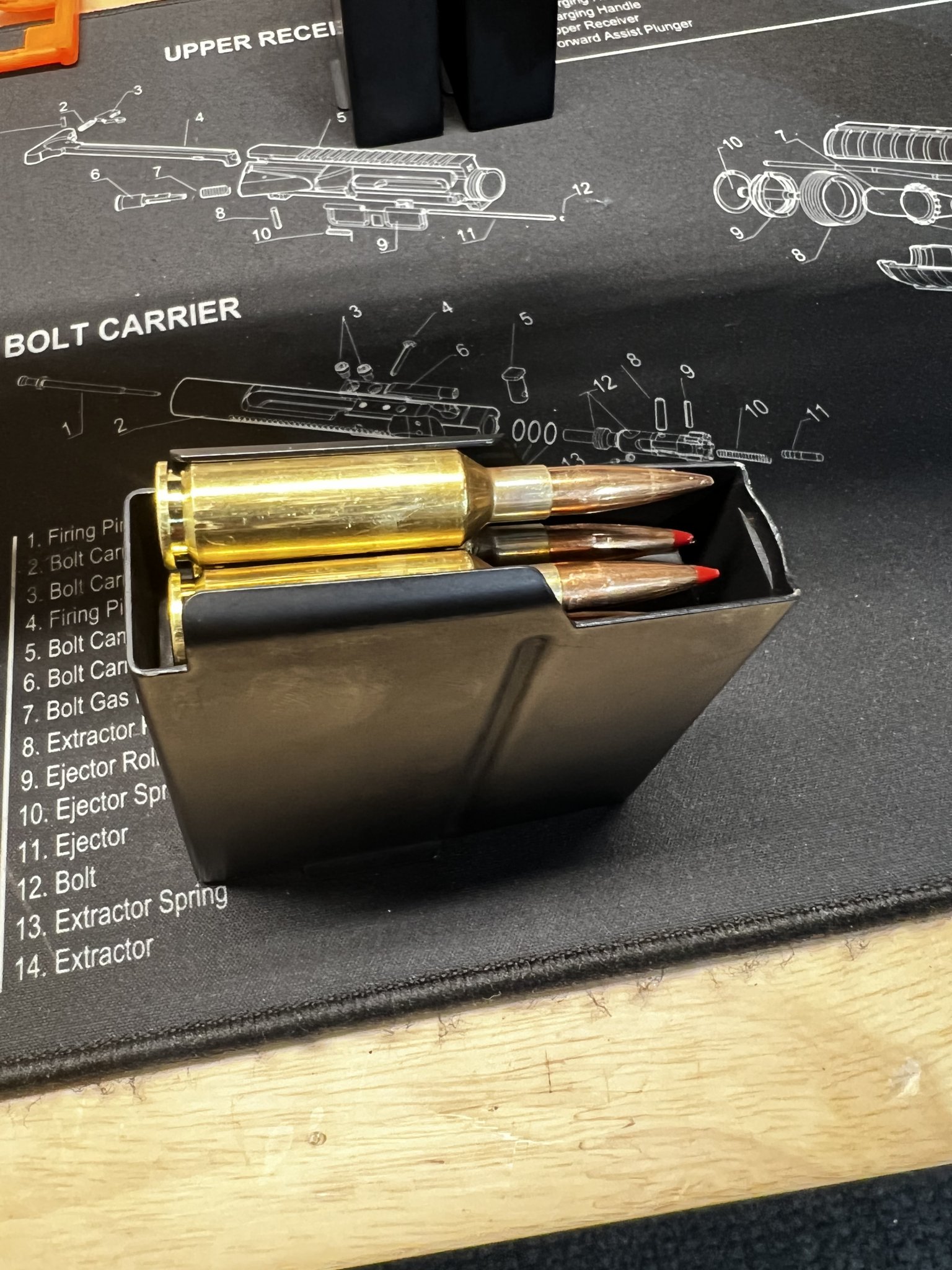

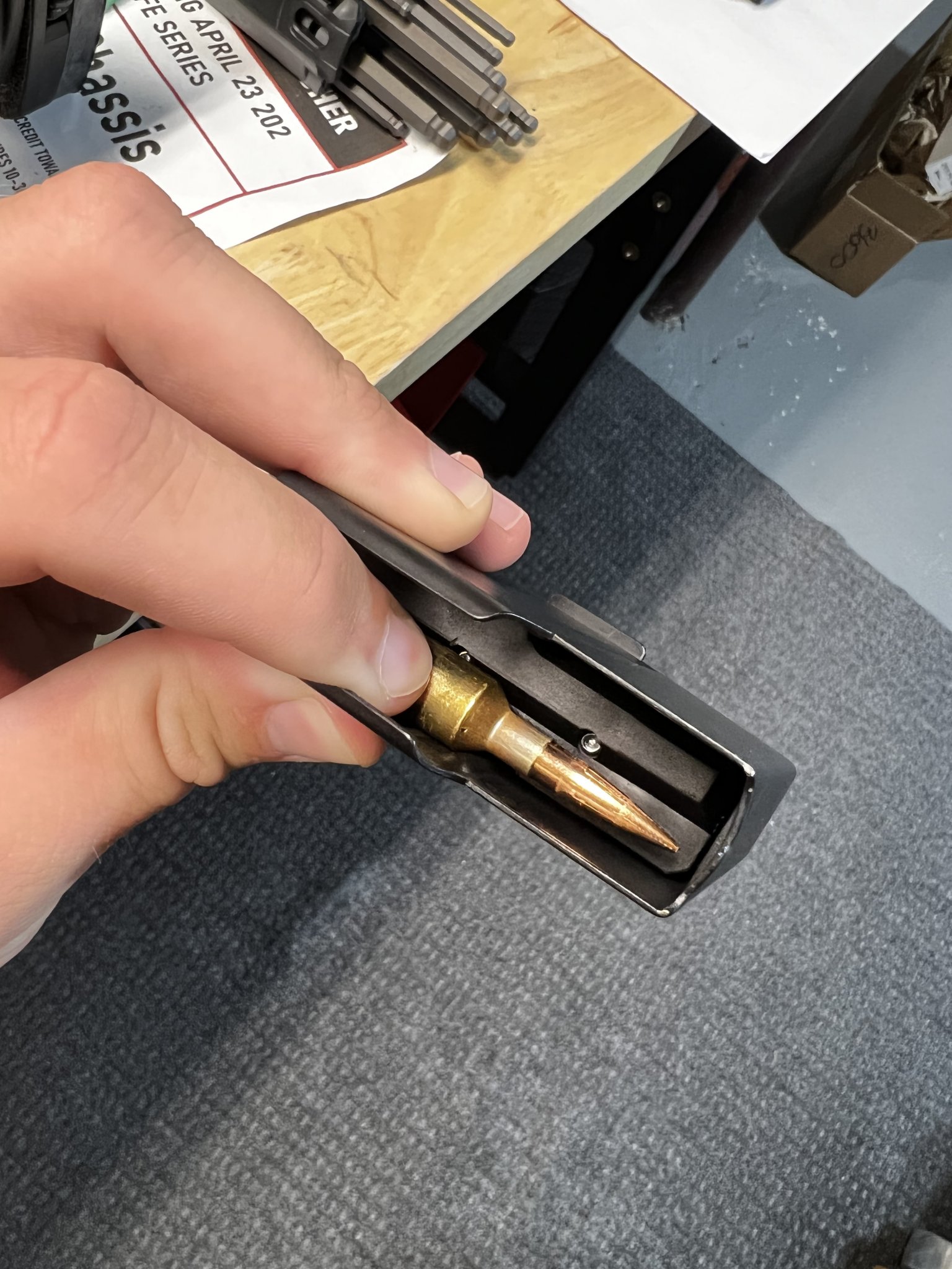

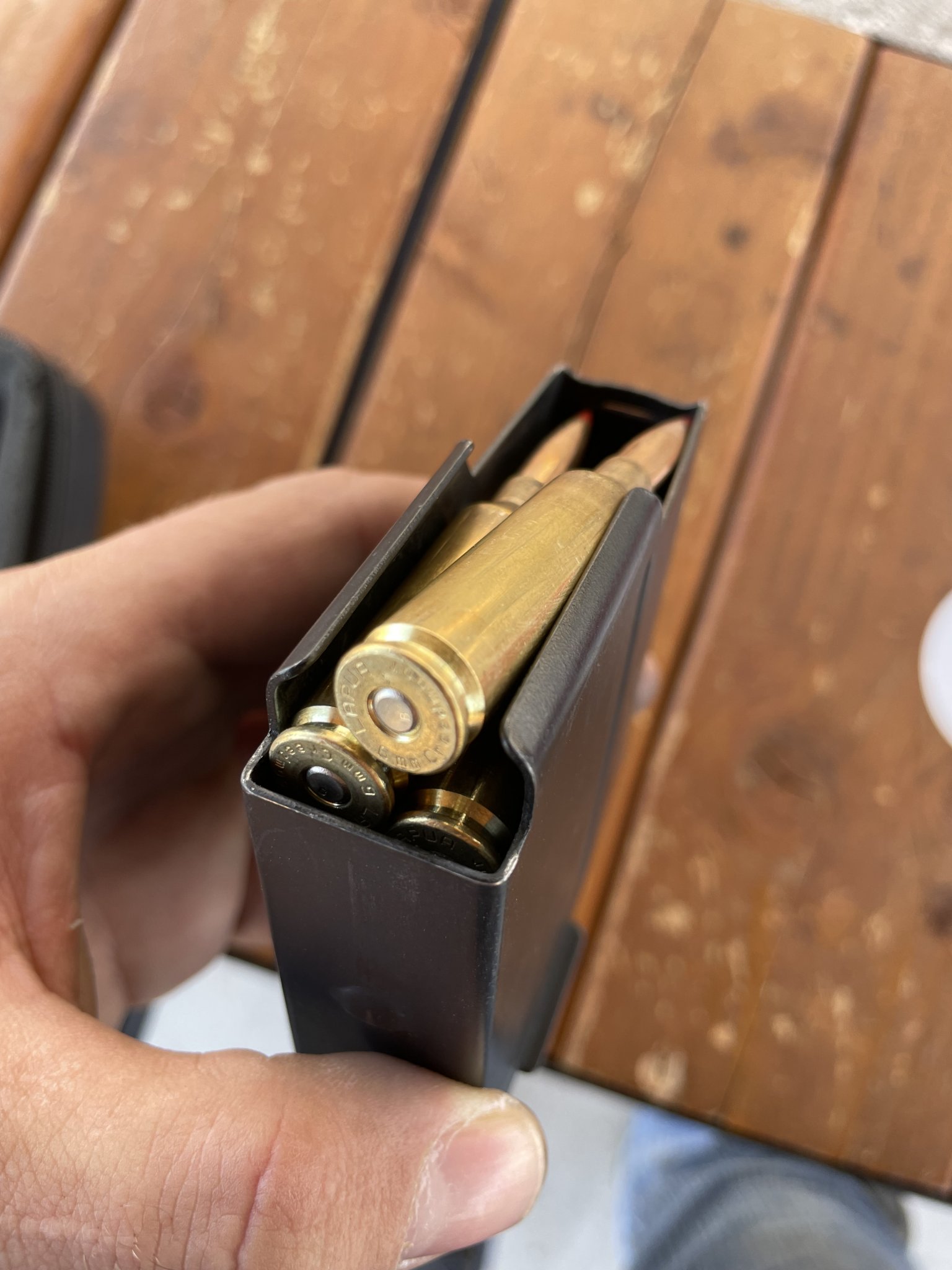

Has anyone else had trouble feeding GT rounds without HRD kits? It will pick up some rounds (seems like the odd numbers - 1, 3, etc.) but skips over others. Does the same thing with 3 different brand new AX mags.
I feel like the mags sit a little low when secured in the chassis, but the cases have good engagement with the feed lips. If I move the cases forward, as if there was a spacer, it feeds fine.
Just looking to see whether guys have had better luck with or without the kits (or maybe if there is another issue at play). I thought it might have been the bad mag issue, but given that the feed lips seem like they’re OK, I’m not sure that it is.
Few pages back this was talked about some. I’m running 6gt with no mag kits and it works most of the time but get a few bolt ride overs myself. I shimmed the mag catch up and that help a bunch but still miss a round here and there. AI says there is no need to shim the mag catch though. If your having issues send them your mags and they will fix them.
Messed around with it a little bit more today and found that I can get it to feed reliably by moving the rounds forward in the mag so the case shoulder touches the rib. Also talked to Krob about it and he said the same thing has been working for him.I get bolt overrides running 6GT in my AT. I thought my mags just had weak springs. Seems like it's common.

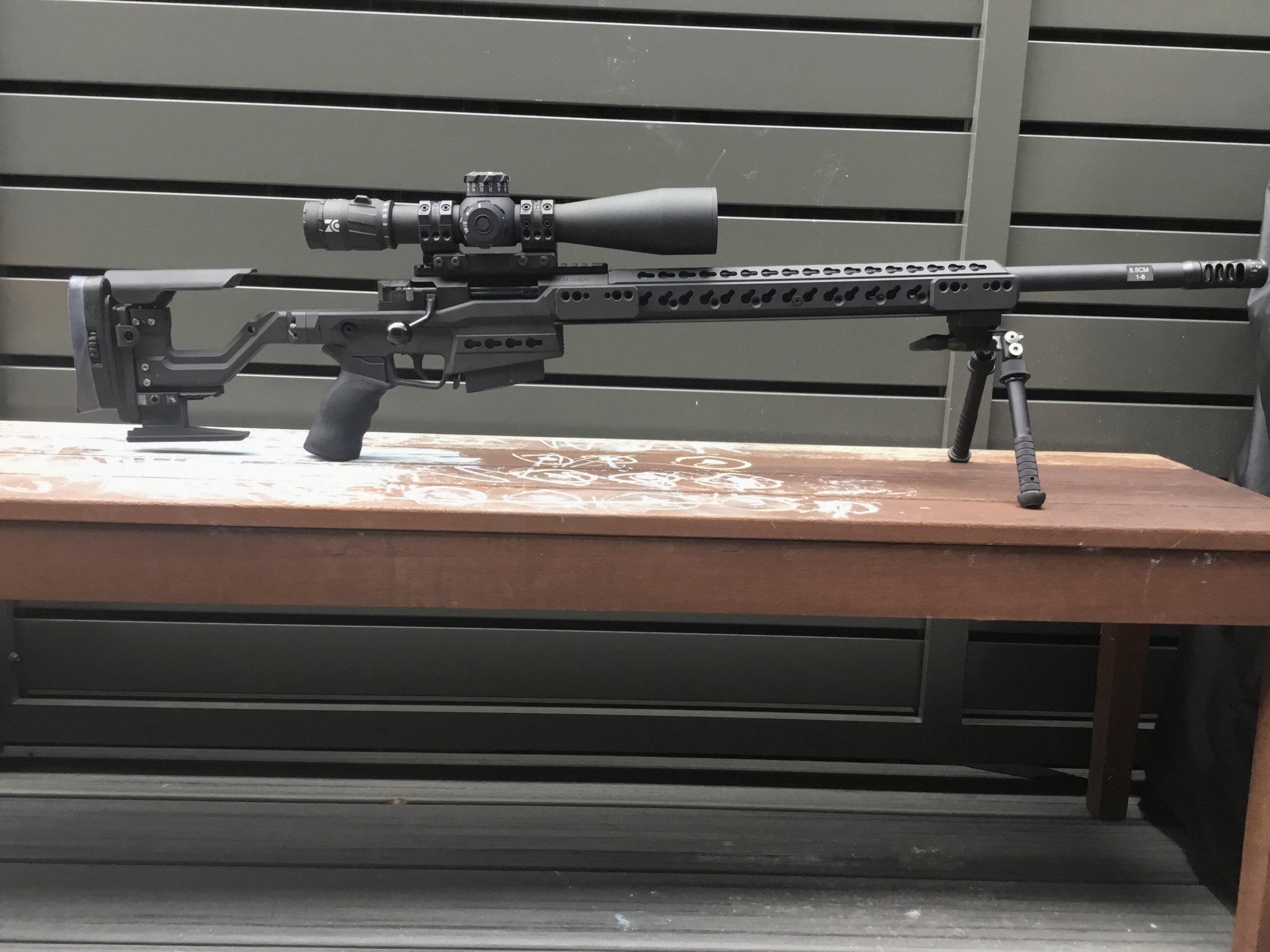

The longggggggggg wait finally over, picked mine up today

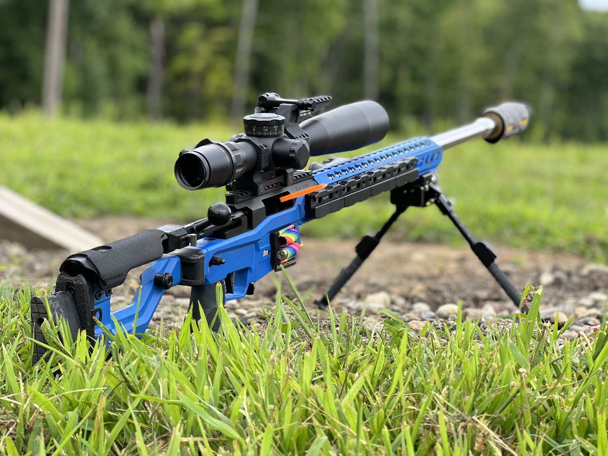

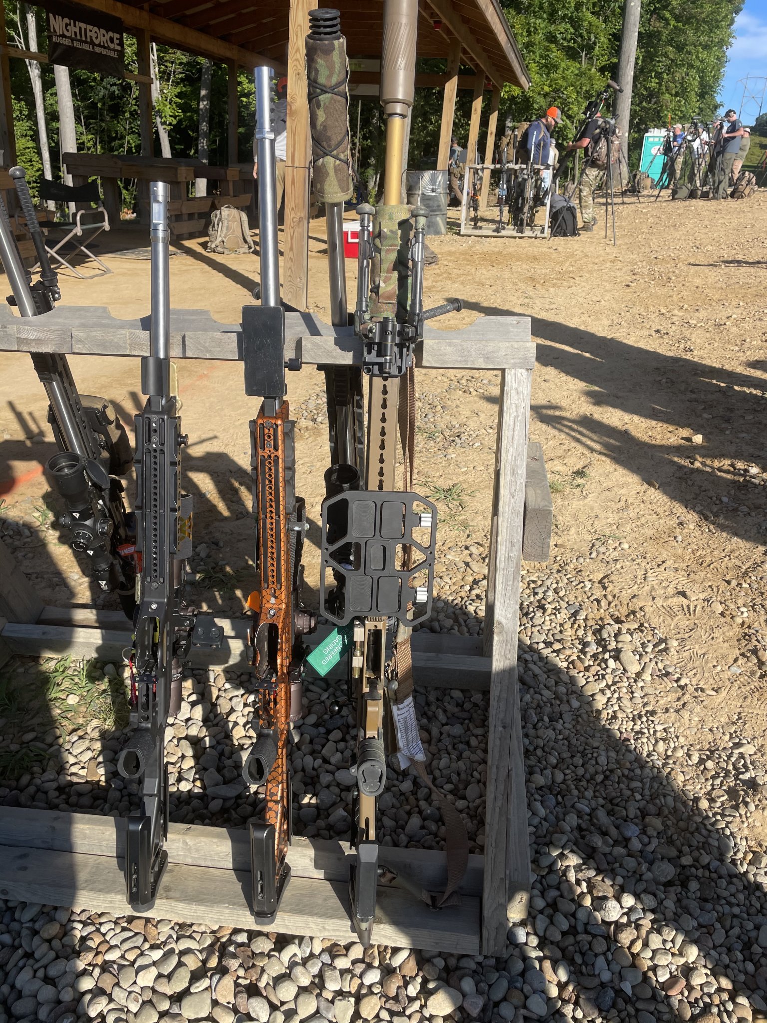

How heavy is that thing? Looks thick with all the weights, barrel/supressor.22GT hammered this weekend. Fed and performed flawlessly, any misses were solely on me. Love this thing more and more every time I shoot it.
28” Brux, 6.5” twist, running Berger 85.5s right at 3100.
Ohh she thiccc for sure. Around 27lbs. as pictured, and there’s still space for more… not sure that I’ll go any heavier since I have the balance where I like it and moving the weights forward would make it really front heavy.How heavy is that thing? Looks thick with all the weights, barrel/supressor.

Not to mention, the recoil is already non-existent so I think I’m to the point of diminishing returns anyway.
The width of the fore end with the weights/Sidebite was important for me as I did not want to increase the HOB while using a plate. Probably a marginal improvement but it’s exceptionally stable and easy to control recoil configured like this.
It’s hilarious/awesome watching trace with this setup between the flatness of the GT and the weight.
