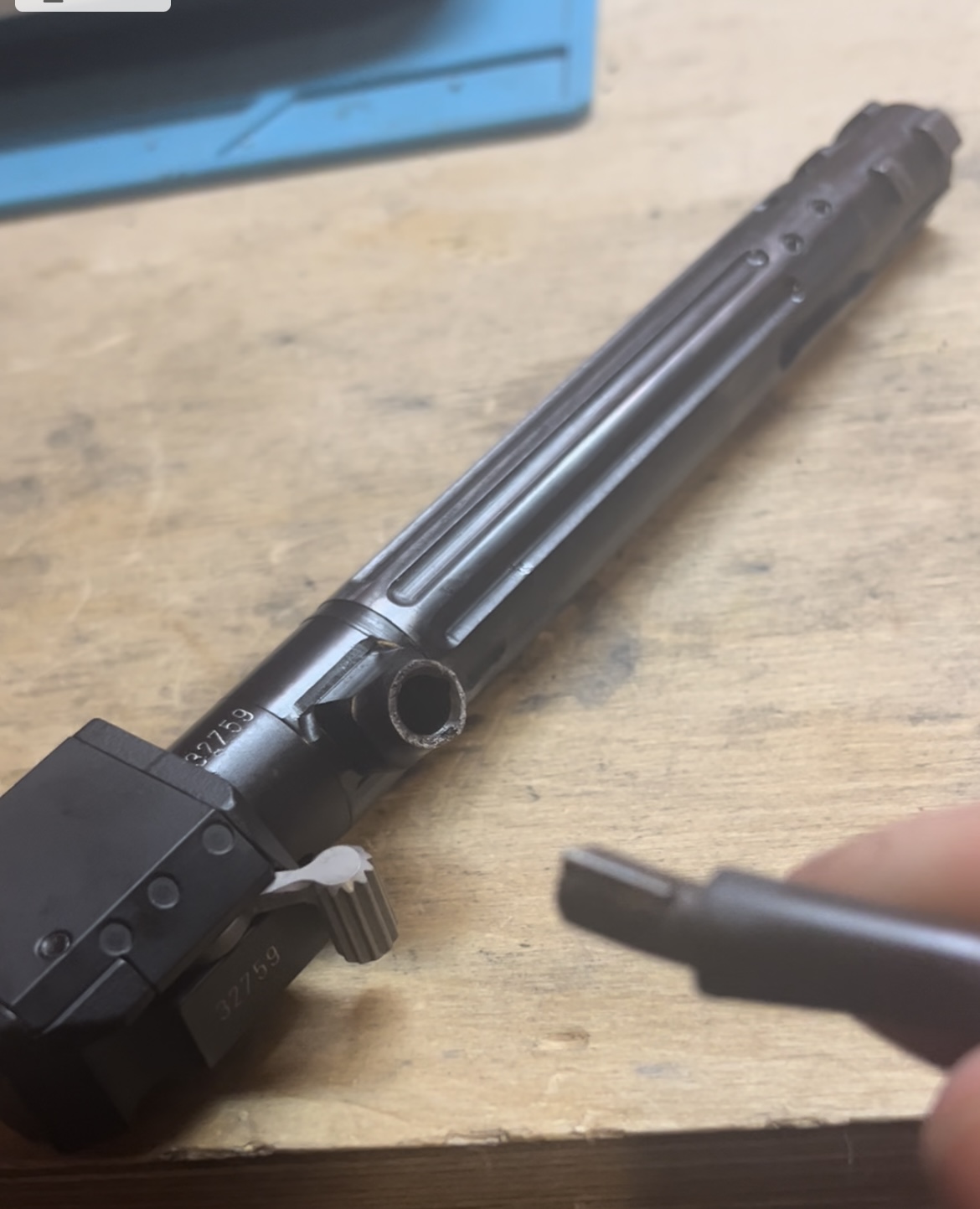

I was shooting with a friend at the PRS match in Telluride when he got a stuck .223 case (a bit overpressure). He was on-the-clock and hit the bolt with his hand to try to eject the case and the bolt handle snapped clean off his Tikka. He finished the match shooting his .308 AI AW which they let him shoot so he could finish the match. However because of that, I wouldn't shoot a Tikka.
Reactions: BurtG
How hard did he hit the handle? Had he ever dropped the bolt before?
I mean, Remmy’s handles have snapped off
“I wouldn’t run a Remmy either” I know I know.
Yeah, he was hitting it pretty hard.
However last time I shot the Nightforce ELR match in Wyoming someone - I can't remember who, but pretty good shooter had ammo that was WAY over pressure. Every shot he had a hammer, to pound open the action by pounding on the bolt handle. He did that for the entire match (2 day match)... I kind of expect the bolt to hold up to repeated abuse, but I guess if I was really concerned I would go with the Archmedes from ARC...
That was chase stroud. He was shooting a 338 enabler version I think, in a cadex or cadex chassis. He said the chamber was cut wrong. He lost 200fps from his first shot of the match to his last. I think that was 2021, first time I shot that match. I was in that squad.
Yes, it was pretty surprising to watch - I think someone else did the loading for him right before the match, so no time to validate it. I was surprised his action survived...
