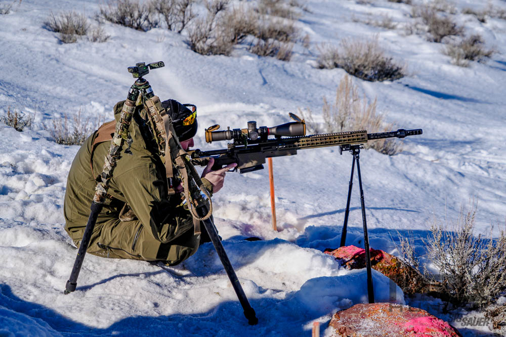

Took it to the USA last week for a course and NRL Hunter match with the 6.5CM barrel.
In the dust of Cameo and the snow in Utah, zero issues... Thing is a beast.
This is the first rifle out of my safe more often than not. All I have done is change the trigger shoe over to the flat version, personal preference.
I would absolutely recommend the AXSR to anyone looking for ONE rifle to cover a fairly wide range of magnum & short action calibers.
