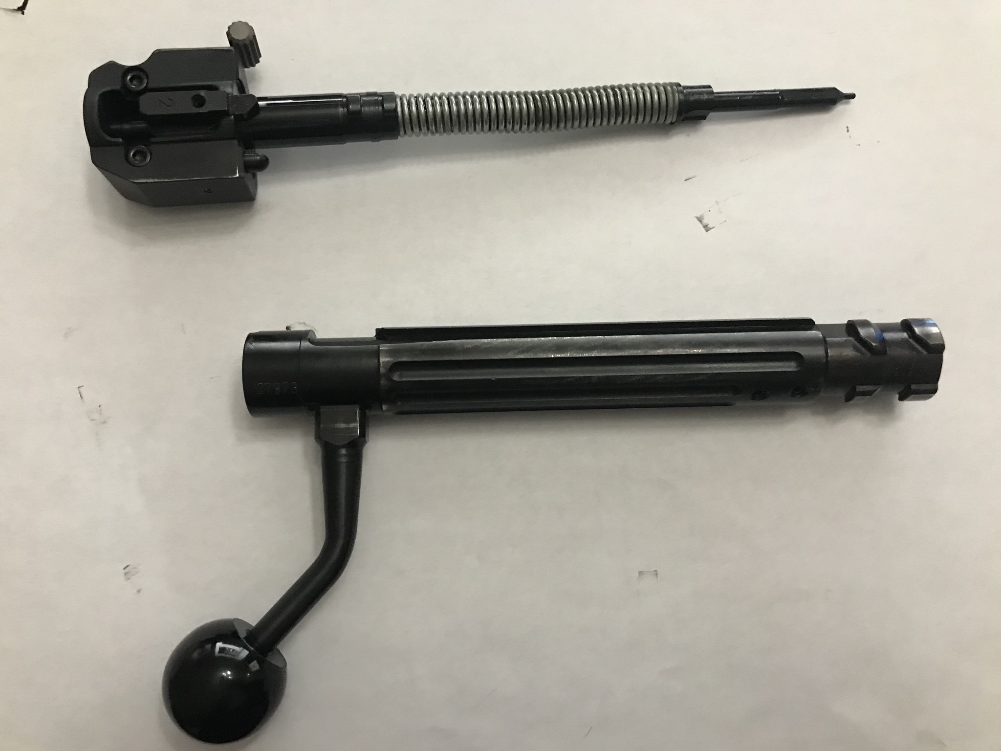

It’s a new gun...It’s was lightly lubed when took it out from the box. Haven’t apply any extra lubrication on it yet.

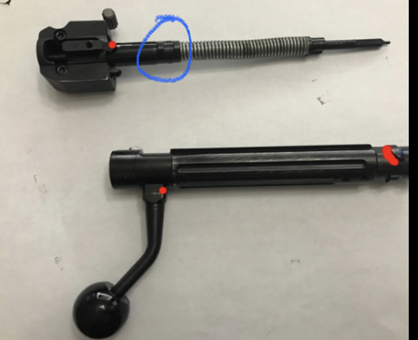

Two things to mitigate:
Knife-hand plus thumb on shroud technique:
And make sure you lube red and circled blue areas.

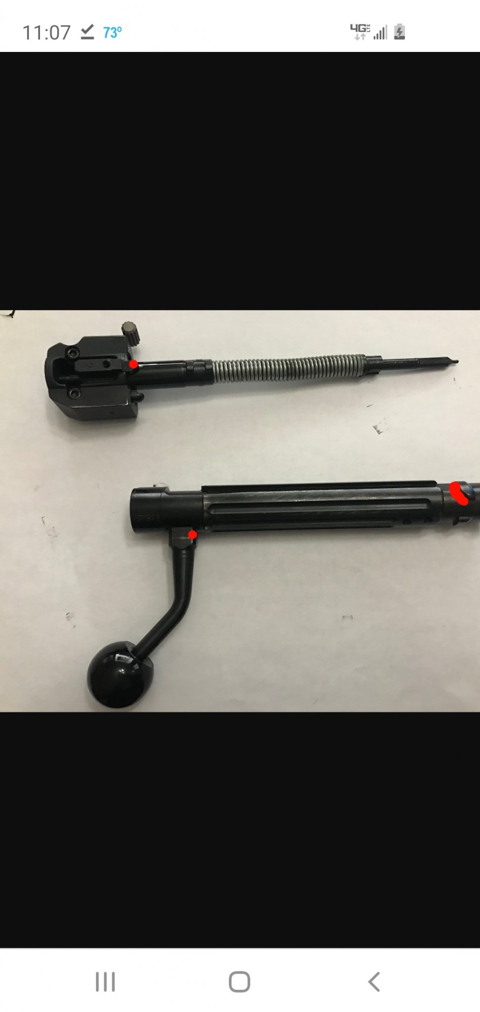

Oh yeah, thx to @Supersubes and @6brshooter for the graphic above. See here and here.
