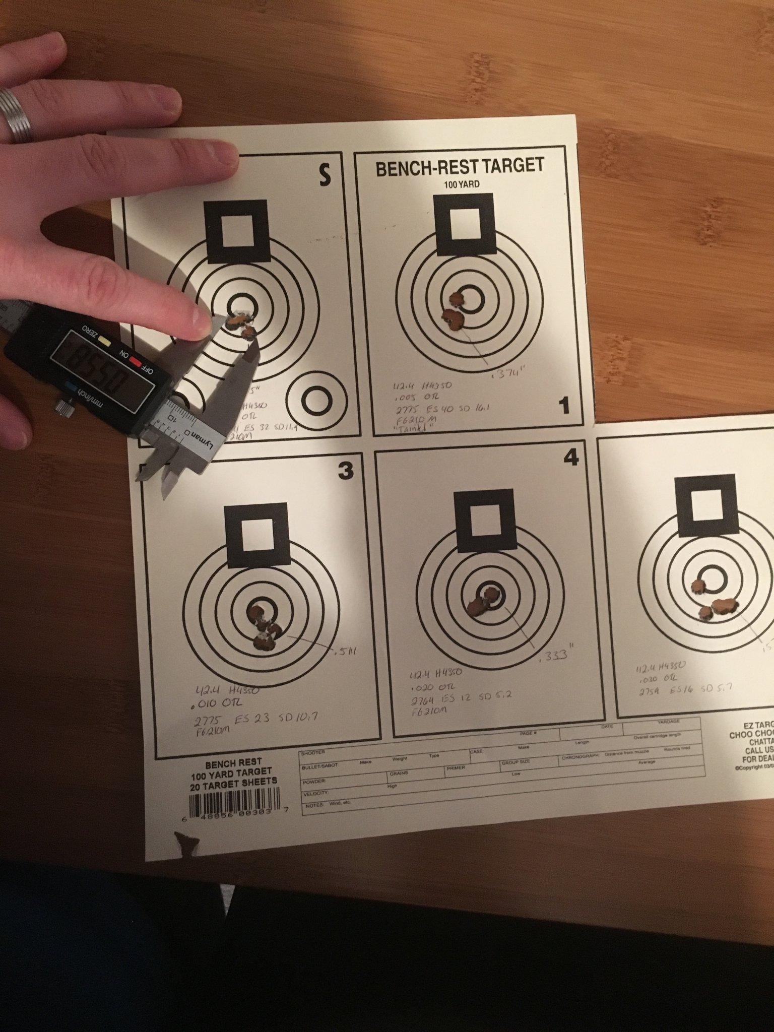

    Shot these today after reading this thread in the AM. Not the best but then again this is a seating depth test and the winds were no joke 20-30 MPH #F¥£kKansas. However, .4xx inch average for a 5x5 ain’t bad for working up a load in crap weather

    Good shooting, that's the exact target I used, lol.

    I would not get super excited about the factory Ammo unless it’s giving great ES and SD’s, something factory Ammo rarely delivers on. Look at my target above and check the velocity numbers, target 4 is probably what I’ll go with as the numbers were the best with it. However, target 1 had the first 4 go into one hole and the last round was actually colored red for “damaged.” It got caught on the feed ramps and when I checked it the meplat was jacked. I did this at home while chamber testing with a new headspace load. If you remove that round it was an ES of 11 and SD of 5 and a group in the .1x realm. Target S was the smallest but the numbers start sucking away from the lands. While prime Ammo groups well for me, 1/2 MOA or better most of the time @100, the ES is 40-60. If you run the numbers in a ballistic app you will see that becomes significant down range.

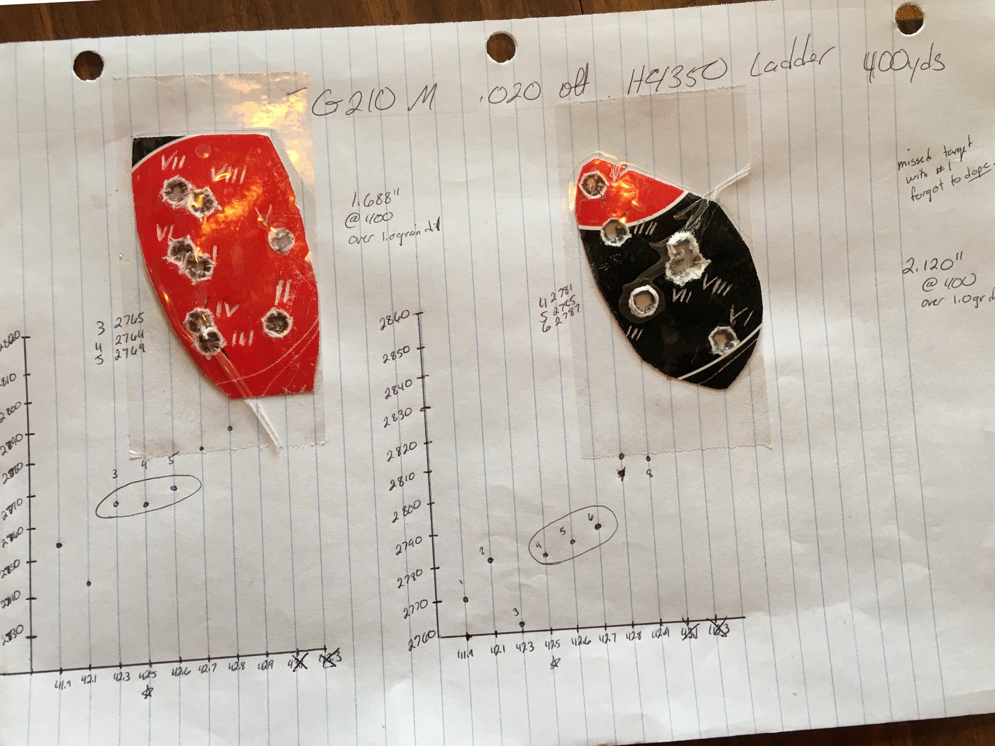

    In your original post did you just guess where to start? Did you run a ladder test or OCW? Here’s my ladder tests with FG210M primers, I ran some with BR2’s but there weren’t near as good. I shot a lot in between these two and you can see it was right around the 100-200 rd mark as the barrel sped up between. Settled at 42.46 of H4350 and the above target was the result.
    Last, I’d be trying a 105 Berger or Dtacs..... just my $.02

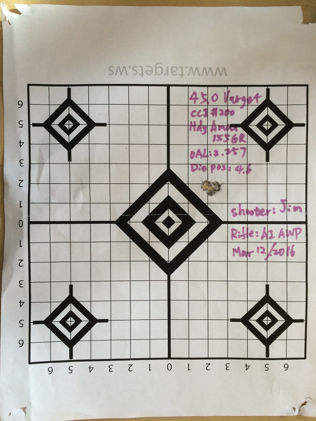

    For quanlity rifles, like AI or TRG, half MOA is really not difficult. I got my AI AWP, 20" factory barrel, on Jan 2016, and took it out when it's getting warm. The first 5 shots in 100 meter is,

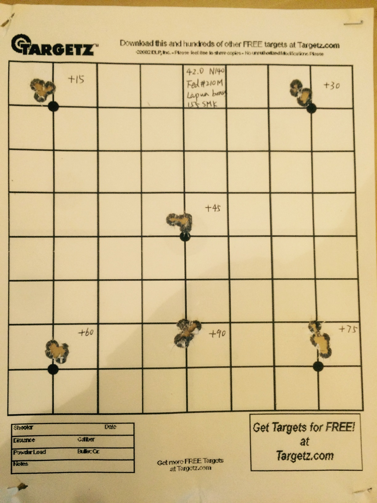

    Then, I did a load development, and this target paper is from when I playing with its seating depths on Oct, same year.
    Some things need to be notice,
    1. I'm using mixed second hand lapua brass. Very cheap, I know:).
    2. The powder charge used in this attempt(42.0gr) is not an OCW charge. High/low node should be 45.7gr and 39.2gr.
    3. For the group in the right-bottom, there is one shot caused by me, my support hand was so tired, after that many shots, that it can't squeeze rear bag very stable, which cause that shot is a little high. Not an excuse, just don't want you're be misleading.
    4. I'm not a good shooter, and I don't do breath control, follow though .etc. I believe it will help accuracy, just didn't feel comfortable to do it.
    5. +xx means xx thousandth off land.
    I did take this rifle out twice after. Both are very cold, I'm from Canada, you got the idea how cold it will be in nov. anyway, i still got 2 out of three are sub quarter moa.

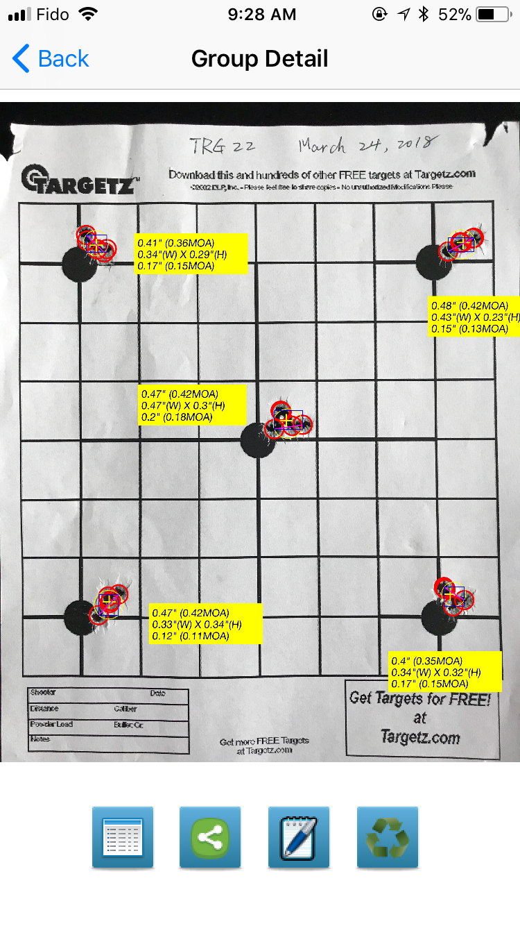

    Can't resist to register and post my reply. will update my TRG target paper I shot last month in a minute.
