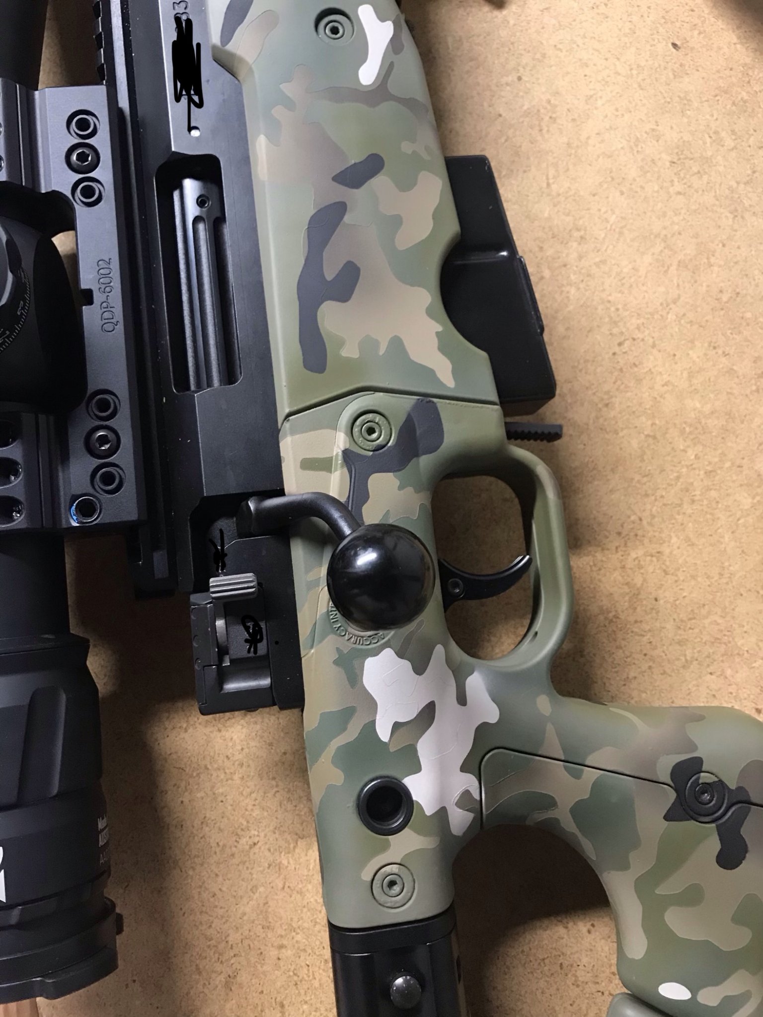

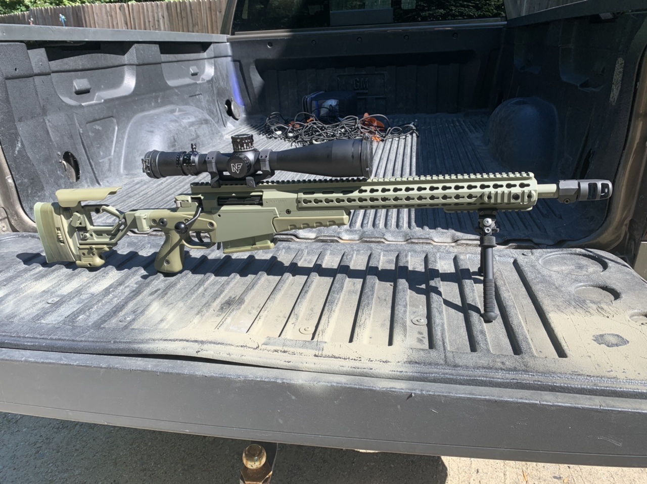

In an unrelated note, anyone got any reason to think the AI flat trigger shoe won’t work on the ASR? I love flat shoes but I’m very impressed by the grip and grooves of the factory ASR trigger.
See said grooves:

Yes, I think that's what they call the small one.
Nice, but it looks like a tight fit ;)
