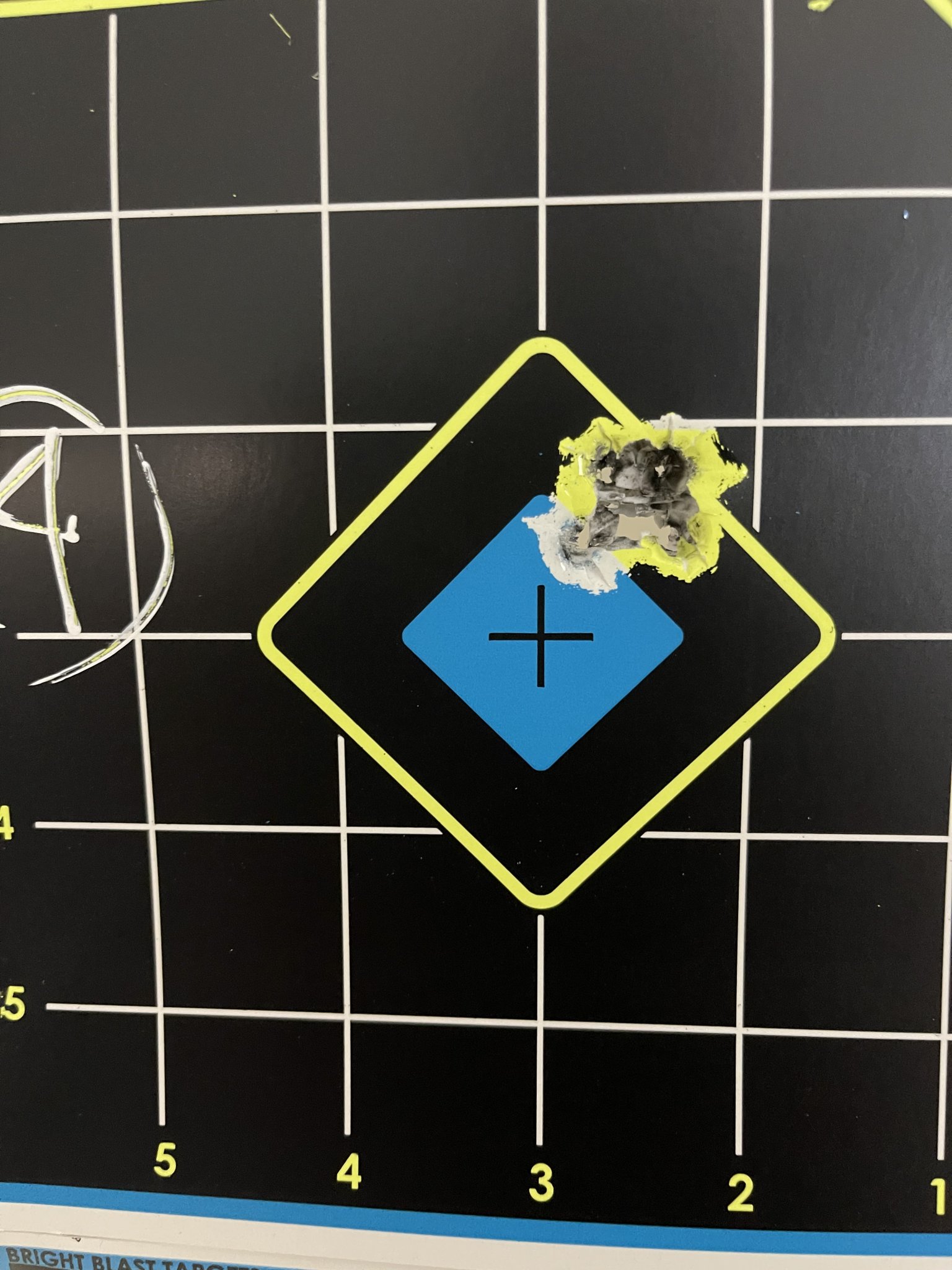

axsa 26” 1-10
155 smk Palma #2156
.308 Peterson srp case
47.0 gr Varget
cci #450 srp
5 shot group
Had some time to finalize my reload. I’m pretty much done and just stick to this recipe.Don’t wanna waste anymore powders. Seems like no matter what reloads I throw at this ax, it just shoots dead nuts anyways.Time to stretch it.
Nice shooting. That velocity seems a little high?
Reactions: Defender3
Nah.. 2900 fps and up is key with the #2156. Is completely different design from the old #2155. Those Palma guys get it going to 3000 fps and up, though with a 30” stick. Key for the 2156 is, these bullet likes to jump. Mines is 8 thou off lands. Best to go with .308 cases with srp pockets ( there’s lots of info on this as to why ). And I don’t know if it makes a difference, but I like to use srp magnum primer for this. And I went with 3 thou of neck tension. With a kiss of taper crimp. Using Reddings taper crimp die.
