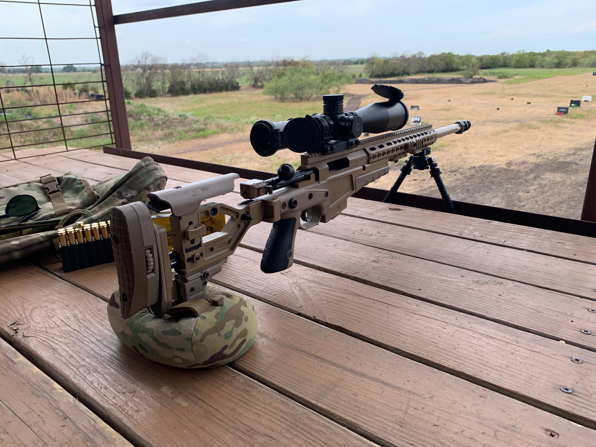

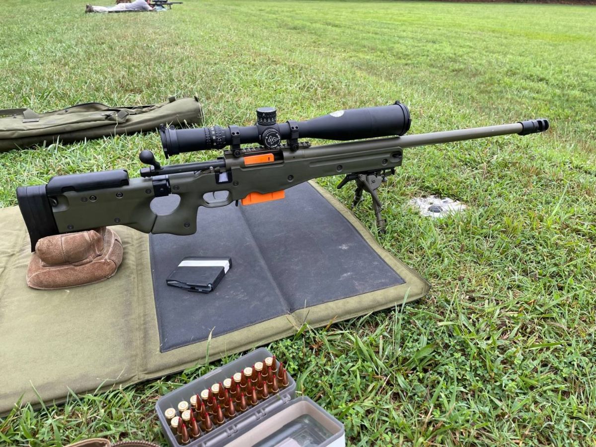

I have one on my AT...it is a great optic
I’ve got another on an AICS LA. Great optic. Edges out the Gen 3 Razor slightly on the brightness.
Don’t bother to ask me about edge clarity or chromatic aberration or depth of field differences because I don’t have a clue what any of that technical jazz means.

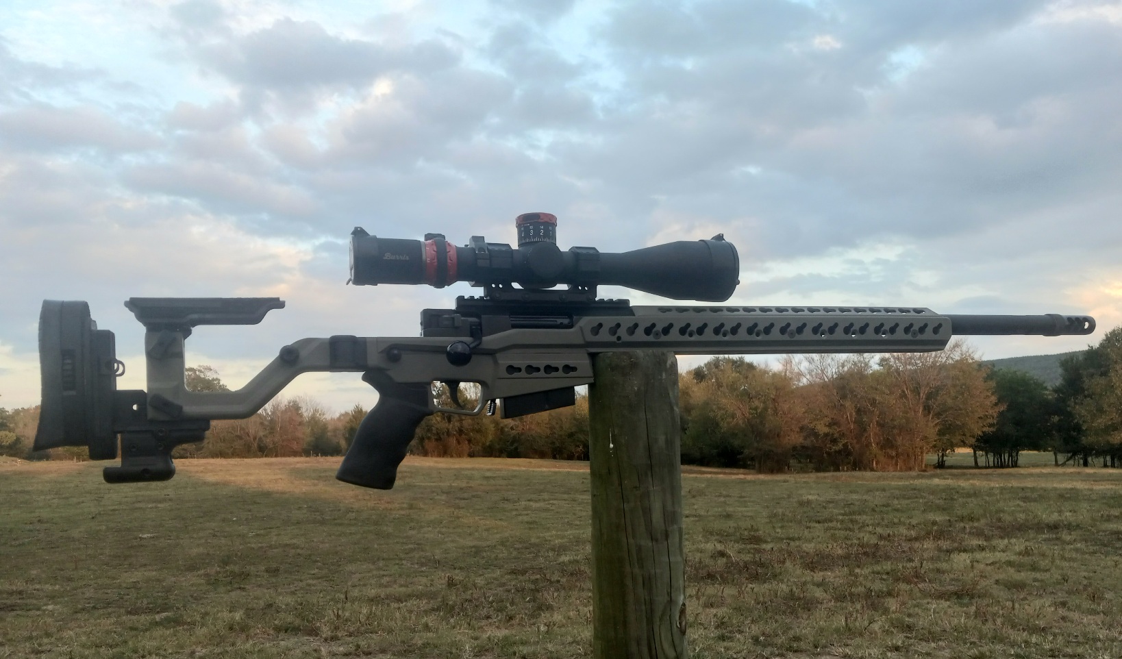

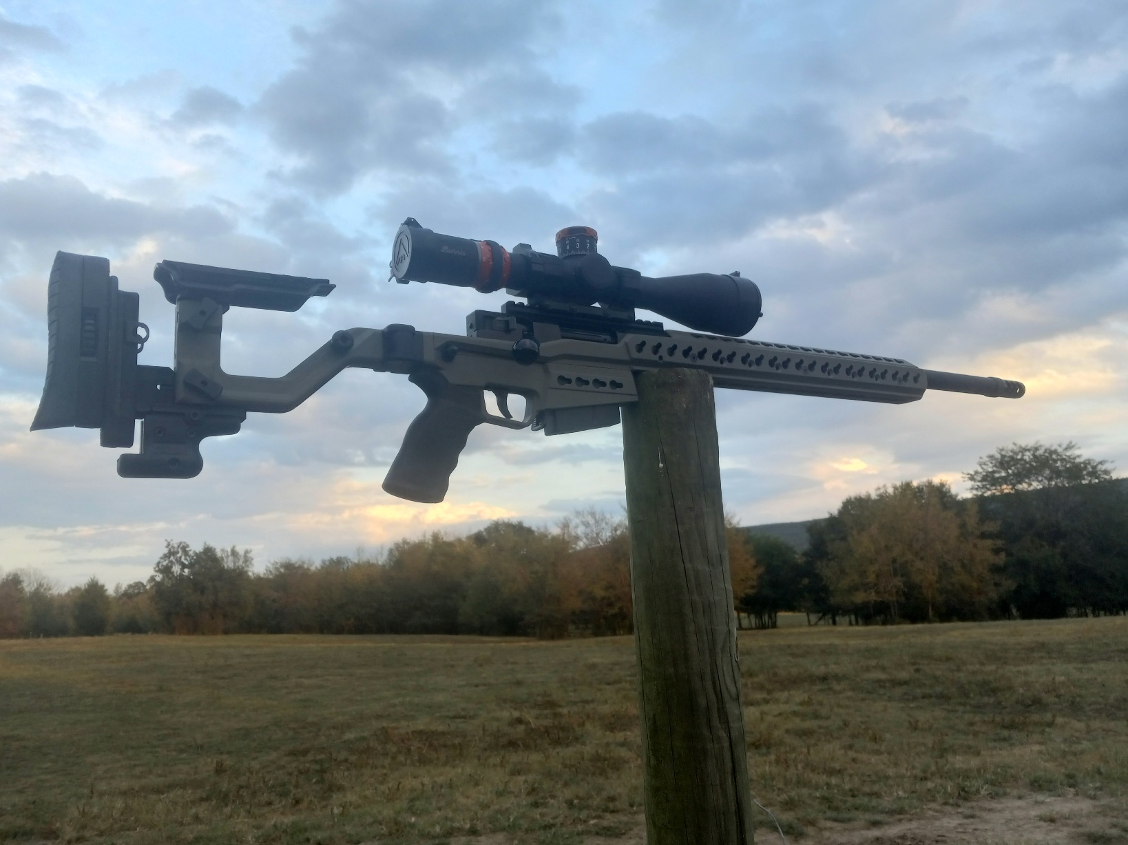

A Remington! Blasphemy! Heretic!
