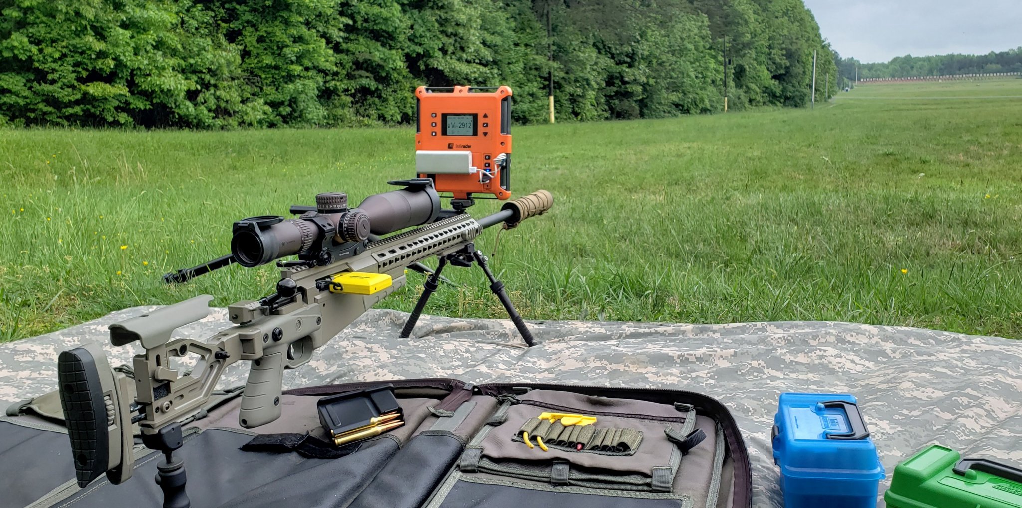

I took the new AT out to Quantico for a 1,000y range day today. Even though it was raining and supposed to rain throughout the morning, there were still a few of us on the line. I also had a guest in Scott Seigmund from AINA. On a whim, when I noted that AINA was right in F'burg (all of 12 miles away) I sent a note to the info e-mail addy asking if "they" wanted to shoot LR on R4 (which we do each weekend). Heck if Scott didn't reply, and came out to join the Quantico Shooting Club. While he didn't shoot today, it was a pleasure to meet him and learn a bit more about his shooting passions; I know we'll be seeing him on the line as his schedule permits. I know, CSB...
Anyways, I brought the AT with me and even though it wasn't sighted, I shot at 4" clays on the berm (1,035y) to get a read on where it was hitting. A few adjustments and 10rds later I was at least on target. I think I like this rifle, incredibly smooth bolt, excellent ergonomics and it seems like it just "fits" me; I will be naming the AT "Darlene." On the 1,000y line at Quantico.

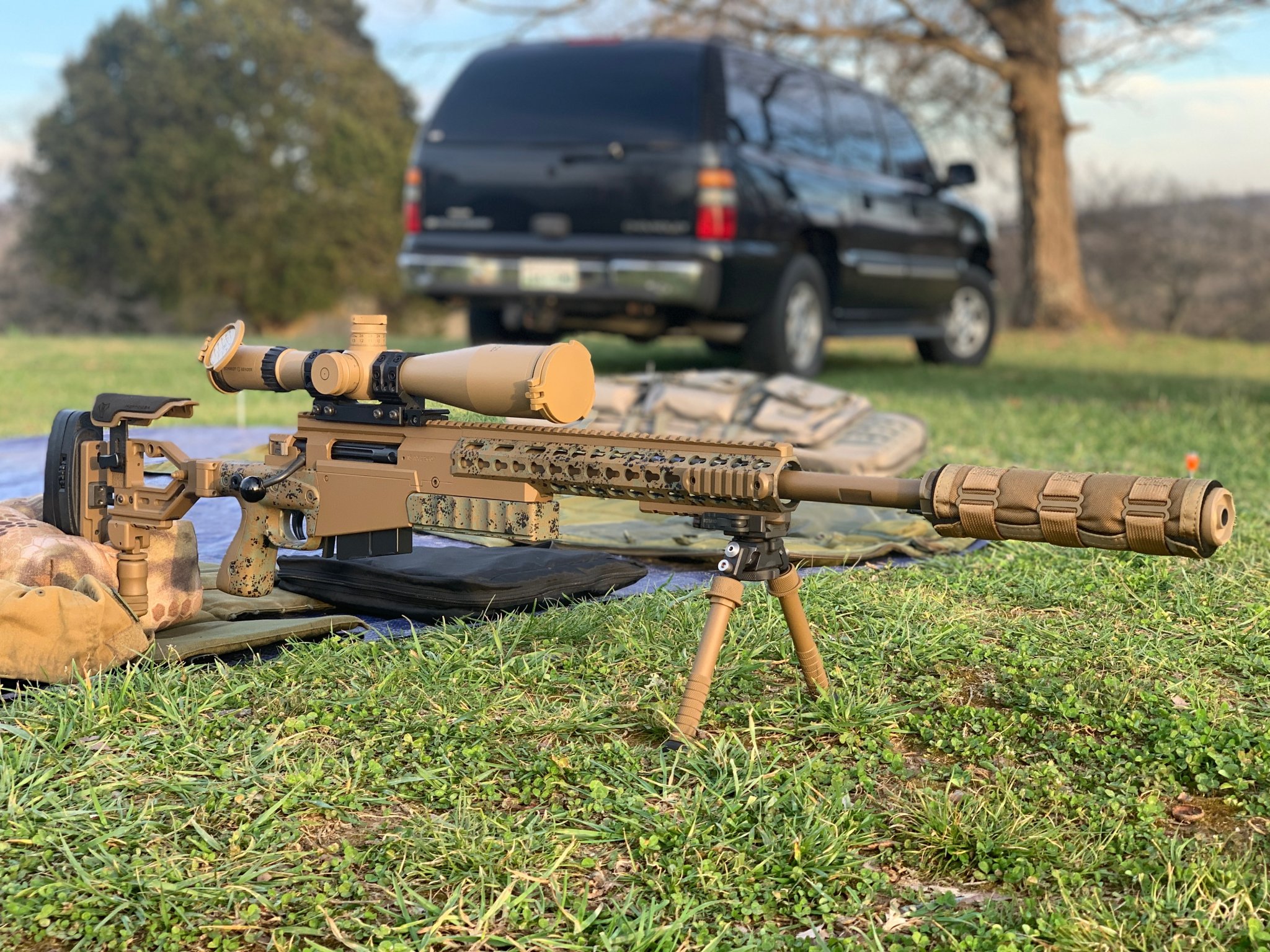

Swapped out the Vortex PST in Smith rings to a Vortex Razor in an ERA-TAC adjustable base and swapped out the .338 LM with a .300 WM so I can reduce the noise with a Thunder Beast 30BA.

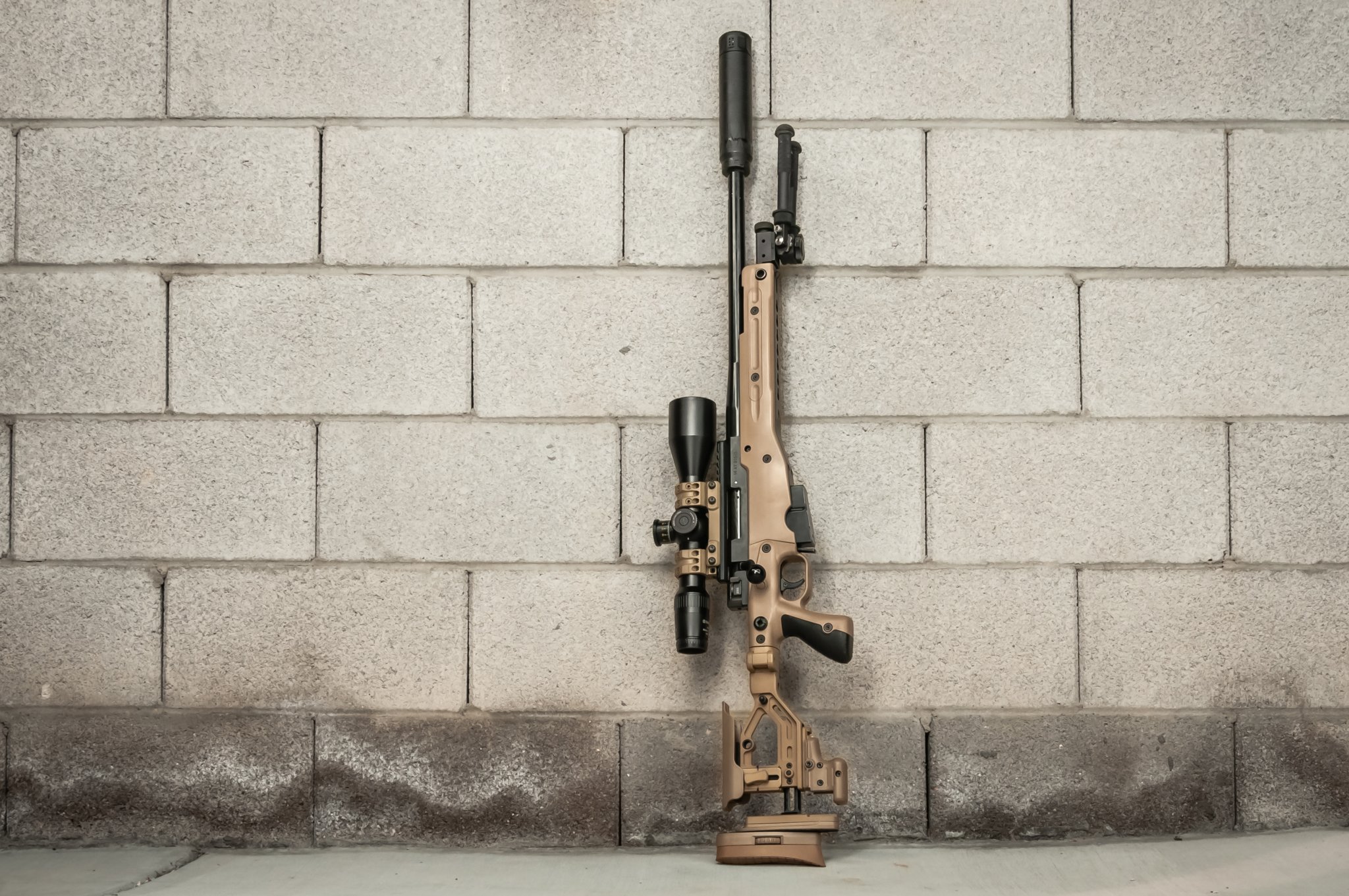

I’ve got the shorter handguard on mine. This is with the 20” .308 barrel mounted.
That's sick I wanna run a short 1/8 twist 308 for subs but I'm having a hard time finding a shorter handguard anywhere. Mh and euro both don't have one might just have to cut an inch off mine.
I’m happy with the 13” tube. I just need the barrel cut to 16” to get it the way I want it.
Edit: I wish I could tell you where to find one, but I didn’t even find mine. I bought my rifle used, and it already had the short tube. Lucked out, cause I would’ve been hunting one too.
