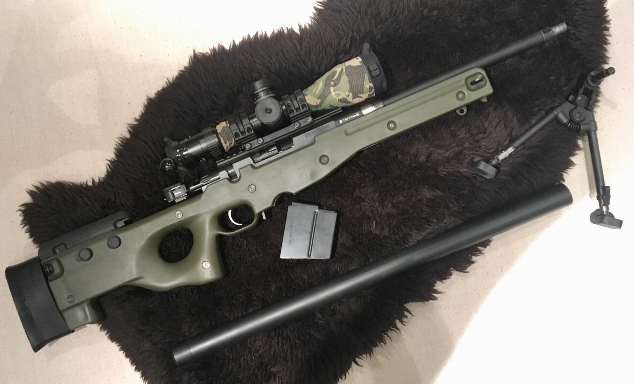

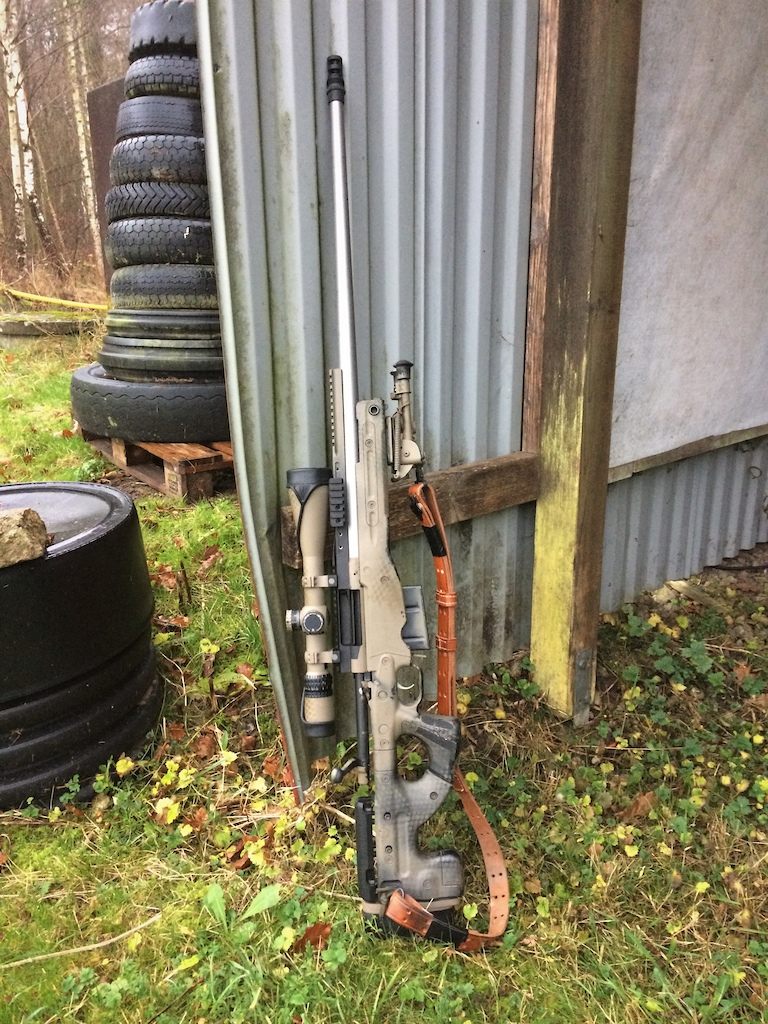

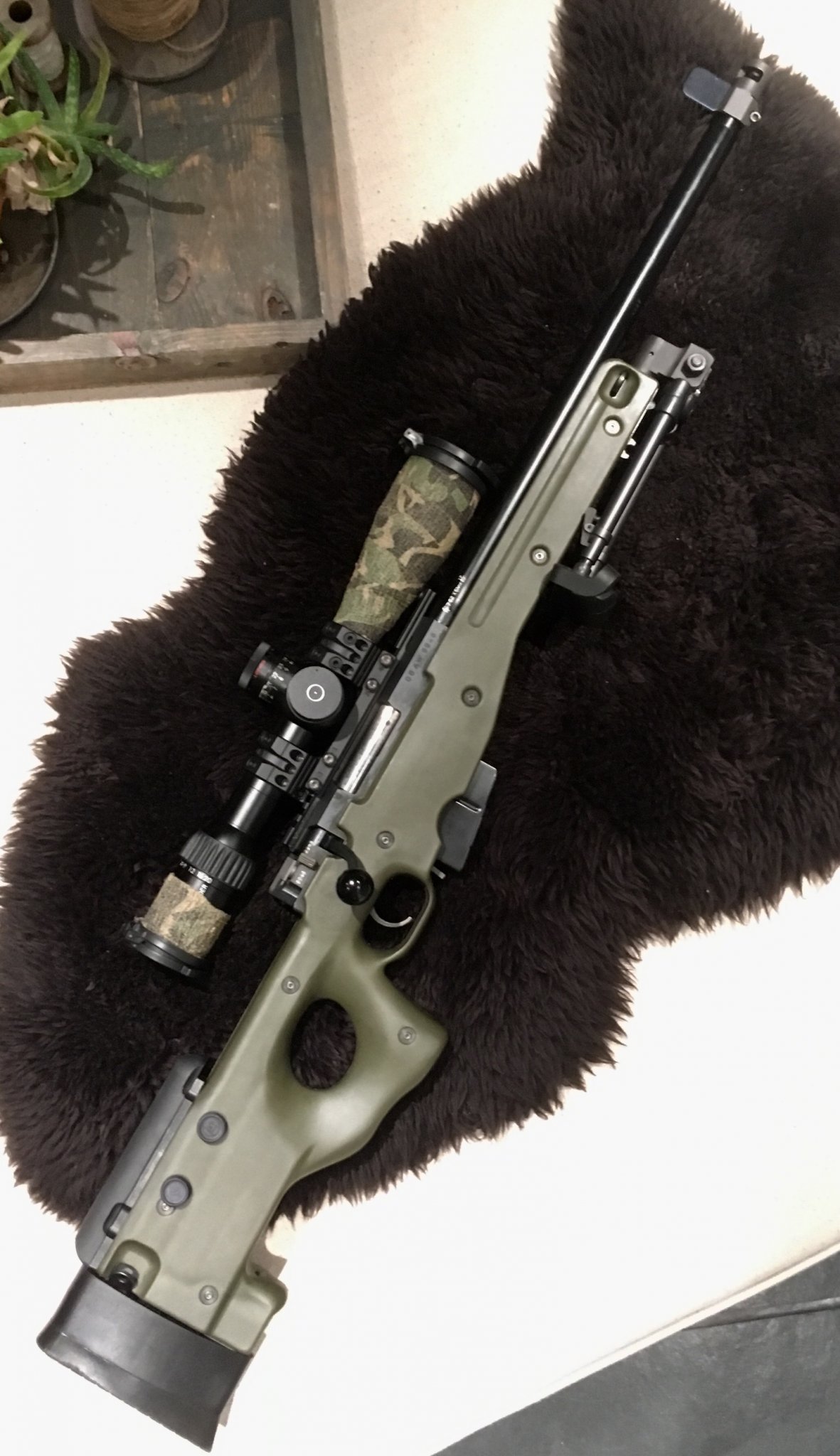

An older AW starting it's second life as a 6.5cm this time.

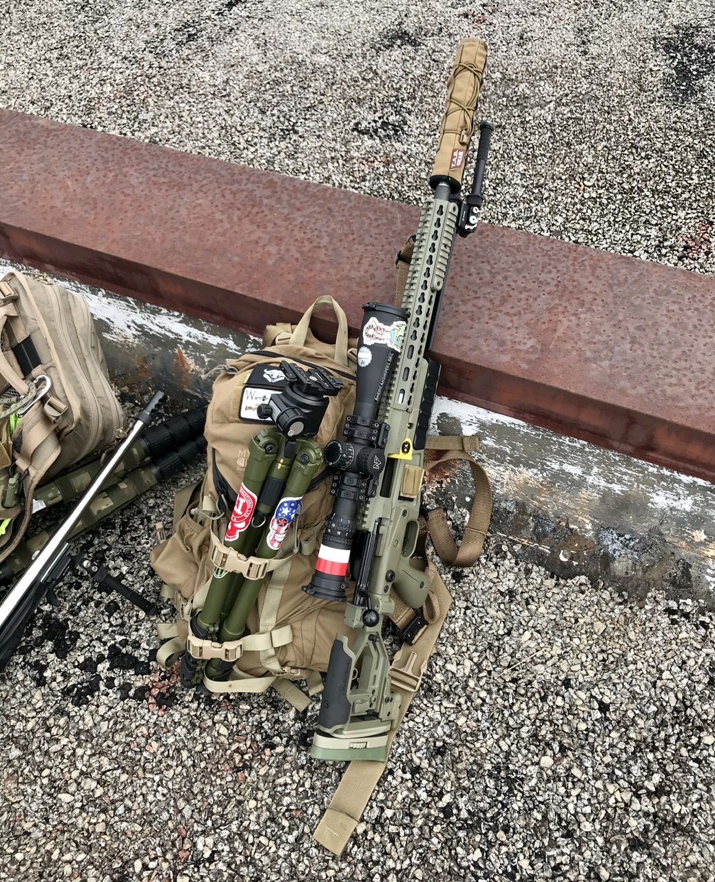

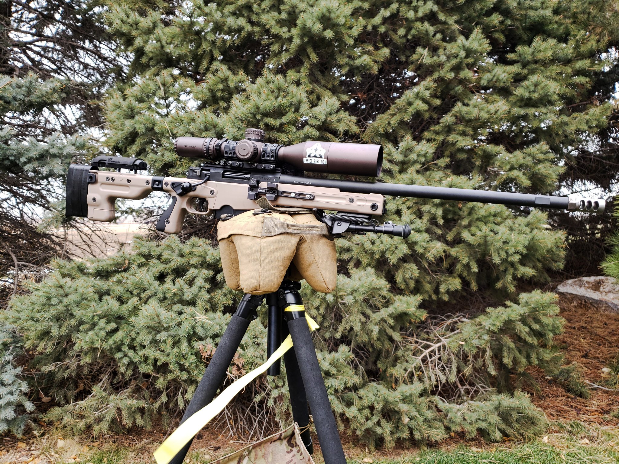

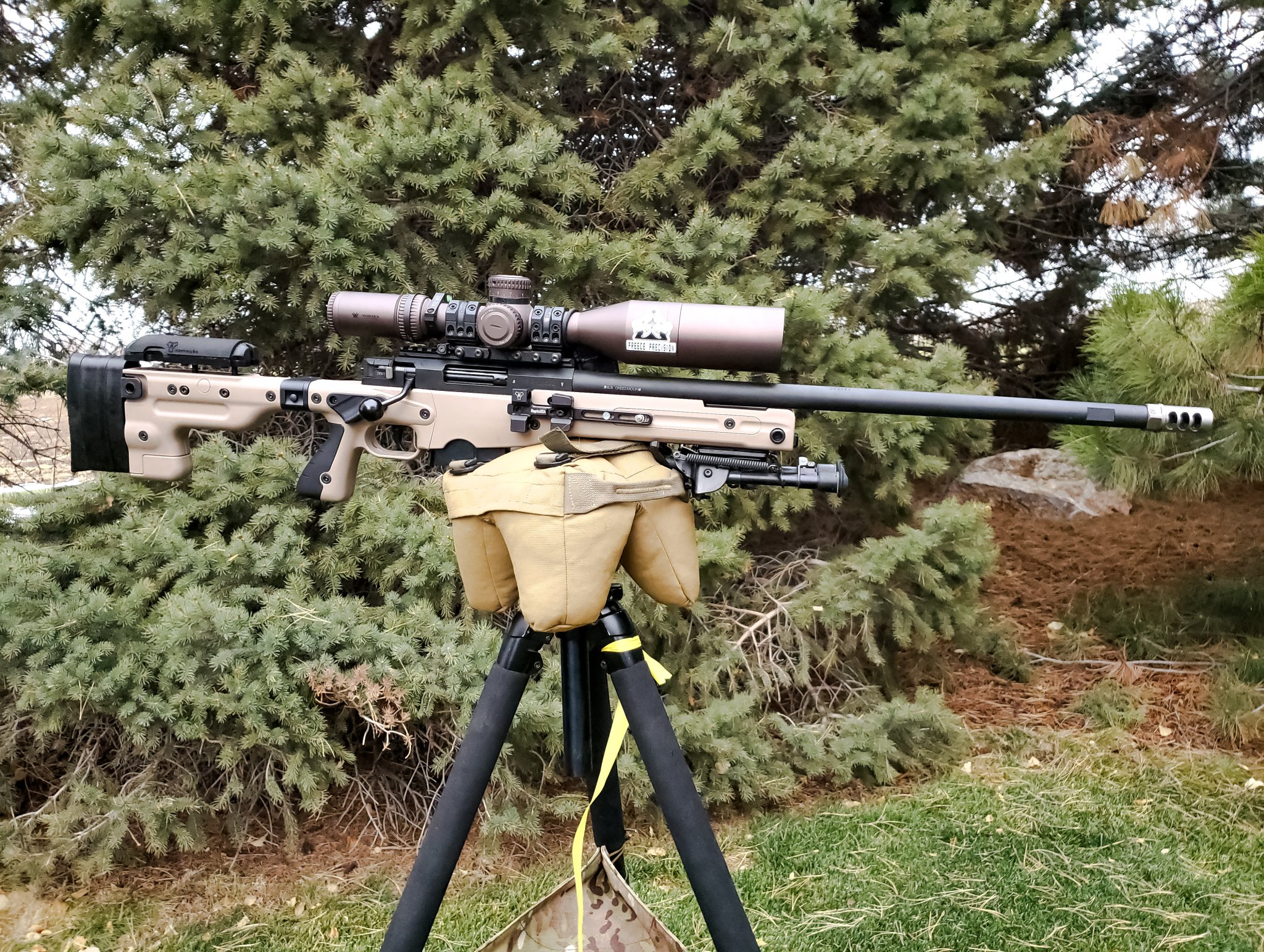

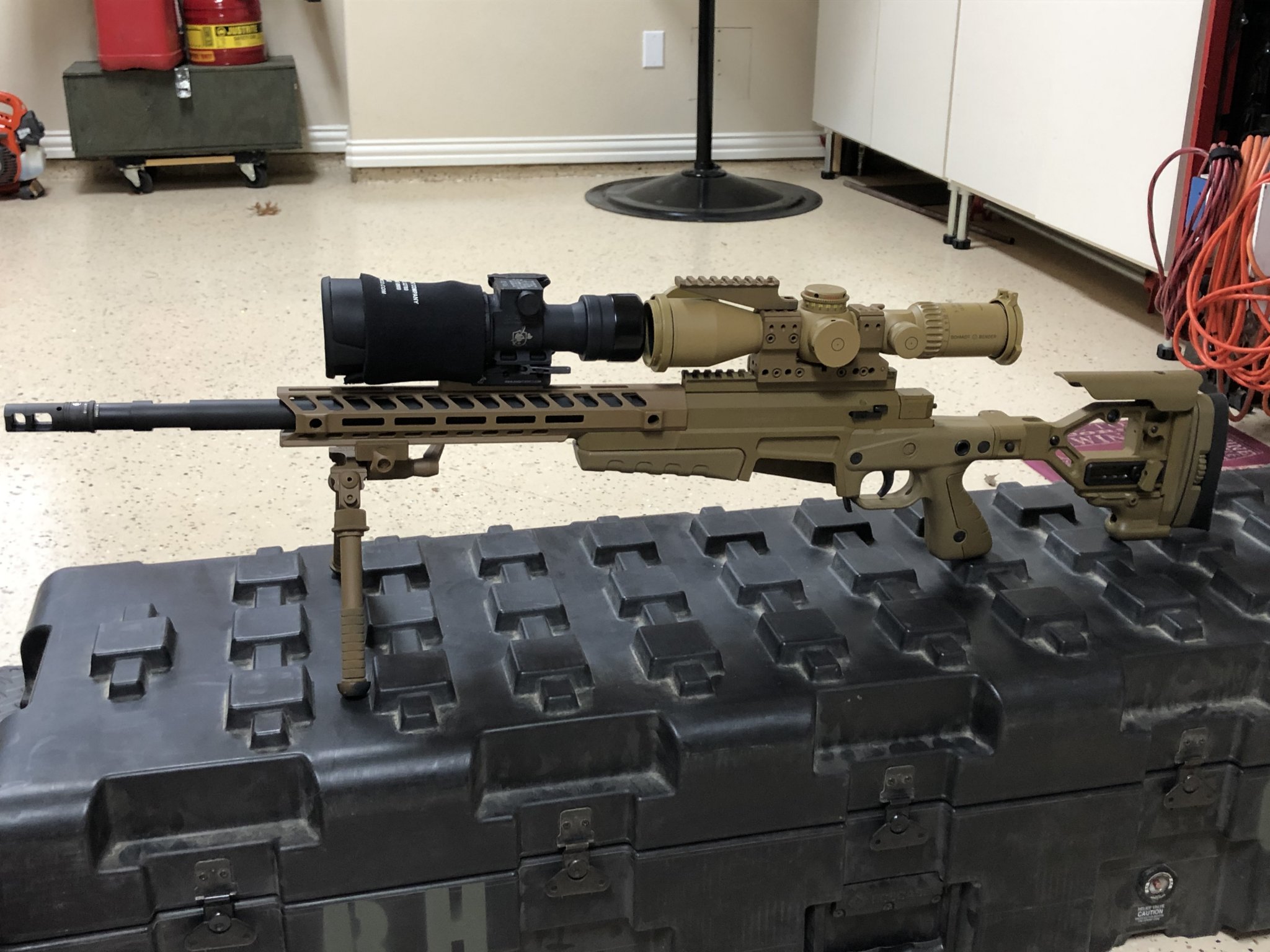

Nice rifle! How do you like that Ase Utra BoreLock muzzle brake?
It is very loud, so I wear both earplugs and ear pros on top. This makes the blast bearable. It helps a lot with the recoil too, granted the rifle is heavy on its own but it's good to have something that takes it down a notch. I do prefer my suppressor though.

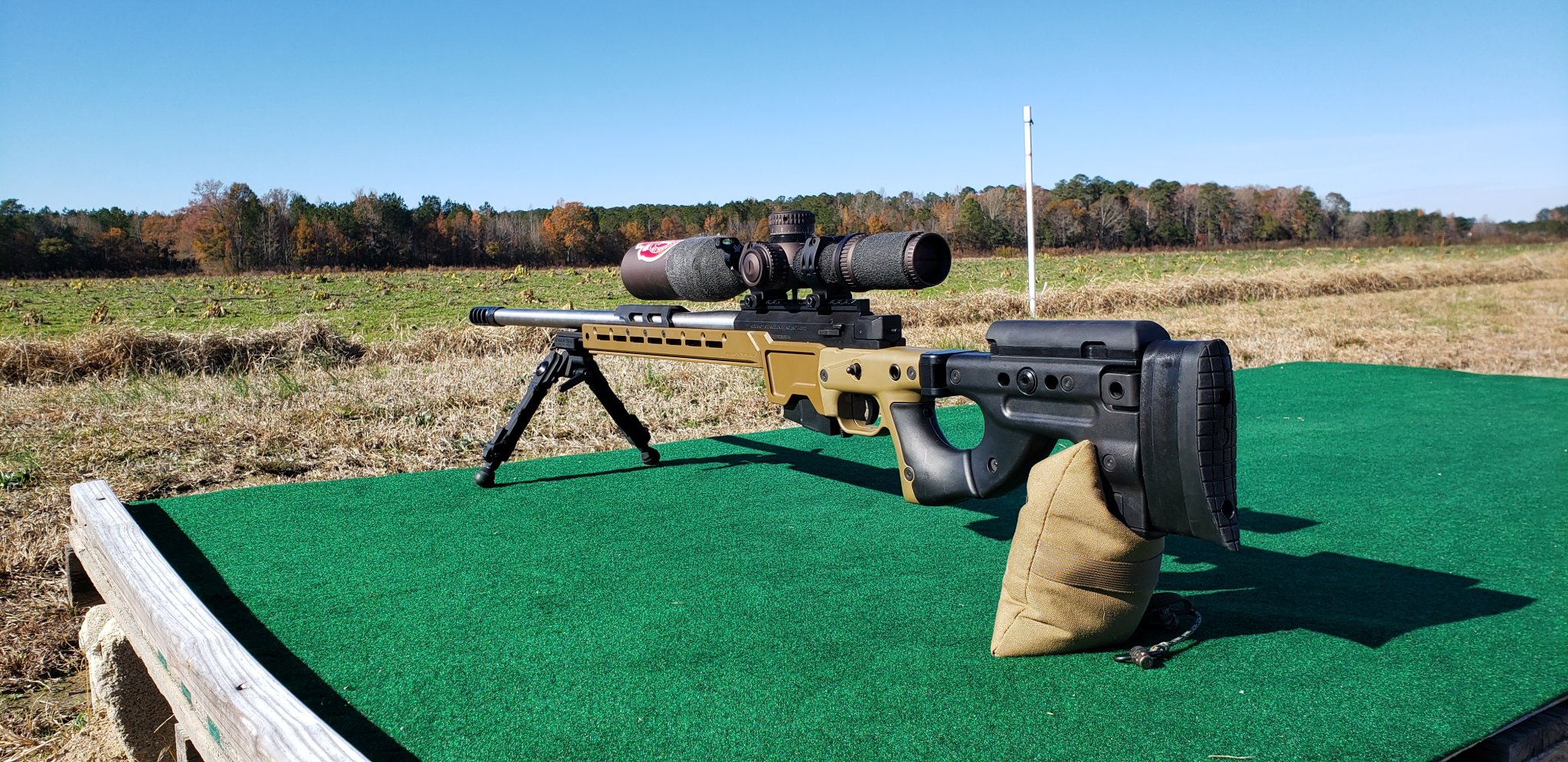

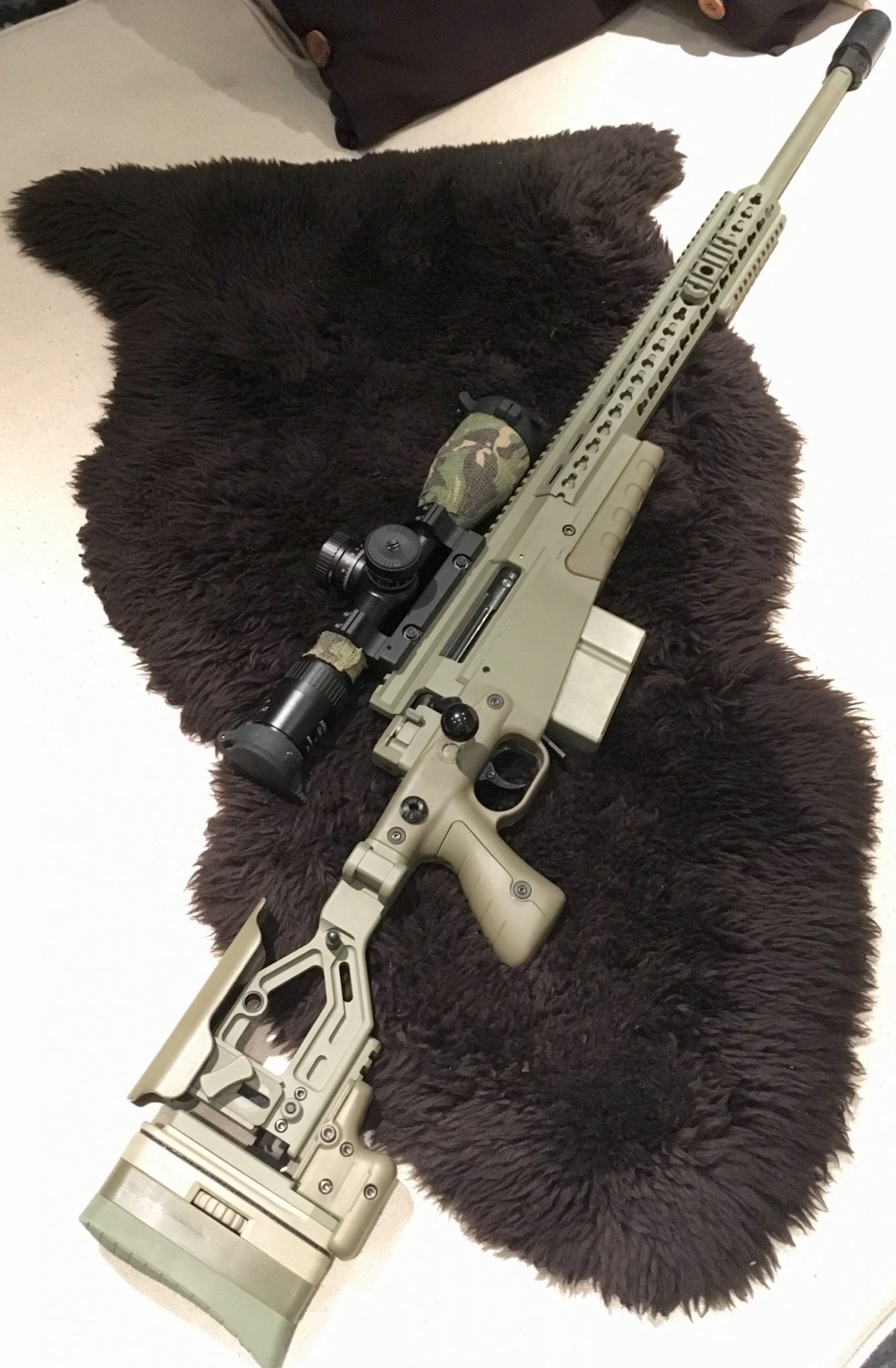

Nice rig! Don't you normally shoot an AT-MPA?
I do in PRS style comps, but I bought an AX out of the PX a few months ago and it seemed more fitting for a tactical style match...especially the right folding butt stock. It was extremely convenient to be able to fold the buttstock while the rifle is slung across the chest...especially when climbing caged ladders.
Reactions: samb300

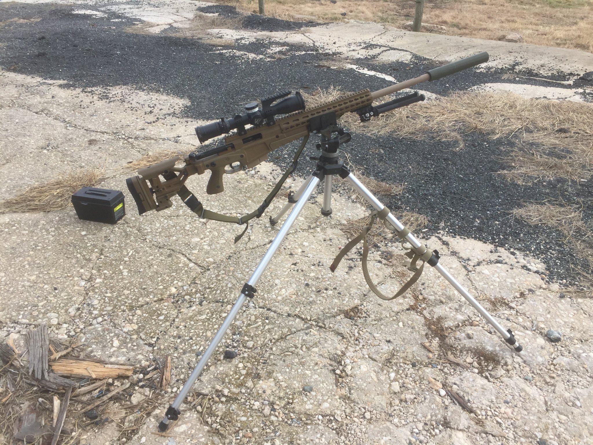

Really nice set up!
How do you like the tripod? Worth the money or should I spend a little more and get a different one?
It is a really good field tripod. Not as tall, or as stable when fully extended as some of the higher priced options, but it handles this AX very well. I have seldom shot from it standing, mostly prone, or sitting where it is extremely stable. It is light and very quick to deploy/stow. The only negative I have found so far is the max height. I’m 6’1” and have to bend slightly to spot (binos) with it fully extended (incl center column) and tall bino adapter. It would be perfect for an angled spotter. However, I prefer to get on the binos sitting when I can so I don’t let it bother me. I thought I’d get good experience with it in the Guardian match, but the way it was set up our tripods were extra weight. My brother used his PVA comp on two stages, but I did not deploy mine at all. We ditched them both on the second day and did not miss them.
Reactions: az _desert

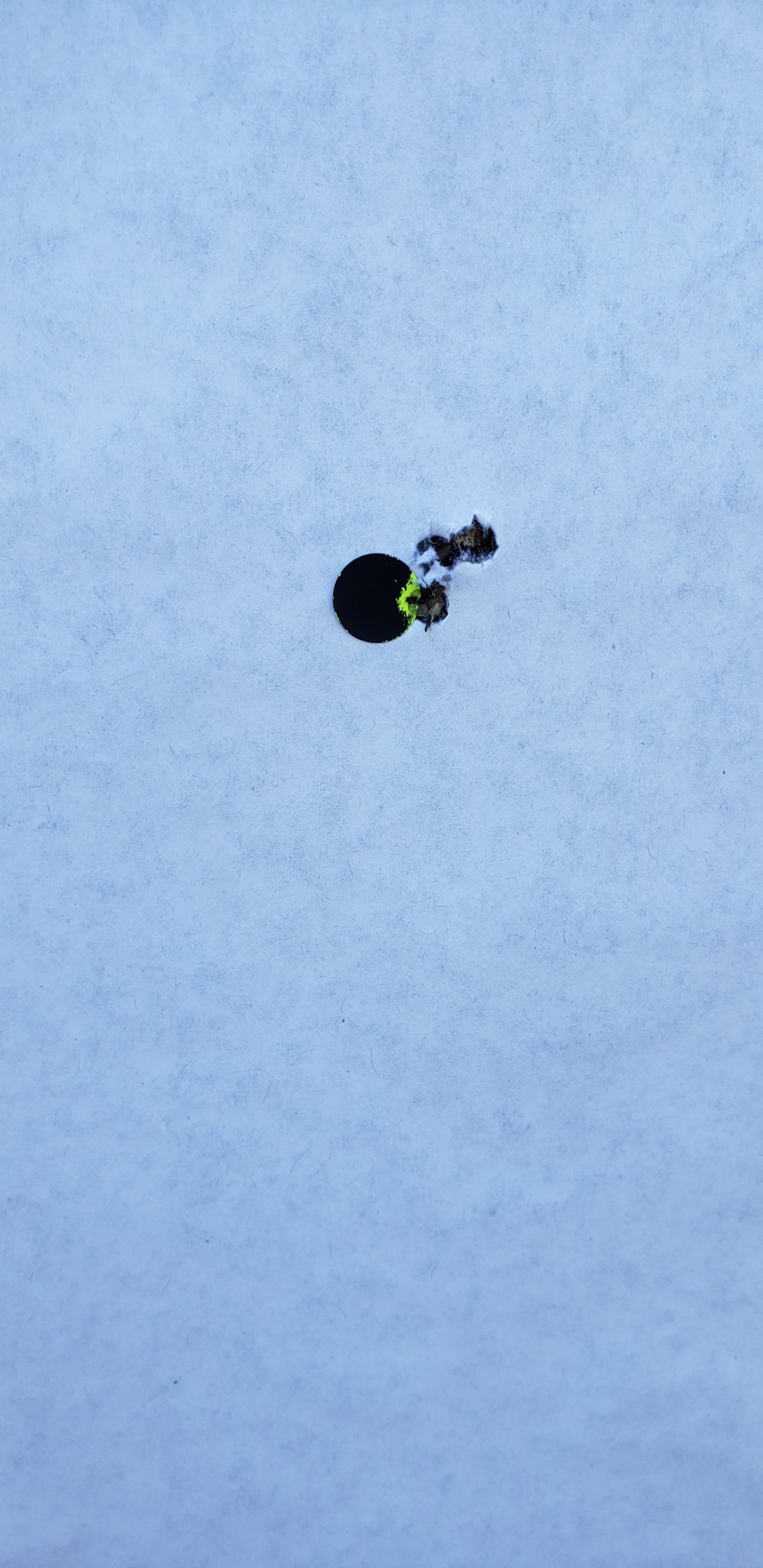

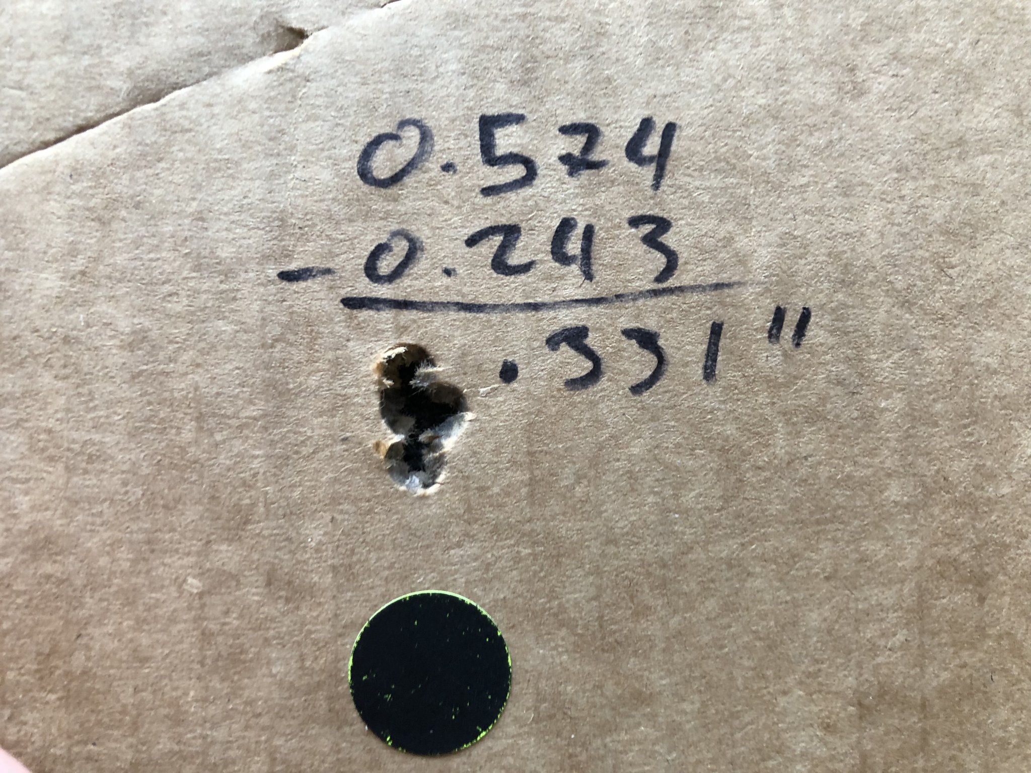

Well I love my @Robert Gradous Dasher barrel... I just finished fireforming 600 pieces of Lapua brass and I loaded up 31g and 32g of Varget over 107 SMKs and couldn't be happier. This is my first 6BR variant and it really is kind of an "easy button". These are five shot groups.
View attachment 7189572View attachment 7189573
Really impressive groups... did the Dasher feed without issue in the AIAX magazine? I was thinking about 6 Creed but the dasher has a strong following. Well done!
Reactions: 81sfo
I’m using the HRD mag kits and I had a couple hick-ups with the 6BR rounds during fireforming, where the last round in the mag would nose dive down into the mag/follower from recoil. But zero issues with the Dasher so far.

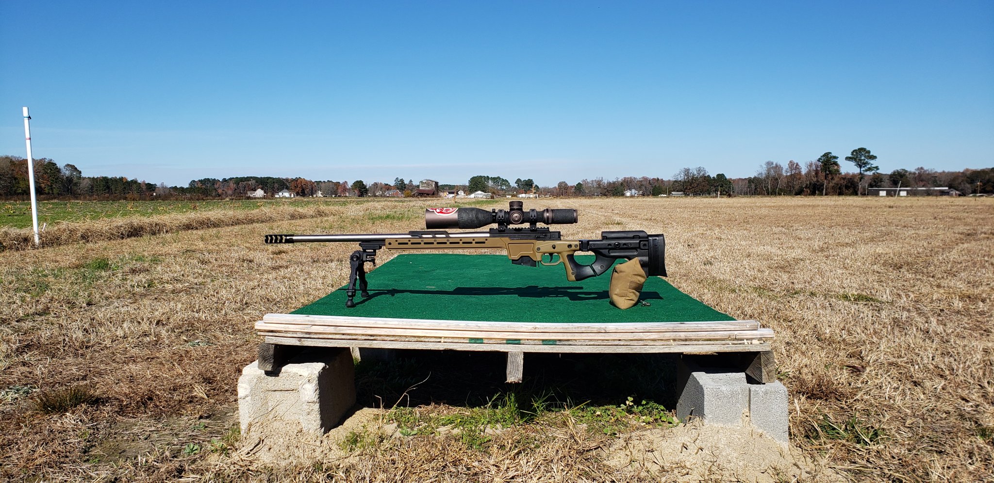

Finally put some rounds down range in the AO prototype chassis. Felt amazing. Shot prone and some short 200 yard positional. Night and day difference from the factory chassis. Not to mention, it was a virgin 6cm rock creek PVA barrel shooting shitty hornady black ammo. Proof that re-bonding the action wont degrade accuracy.
How is the repeatability when you change barrels? Can you unscrew the barrel, shoot a different barrel then put the original one back on and it is always the same poi or do you have to rezero each time ?
My DT is very consistent. Dead on with 16” 308. .5” high with 18” 223 and 2” low with 26” 6.5. And the zeros are always the same.
I have been re-zeroing, but it has been the same every time. All 3 barrels are zero’ed to my 6.5CM barrel. I don’t reset the zero stop on my ATACR, just reset my turret to zero. Zero stop is set 1mil below zero.Windage I just dial and put the cap back on. The receiver set screw is torqued to 55in-lbs and a witness mark is on it, to ensure the same spot. I don’t have my data book in front of me, but off of memory;
.308 - 0.9D, 0.2L
6BR- 0.4D, 0.2R
6.5CM- 0, 0
