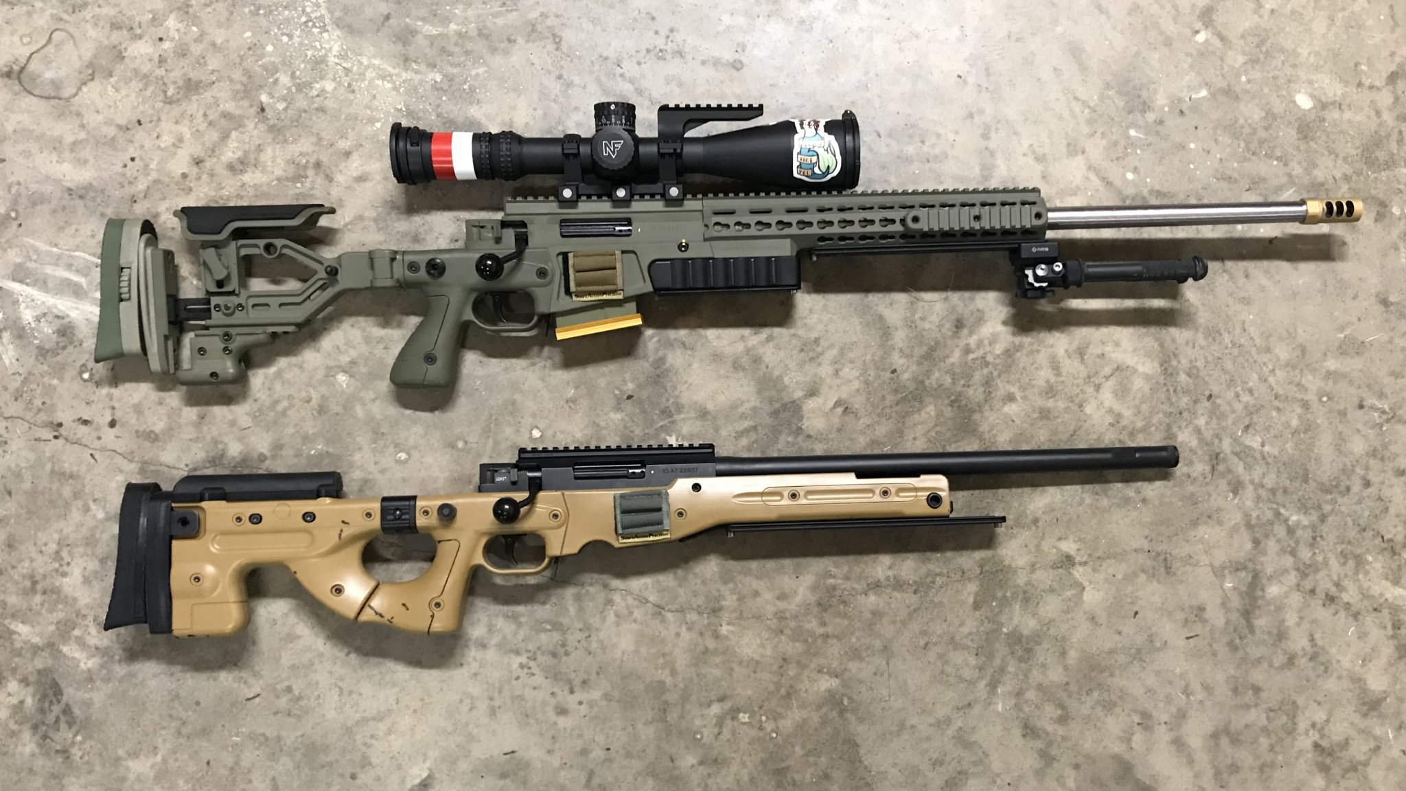

I still need a permanent optic for the AT. Thinking of another DMRii with the illuminated G3 reticle this time (didn't warm up to the H59). I just switched over to the NF Uni-Mount from the Spuhr and like it so far.
Love the rifles , What led you to owning both an AT and an AX?
I own an AXMC (338 lm) with a .308 conversion kit , im constantly eyeing an AT as my next purchase but I'm struggling to justify getting one besides that I really want it.
What has drawn you to having both ?

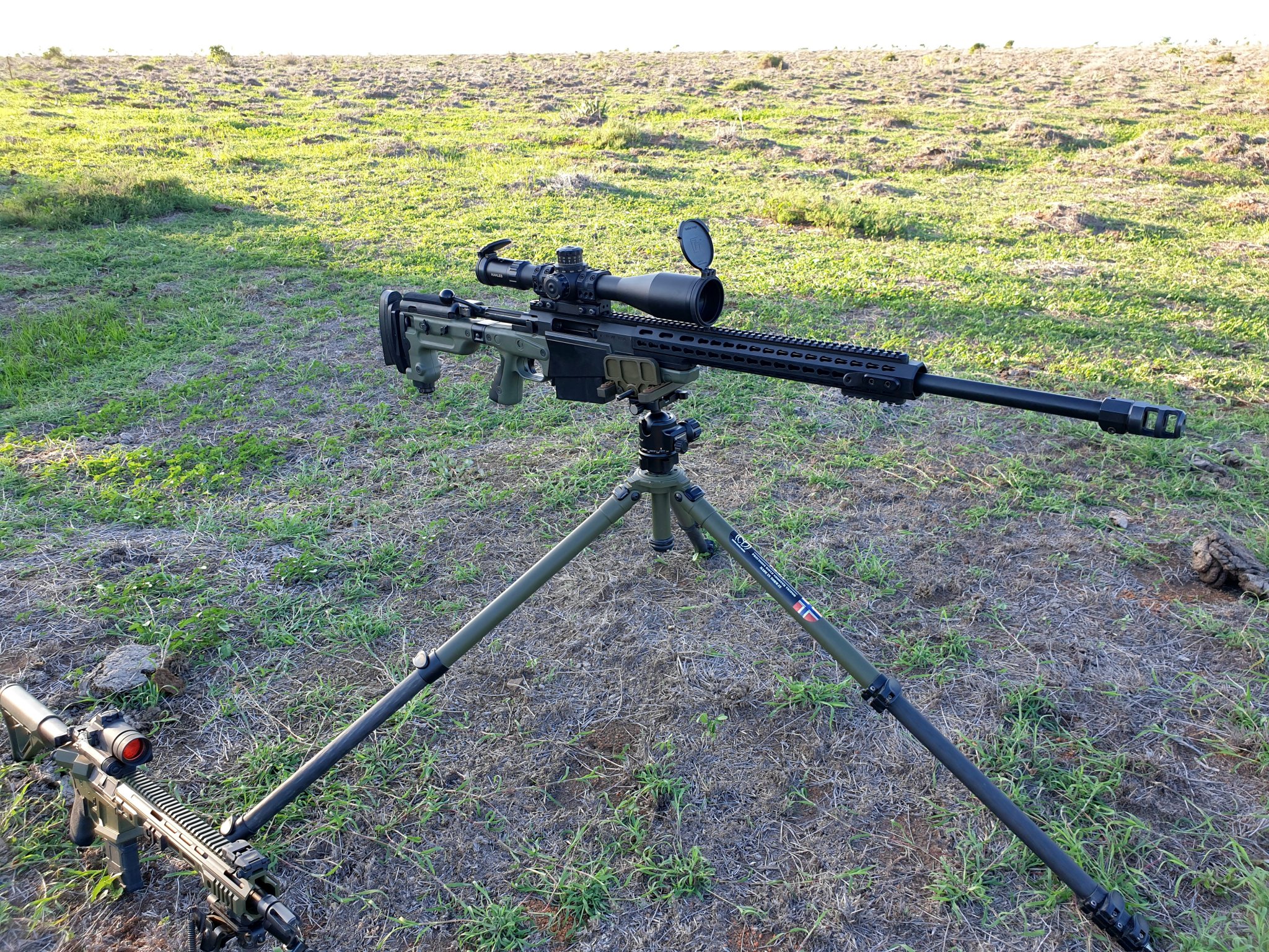

Finally got my Sage Green(best color followed closely by sand) AXMC in 300WM/ 6mm CM with the NF 5-25 ATACR mounted. Crappy pic but will add better ones soon.
Trying to decide on weather to do an Arca Swiss dovetail to put on the bottom or change the whole handgaurd to the Victor Company one that basically turns the MC into an AXSR from what I can tell.
If you are running either tell me your thoughts. Sawtooth or HRD would save a bit over the new rail. Planning to run a CKYE pod on it if it helps.
The balance point of the rife is just forward of the mag well. So if the primary intent of the ARCA rail is to tripod shoot, the RRS auxiliary plate will serve the purpose better and at a lower cost.
Reactions: deersniper
Seems like that's the case, thanks. I'll be putting a CKYE pod on it so having arca Swiss dovetail along the whole rail will be nice for PRS/NRL games. I'll probably the RRS plate on too, want to get a RRS tripod when funds allow.

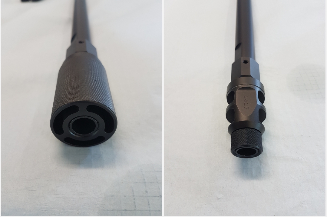

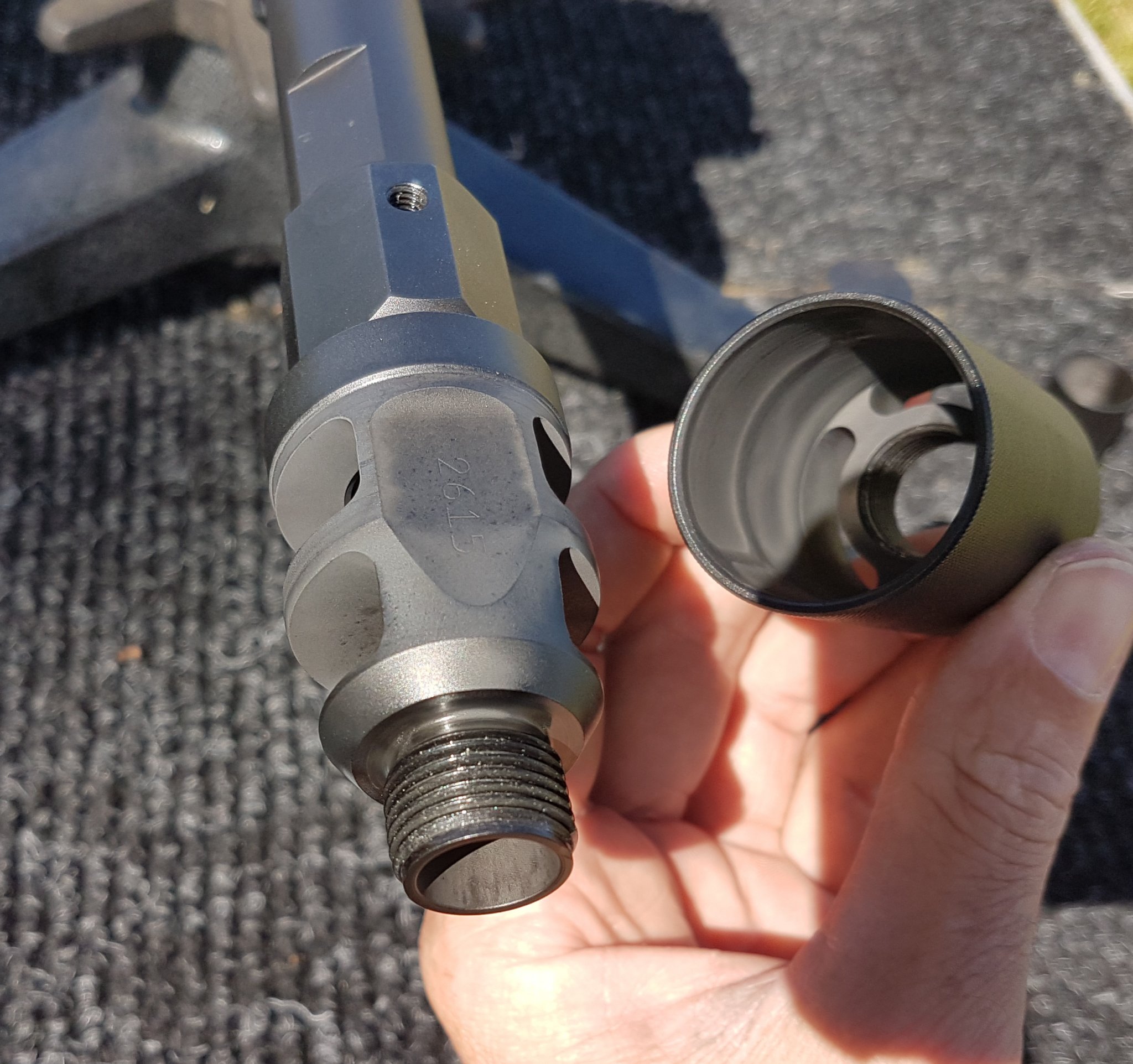

Some Ranges here don't like muzzle brakes, so instead of taking the brake on and off, I machined up a 'Blast Jacket' for the AI Tac brake.
Works well...
Some of us actually perfer to get some practice in with braked 50's going off in the next lane. If you can't shoot while being hit by muzzle blast then how can you if it was ever more than fk'n wind coming at you?

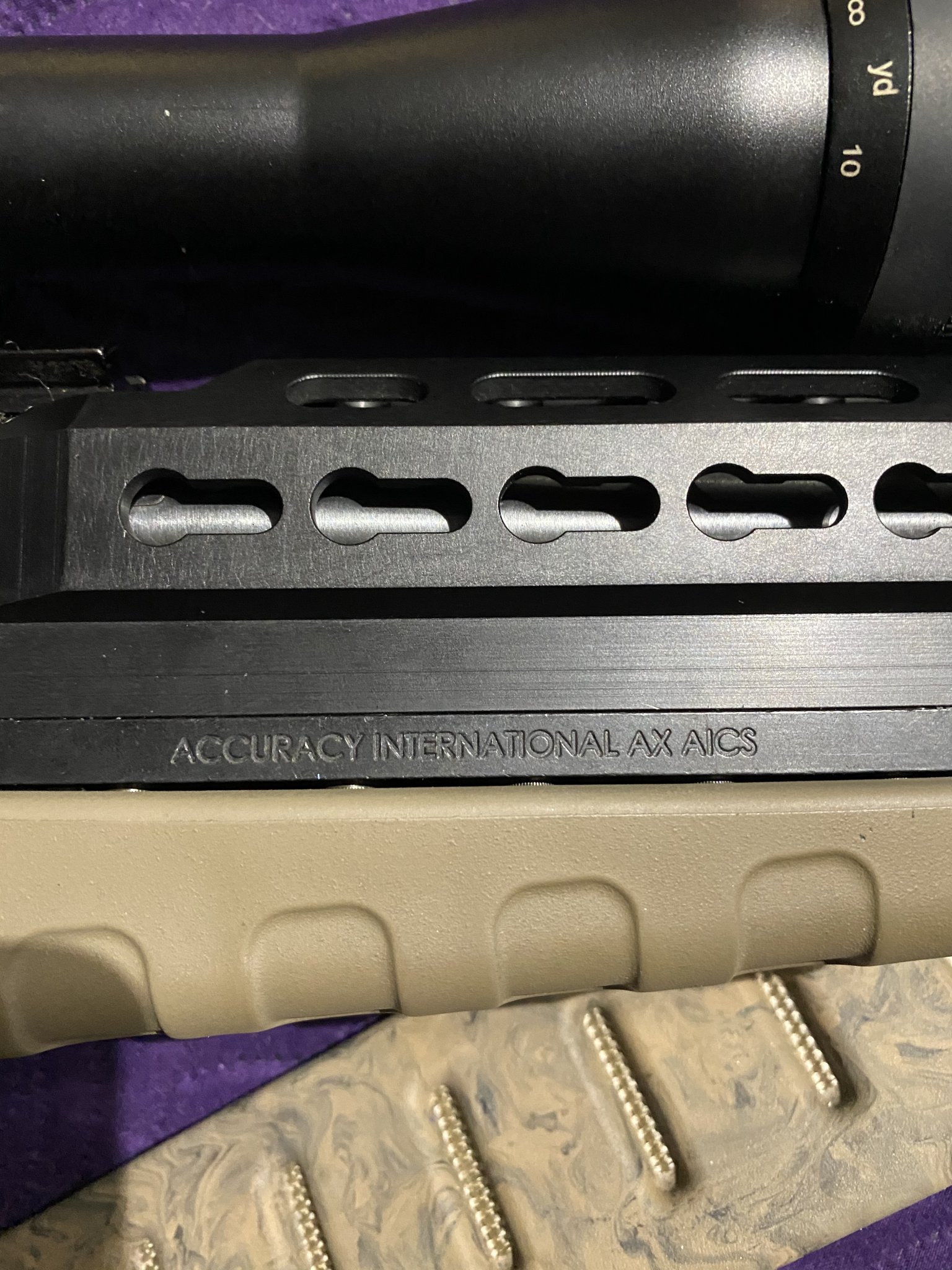

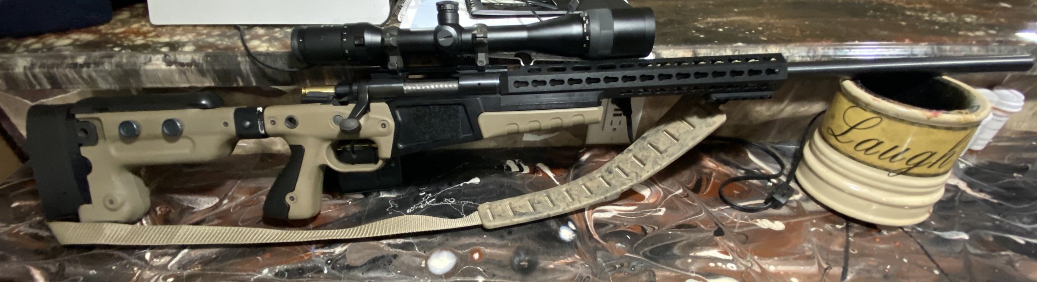

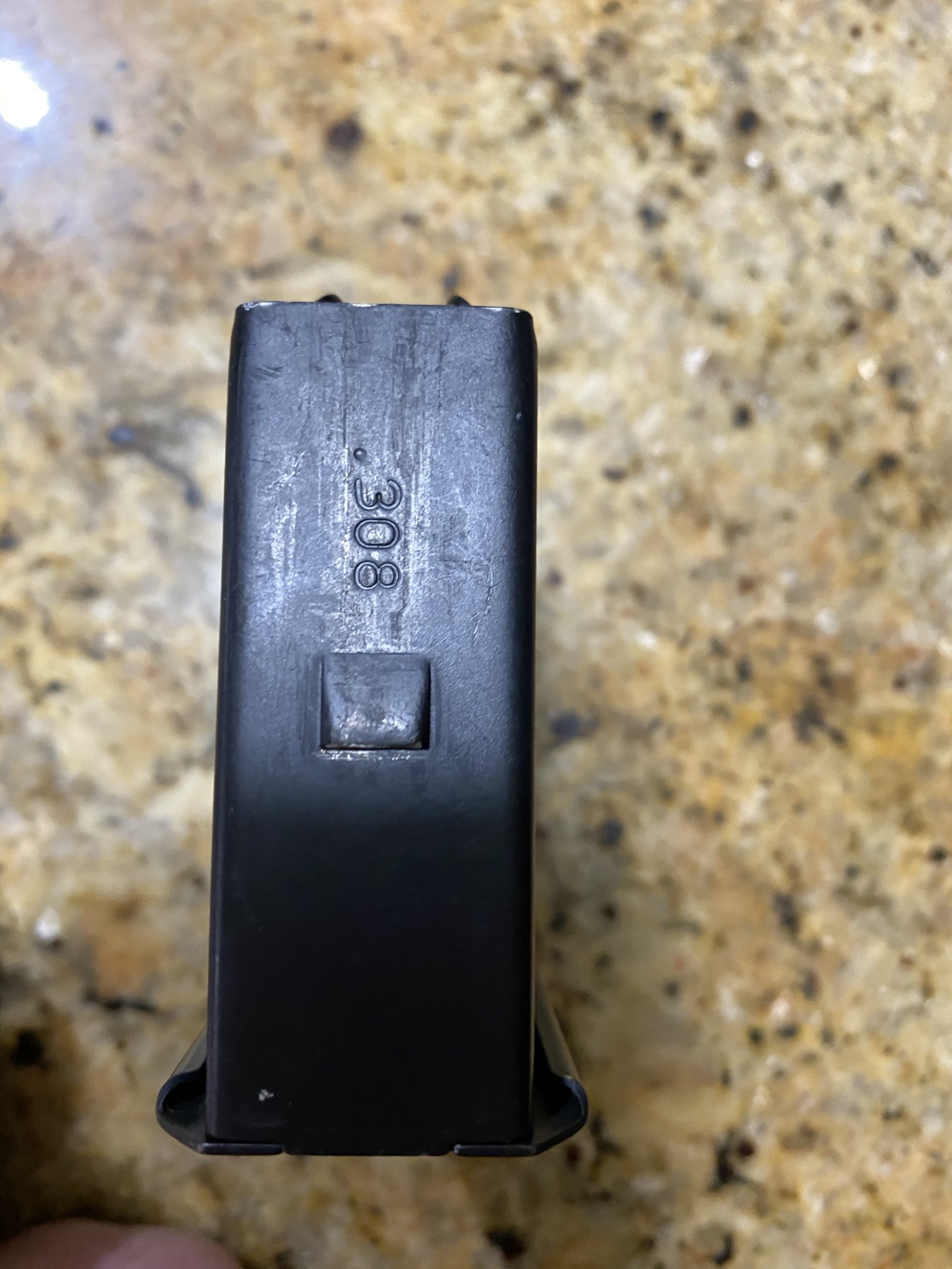

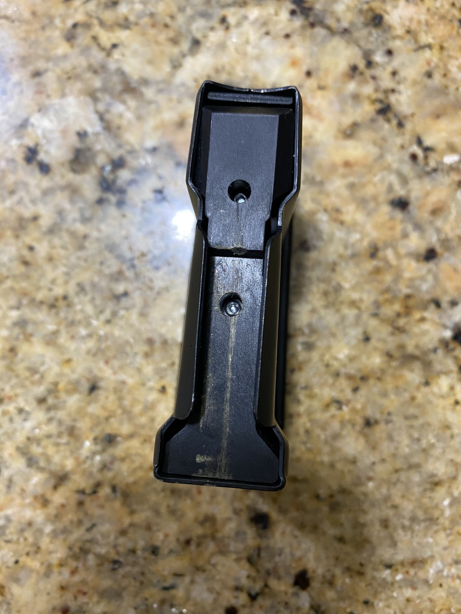

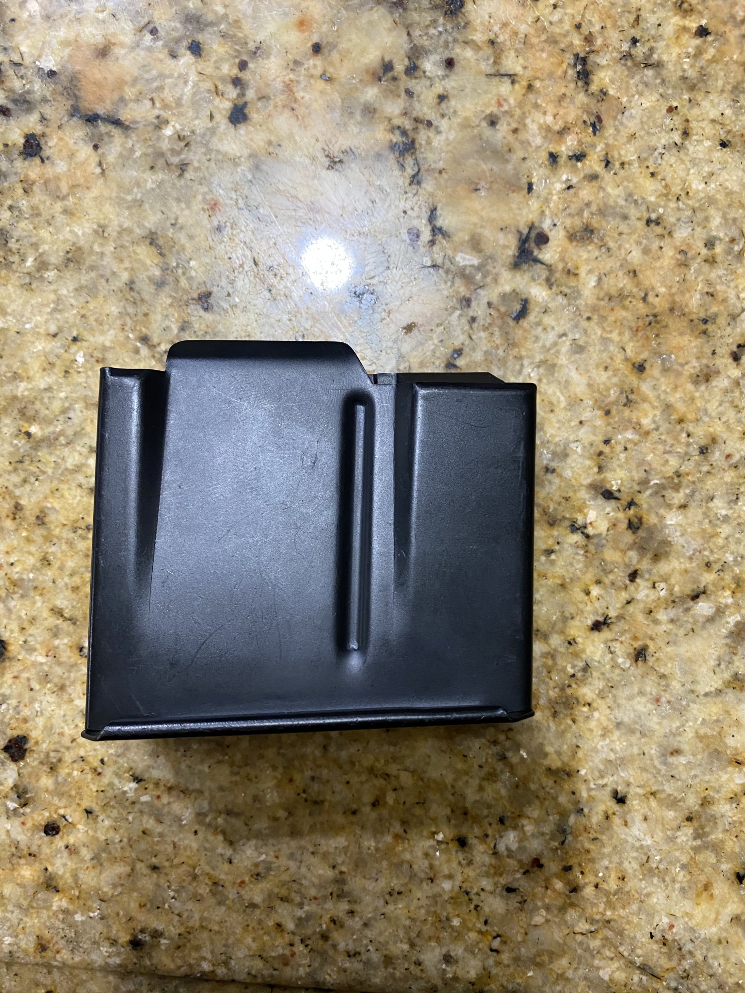

Ok question for everyone.... I received a AI MK13 MOD 7 stock, although it says AX on the mag well, and the guy put my Remington PSS 308 into it. Now when I go to load the magazine, if the bolt isn’t open, I can’t seat the magazine. If I open the bolt, mag seats fine, but doesn’t seem to cycle properly, some of the rounds seem to get hung up. Is there a certain mag I need or is there another issue? Thanks in advance... btw, just to let you know, I’m a border line functioning idiot, so be gentle...
picture of magazine?
The Remington PSS, Police Sniper System, it is not a long action .308.

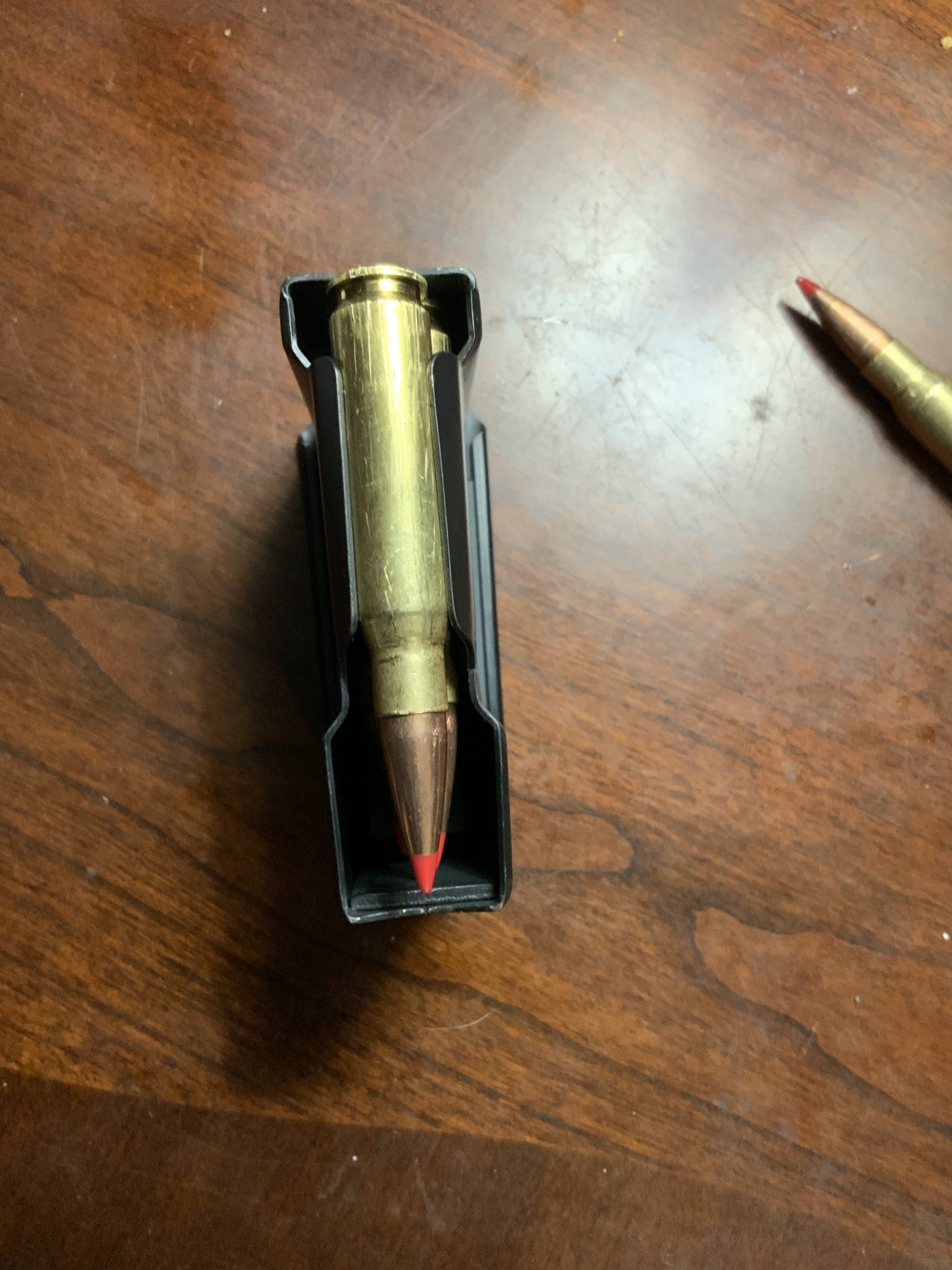

Do you have a part number for the magazine? I don’t see a part number on my magazine, other than 308
mk13 is for long action. im not familiar with what a pss is, but is that a long action chambered in 308?
That’s what I thought as well as far as long action, that’s why I was curious when he said it would fit the .308, but he’s an armorer for the Marines and has worked with their snipers weapons at Quantico plus he’s built rifles so figured he know a heck of a lot more than me.... which he does regardless
So is that a short-action stuffed in that long-action AICS 2.0 (Mk13 Mod 7)? I mean how would it even mount? I think the hole spacing is like .9" different.
On my phone right now and I can’t seem to zoom in.
So is that a short-action stuffed in that long-action AICS 2.0 (Mk13 Mod 7)? Pretty sure that’s not going to work out if so.
That’s what I was told, the action and barrel are from my Remington PSS .308 that he said would fit, when my son brought it back to me and I tried to load the magazine, that’s when I noticed the issue. I’m actually questioning whether or not it is actually a MK13 Mod 7 as all the pictures I see of that chassis, they are all tan all the way through and as you can see, mine is not. Any advice on how an idiot, myself, would be able to tell? Thanks
View attachment 7241686Looks like you just have the added tool less thumb screws for the cheek piece.
Thank you, so do you think if I get an AI AX AICS 7.62/.308 5rd. MAgazine 6852, it would fit and stop my issue where I can’t load the magazine when the bolt is closed? Thanks for all your help... looks like I’m going to have to have a discussion with someone over the misrepresentation.... Sorry about the bigger font, don’t know what happened
Are the magazines you posted 5 rounders as well and do they all do it? Wondering if the mag catch has been shortened for whatever reason or the feed lips have been bent/tuned and they just aren’t jiving with what you got. Hard to tell without being able to handle and see it. I’d say take it it someone else that is well enough versed in this stuff because I don’t think your guy is it.
I have some magpul Pmags and they do the same thing, i Only have 1 metal AICS MAG and it’s a 5 round... here’s a pic with rounds in it

That's not his problem. All the AX mags do is add a front attachment point, but are otherwise identical to standard aics mags....and standard aics mags work fine in AX chassis. I'd still like to see the bottom of the magwell as there may be something else going on, but it's probably a mag latch issue...may just need a couple strokes of a file....sounds like the mags aren't able to insert far enough in to engage the latch with the bolt closed....shaving it down ever so slightly would allow it to engage sooner.
Reactions: trob_205
Ok now we’re getting somewhere lol. I was under the assumption there was enough difference to cause issue but I shoulda known with my AX using AW mags just fine. My only experience with AICS stuff is with a legacy 2.0 chassis.
