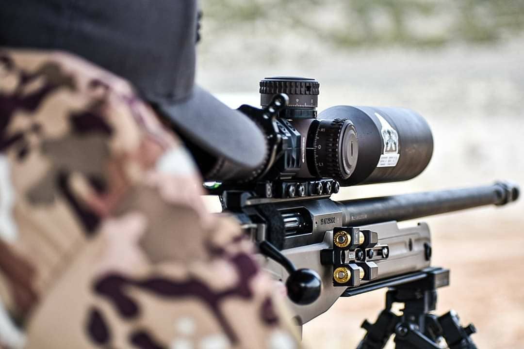

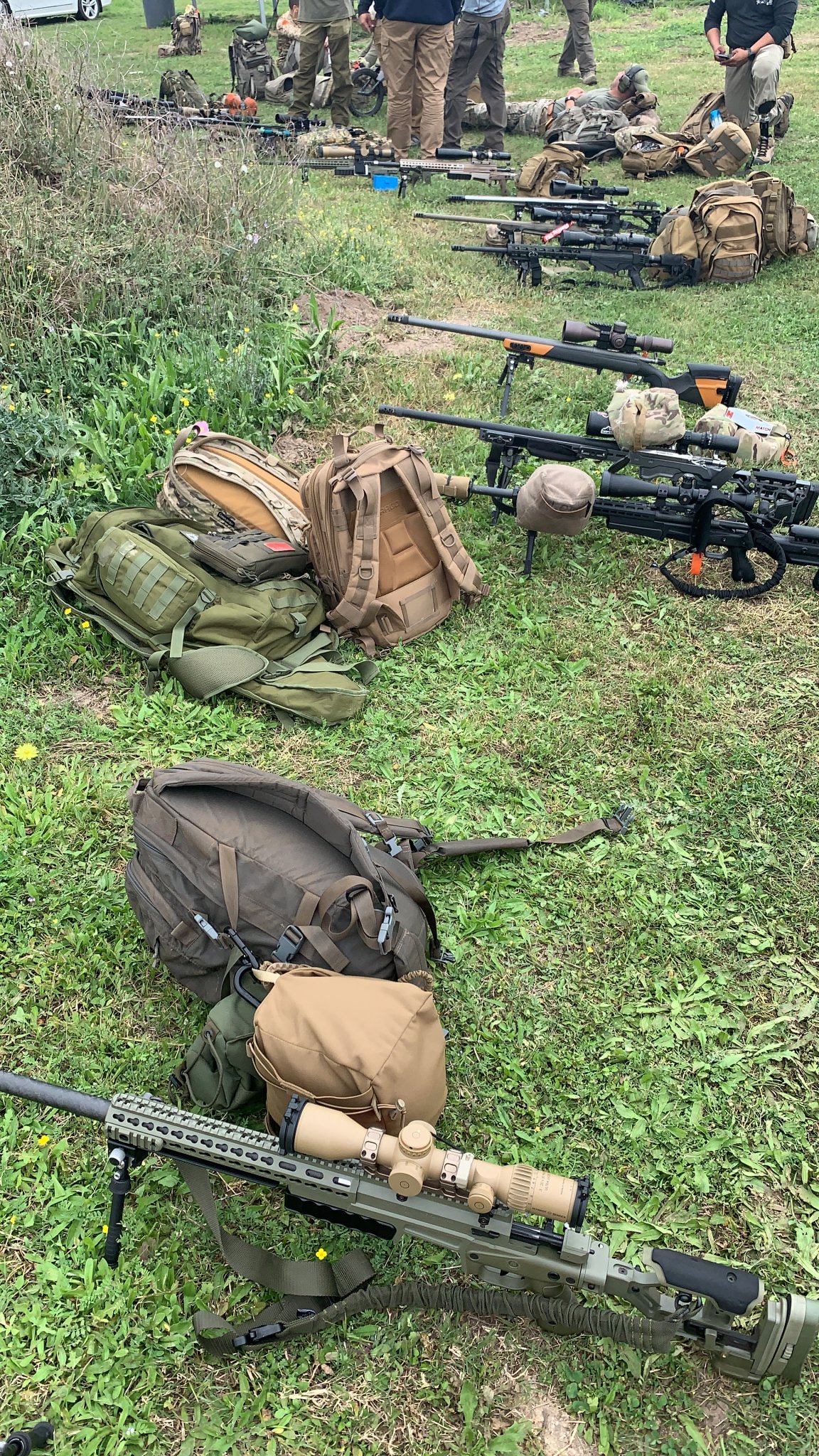

Some pictures from the match over the weekend here in Utah.

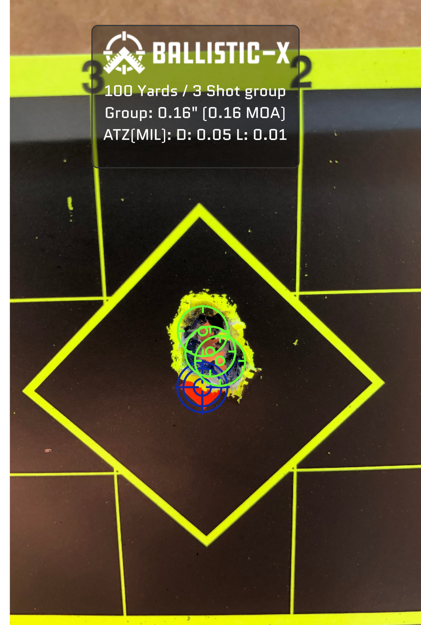

Proof Carbon Fiber 24” 6.5CM Prefit shot well. Berger 140gr factory ammo was running 2820fps. McCourt 30rd Test Series w/ 140gr VLDs was 2810-2830fps.

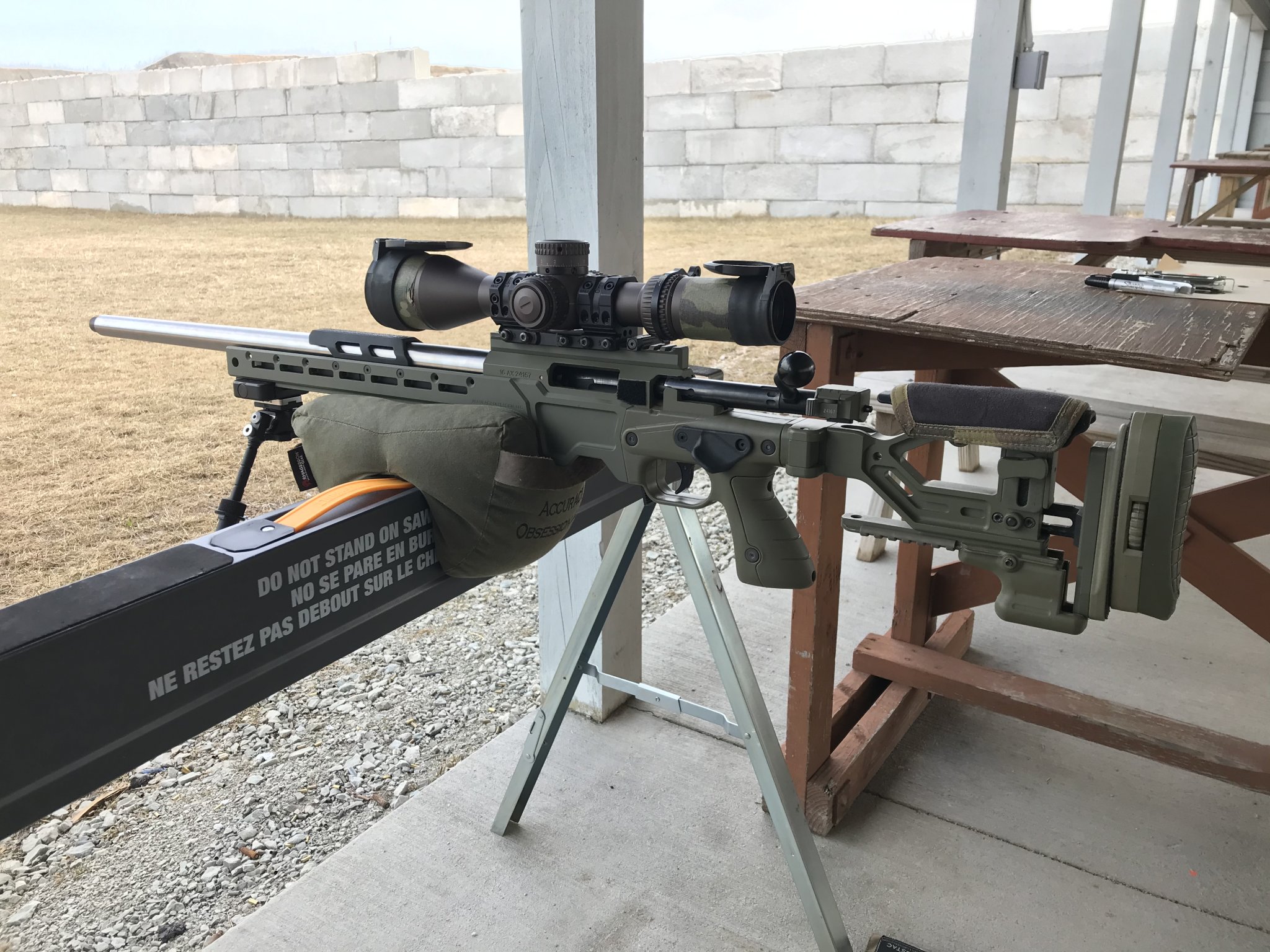

Man I wish mine was that easy the first time out haha. Very nice

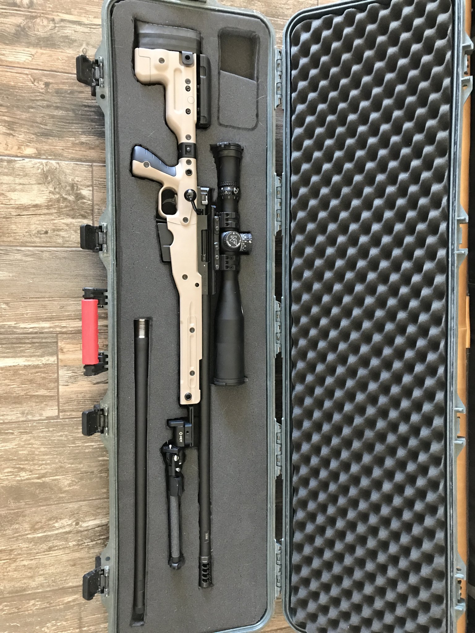

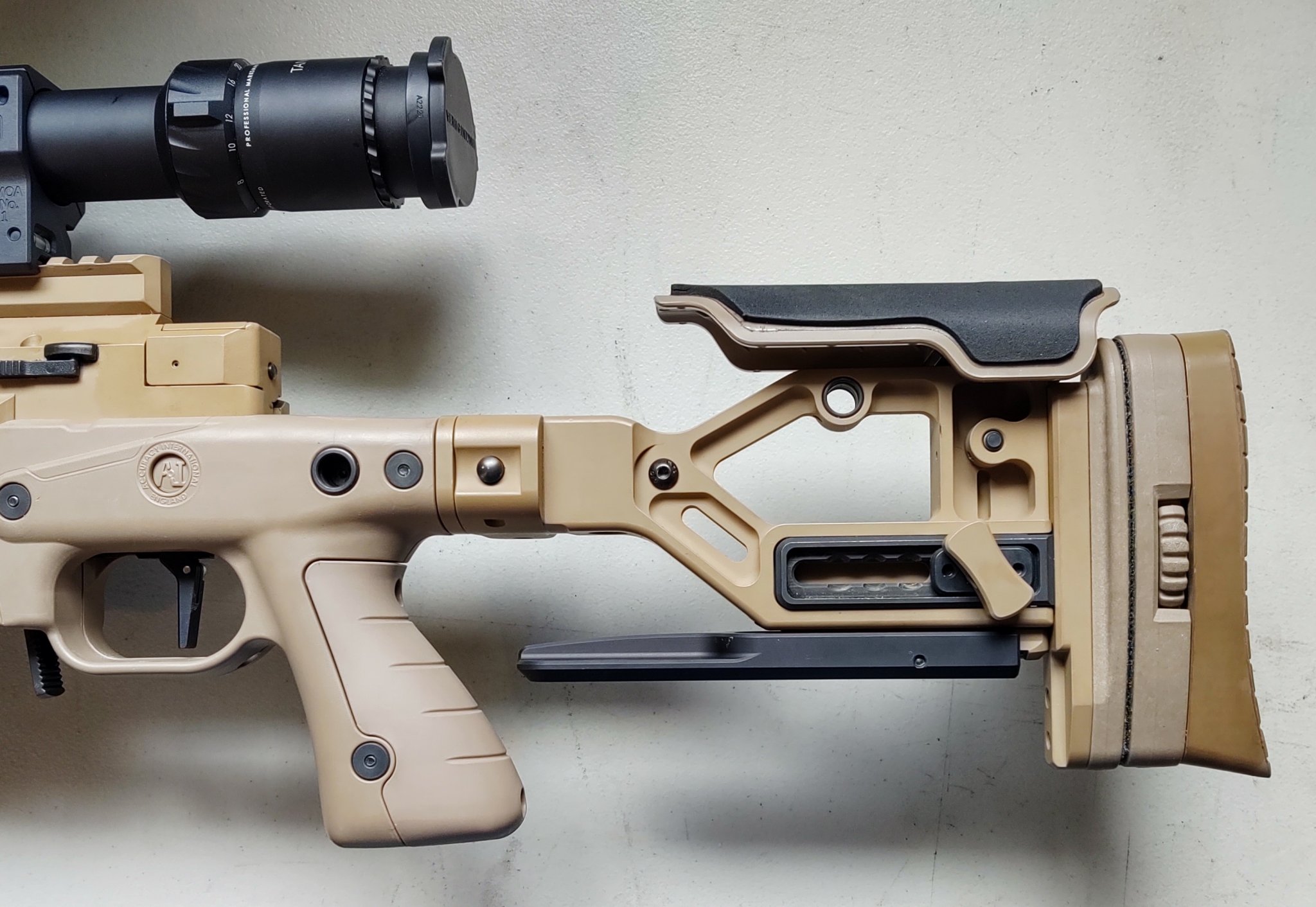

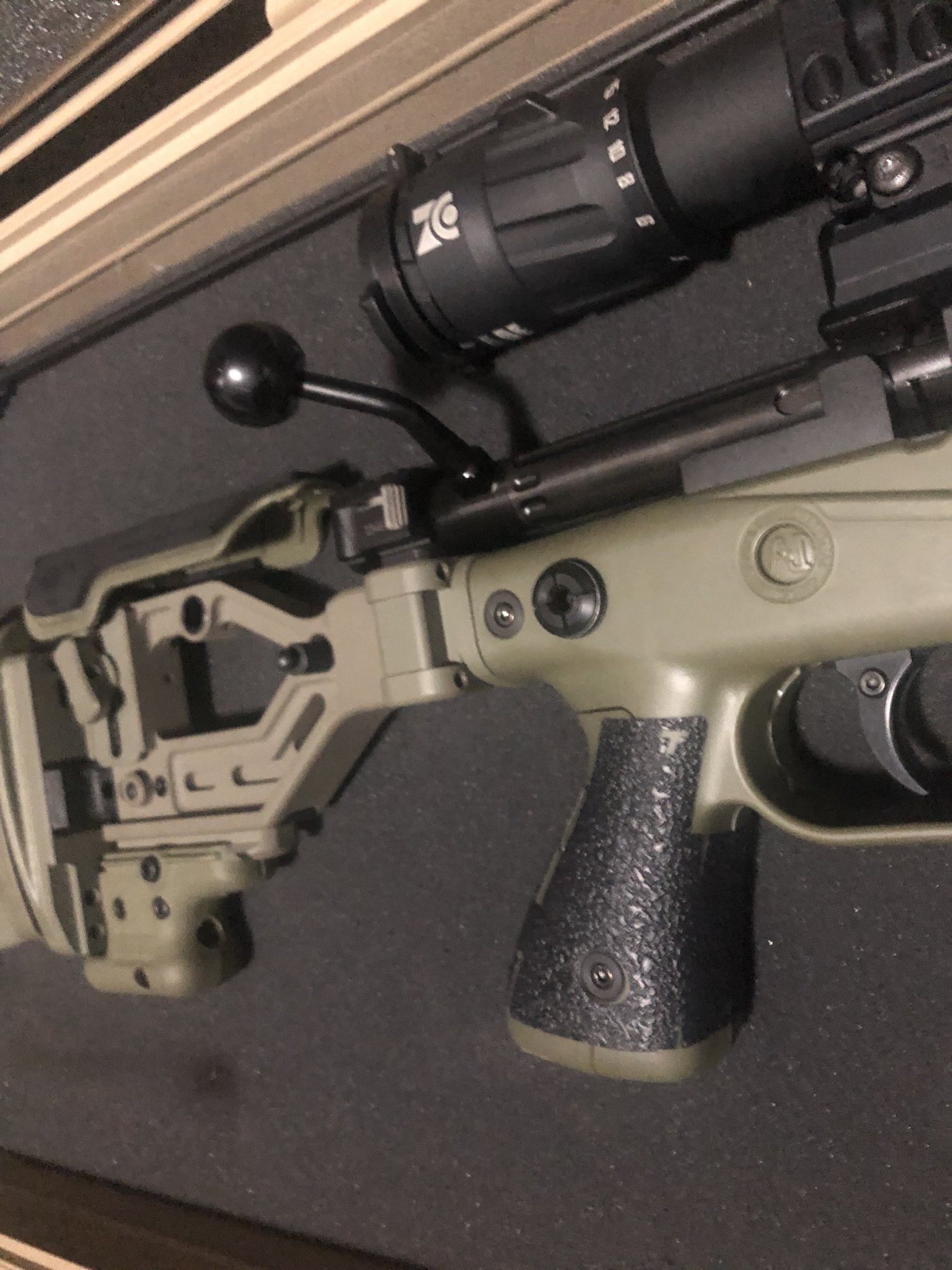

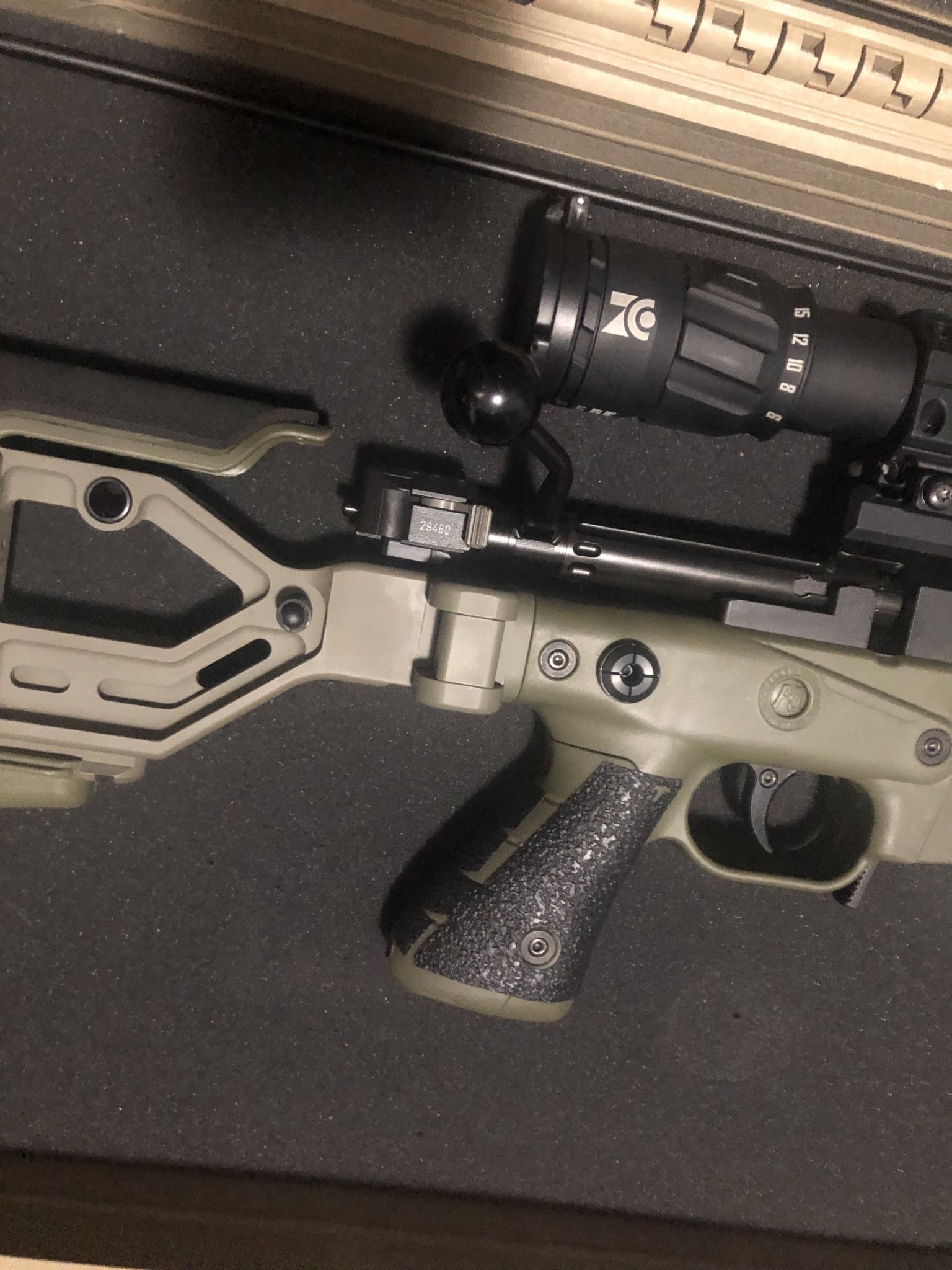

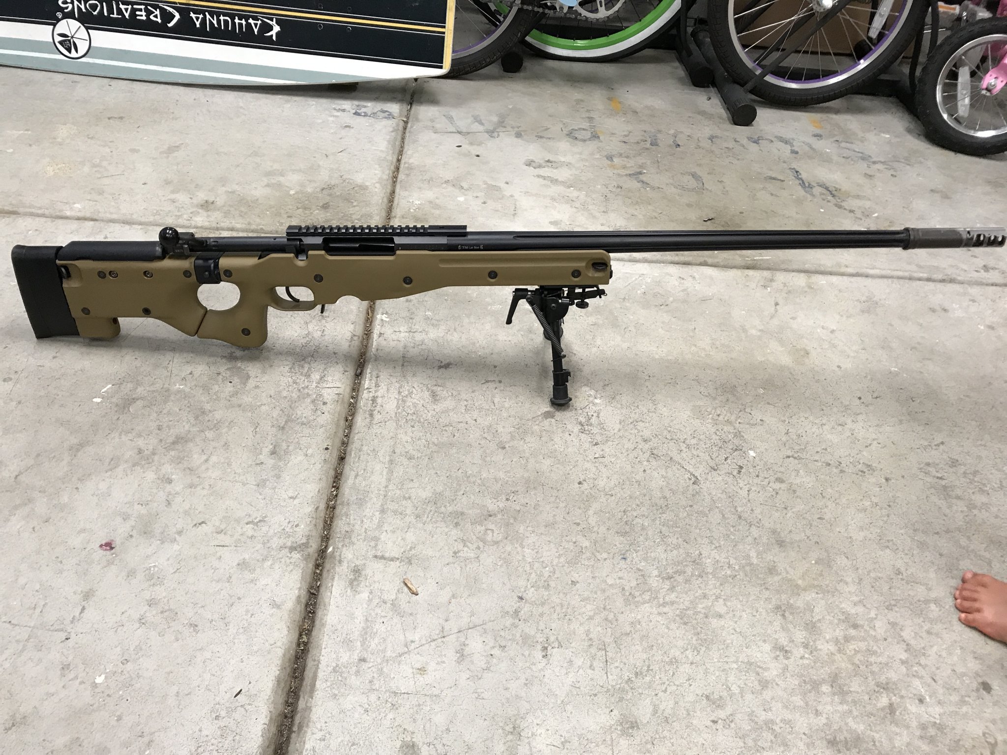

Does anyone have the Talon grips on his AXMC? Care to share some pics?
I'd like to pimp the pistol grip (as far as possible.. )
Found these pics in a folder. So here ya go.
