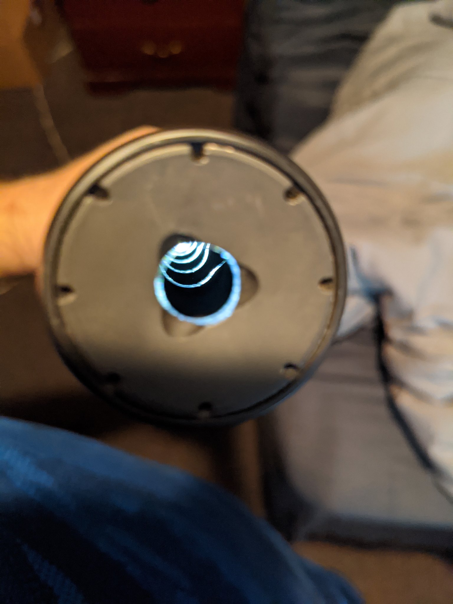

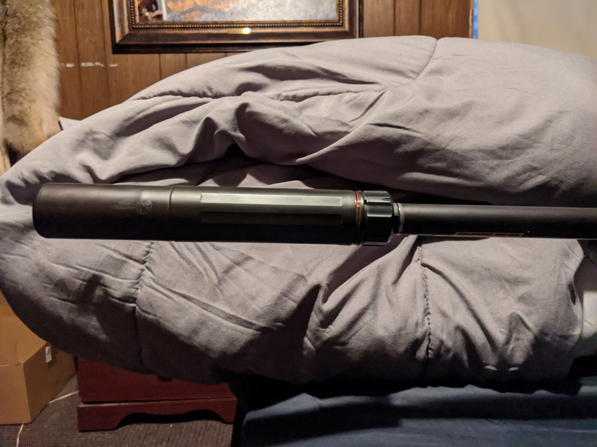

I am new to the suppressor world. I recently got a sand man L took it out and tried to sight it in was all over took the can off and in the picture the 3 top shot were with no can( I'm not a professional shooter) put the can on and the two lower shots were the first two shots the next two shots didn't hit paper. Was at a range at 100 with a lead sled. I am shooting a bergara 300 win mag with hornady precision Hunter 200 grain eld-x factory ammo. Any advise on what could cause such a drastic change would be much appreciated.

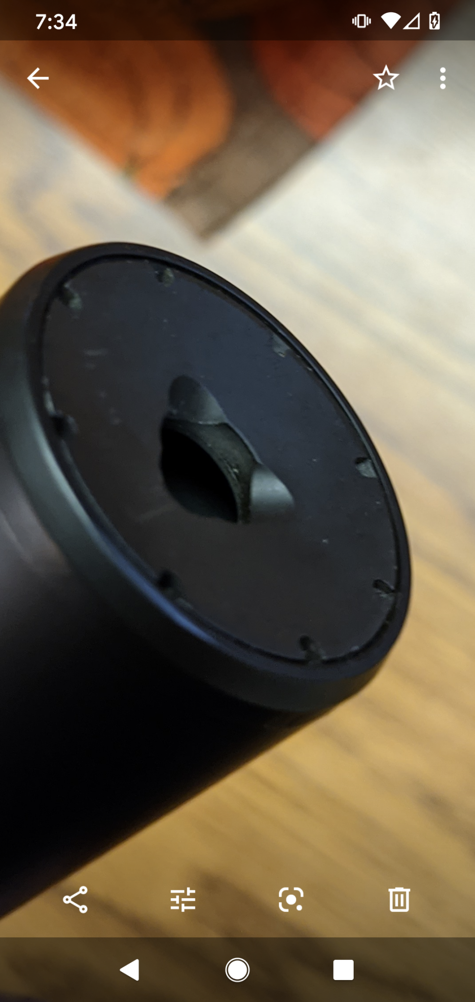

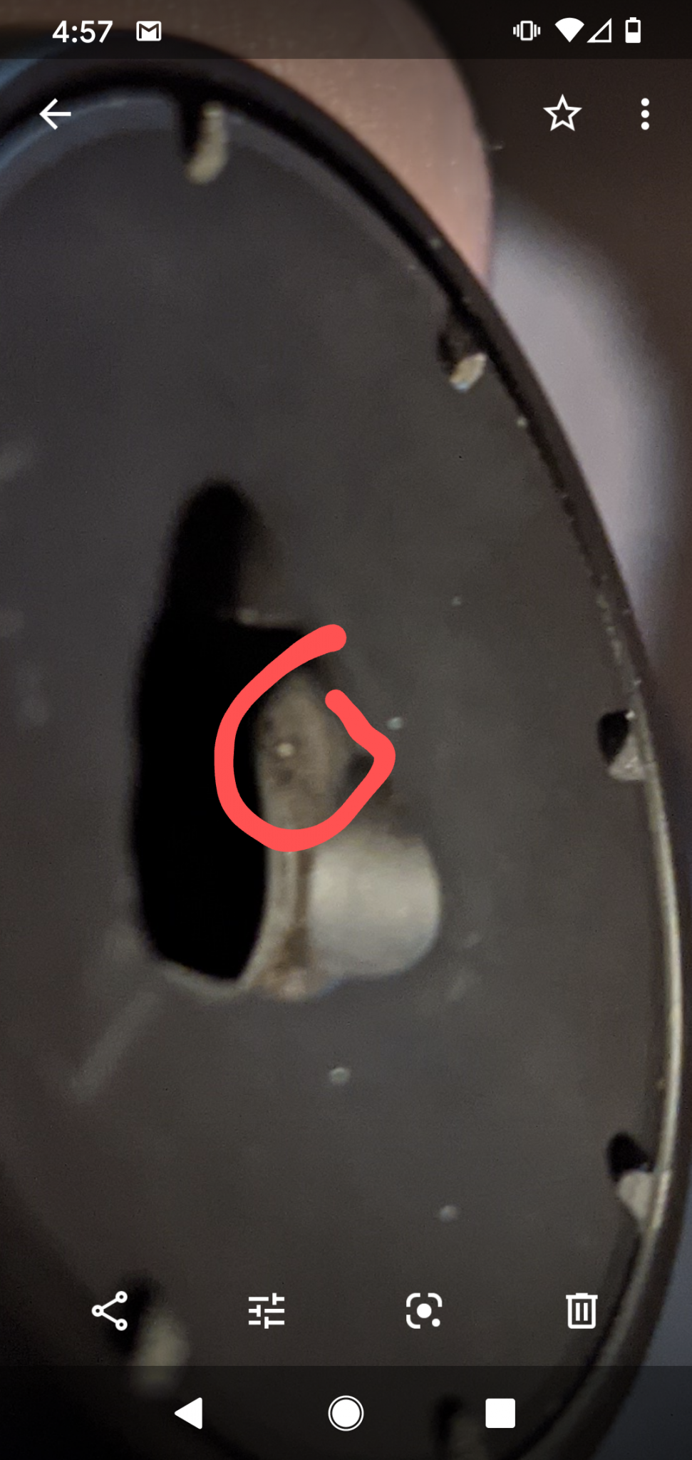

Kind of hard to get a picture of but there is a little dimple on the end cap and looks like a bit of a groove can only see on the last 4 baffles is this similar to what you saw with the glancing issue on yours or am I seeing things?

I just checked all of the cans and none of them have a mark like that. The photo is a bit out of focus but it might be a strike. I had strike from a bad brake, dead air made it right and painted the can (burned off doing full auto)...for free.
This looks like a strike... Have to verified the supressor/mount/barrel thread alignment with an alignment rod?
I just ordered an alignment rod Friday night waiting for it to show up so I can verify. I have been in touch with dead air sent them the pictures as well will hopefully hear back from them and get the rod soon so I can verify.

From the pictures you provided I think those Notches are normal. My saker has similar notches in the first couple of baffles. Still worth looking at alignment. Like I mentioned, I changed mounts and adapters on 2 of my rifles and it fixed the issue. Nothing visible on the end cap. Hope DeadAir can help you figure it out.

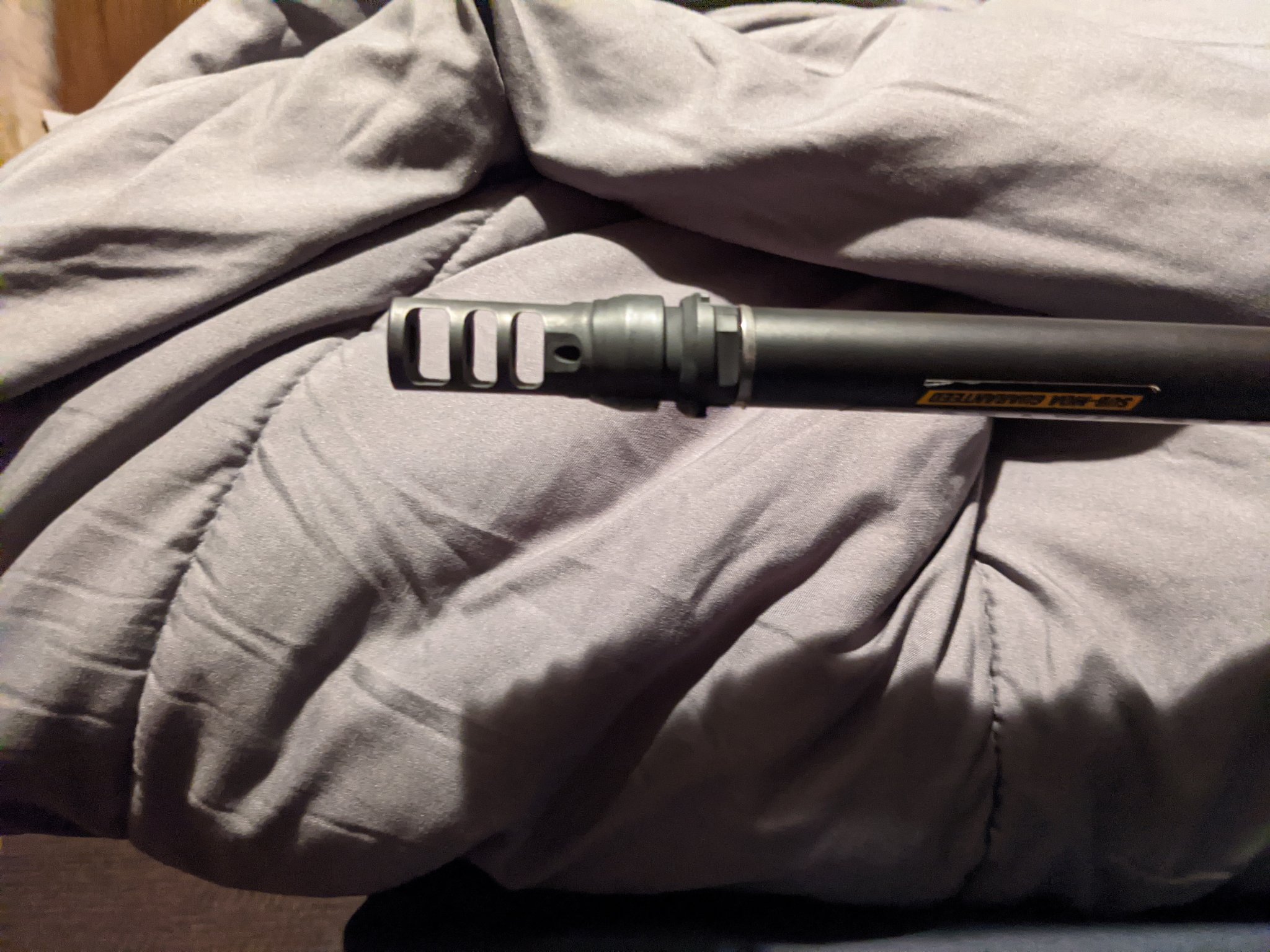

Post a pic from the side of your brake then with the can mounted up
The keyhole notches in the baffles are normal as it had been stated several times already. The small clip inside the end cap he posted does not look normal though
That is the same mount I had problems with (the Dead Air mount for the saker.) The Silencerco mount sucked. I launched my can down range once due to a Bad lock up. I changed to the 51T ACC tri tip flash suppressor and adapter and that fixed it. YMMV.
