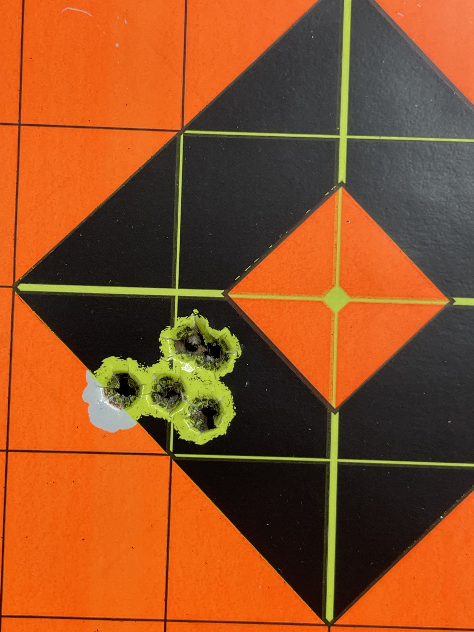

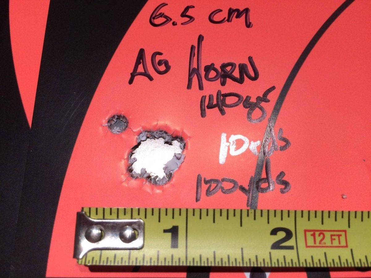

FWIW, my Criterion 22" RLGS has been a fine barrel. I don't know what kind of magic Criterion did to that specific barrel... but..
I should add, that I lapped the upper receiver face flat, and Loctited the barrel in place, I also made the fit between the upper and lower snug.
G SSA-E trigger.
It doesn't shoot every factory load this well, but it sure likes the Horn. 140gr American Gunner.
I did the flier, I got to giddy.

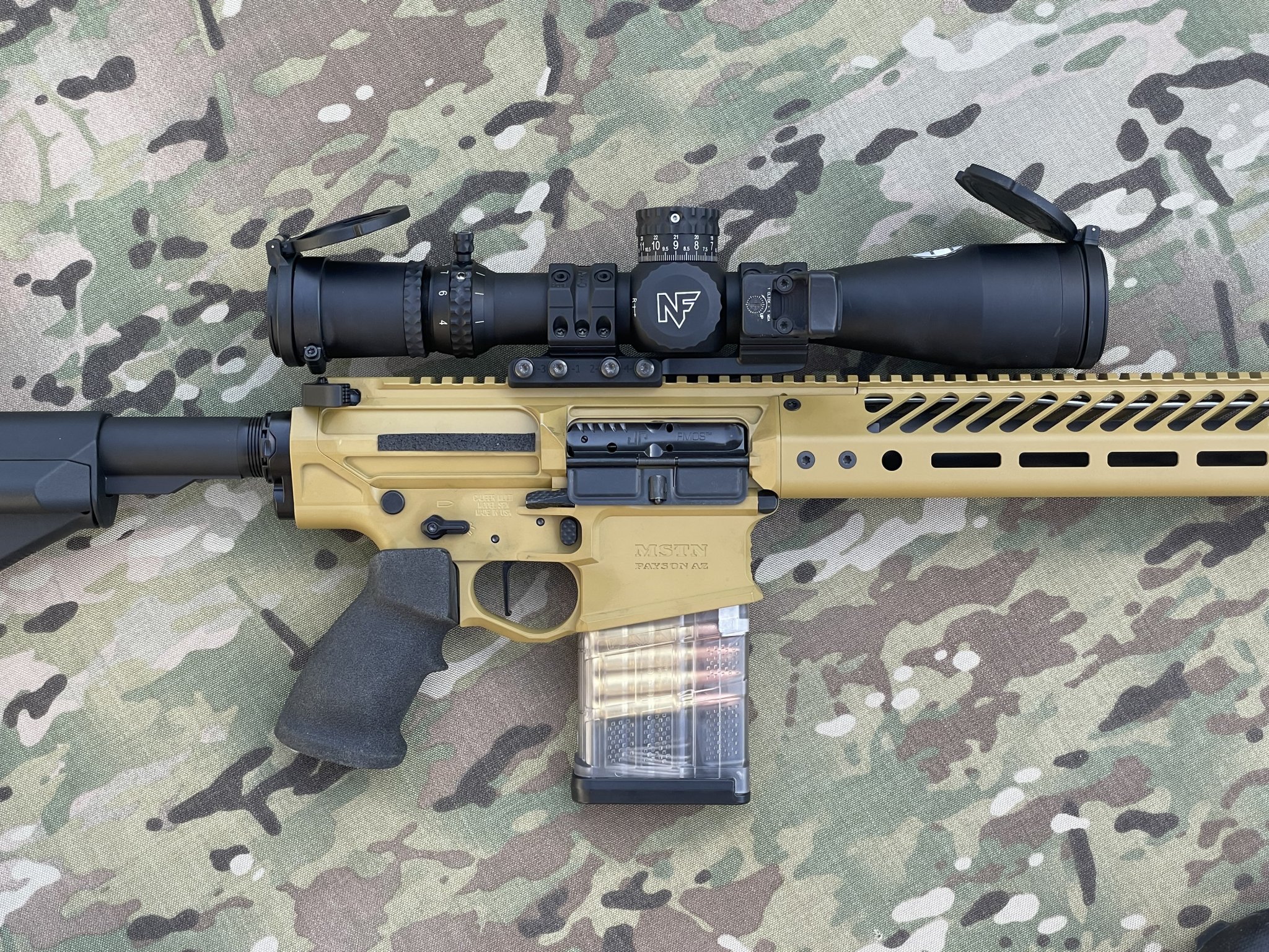

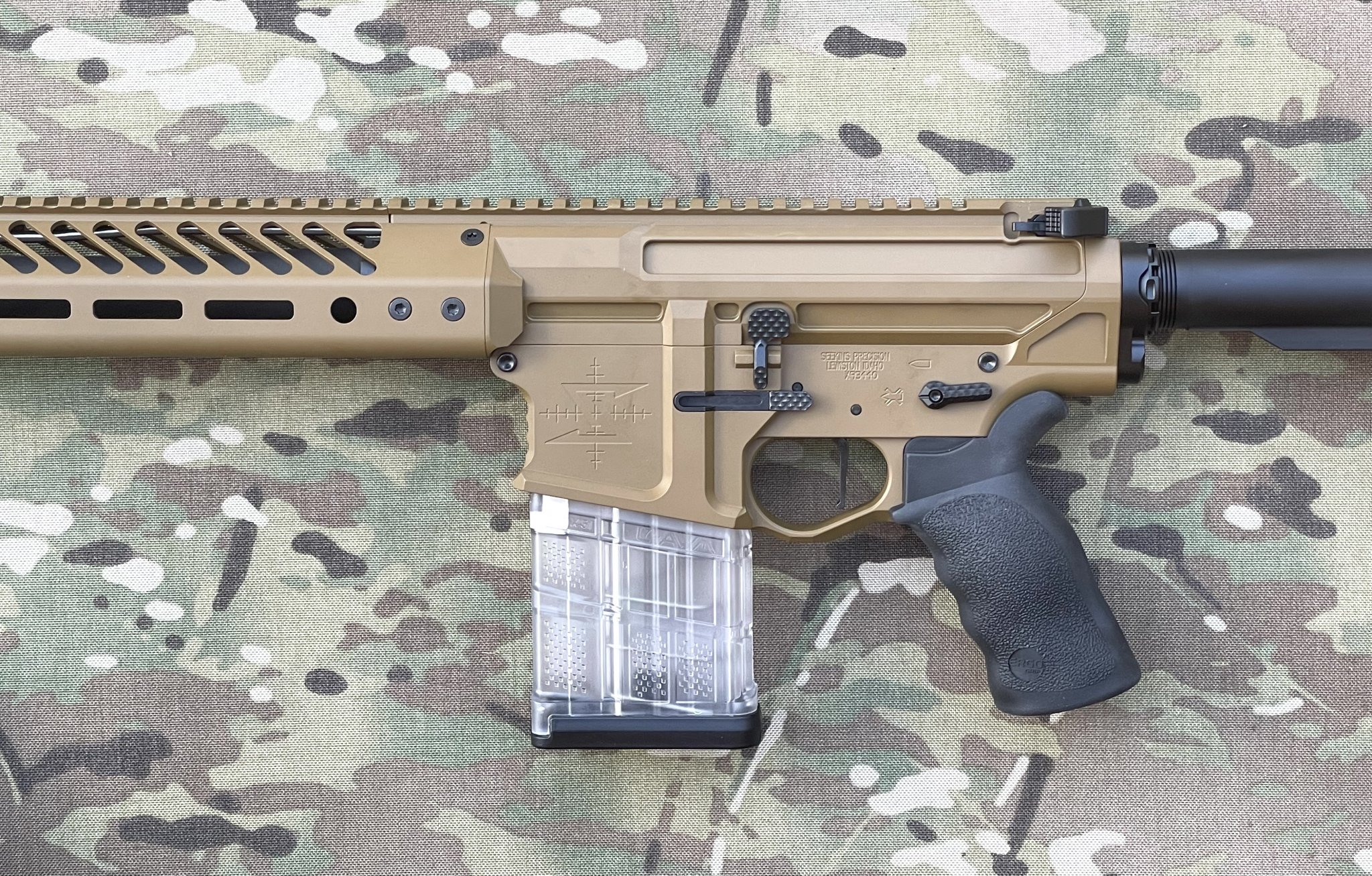

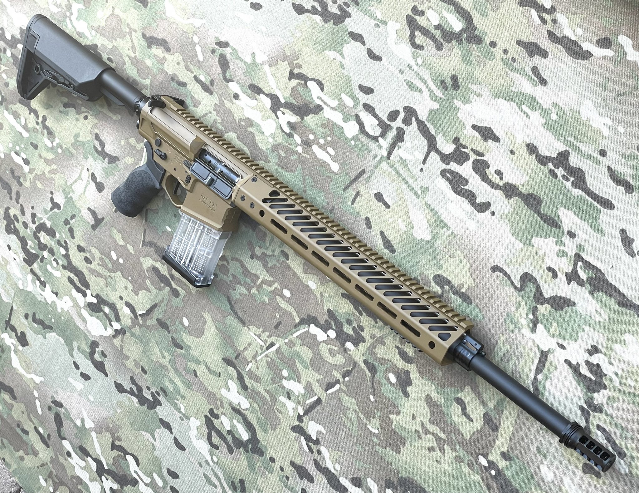

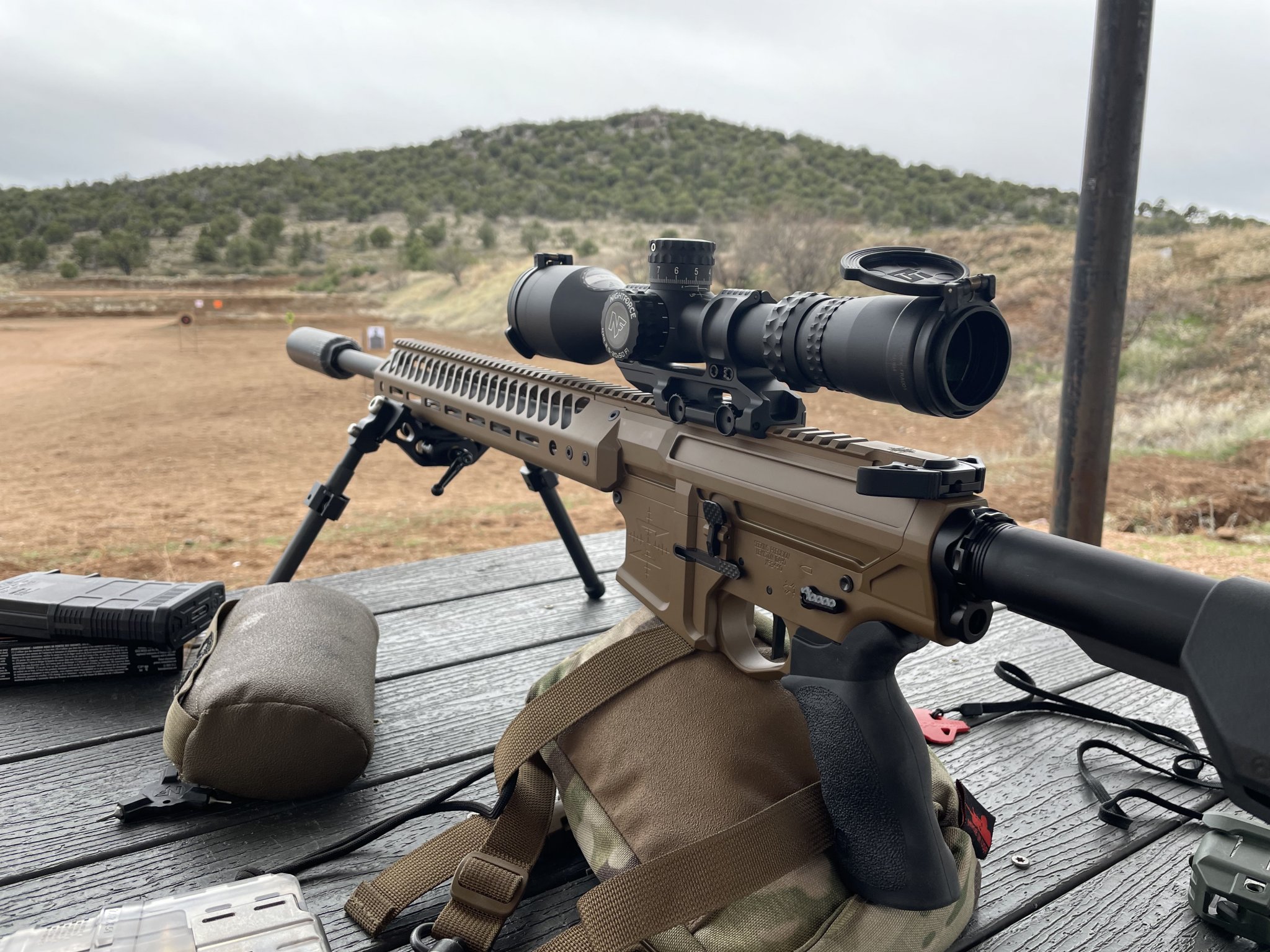

This is my own 20" SS Proof 6.5 CM. It's reliably sub-MOA with good factory ammo. I'm shooting Federal GMM 140 right now, which chrono's at 2702 FPS.
You can get a 20", 22", or 24" Proof SS with Rifle + 2" gas system for $649.
I'd be extremely leery of a barrel with a rifle length gas system in this caliber.
I like the JP FMOS (Full Mass Operating System) bolt carrier group with high pressure bolt.
This is my own 20" SS Proof 6.5 CM. It's reliably sub-MOA with good factory ammo. I'm shooting Federal GMM 140 right now, which chromo's at 2702 FPS.
View attachment 8367207View attachment 8367209View attachment 8367211
Beautiful gun man! I'm not sure if I'm gonna like the cerakote finish on the set I'm getting but I couldn't pass up the price.

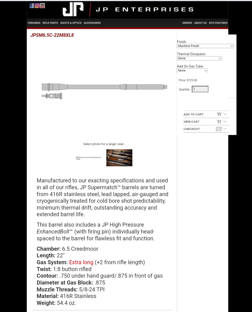

I've just skimmed through this thread, so sorry if this has already been discussed.
With a $750 Barrel budget you have several excellent options..

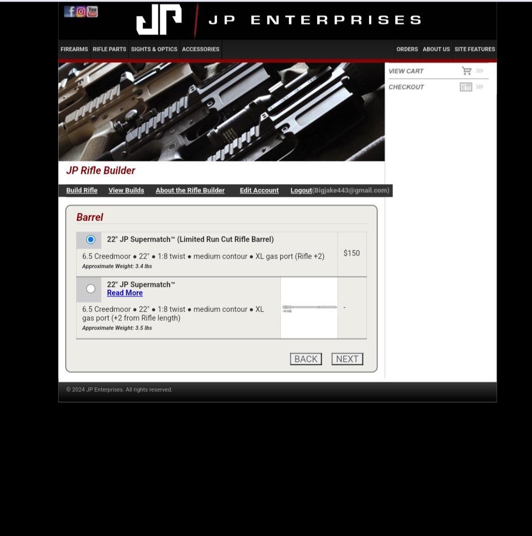

For off the shelf barrels you are well and truly in the JP barrel Price range, thier in-house 6.5CM barrel are exceptional shooter's that come with the best HP bolt on the market.
JP Enterprises also offers Single Point Cut Rifled barrels for an additional $150.00 ( IE. Like Bartlein or Krieger) that receive the same Cryogenic treatment as thier in-house barrels do but you have to purchase them as a Barrel Kit, which once you take into consideration they provide a perfectly timed and Blended muzzle brake and adjustable gas block the $1,150 price tag isn't that bad.
I would stay far away from Proof Research or Rainier Ultramatch, if you do a little digging on here you can see why.
And if you want a guaranteed Sub 1/2 MOA Barrel I'd send @TheOE800 a message about his 22" Bartlein, it's definitely your most accurate barrel option and I know this because I designed it.

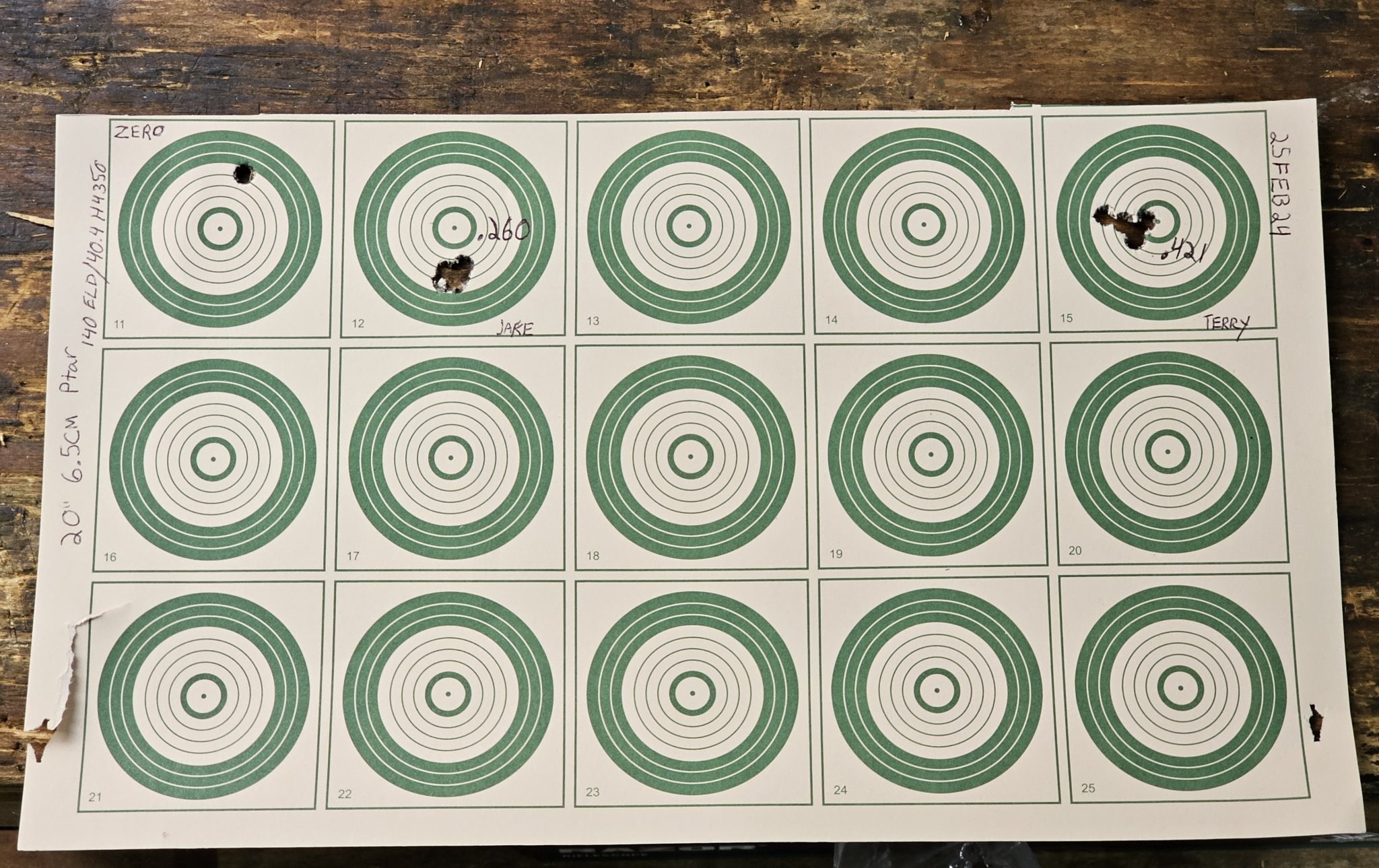

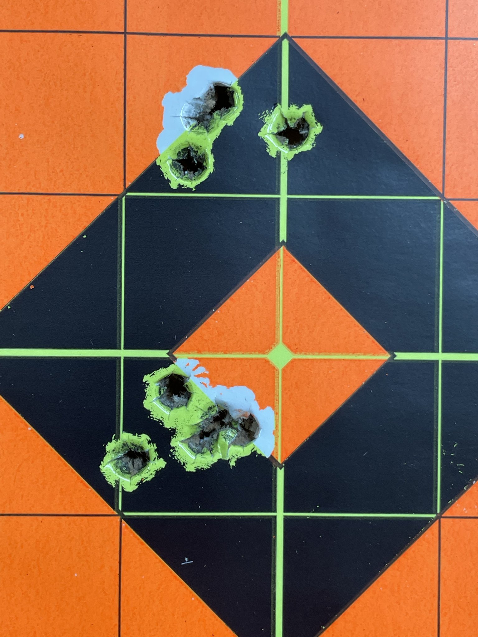

Here are two Proof Groups from the Last 20" Bartlein I just Finished. This is with 140 ELD's / 40.4grs of H4350 / Lapua SP Brass / CCI BR4 Primer / Seated at PMag Length.
I shot (1) round to check Zero and make adjustments then shot a 5rd group, After my group I handed the rifle off to my 70 year old Father In-law who has only shot a Large frame Gasser a handful of times and he easily printed a Sub 1/2 MOA 5rd group.
From your OP you mentioned factory ammo? If you unfortunately have no means to reload you won't see the full potential of OE800's Bartlein barrel.
If you are going to run 100% Factory Ammo the JP standard in-house barrel is what you want, they will group just about any Hornady 6.5CM Ammo at .75 MOA or less.

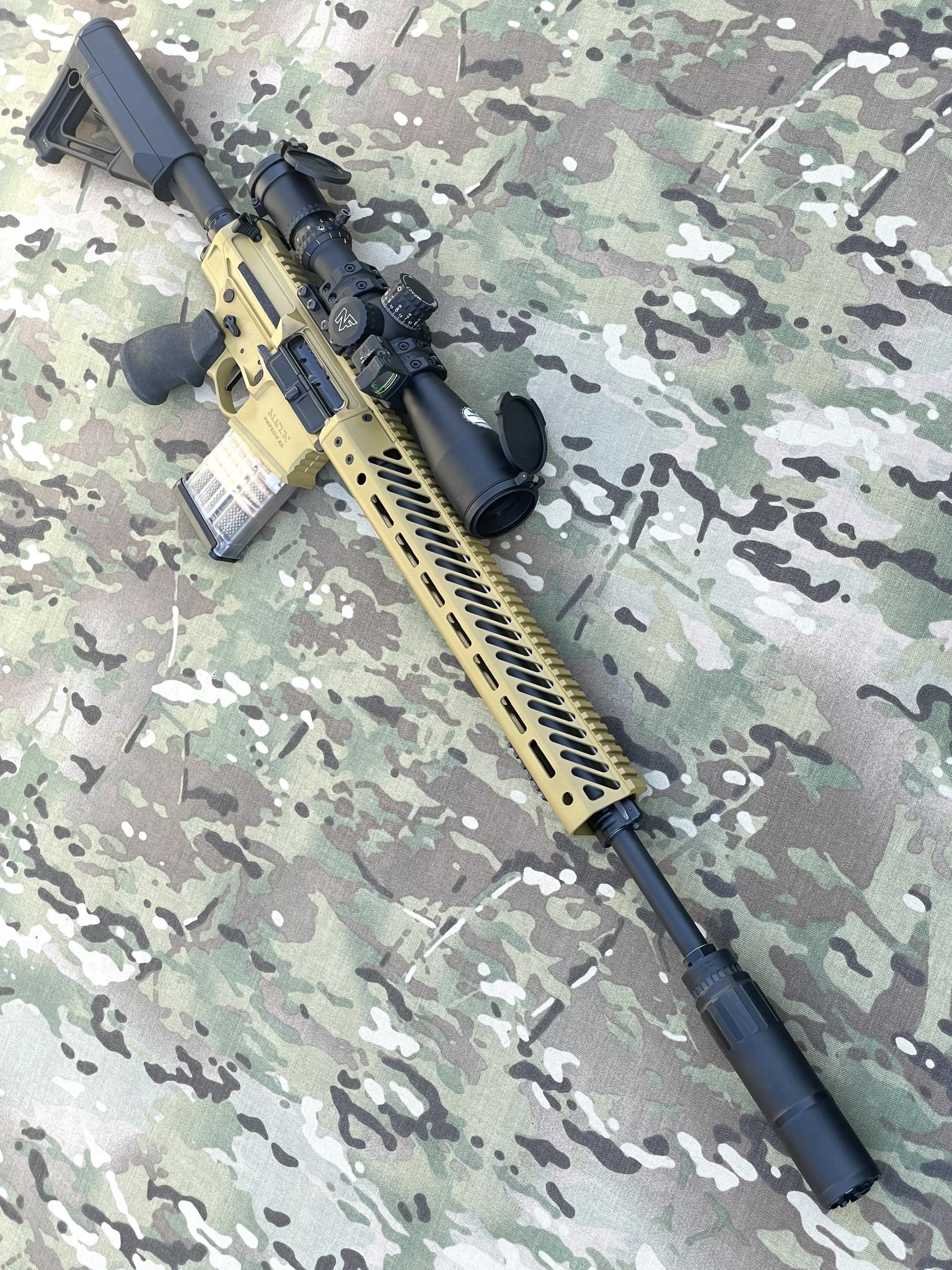

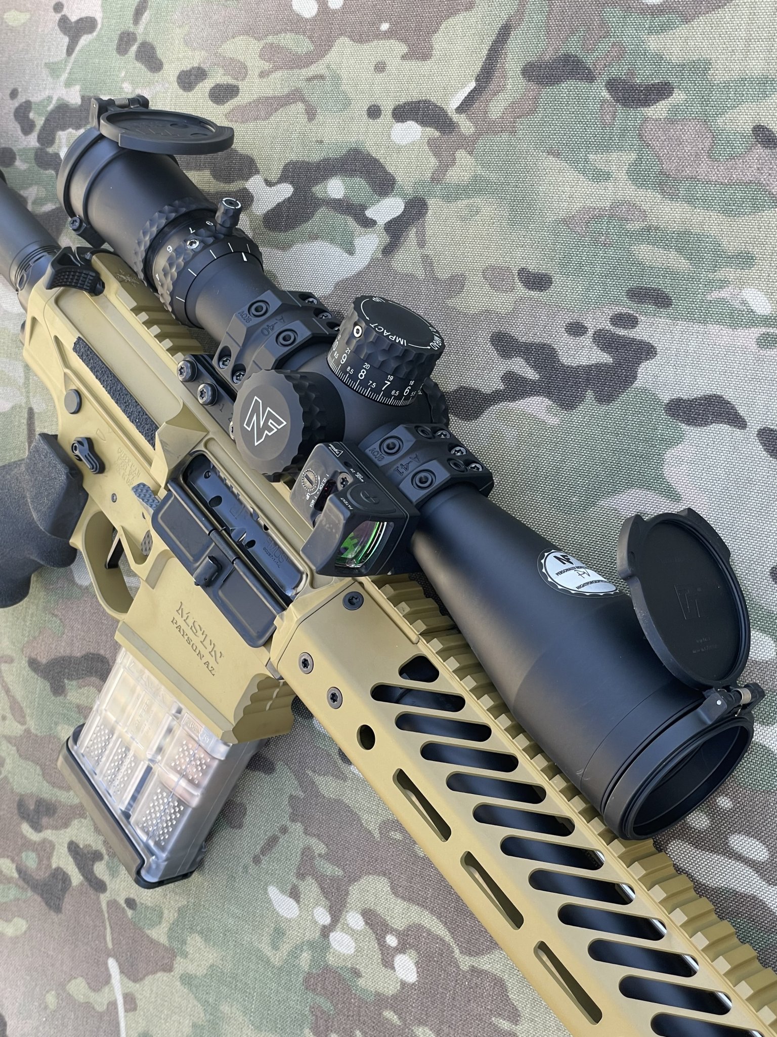

Excellent point! Here's a Craddock Rock Creek 22" SS 6.5 CM 5R barrel (NOT the button-rifled Rock Creek RTR series) that I just finished. I threw a scope on it to see if it would shoot. With zero gas system tuning (wide open), with zero so-called barrel break in, it immediately began pounding out sub-MOA groups at 100 yards with the first box of factory ammo I grabbed.
I heard you
View attachment 8368950View attachment 8368951View attachment 8368952View attachment 8368953View attachment 8368954
Very nice! I heard you can't go wrong with any option from Craddock precision.
Which wide stance bipod is that and how ya liking it?
Long Range Accuracy Ultralite F-Class Picatinny Bipod:
This design is about a dozen years old. They used to be so hard to find that ten years ago, in order to get my hands on my first one, I had to buy the rifle with it.
Production has ramped up in recent years. I try to keep them in stock now.
