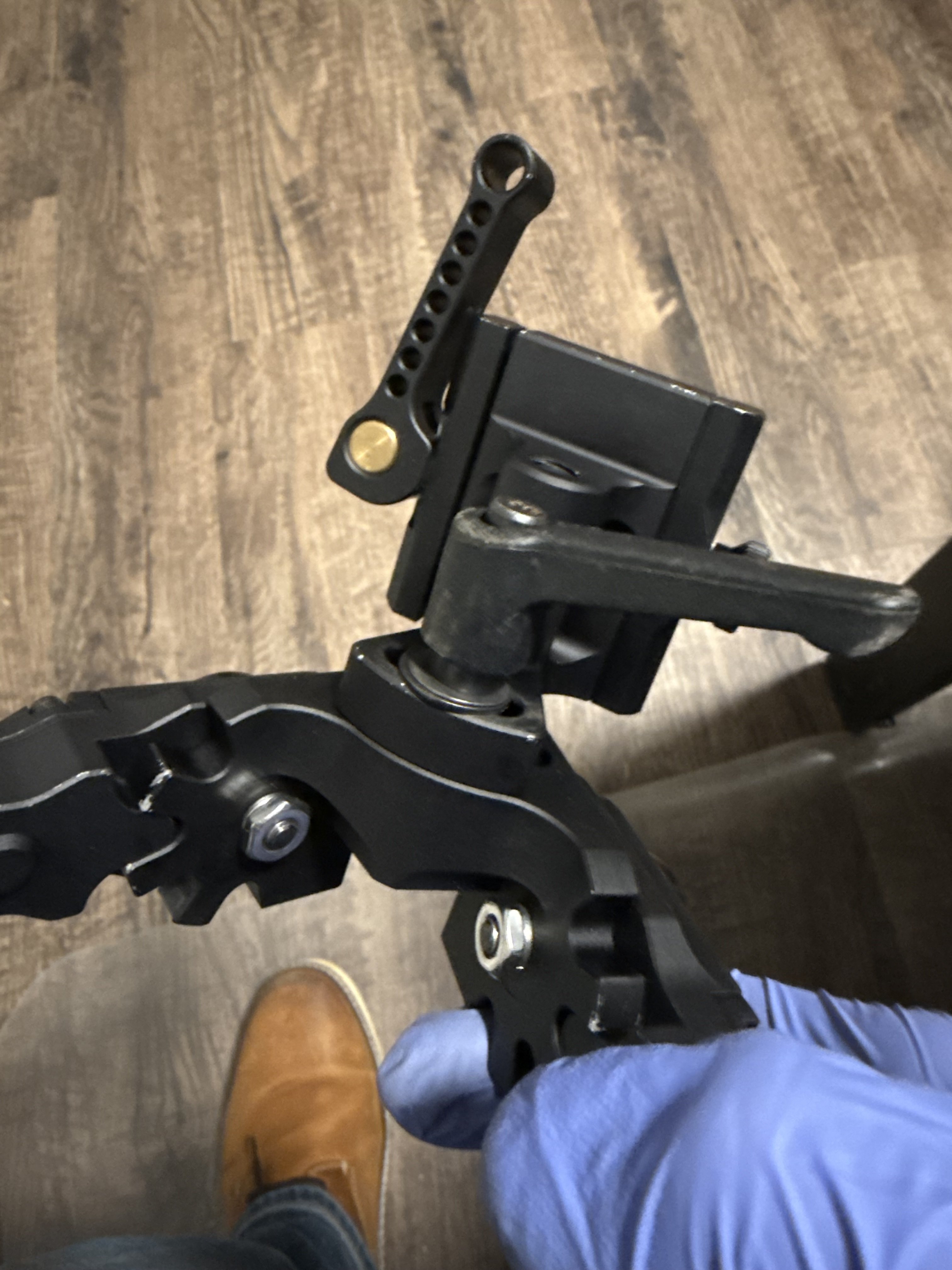

I called and spoke with them about it. There are two washers that help provide tension to varying degrees. I fully disassembled mine, cleaned it, reassembled it, and it functions significantly better now. I also will only be using the accutac for prone/mod prone with minimal panning going forward. I picked up a Ckye pod and will run it most of the time.
Pic for reference:

I have two FD -4’s and have the same issue in matches. The cant knob loosens up and the bipod flops side to side. I removed the handle and added a large plastic washer over the top of the existing washer. The washer is 2x the size of the washers that came stock. The plastic allows you to crank it down and still have some slop for adjustments. It’s not perfect but stays stable for a few stages. Before doing this I was having issues on every stage that required a bipod. I too called Accu Tac and did not get any assistance.
