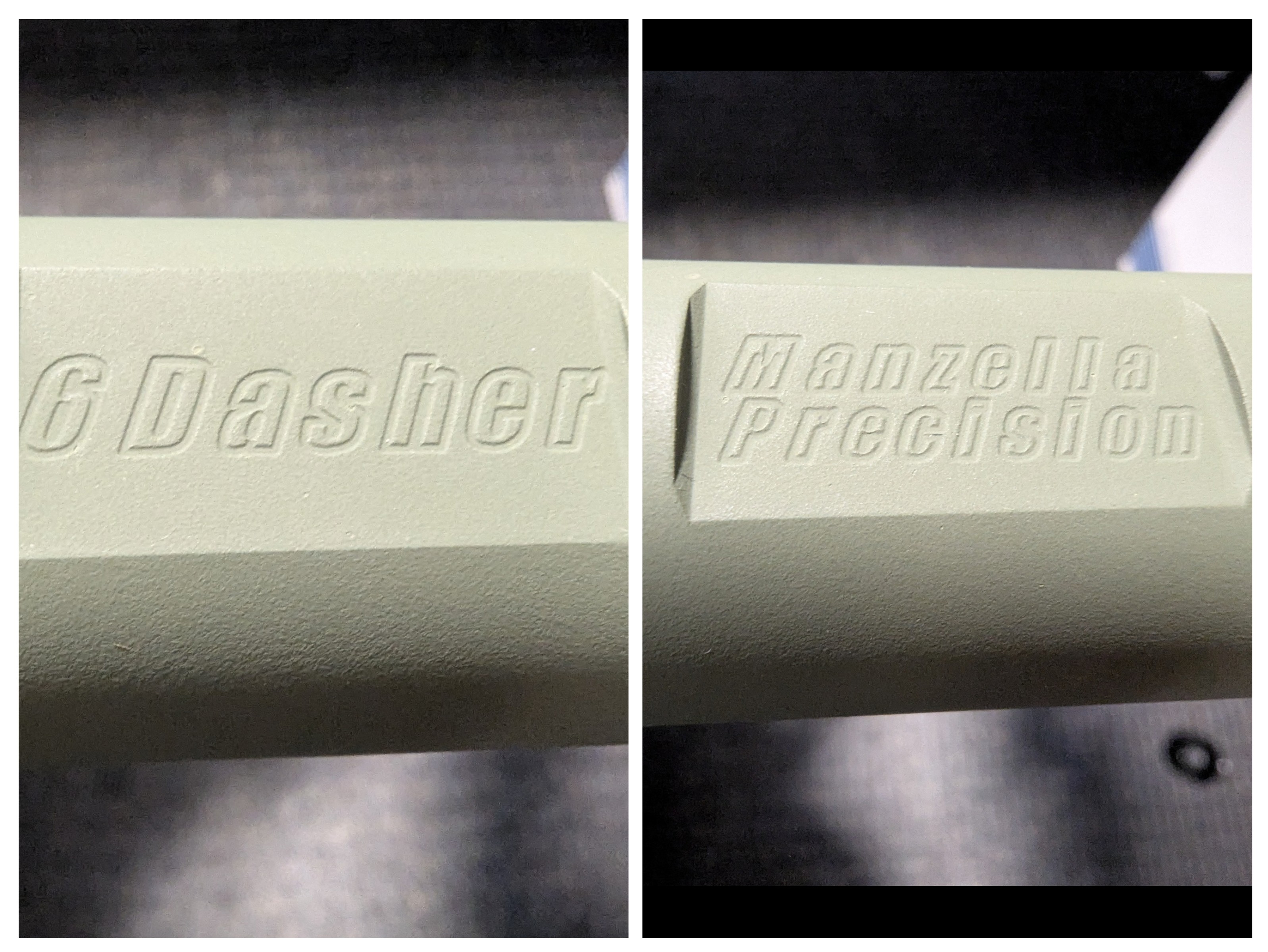

I just finished up this GM barrel blank testing. Just waiting on my ACE blanks to show up to Manzella so I can start my testing.
One of them is a 29" 224 0.219 1-7 heavy varmint.
I have a brand new identical spec Krieger sitting here I've never fired. I'm going to screw that on and start testing and do a direct comparison to the ACE when it arrives. We will see how they stack up

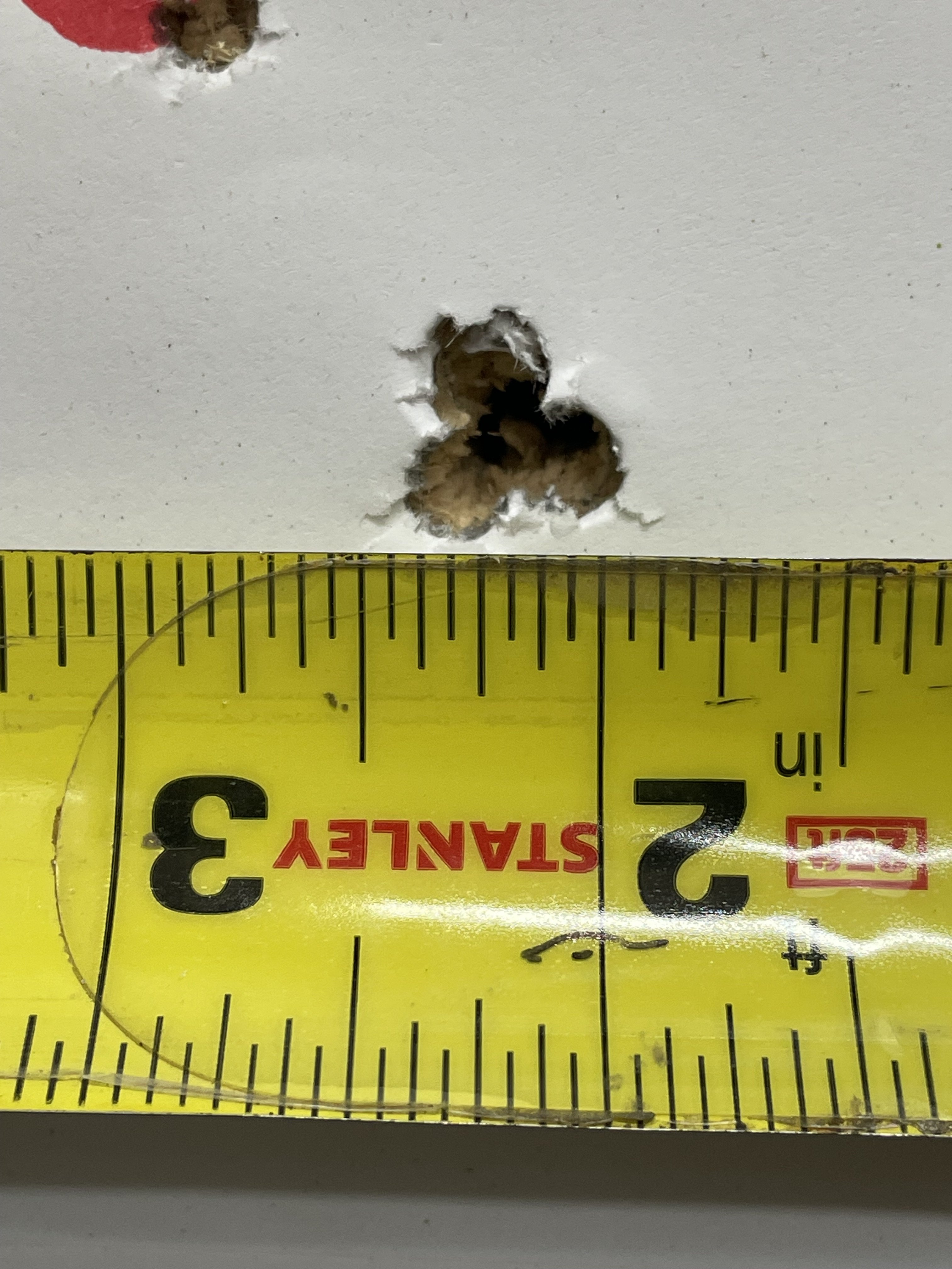

Here’s my ace in 6GT. 26” M24. This 5 rds of factory ammo. She’s done this since the beginning and only has about 160 on her now.
Do you know bore diameter and groove count? I know early on it seemed like they started with 6 groove 0.236" bores before adding 0.237 bore. Same with 0.218 vs 0.219 bores.
Its all in what you order. I believe they only offer 4gr and 6gr in 224 and 6mm, everything else is 6gr. I have multiple of their 4gr 6mm, as well as 6gr 65 and 30 cal barrels. They all shoot well.
I do not shoot tight bore, so no 236 or 218 bore barrels here.
