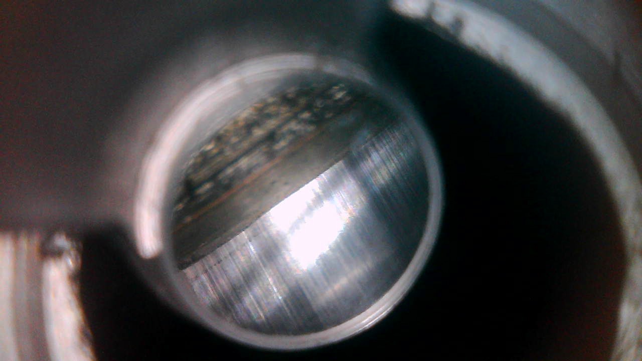

Shilen and Lilja sent me more that one bad barrel. Either inaccurate or in the Shilen cases had voids in the metal that not only would have ruined accuracy but possibly been unsafe. Lilja were very poor shooters. All the others were fine.

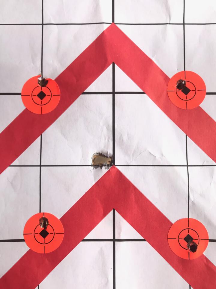

Here is a pic from a brand new button rifle barrel blank I did from Wilson (sub $200 barrel) with factory hornady from a gen 1 ruger rpr. The sister rifle I did shot the same. Something like 10 or 15rds in the center, stickies are rounds 2-5.

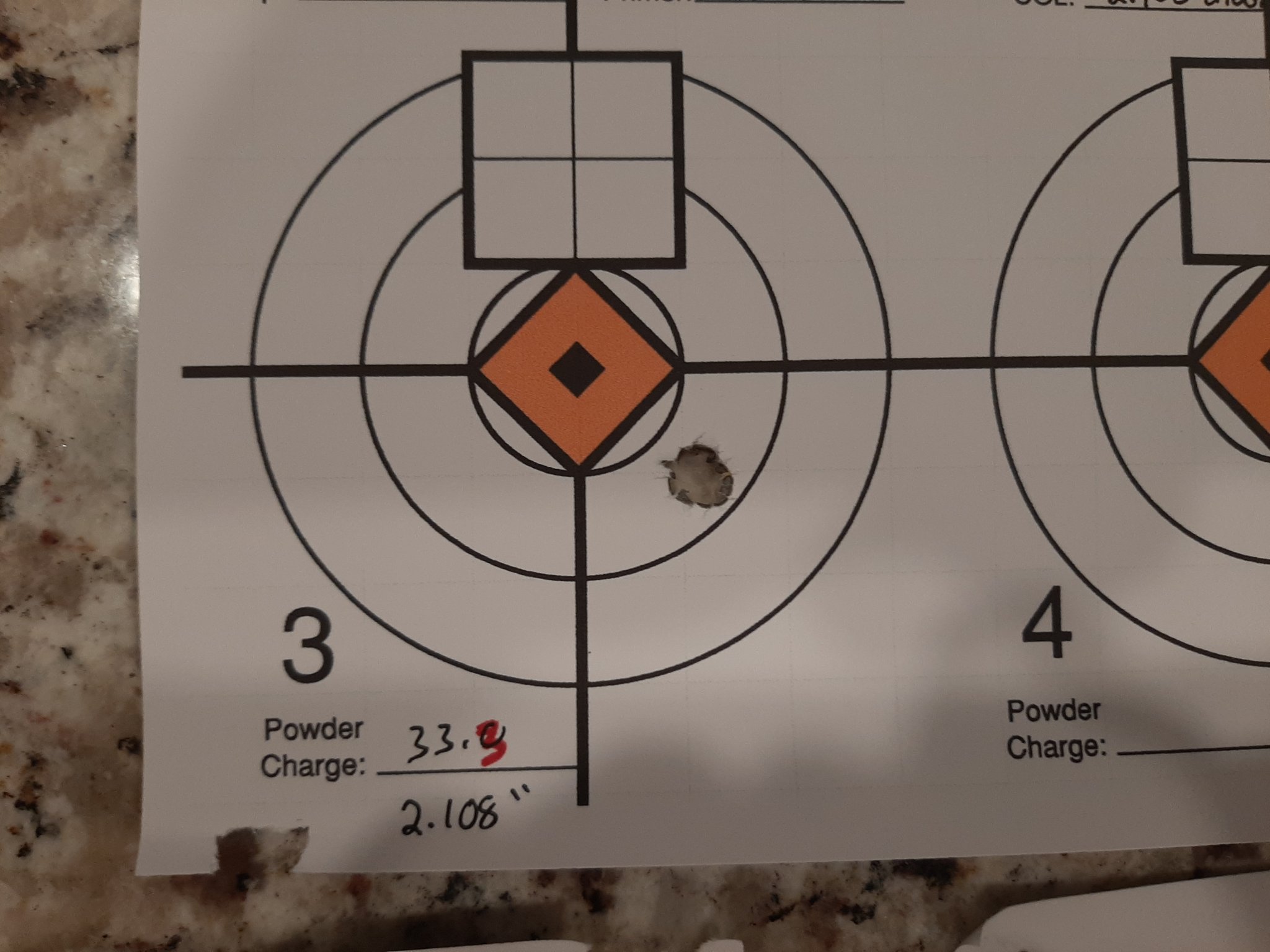

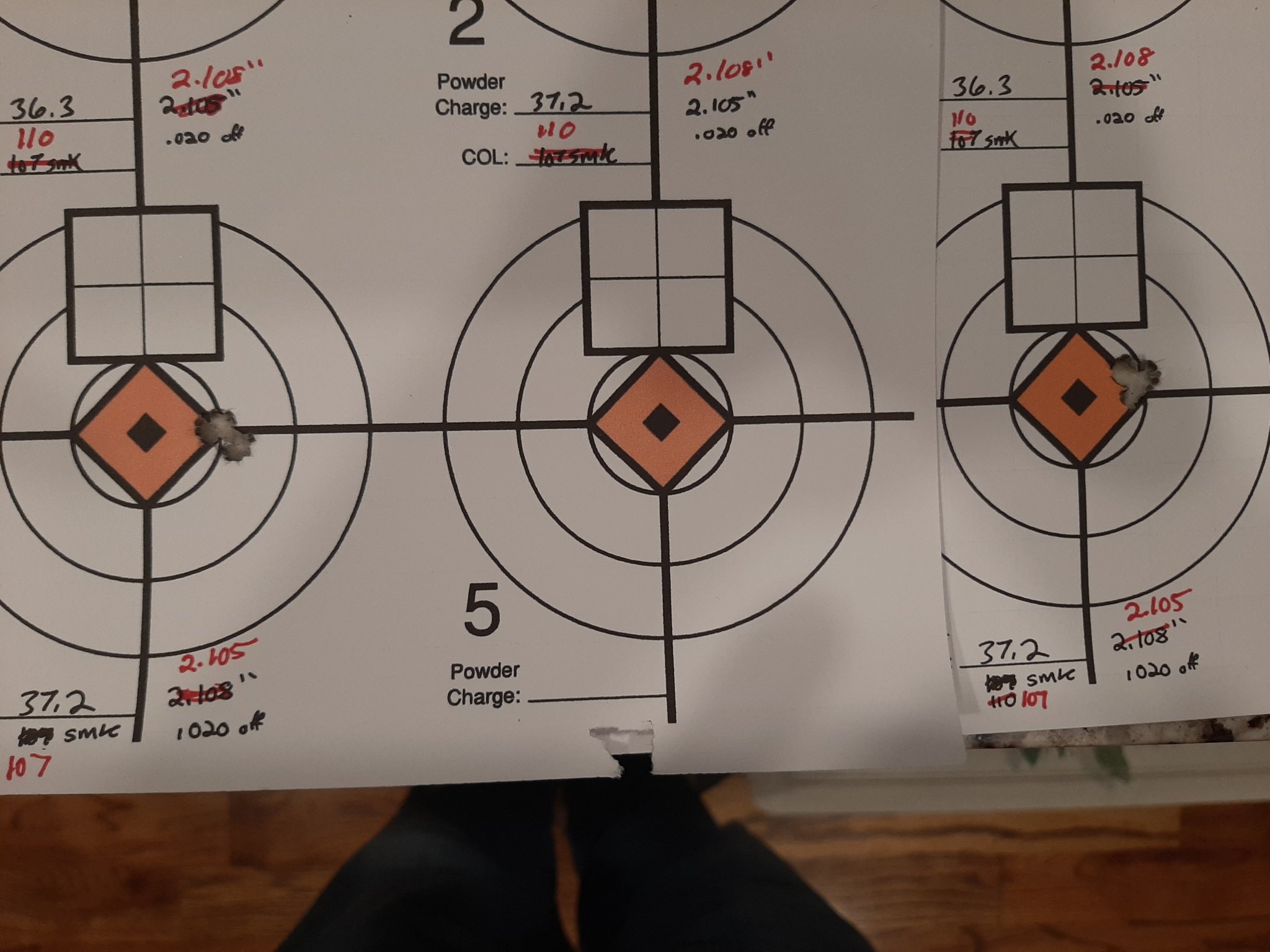

Not sure why people post, what I assume is, 3 shot groups. If you have an XR51 that needs first or second shot one hole accuracy for life threatening matters then I get it. Otherwise, competition rifles should post 10 shots or GTFO.
Calm down bud it was load development. Showed promise with great ES and SD. Next step is a larger sample.
Regardless I'd rather have repeated groups over multiple trips to prove a load and not just 1 group of any size. Any time I shoot 100 I print a 5 shot group and record the size. 10 shots you are testing the shooter more than the rifle.
Reactions: PRSDietitian
I guess I’d preface with that 🤣
Anyway, hope it develops nicely 🍻
