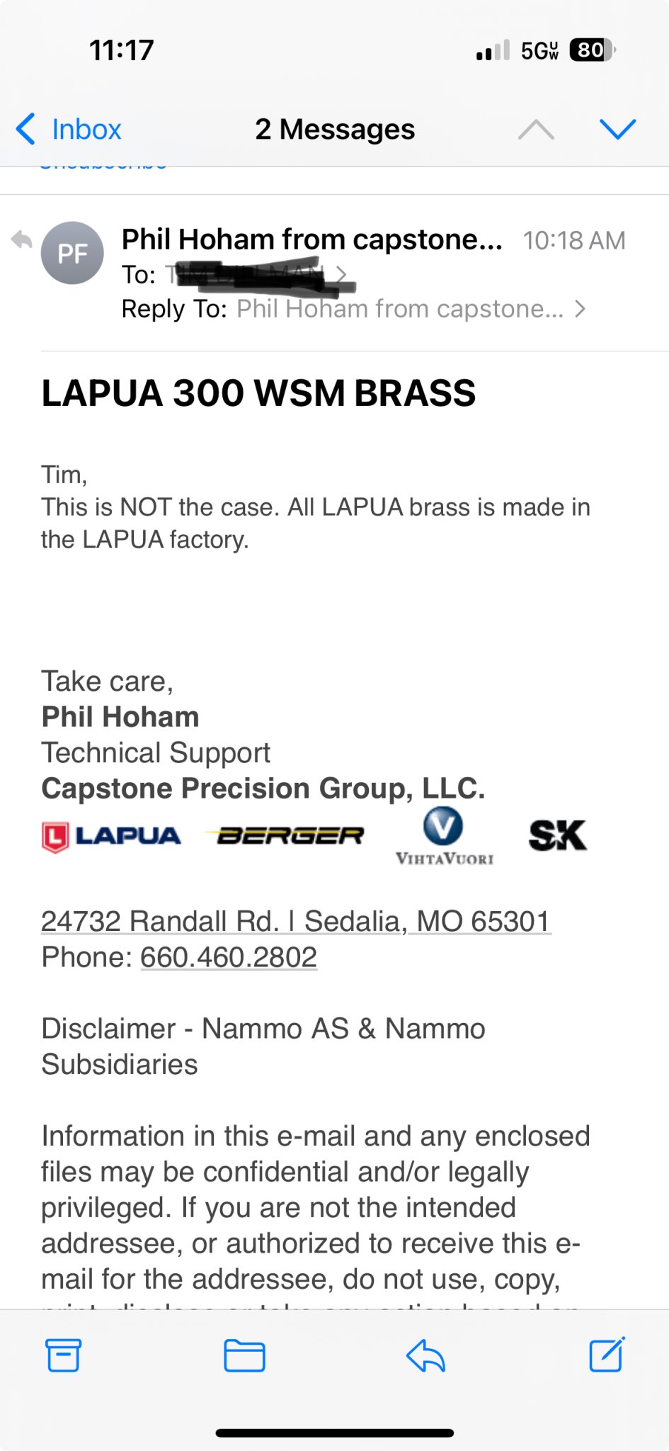

    I sent an email to tech support at Lapua asking if their 300wsm brass was made by Norma and they very quickly replied that none of their brass was made by anyone other than Lapua.
