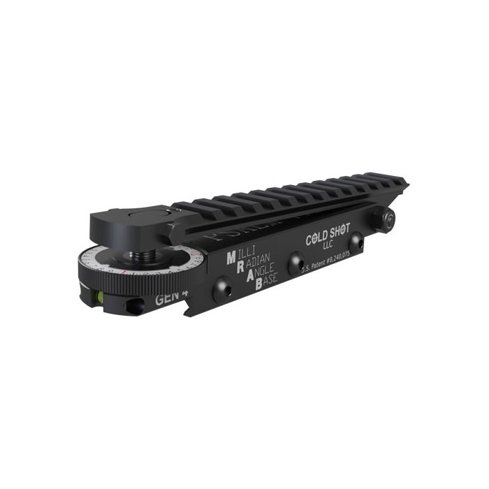

Cold Shot
First few mins of the video, he has mixed feelings about the Cold Shot
Although this is a 2017 video; Cold Shot are up to Gen 4 now so maybe they have addressed the complaints.

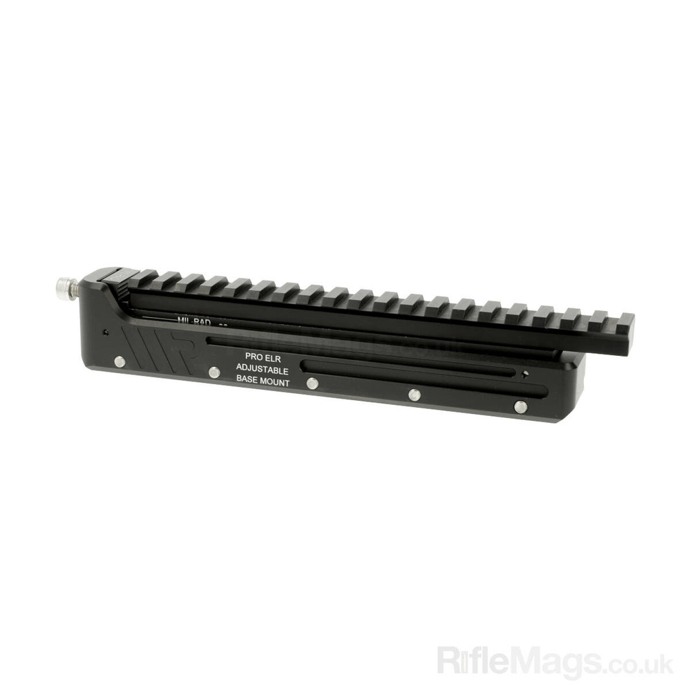

WR Precision
WR-Precision-Pro-ELR-80-MIL-RAD-MRAD-Adjustable-Sight-Base-Mount-WR-ELRB-MRAD--1__41935.163059...jpg

I have used both the Cold shot and the Ivey mount. I found both of them to repeatable. The main difference is scope height. With the CS the scope sits much higher above the rifle. The Ivey sits lower and requires less movement of the head up to compensate to get into the scope eye box. The WR looks to be the same height wise.

On the Cold Shot being repeatable, isn’t it a screw which sets the elevation when you turn the dial?
If so, how do you avoid slop in the screw and why doesn’t it move or rotate a bit under recoil?

The story on the cold shots is essentially the first gen had about .007 movement sideways and .009 vertically measuring at the end of my scope with a test indicator bearing in mind at the time was for novice shooting and did allow anyone to go long range cheap with any scope they may have but way way too much movement , and each generation has got better meaning tighter and beefier up to gen 4, the latest generation has .001 up and down slop and sideways about .001 stress induced return, unstressed return was was .0005. This is the sum of all clearances of all the connections of the parts. from a machinist standpoint that is pretty freaking good, I agree .001 is still too much . The dial is spot on in moa through the whole adjustment so it works well for elr, so for supreme accuracy in comps I make a simple lock out for the cold shot that has worked well. it brings the slop in both planes to zero with stressed return to .0001-.0002. which is tight enough for competition. I have had it on my 375 for years and it was always spot on when it came to adjusting. You do not need a wrench to lock it which is also nice The Tacom new prism is tier one nice and cold shots are cheap and they need to have a lock out to work in competition in my opinion. So the question is how much money do you want to spend?
Thanks for the write up. Those slop values, are they in inches, eg 0.009 inch? Do you know what that translates to in miliradians of elevation or windage slop?
They are just measurements from the front of the scope which hangs out in front of the cold shot by 6 inches using a test indicator that reads to 1 10/1000th of an inch. The slop in the cold shot I am sure is considerably less at the point of pivot , because I am measuring at the objective lens of the scope this is only a comparative measurement not absolute.
Tim in Tx
I saw a video a while ago of a guy testing an Ivey base with a dial indicator, he dialed 50moa and that was .064" so 1 moa is roughly .0013" but that was measured at the back scope cap. That would be increased substantially at the objective. here is the video if anyone cares Ivey base test
