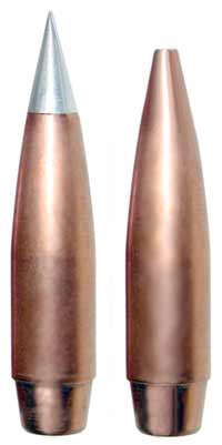

    Look into Warner tool bullets.
    Hi,
    They are great :) Warner makes them PERFECT..each and every projectile.... but I am talking beyond that.
    But lets start the conversation with their projectile....
    Take their 361gr .375 projectile. By changing the composition what if we can keep that exact shape and dimensions but increase weight, thus increasing the sectional density, thus increasing BC.

    Theis:
    As soon as you bring enough money I'll make them out of any damn thing you want.
    Without a Mil R&D contract, or a very well off individual, there is little hope of much progress in this area.
    Alan

    Powell River Laboratories made a number of bullets that used powdered tungsten vice lead for the core. They make for a very heavy projo for the same length and profile as a Sierra or Hornady A-Max. They fly extremely well and are very wind-resistant (external ballistics-wise).
    They were very expensive at over a dollar each for .224-caliber bullets and while useful as a target or game bullet it was doubtful they could be used as a standard military bullet. I know they were used as a specialty frangible projectile around high pressure vessels and piping.

    The projectiles I posted are of a powdered tungsten but instead of being copper jacketed, they are a tungsten/polymer "compression". Still is T&E phase :)
