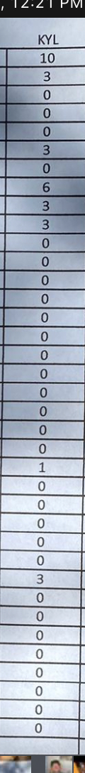

last Club match i shot (not one I had a hand in setting up) with an actual KYL...1”, 3/4”, 1/2”, and 1/4” @ 100 yds
I shot it backwards from small to big lol
If the kyl’s go sub moa, there’s likely only the top 5% of the shooters who have any business shooting at them if the shooters actually “know their limits” and that’s if it’s a prone stage...if it goes anything positional, it’s way less than that....years of matches to Support that with evidence
