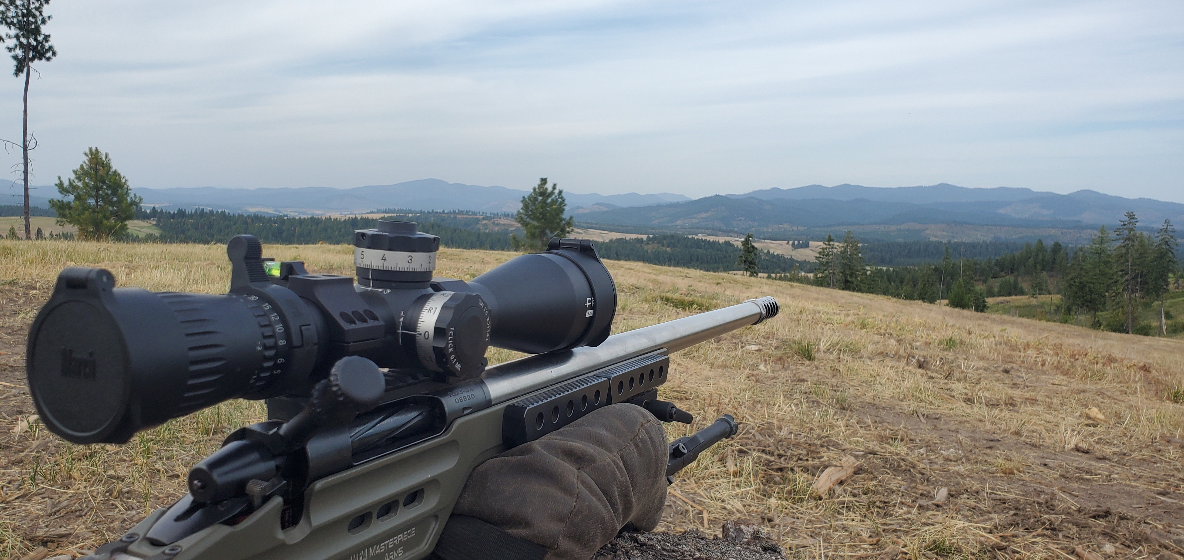

I spent the day behind the gen2 and zco 527.
Mirage was wicked today and both optics cut through very well.
I was able to spot hits and misses out to 940 with 75 vlds.
The turrets are by far the best I've laid hands on, I can't wait to run it in the NW finale next month!

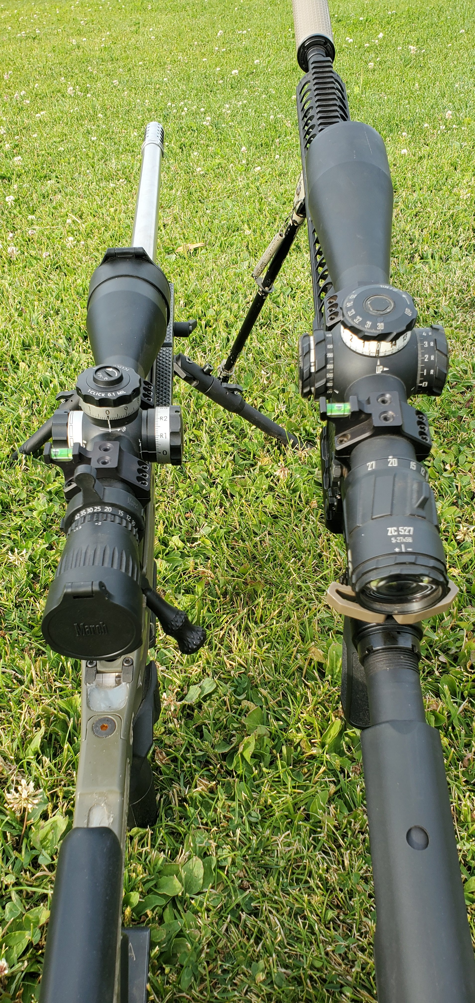

View attachment 8730402View attachment 8730403
The size difference is crazy and that's not even the big boy ZC840! Cudos to March for making such a compact package.
40mils elevation, huge FOV, big mag range and yet smaller and lighter than all the current alpha glass with similar and even worse specs.
Does the ZCO in the pic have locking turrets? If possible, would highly appreciate a quick video of the turret operation and sound, showing wiggle, backlash, quick adjustments etc.
It's not as drastic as that pic makes it look, the 527 is riding much higher up on a harris bipod putting it closer to the camera, It is almost edit* .5" longer though. Yes the zco has the locking turret.
I'll make a video of the gen2 turrets, they're damn nice

So I was surprised a little but the gen2 has a more forgiving eye box than the 527, it reminds me of the 7-35 ATACR I just sold.
The parallax is also massively improved over my 4.5-28, I can set it and don't have to touch
It from 200 to 2500 yards.
The zco has slightly brighter and better glass but it's a compromise to the gen2 in every other way.
Also the high-end magnification is surprisingly clear and usable!
Just for fun I cranked it up to 35x today and ran some drills at 400-700 yards and didn't have a problem transitioning between targets rapidly.
