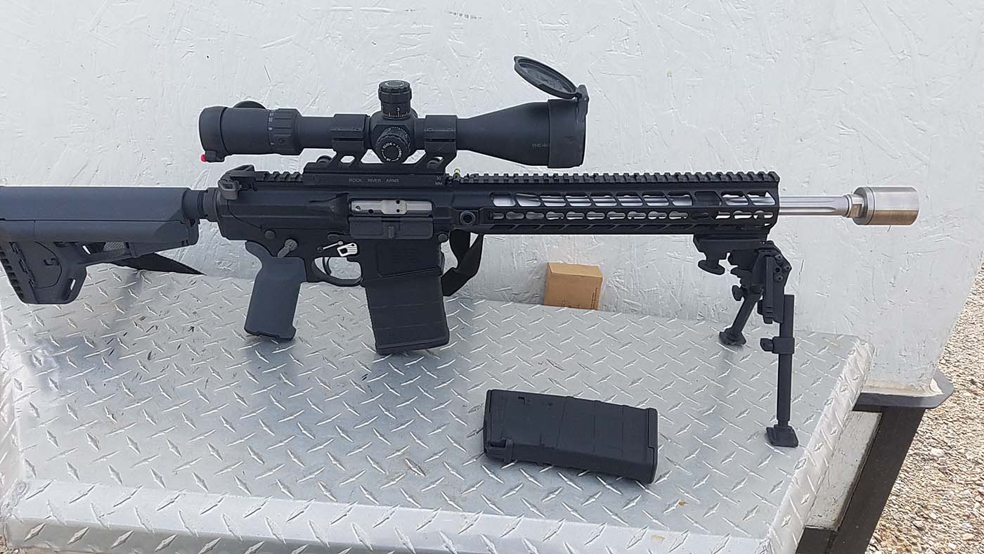

My GA Precision Armalite AR10A "HAD" problems without the can. @sinister and AMU helped fix that, a looong time ago...
Now it runs canned or not.

I have a Mega MAten megalythic (or however they spelled it) with a Wilson 18" rifle length barrel.
Yup, as everyone has said the longest length gas system you can get on the barrel is best to offset the dwell time the suppressor adds.
Adjustable gas block is also required if you plan to use both with and w/o the can.
I haven't shot out the barrel yet but I'm close, thousands of rounds with zero issues.
Sorry I do not recall what gas block I bought (and it has no markings) but it's the click adjustable type.
Can on 4 clicks from closed, can off go 3 clicks farther out and it has been perfectly working like this since I built it.
I'll post up a pic when I get a chance.
Here's a pic with a flash can (pig) on it....I had it made to use same mount as suppressor, a bit more accurate too.
