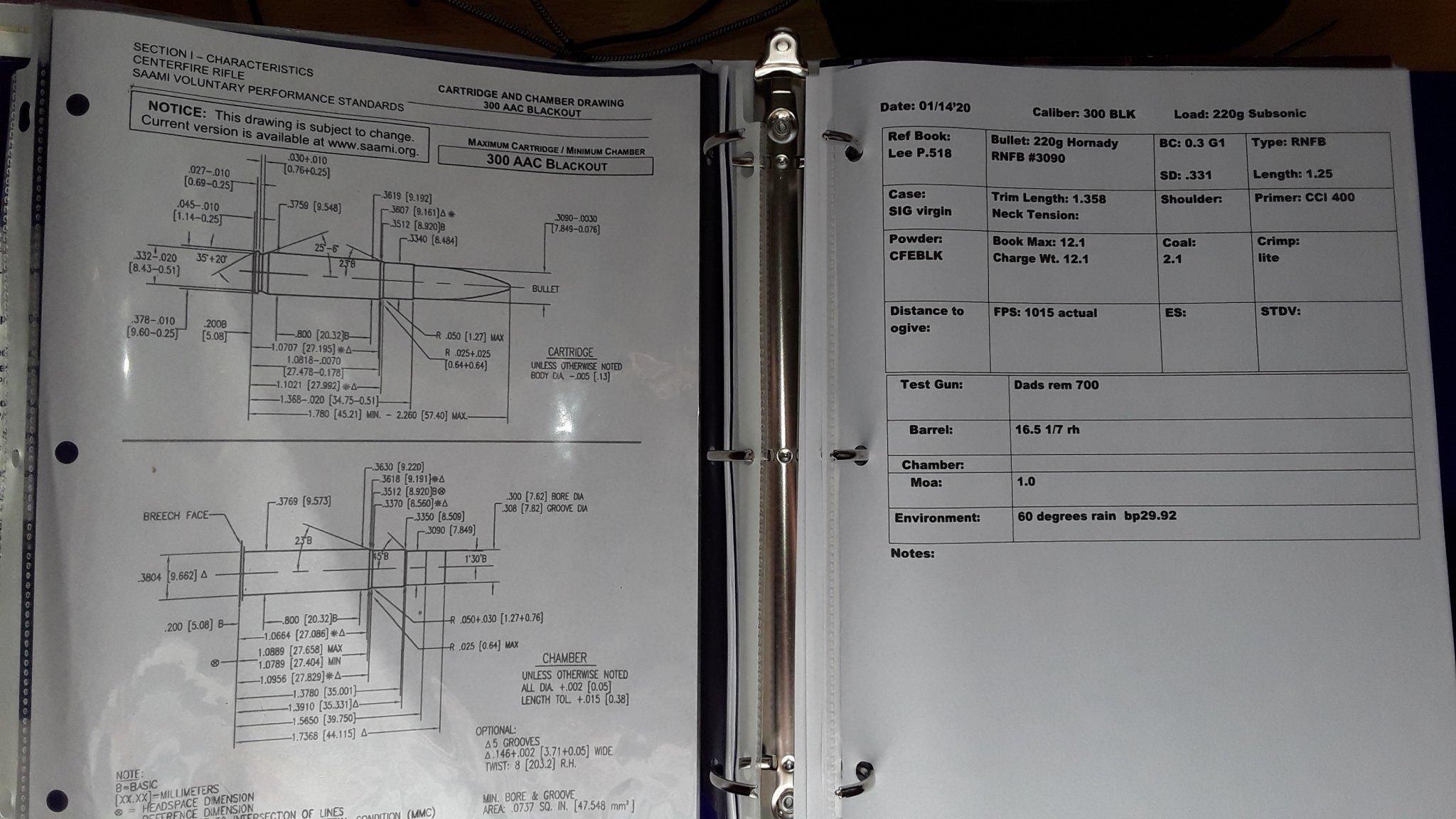

Some sort of data book ,to keep up with what you've done.
Reactions: Snuby642
Do a Word format or Excell format data sheet template.
Each time you change bullet, brass or powder that's a new sheet in a 3 ring binder. Leave room for notes on gun and performance.
For each caliber I print the saami spec for a reference. I put them in a sheet protecter for a separator.
You will find yourself loading more calibers as you start enjoying it.
This is still in work but gets the job done.
Each time I make a small change I scribble it in red pen on my printed sheet till I have time to type it in.

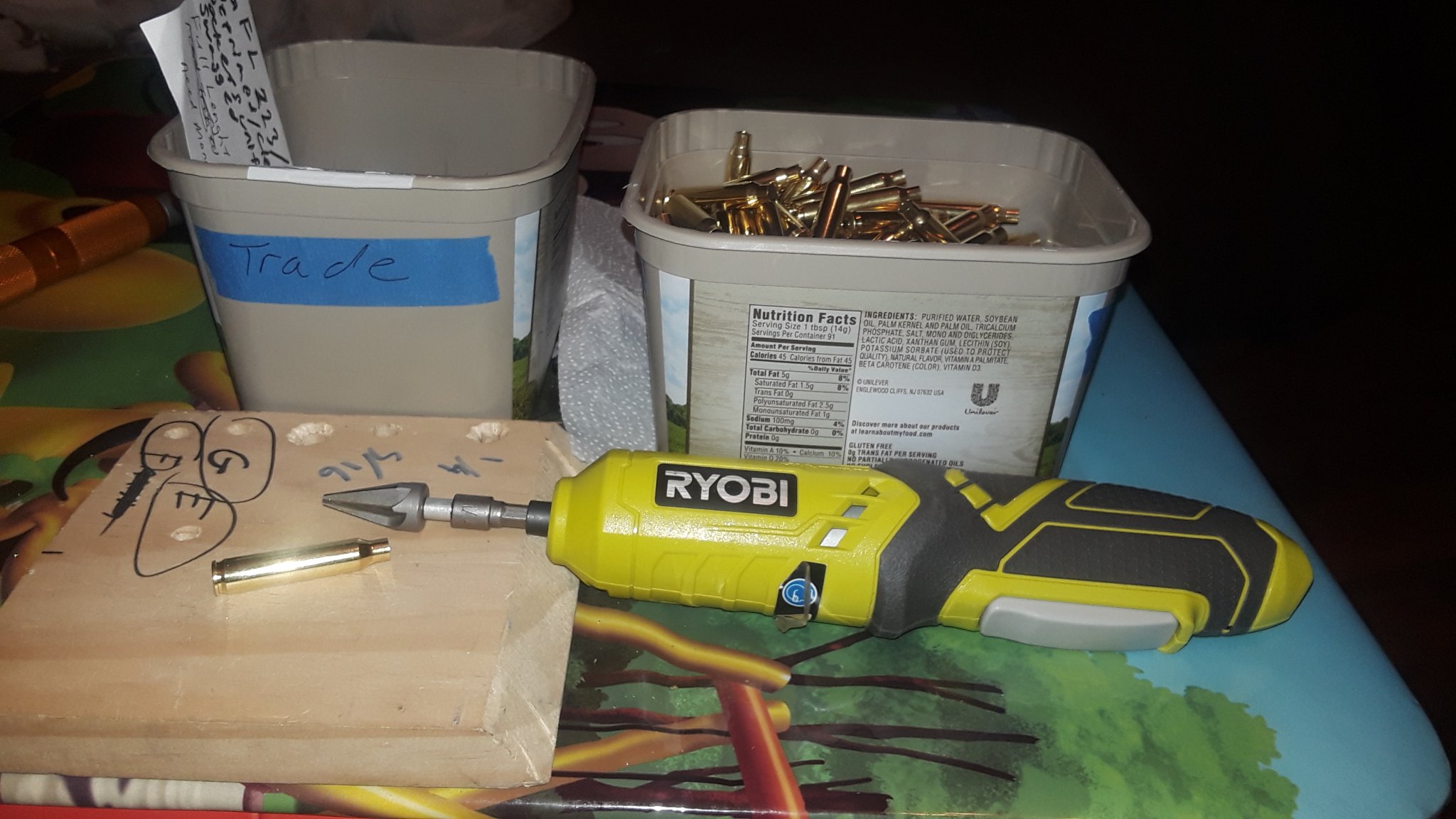

Lyman tools in a strait screw driver.
They sell a kit that fits inside the handle but need to get uniformer separate and a primer pocket gauge is handy.
