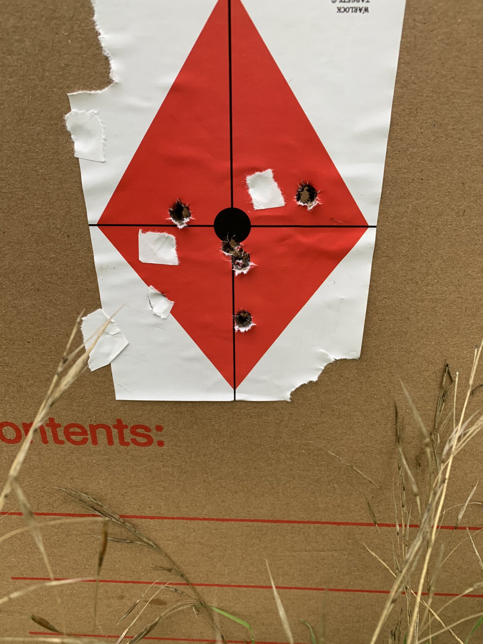

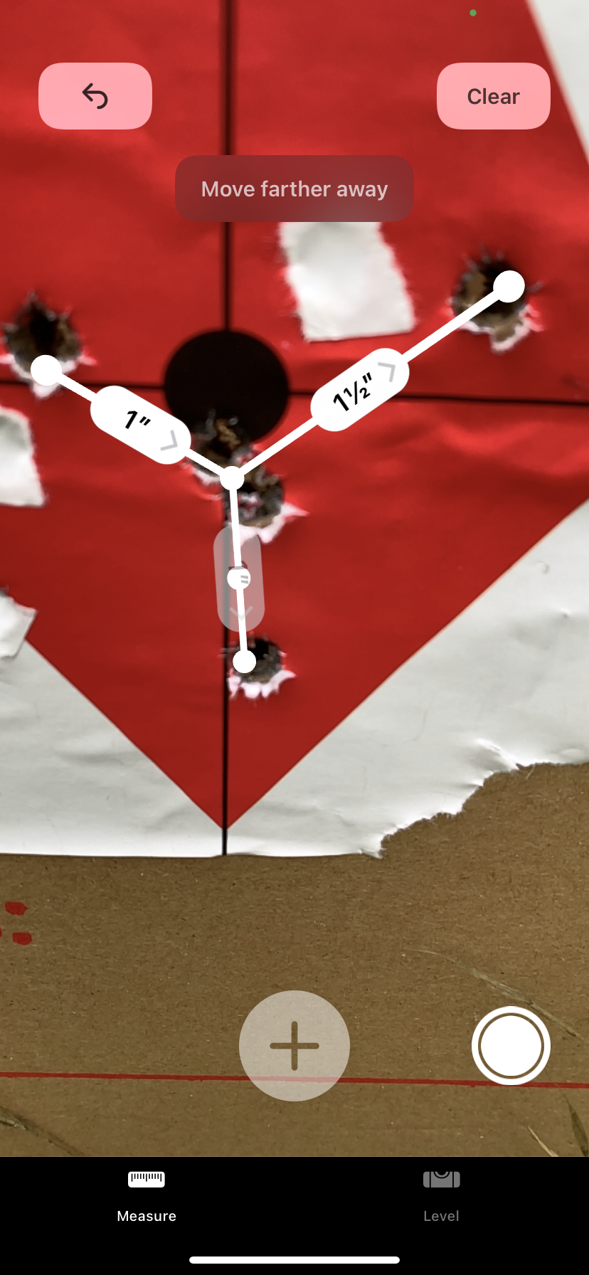

I went out today and had to leave the private range I was at early but managed to at least do a few 100 meter groups and I think it was roughly 1moa. I think I’d like a PRS stock and maybe (maybe) a bipod. I had to leave before doing more groups. I changed my technique a little after my first group kind of sucked and did the thumbless thing which actually helped.
I was kind of upset a couple nights ago as I researched reloading and what was available. Almost gave up altogether but found some powder and primers online the next morning so I’m just gonna chase this hobby finally and stop beating around the bush. It’s the only thing I’ve found enjoyment doing lately. Thanks for the advice and encouragement everyone. I think I’ll start going to the precision rifle club nearby and just see how it goes. Probably the only way I’ll be able to get my dope out to 800-1000 without going to the Nevada desert.
