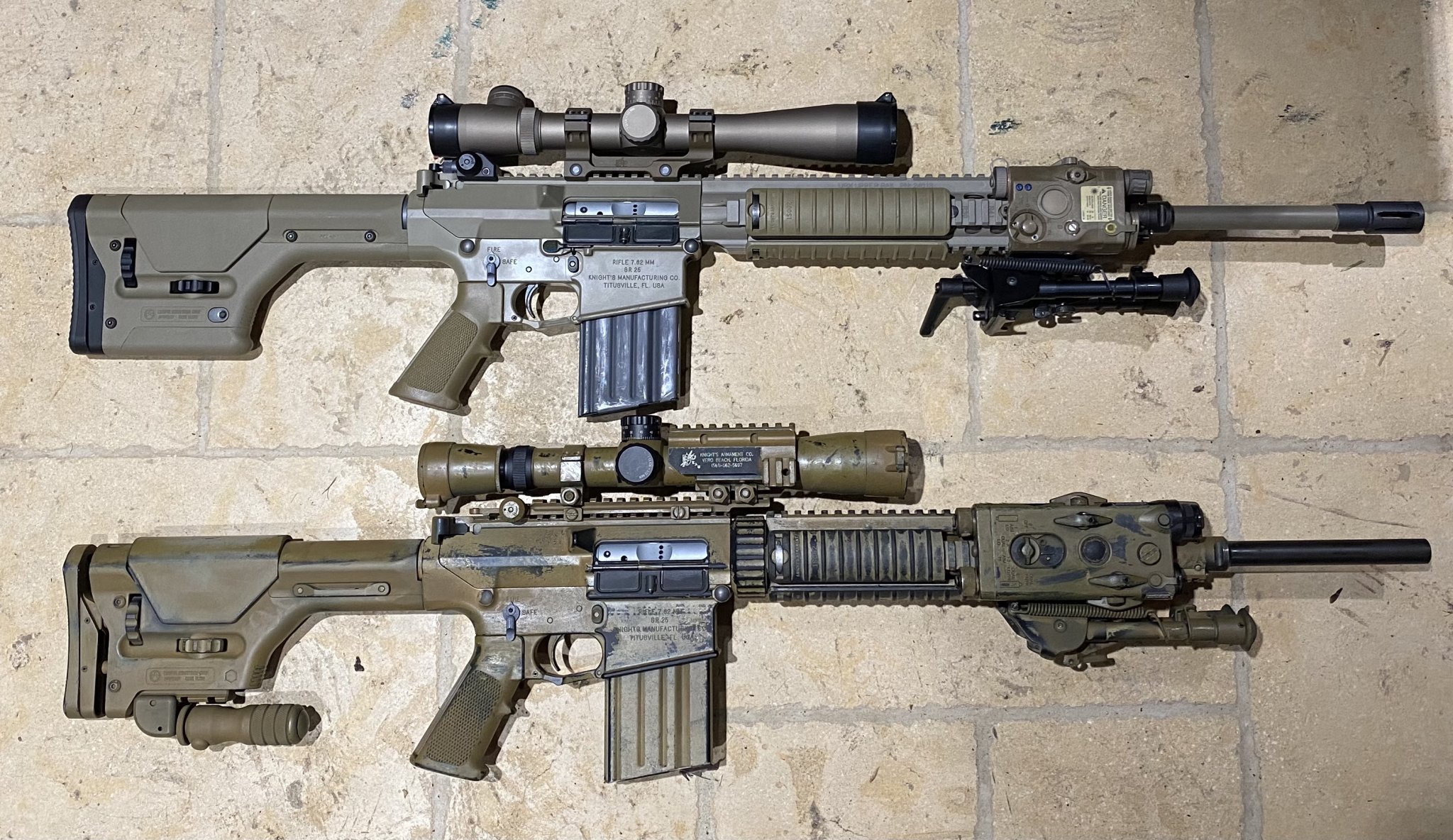

Build an M110 and an Mk11. But do it right!

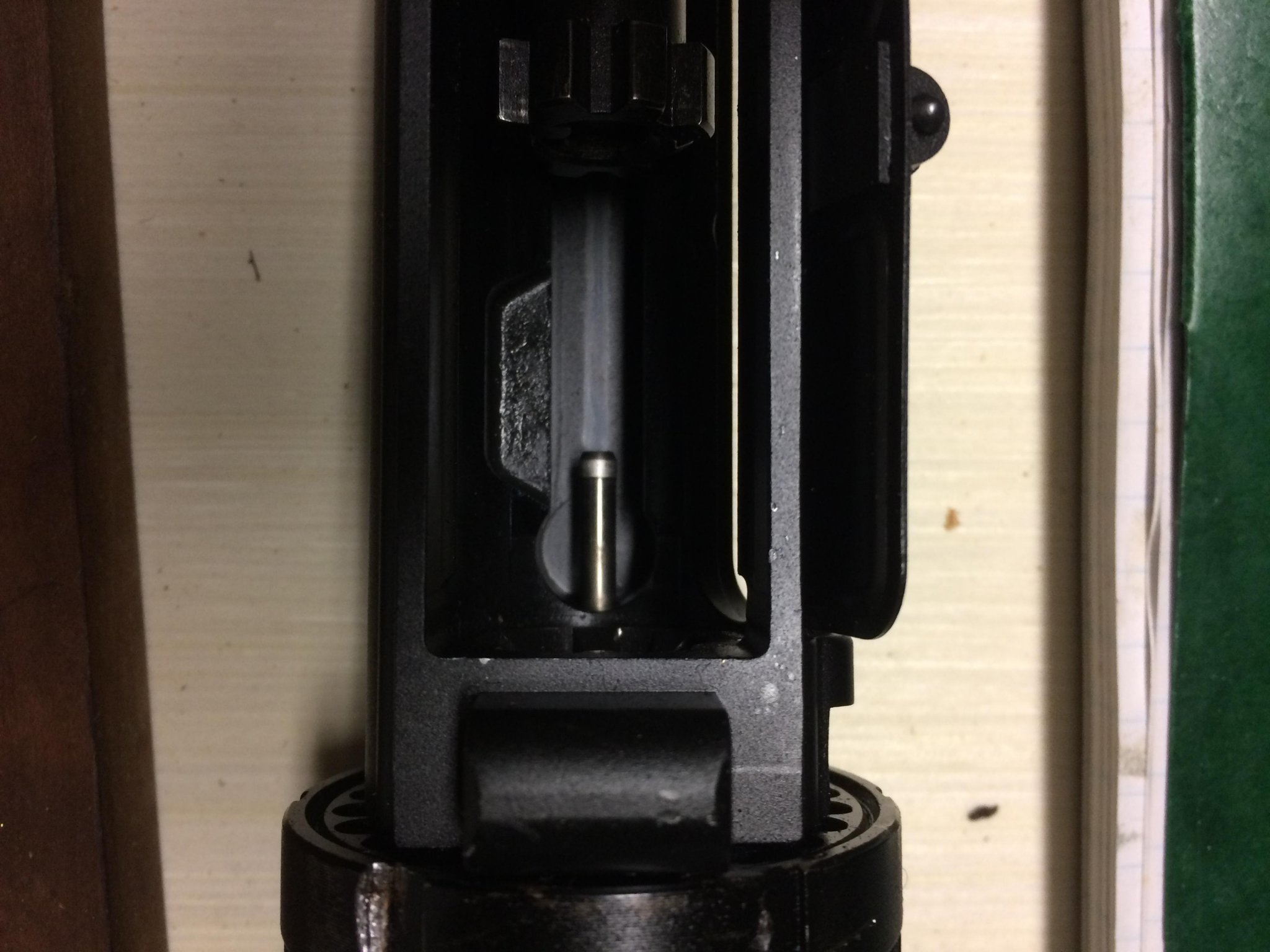

The biggest thing that will screw you over is gas tube length.
This one below is to short.
Wilson Combat are notorious for causing what you see below because they have to do it their way.
Buy your stuff from people that build large platforms for a living And AVOID anything prattitary
