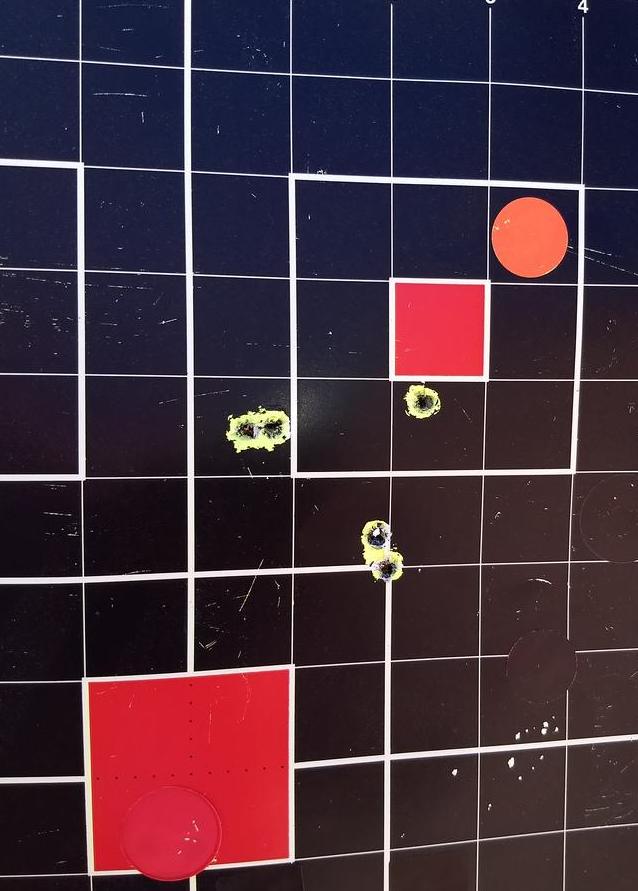

I put together an AP M5 Creedmoor build a few years ago. Through careful shopping and patience I'm in for about $1200, not including the optic.
I have shot it a few times at 100 yards and finally took it over to the 300 yard line this week.
I used Hornady 147 ELD's at 100 yards and the rifle seemed to like them
@100 yards. The three square pasters are covering three warm up shots I took with the 140 gr Hornady "American Gunner" ammo. My son and I then took turns shooting three-shot groups using the Hornady 147 gr ELD match ammo. 4 groups, all averaging about .75 MOA.

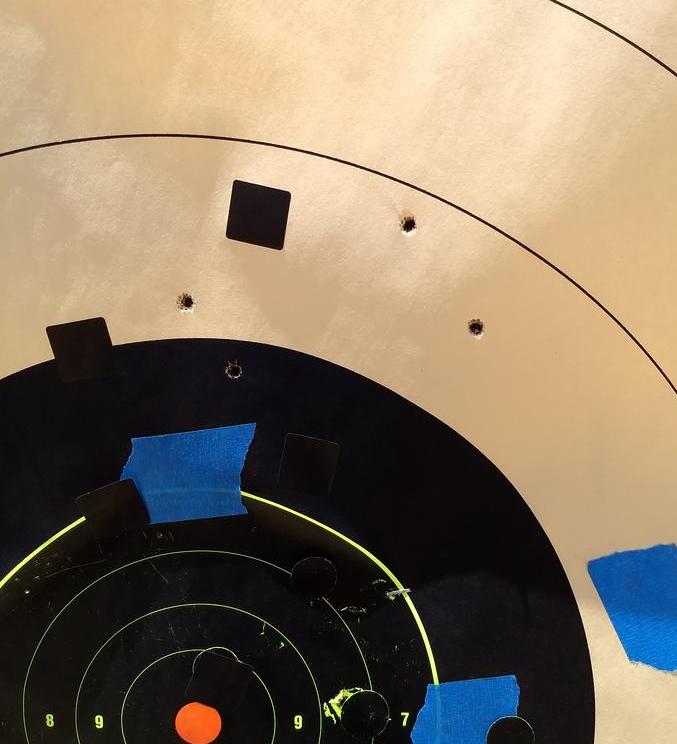

At 300 yards, it really liked the 140 gr Hornady American Gunner (almost exactly 2" or about 2/3 MOA)...
It didn't like the Sig Sauer ammo much (about 4" or 1.33 MOA)

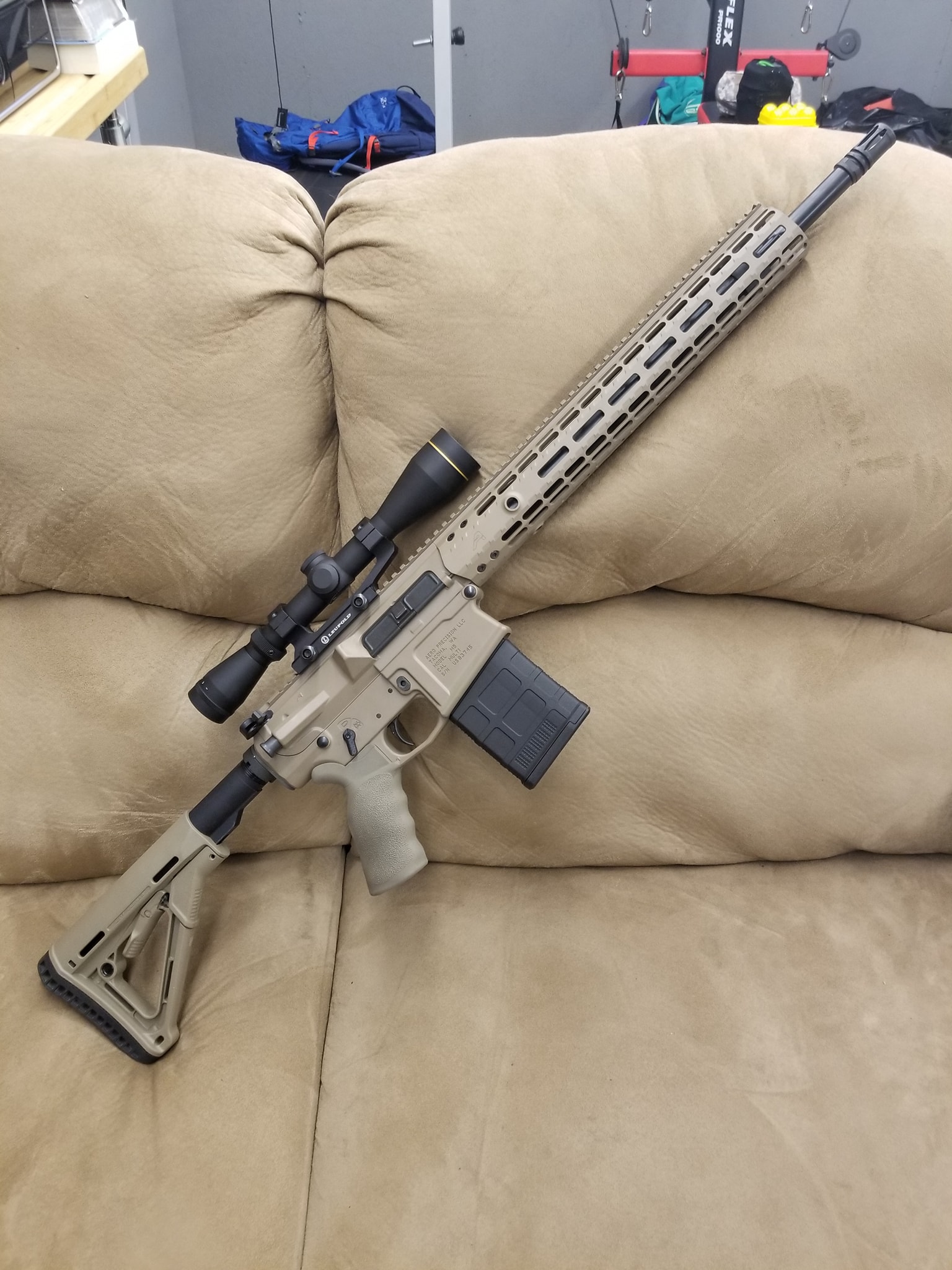

I just built an 18" M5 in 308. Getting .6" MOA with one of my old 168g SMK loads. Still breaking mine in, but it's a shooter. Thinking that I need to get a 6.5 upper in the near future.
