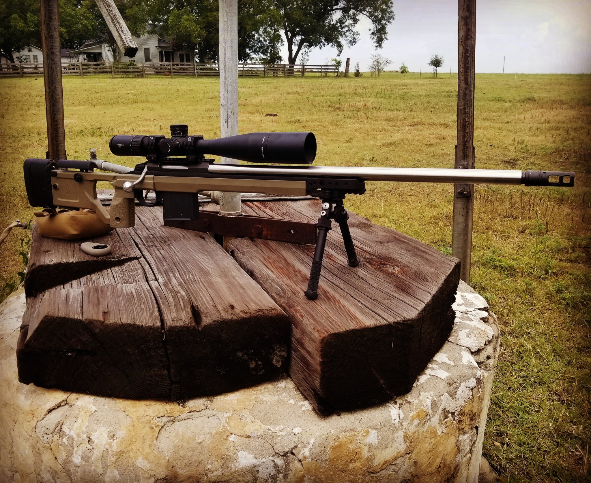

[IMG2=JSON]{"data-align":"none","data-size":"full","src":"https:\/\/vgy.me\/EUyxb8.jpg"}[/IMG2]
[IMG2=JSON]{"data-align":"none","data-size":"full","src":"https:\/\/vgy.me\/SpFwQ5.jpg"}[/IMG2]
edi
