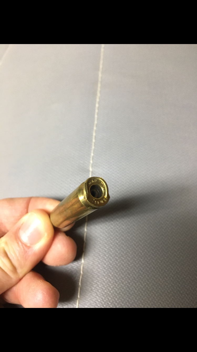

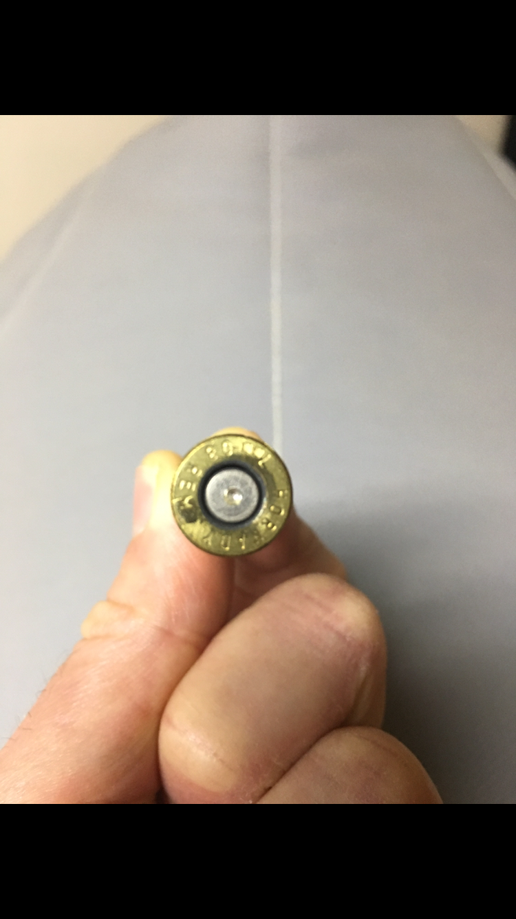

Ok, this is fun (NOT) barrel came off very easily, case was on the bolt, wiggled it free. I may have found the issue, the blown fragment (or portions of it ) is under the extractor inhibiting the bolt's rotation. I am removing the skins, scope and see if I have better access to the extractor surfaces. Thanks to everyone.
These were Hornady cases with three or four loadings, all passed the "paperclip" test (case separation test. This is a new one on me
How much were you bumping the shoulder of the case? Did you measure the shoulder length before and after sizing?

I posted pics. No BS here. The truth sucks for fanboys. The sad part is my loads in the above pics were mild. Not eleven close to max.
K I'm not a huge fan of Hornady brass either but that first picture you posted.... That primer is so flat with a massive ejector flow..... That primer pocket didn't fail just because it was a Hornady case.... That primer screams over pressure
It failed because of a soft case head. The load was a mild load, that the rest of that particular lot of brass handled fine for the rest of their lives. BTW, that same lot of powder/primers/bullets/rifle went almost 200 fps faster in lapua brass with not one problem.
You guys are welcome to use hornady brass, I like the OP, am just sharing my brass failure story.
Reactions: deersniper
Your mild load blew the primer. Tell us what the load was?
A mild case head doesn't explain the primer flow into the firing pin channel, ejector, or cup evidenced by your provided photo... again I don't use Hornady brass either hero
There was no brass flow into the ejector. There is a swipe, but it must be due to the case failure, as all of the other brass from that lot was fine, including no flat primers. The bolt had to be hammered open due to complete failure.
