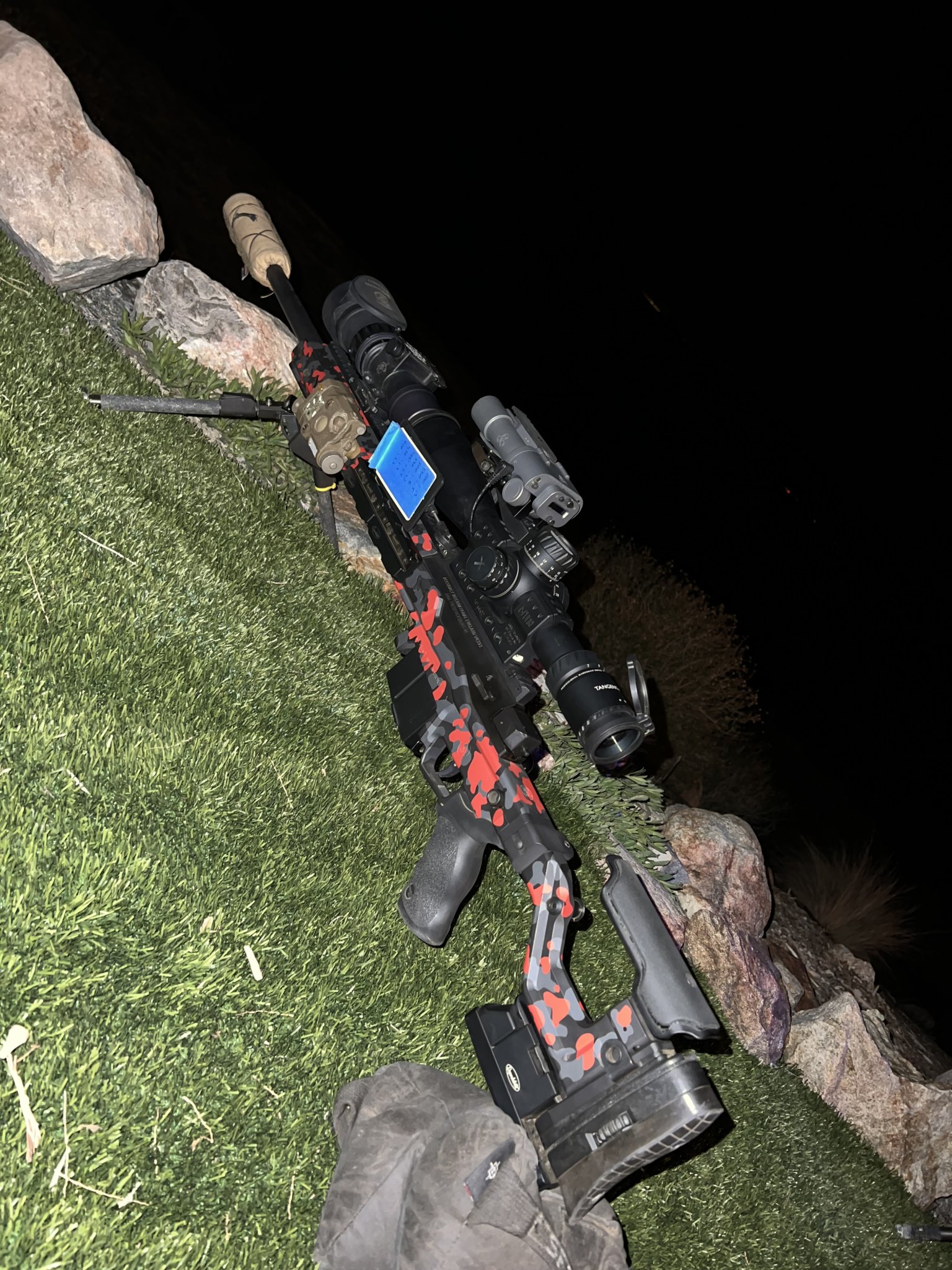

So I was between the ATX and Zeus. I actually ordered an ATX and then cancelled the order after starting to look for accessories and finding them non existent and or insane wait times. The Ai threads here are a support group it seems like.
Couple things that swayed me.
I lusted after an Ai for an about 2 years. I finally got to shoot an AI Ax in 6 Creed. I was disappointed, the bolt was clunky and Heavy and the chassis I didn’t like. Just didn’t fit me at all.
I also got to shoot an Arc Nucleus, an impact 737 and a Gap Tempest. All 3 felt better than the AI to me.
Also the lack of being able to change triggers I didn’t like.
I sat down and thought hard about what purposes I wanted it for. I wanted to get into Prs and matches.
So I ended up with a Zeus and I couldn’t be happier.

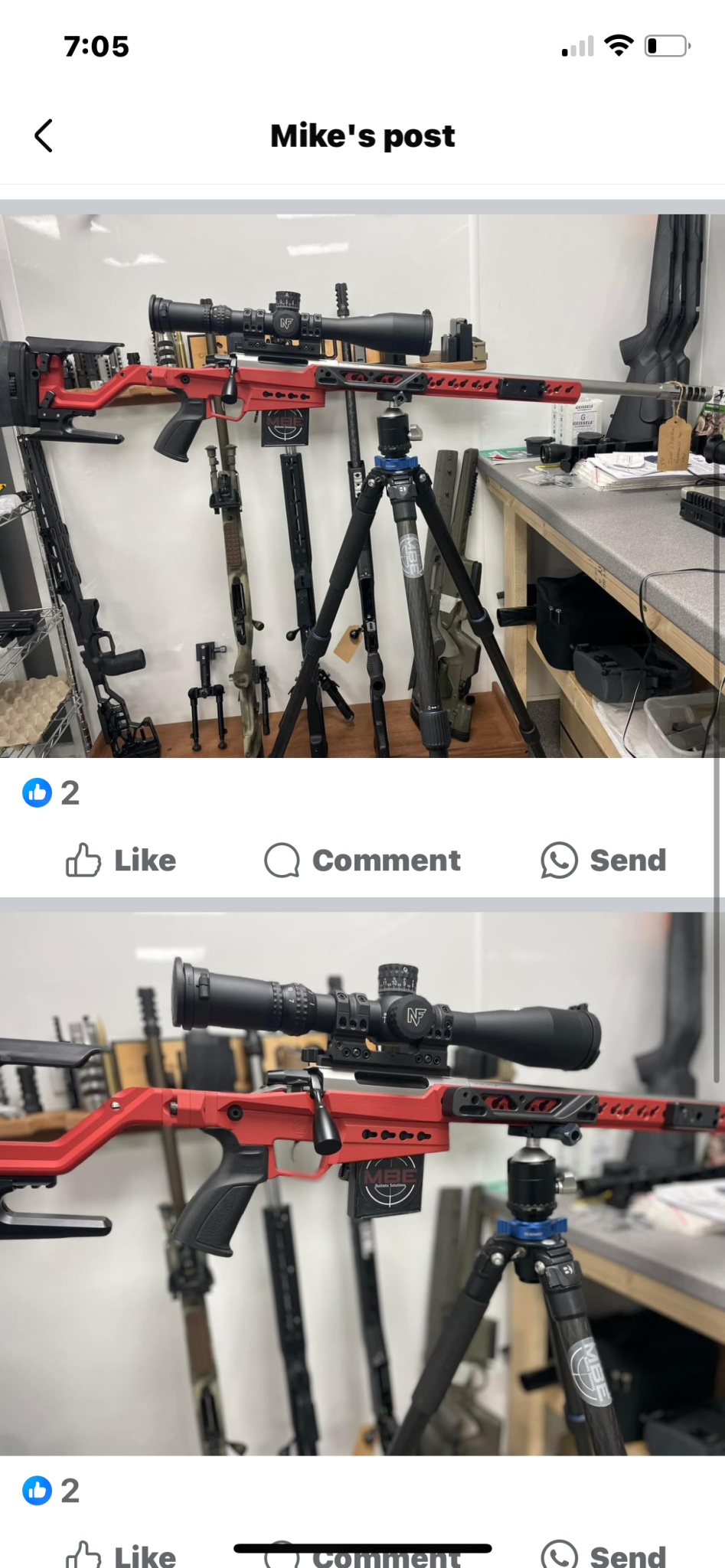

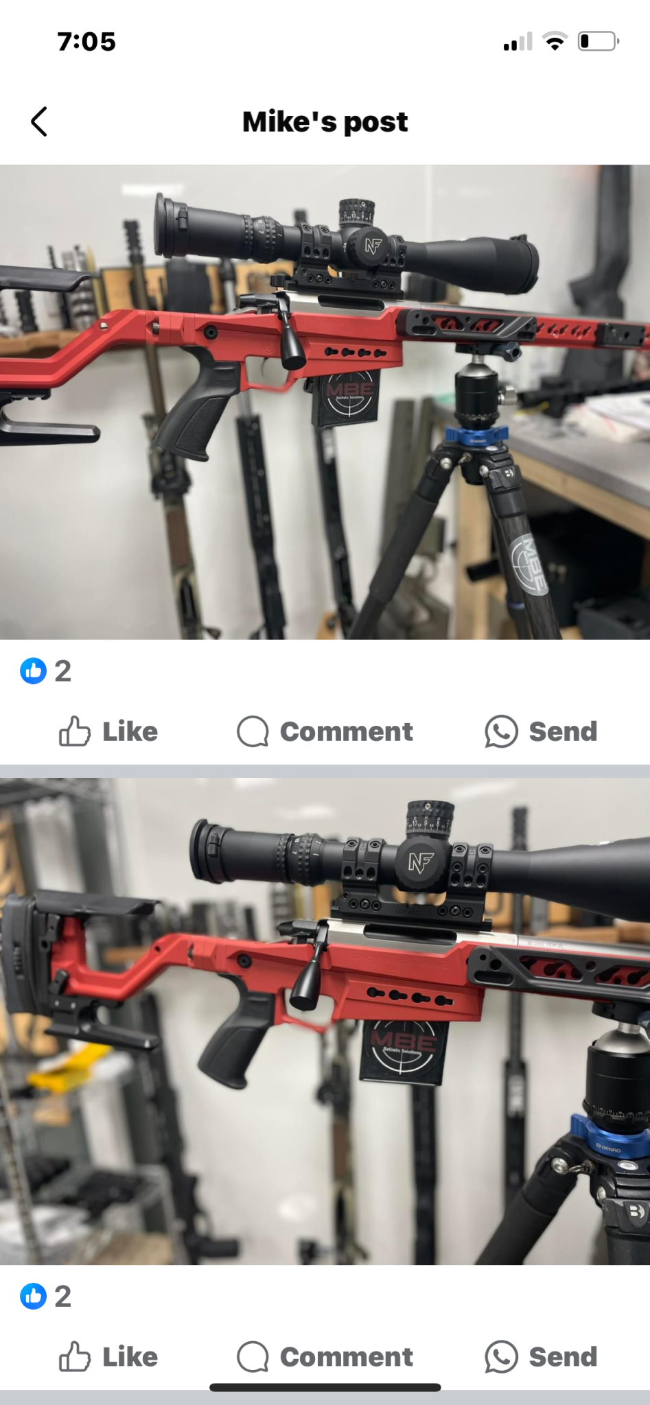

Yes but you’ll have to watch for when @MOUNTIC or other members have them for sale. Or have a regular short action bolt and convert it
The Zeus would I’m sure be much cheaper and much more available in regards to that option. They say the atxc will have the ability to change bolt heads but it’s AI so that could come in the 2nd quarter of 2028 for all we know.
Here’s some that were for sale last year
