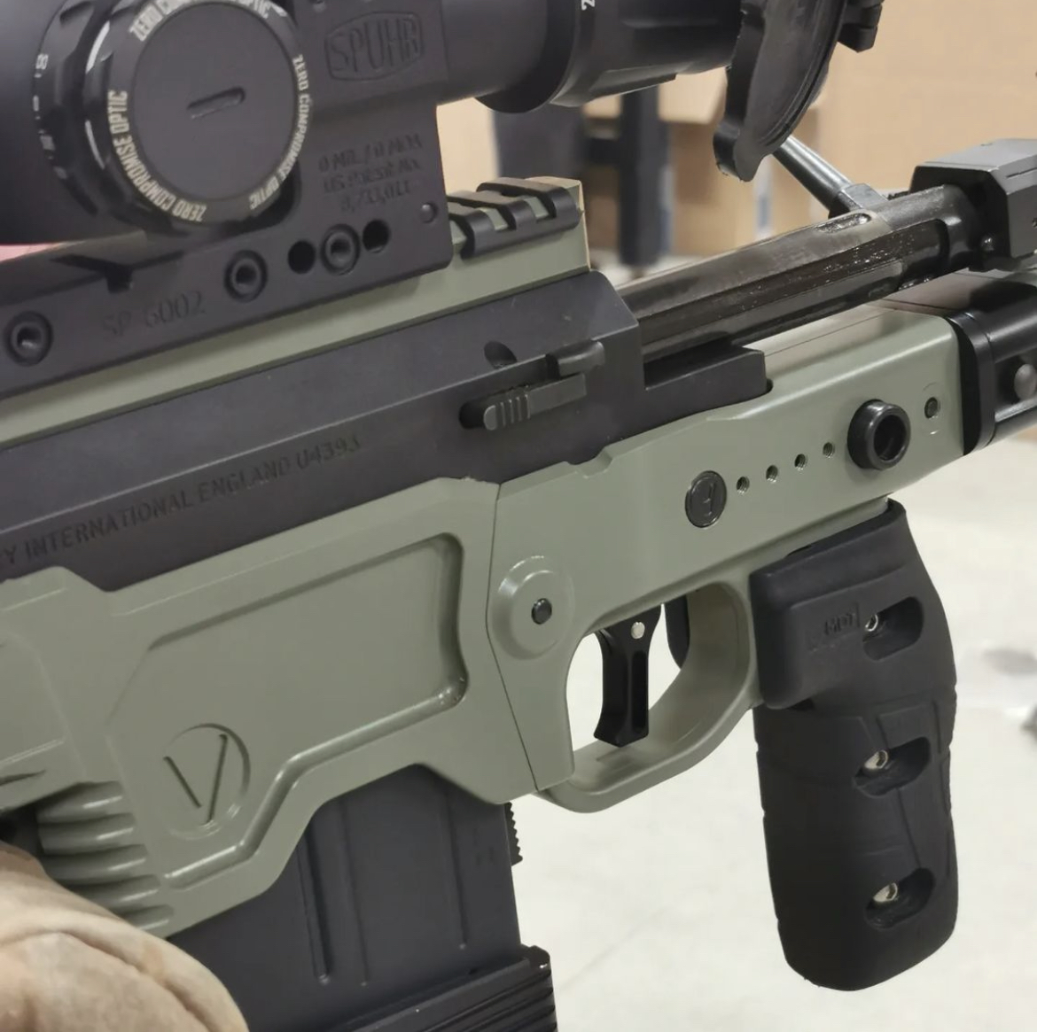

Just so everyone knows, GCP has the grips on hand from Norway, but we found out an unfortunate issue. There’s a fitment problem with factory AX rifles that we didn’t know about. The AT and AO/Vision chassis’ have a larger diameter front hole for the grip panel, which uses an M5 screw. For whatever reason, the AX chassis has a smaller hole which is juuuust undersized enough where the M5 screw doesn’t fit through. We’re talking undersized by 0.003”.
So at this point there are two options. One, will be modifying the design so the front grip panel uses an M4 screw instead. Christian is working on that now, but it will obviously take some time to machine. Two, the customer can machine that hole in the chassis slightly larger. It’s just a small amount, and the hole is non structural, but completely understandable that people wouldn’t want to do that.
It’s disappointing, and I apologize for the fuck up. If you’ve got an AX and were waiting for the grips, we’ll get a solution figured out for you. If you have an AT or AO/V chassis then it’s all good and the current version will work exactly as intended.

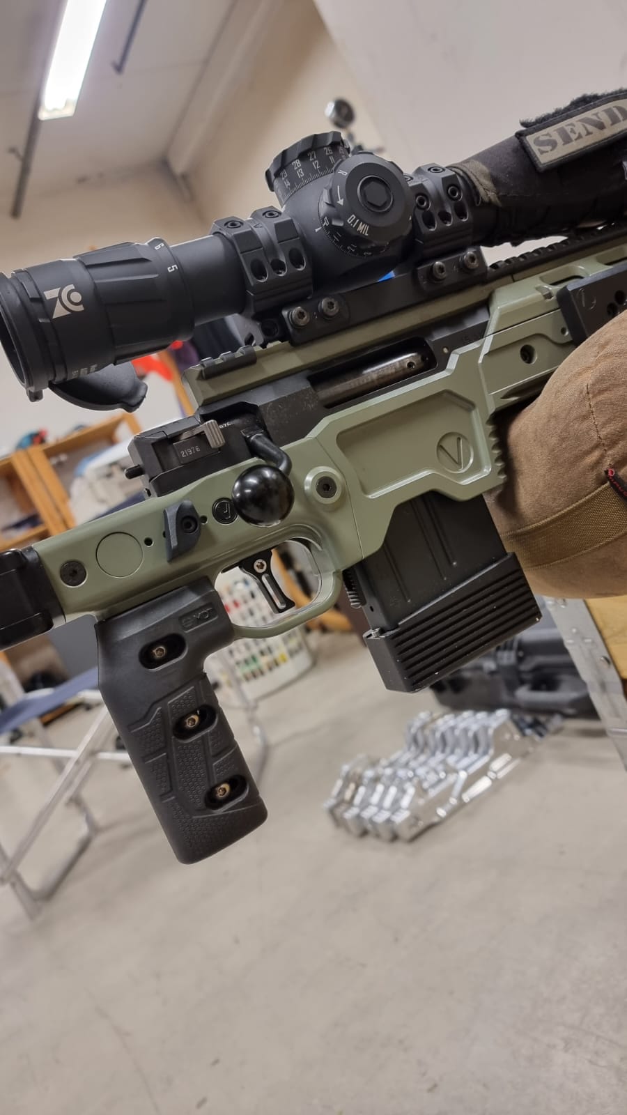

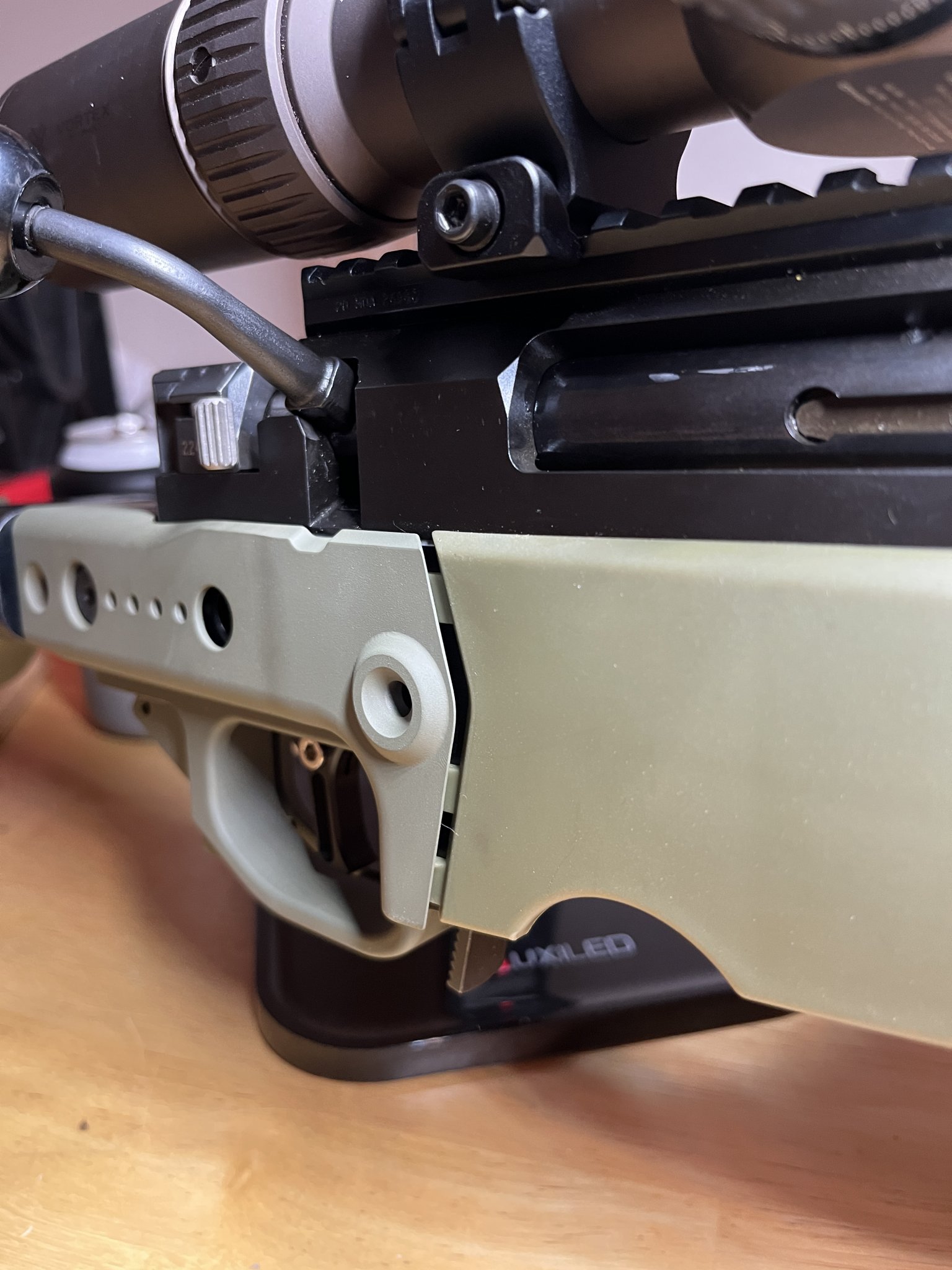

First, my apologies for this product not being right. There are a couple things going on that were missed/lost in translation with Vision in Norway.
The front internal relief slots that capture the 3 tabs of the AT front panel are missing, so it's not going to work. Please do not trim off those tabs on the panels, as they are needed to capture the front panel and hold it flush against the chassis.
The second thing is the grip screw was machined as M6 instead of 1/4-28, not the end of the world, but there wasn't a correct screw included. Rick at GCP was planning (or should have already) sent them out separately.
Unfortunately we'll have to ask you to send the grip panel back to GCP, and we'll get you the updated correct version as soon as they're done.

For anyone else following who has already ordered or was planning on ordering the Vision AI grip panels:
- If you have a Vision AO/V chassis or original Obsession chassis, the current grip panels that are in stock now at GCP will work. These use an M6 grip tang screw.
- AT and AX users will unfortunately need to send their grip panels back, or continue to wait a bit longer for the corrected and updated panels which will have the smaller front screw size, tabs for the AT, and grip tang screw modified to 1/4-28.

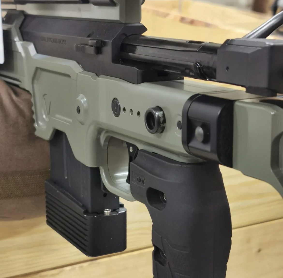

I received my grip mod and installed it on my AX with no issues. The bolt went through the rifle fine. Not sure if there is a difference with build date and hole size. As for the grip bolt it was a simple matter of stopping at the hardware store for an M6x25. Cost 35 cents.
Thank you to GCP for the help and the great product. I’m looking forward to more products from them.

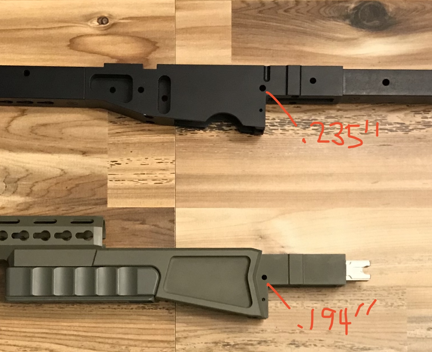

That’s awesome to hear! I’m curious what the hole size was, on all the different AXs we measured they were all 0.194”, basically exactly an M5 dia hole but with Cerakote thickness on the surface.

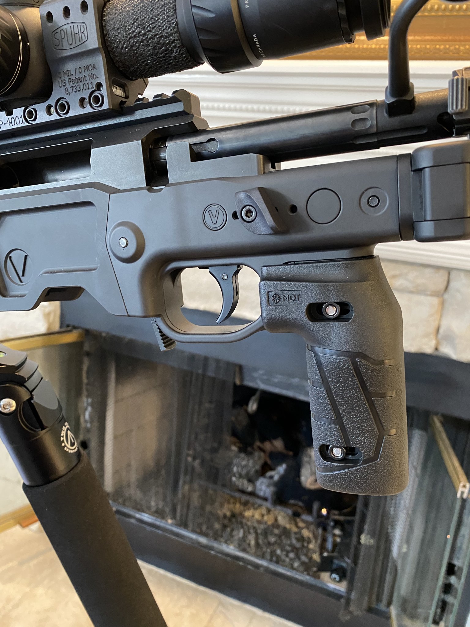

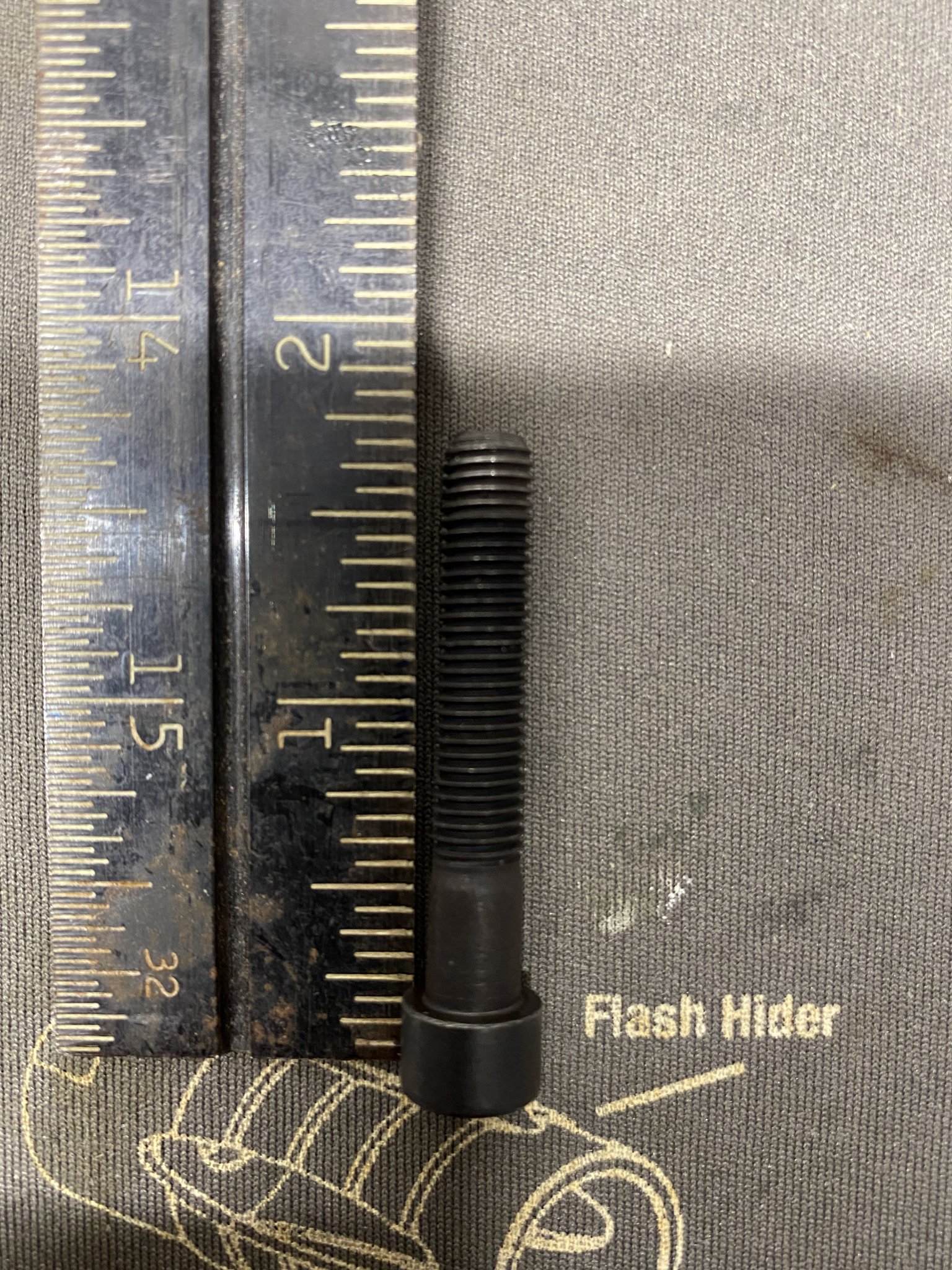

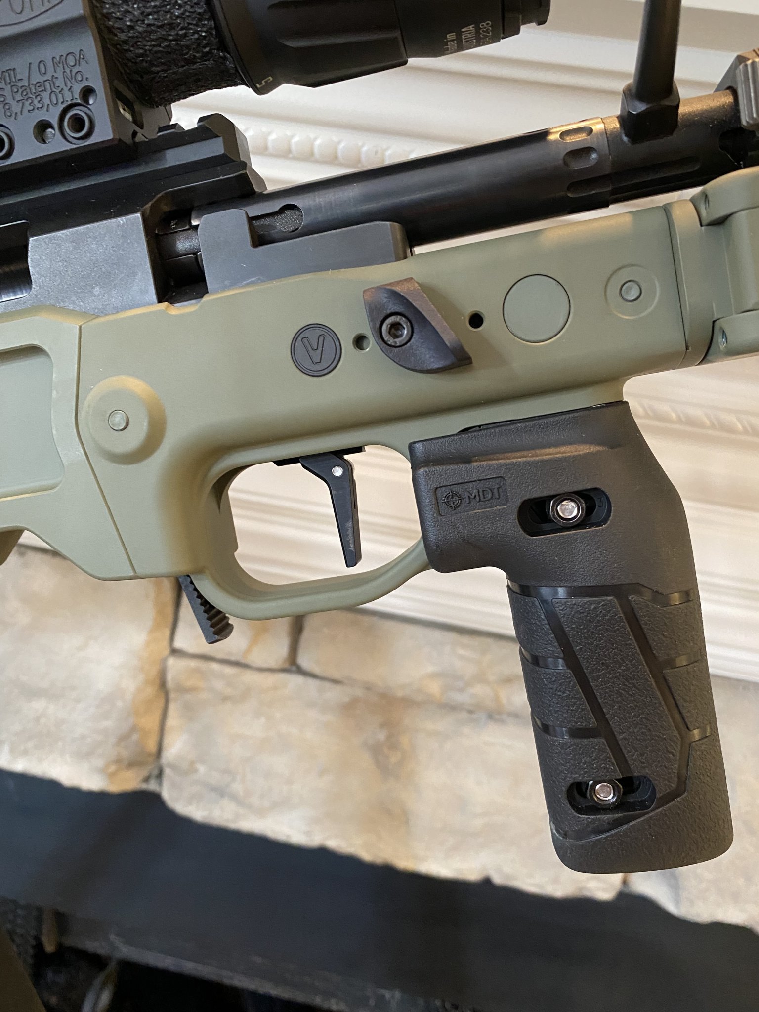

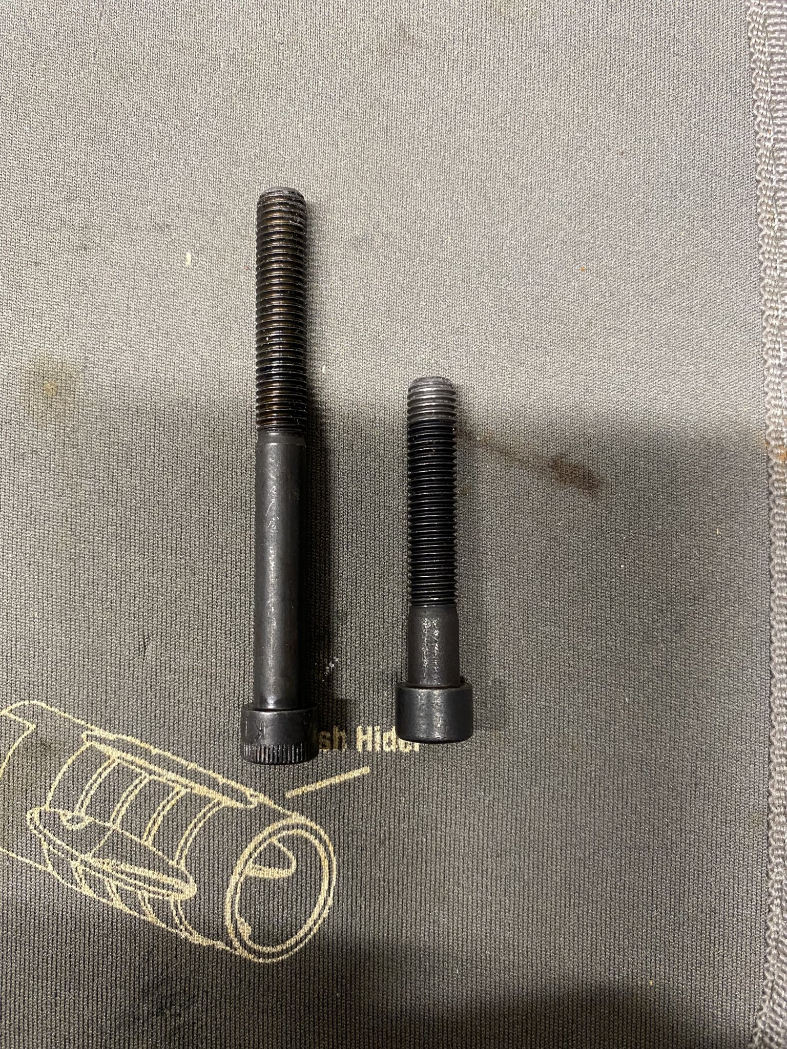

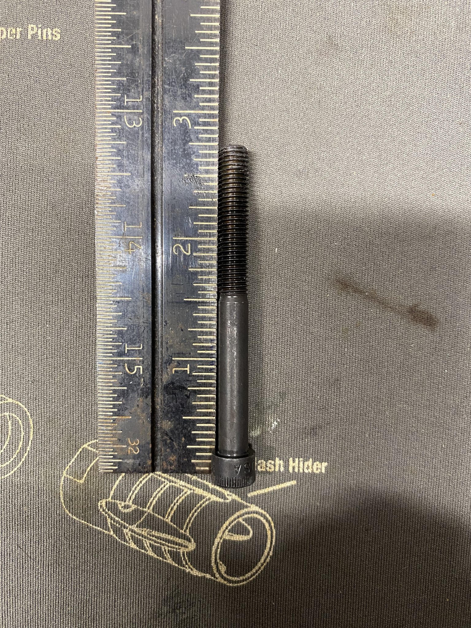

A heads up for those of you using MDT Vert grips. The screws are different lengths depending on the model you have. The 6 screw model that @Krob95 is rocking uses a shorter screw. The 2 screw model “Premier” uses one a bit longer. I pulled one of each from a couple rifles for reference. Hope it helps.

My AXMC seems to be .194 if I am measuring it correctly and it’s a 14 I believe
Thanks for measuring. Yeah unfortunately I only went off my AT and AO chassis when I designed the grip panels, I had a brain fart and didn’t think to confirm that the AX/AXMC had a smaller hole.

It will fit the PSR, but first you should confirm what the front hole diameter is in your chassis (this will only require the removal of the plastic grip skins).
If it's the smaller 0.194" dia, you'll need to wait for the revised version which uses an M4 screw instead of M5.
If it's the larger 0.235" dia, you can order one from GCP Rifle Co right now, they're in stock.
