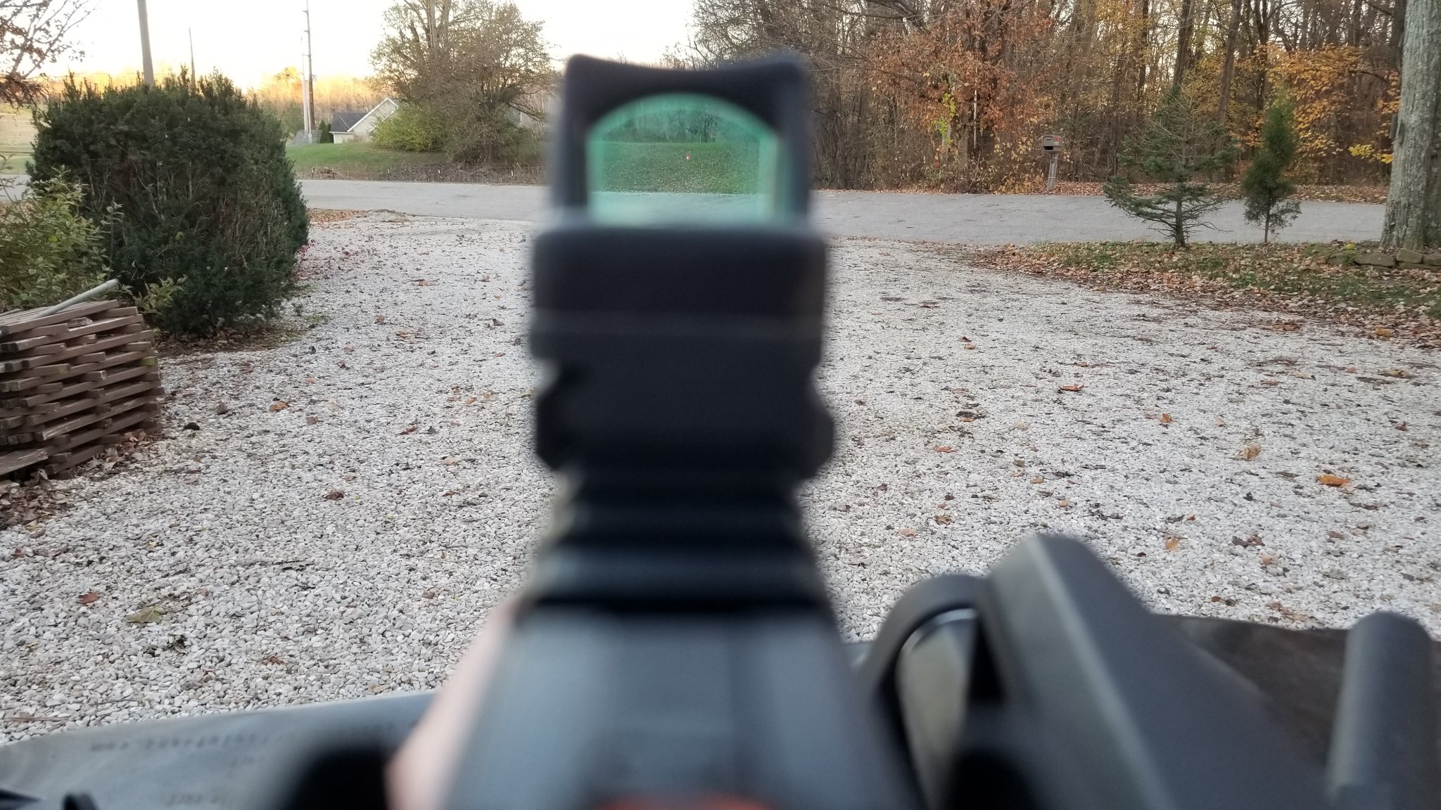

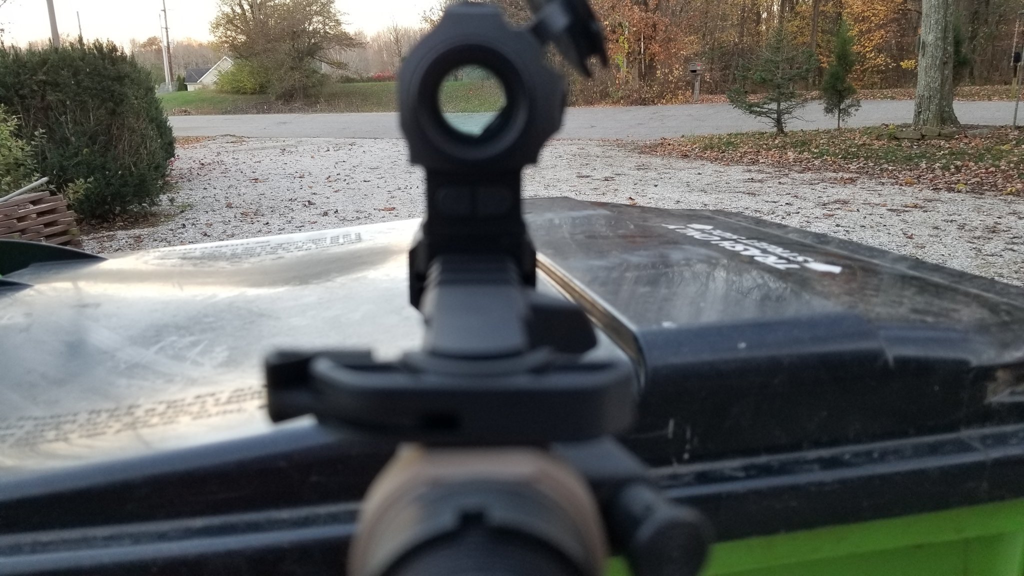

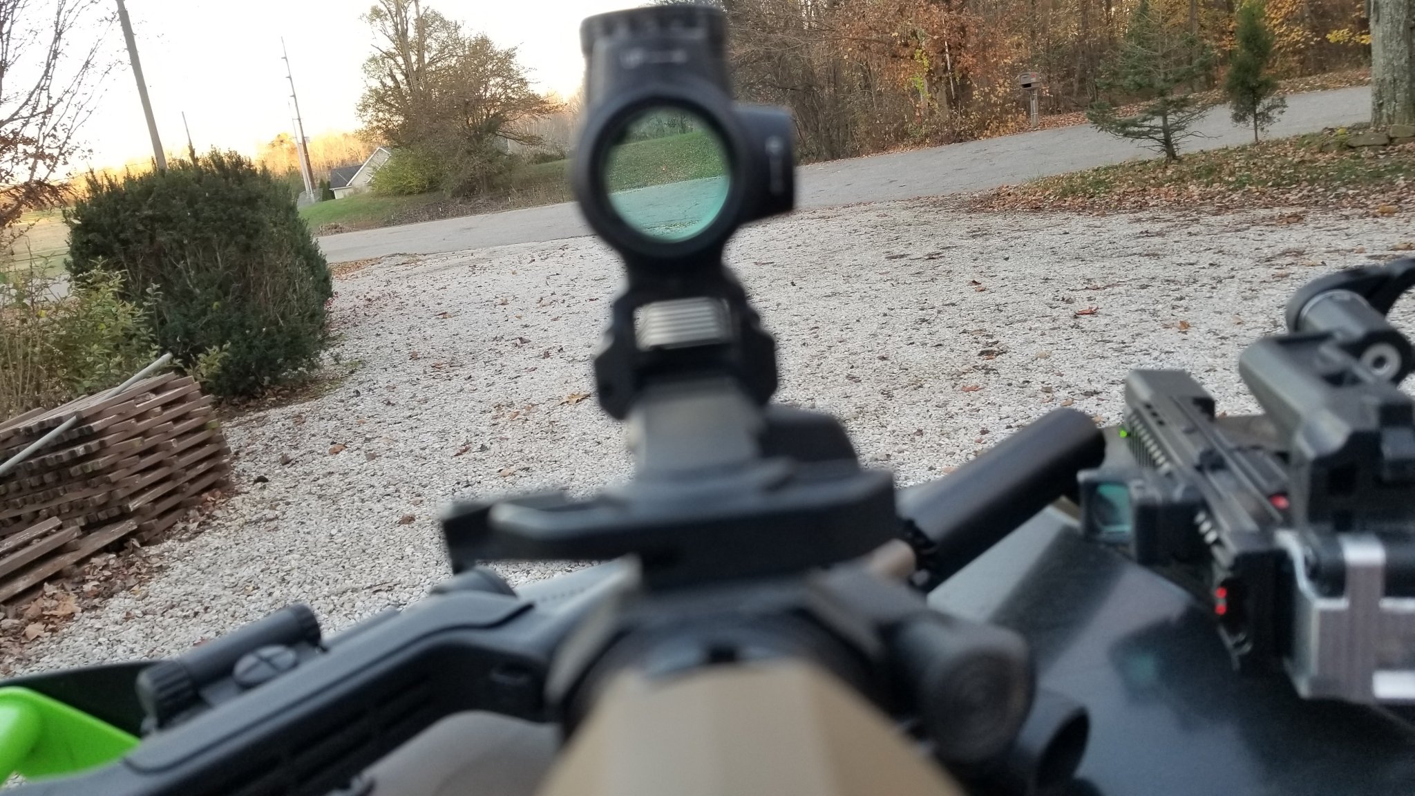

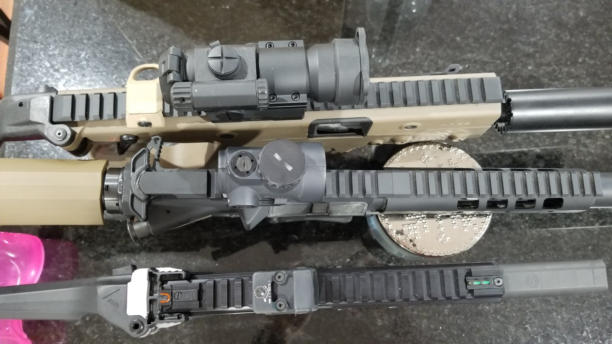

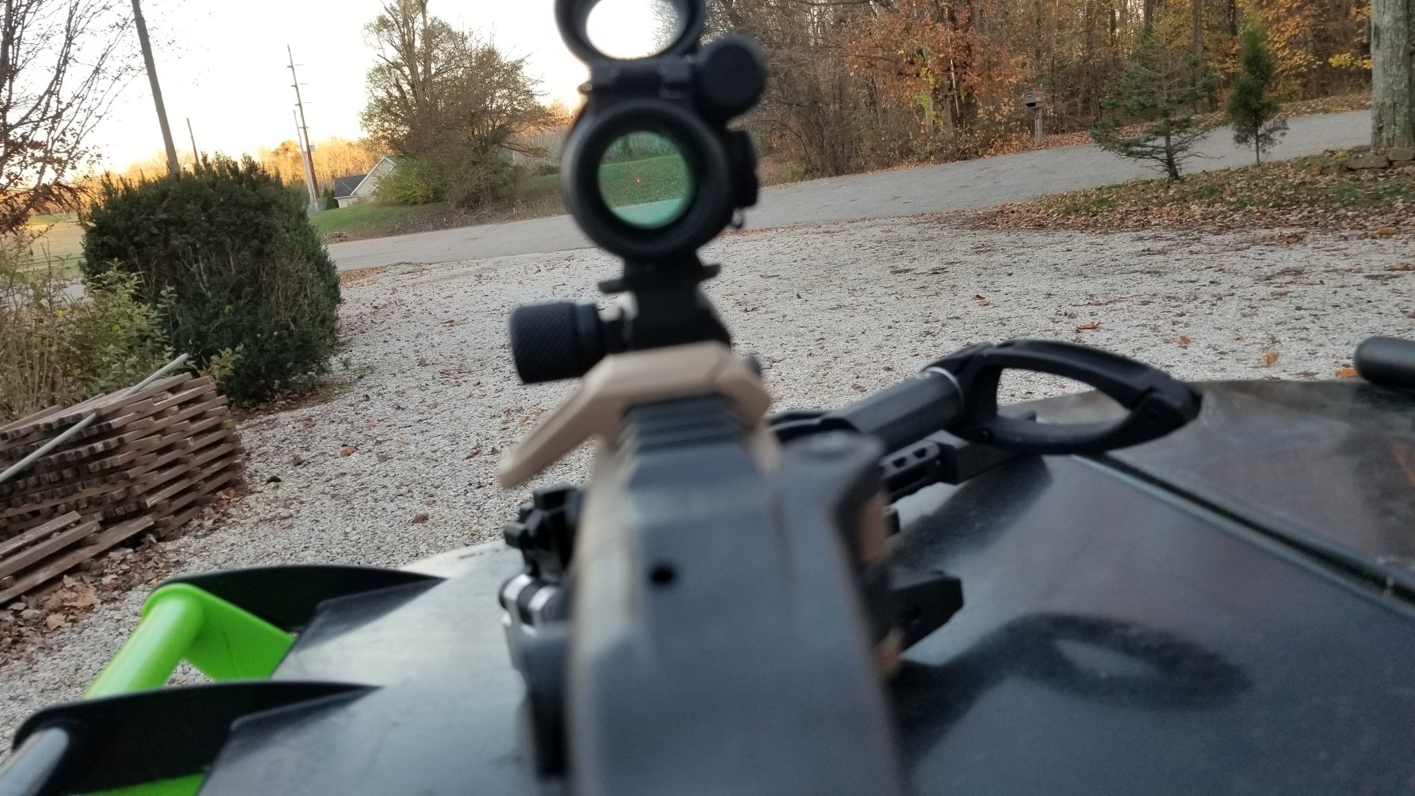

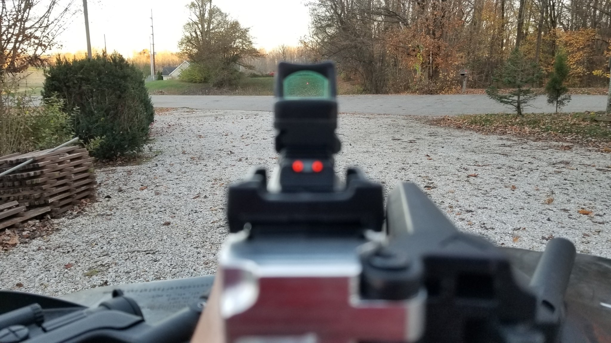

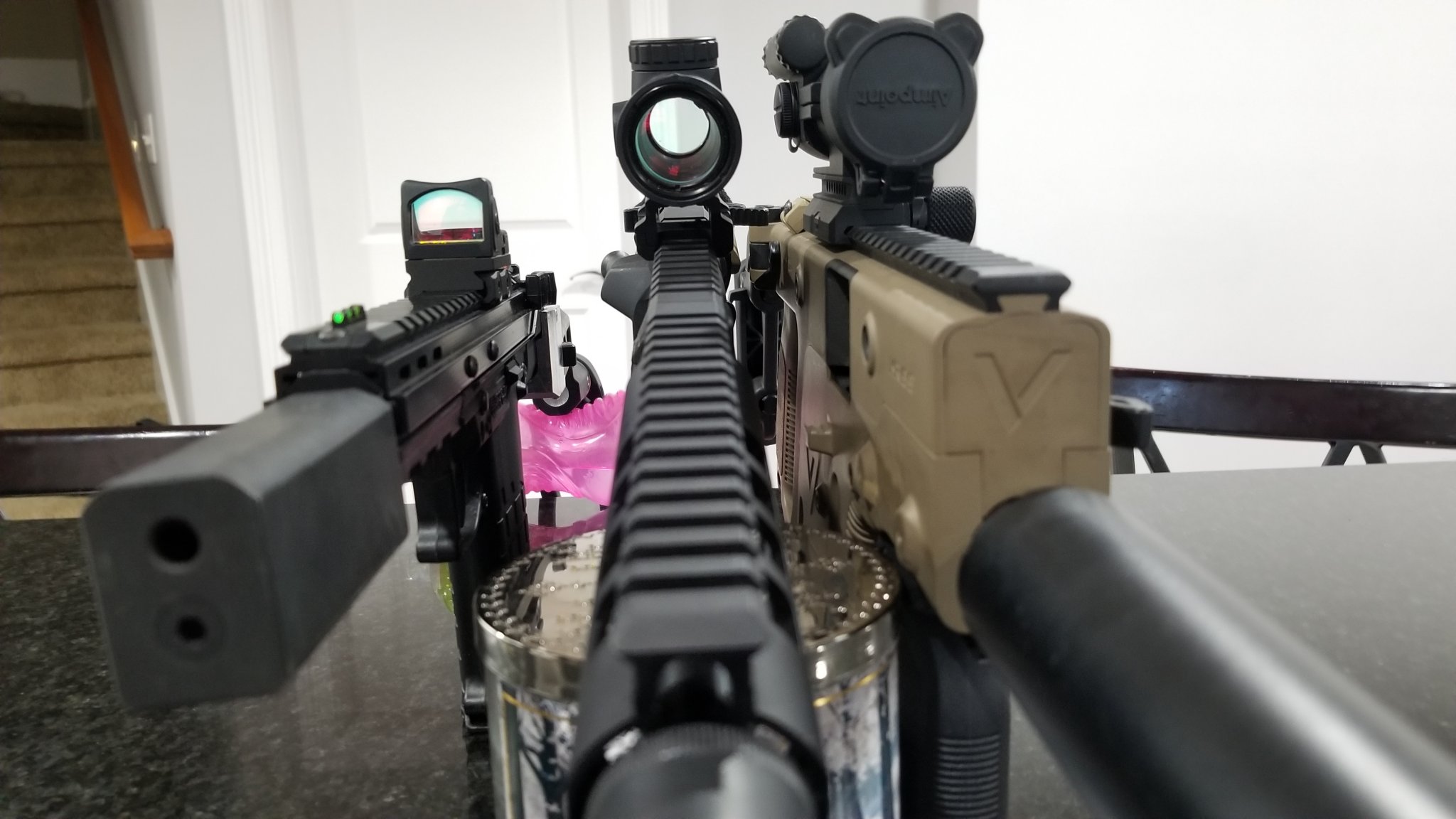

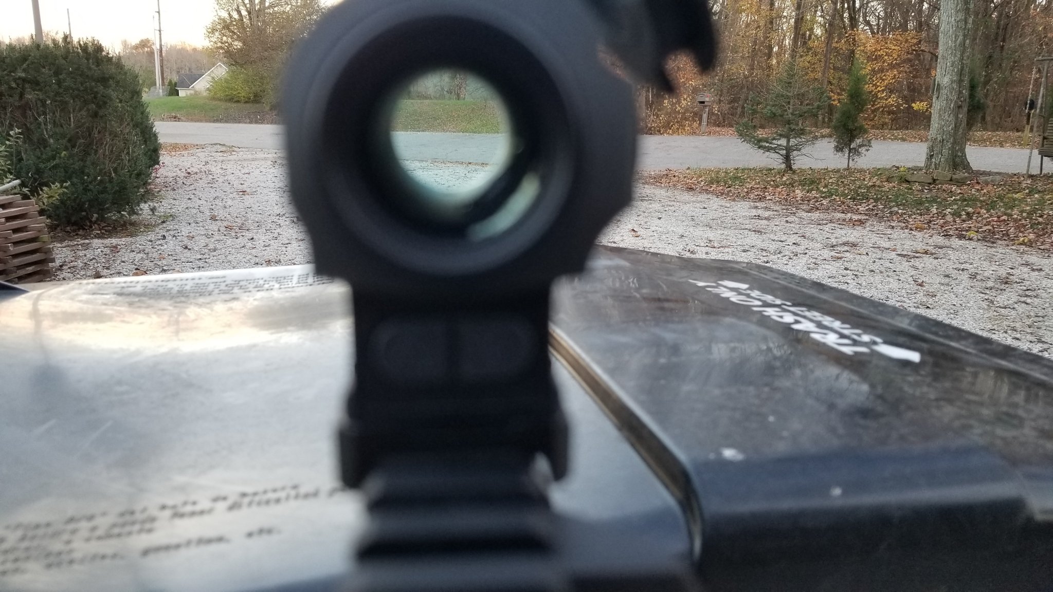

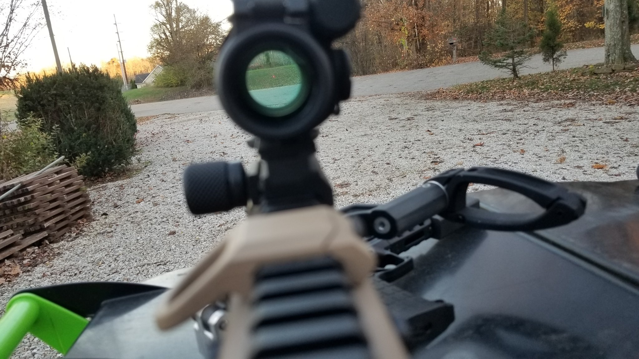

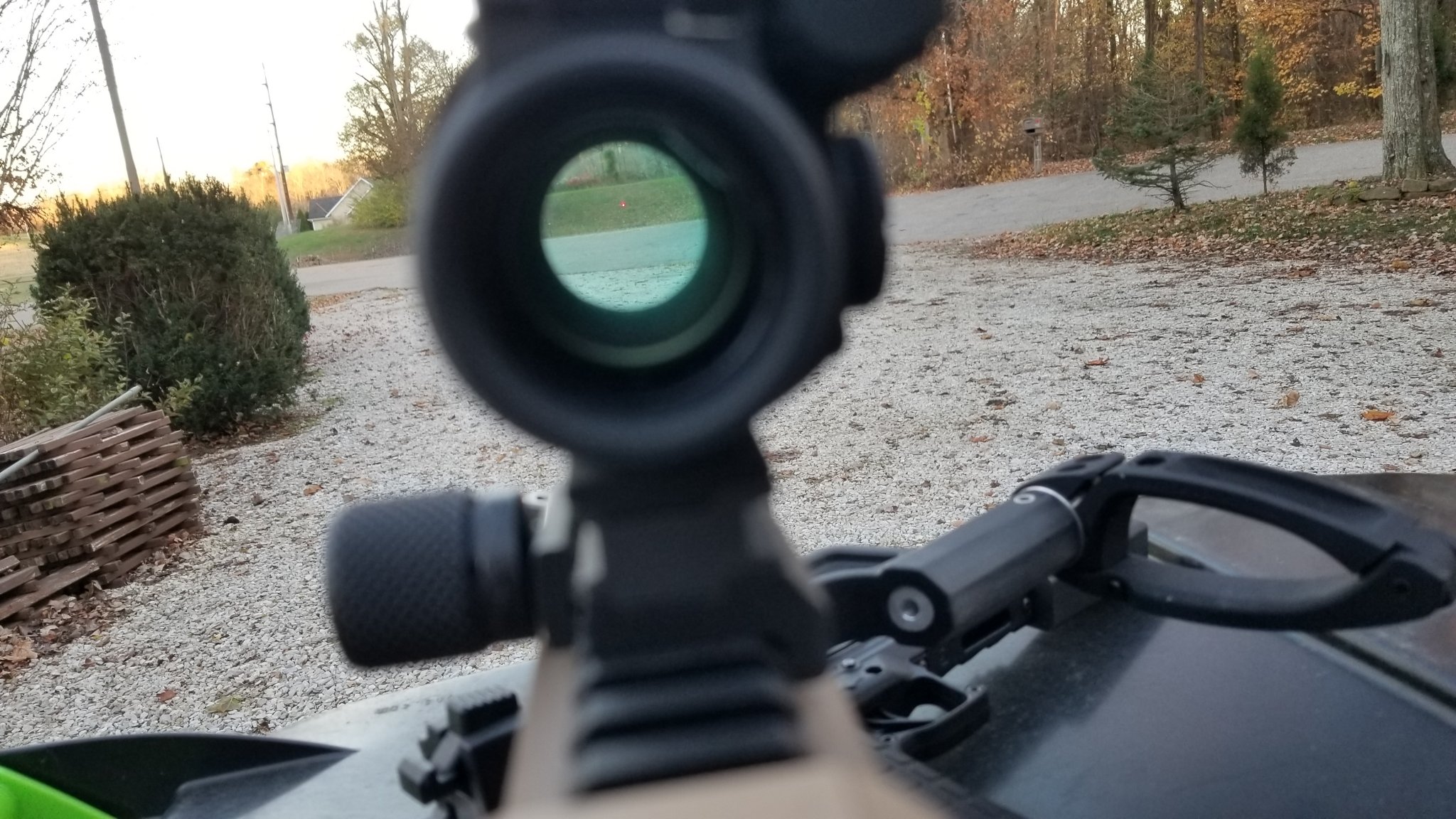

I snapped some pics of the mro and pro side by side, also threw the rmr in there for comparison since no one else seems to like it (it has a role, just not as replacing either of the other two).
Also threw a sparc ar in there because I think it's a pretty good budget option.
For reference, the hillside is about 70 yards away, dots adjusted to a good shooting position for me, not too bright, it's maybe an hour and a half before sun down.
Multiple distances away, depending on how close you run your sights.
