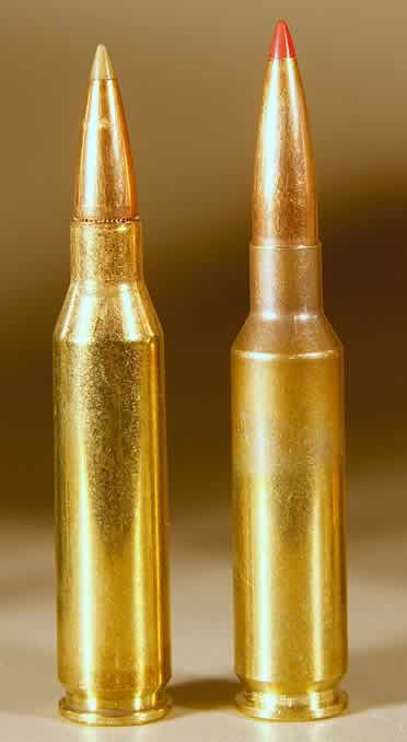

This morning was a practice session for some of our local precision rifle shooters. We were running some of the stages from last weeks NRL Borderwars match. The shooter next to me had a blown primer on the last round of his stage and got a faceful of gas and particles when he was NOT wearing eye pro. While he went to his car to rinse his eyes out, myself and another shooter recovered his rifle and brass cases. He was shooting a Rem 700 action in 260 Rem. We pulled the bolt and could see the case with the blown primer was still in the chamber. We pulled the bolt and the other shooter got a cleaning rod and a light tap got the case out. The case was intact but the primer was blown out. Then we noticed that the blown case was a 6.5 Creedmoor case! What happened was someone had dropped a live 6.5 CM round on the ground which got picked up and put on the table behind the firing point. The shooter also had his ammo on the table and when he was loading his mag, he thought the loose round on the table was his and loaded it in his mag, hence firing a 6.5 CM round in a 260 Rem. chamber. The shooter gathered up his stuff and drove home and I hope that he doesn't have any eye injury.
This is a lesson in why shooters should ALWAYS WEAR EYE PROTECTION. It was a hot day and we have to wear masks at all times at this shooting range so a number of shooters were shooting without eye pro because they were getting fogging issues. Regardless of fogging issues I'd rather deal with fogging than an eye injury.
EDITED TO REMOVE REFERENCE TO A BLOWN EXTRACTOR- I've communicated with the shooter and the gun DID NOT have a blown extractor. I assumed it was trashed since we had to tap the case out with a cleaning rod- but the shooter said that he checked his rifle after attending to his eye injury and the the gun extracts normally now. So all it did was blow a primer which ejected gas into the shooters face.
The range is owned by an Indian tribe so they set the rules that we have to follow or the state or the tribe could shut the range. Just take the mask thing out of it, we should always be wearing eye pro when shooting no matter what.
One thing I learned was a 6.5 CM will fire in a 260 chamber but bad things happen. I have also seen a 308 fired in a 30-06 chamber with no ill effects. It just sounds a little funny, the bullet doesn't go where you thought it was going to go, and you extract what looks like a straight walled case from the chamber.
That's wild. Out of curiosity is there anything that will fire in a 6.5 creedmoor gun that would cause similar problems? I imagine 6 Creed would get a little weird....
Kind of scratching my head how this is possible. The body shoulder junction of the Creed is quite a bit fatter than a 260. I wouldn't have thought it would chamber. Time to go pull some rifles out of the safe.
You can use the same headspace gauge for 6 creed and 6.5 creed so I'm pretty sure 6 CM will chamber and fire in a 6.5 CM, but the bullet won't seal in the barrel since its smaller so you'll probably get a funny sound and the bullet will come out slow and unstable.

Reloads? Possible he ran a 6.5 case through his reloading process? Even if he trimmed to length, a lot of brass moving and certainly different internal capabilities when done. Or not even trimmed and pinched the bullet. Both could spike pressure and blow a primer for sure.
I have run a 6 creed through my 6.5 die by accident...it works. Also recently think there was a thread about a guy accidentally running some 6.5 brass through his 6 Creed die. Just a little case forming.

Just checked... and my 260 will chamber 6.5CM. Not even that difficult- it just felt like a case that didn't get the shoulder bumped back enough. If you were running fast it wouldn't have been enough to raise a red flag. But it will only do it on factory rounds. I ran a once fired piece of brass through a full length sizer and it would not chamber. As far as my 260 having a over sized chamber-- it could, but the brass resizes very easily and only takes the +.004 competition shell holder to get the .002 shoulder bump. After measuring it looks more like the 6.5cm round is under sammi size.
It surprises me that it caused pressure though, with the same projectile, OAL, and powder charge I would have thought it would sound weird and fire form. It pays to be careful.
Because the shoulder of the CM is shorter, it caused excessive head space. Near as I can tell, the firing pin hit the primer, knocking the case forward. As the case ignited, the primer let go, since it wasn't supported by the bolt face. Then the hot gases blew what there was left of the primer, out between the bolt and inside receiver walls. When it went off it sounded odd, and there was a blast of gas into his face, but it sounded (noise wise) like a round going off.
We all thought initially it had to be a bad load or something. It wasn't until I walked him back to his vehicle, and he asked to see the brass, and started cussing that it was a Creedmoor case, that it dawned on me what had happened. He was shooting small primer .260 brass, so it was blatantly obvious to him what happened as soon as he saw the case I had placed back in his box.
