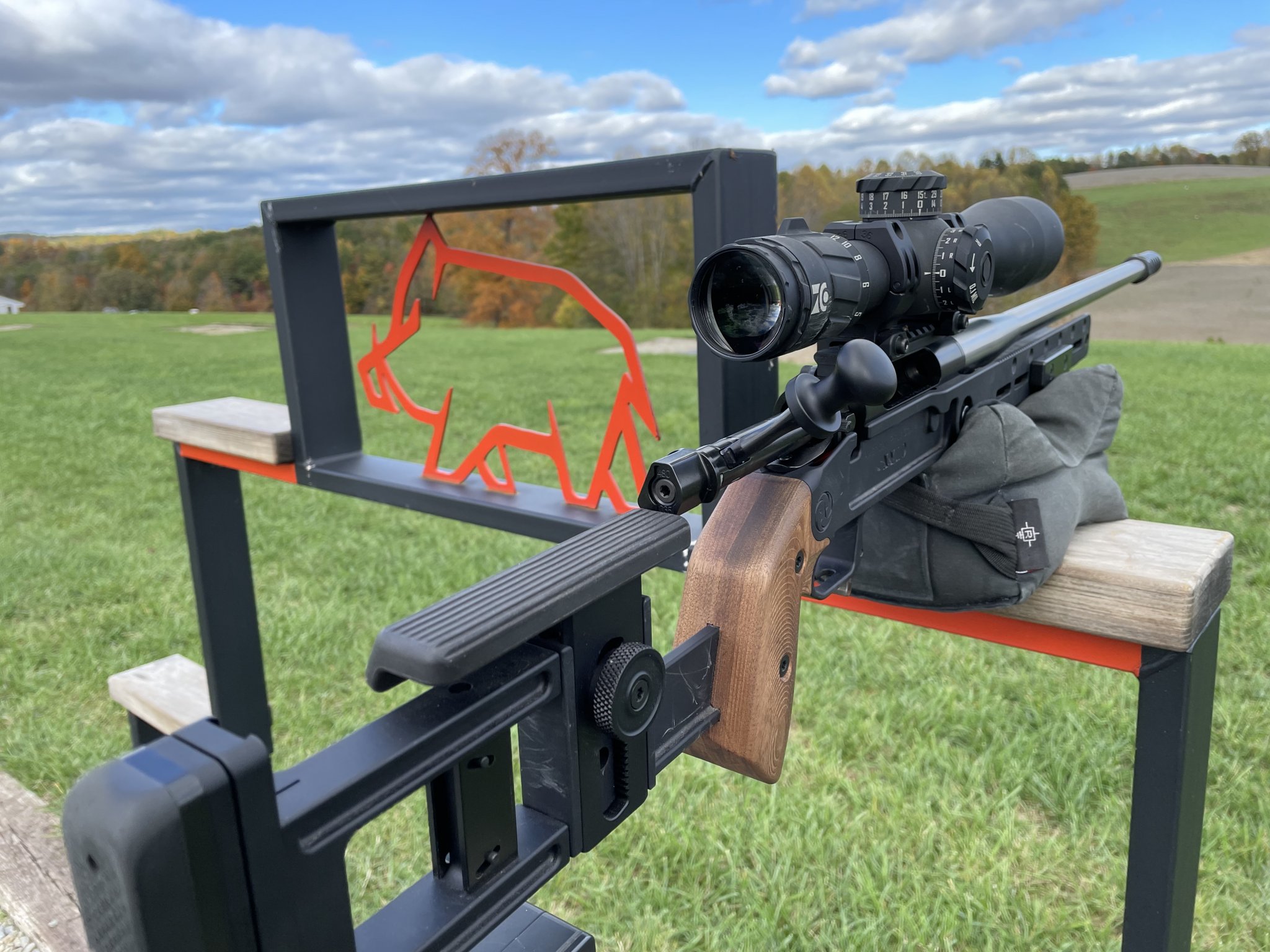

Got pics in the chassis?

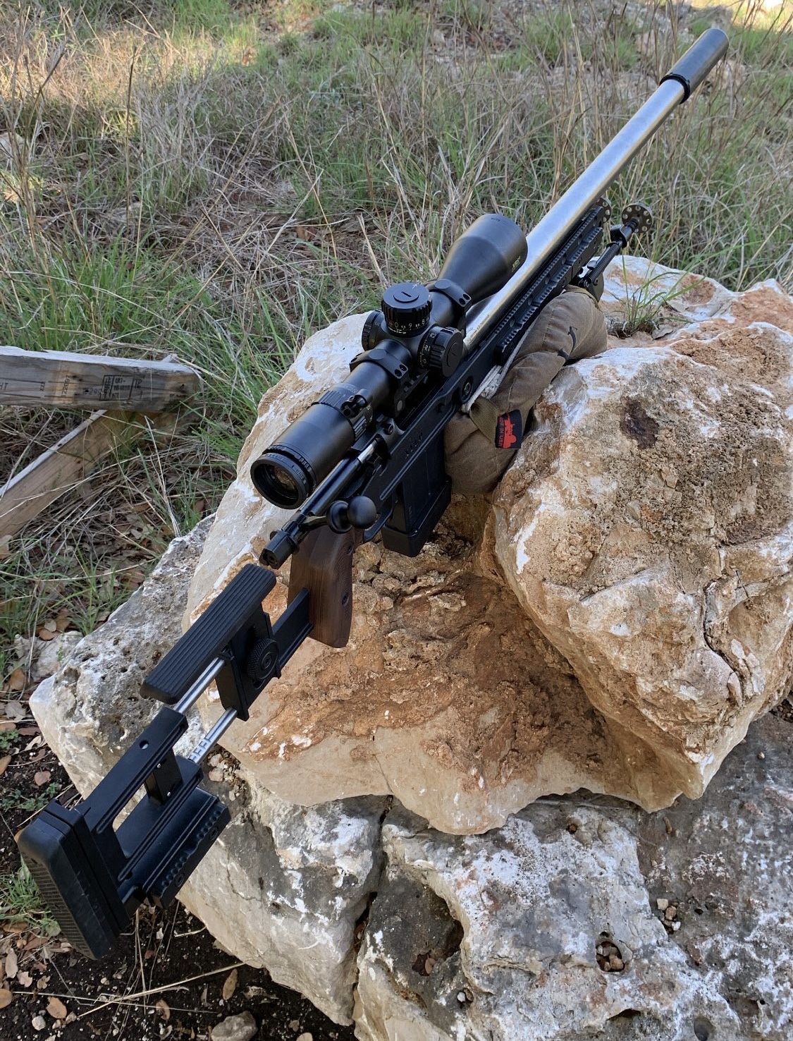

I have a full Archimedes rifle and really like it. When my mcmillan stock failed on my hunting rifle I threw it in a XLR element MG, ordered a 300wsm barrel from LRI and swapped bolt heads.
I used it to take a elk this year. It's by far my favorite rem clone action. Love the mechanical ejector and crf.

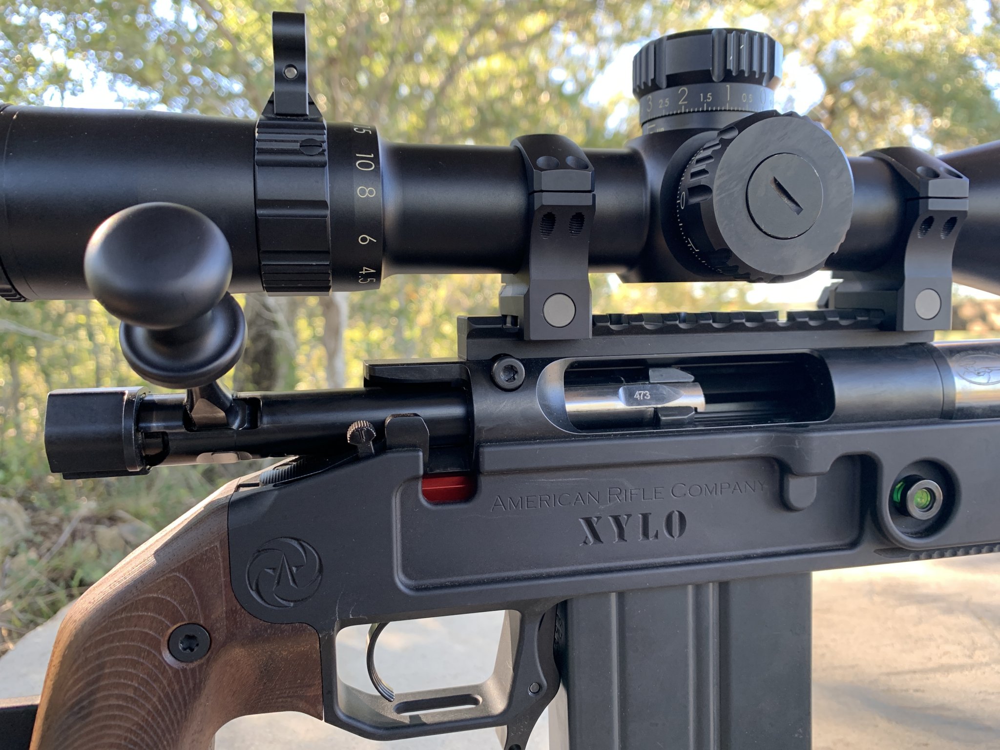

For whoever was wanting to see an Arch in a Xylo

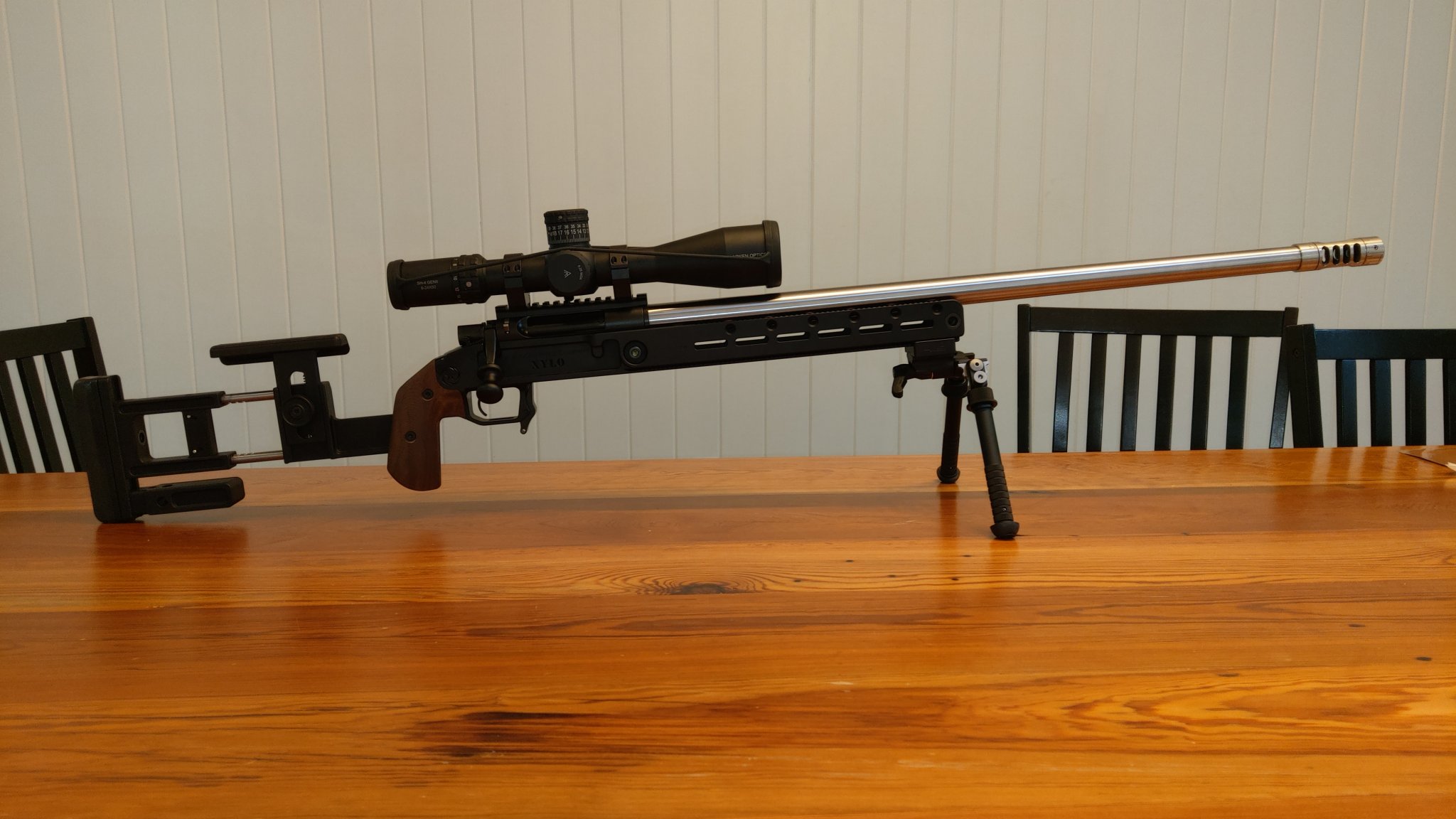

What PVA barrel do you have on this gun?
I have two, a Nucleus I used in a 6CM and a Archimedes I just finished in a necked up 6.5 PRC, both lefty and both are outstanding. They've been entirely reliable and I don't regret buying them at all. I might add that what someone else said about the "smoothness" of the actions is correct. For reliability, they purposefully have some play in the bolts but this means you don't get the same glass-on-grease sensation as you do from some other actions. I've played with both and I don't think you go wrong with either, however I like the thoughtfulness that Ted puts into his actions.
