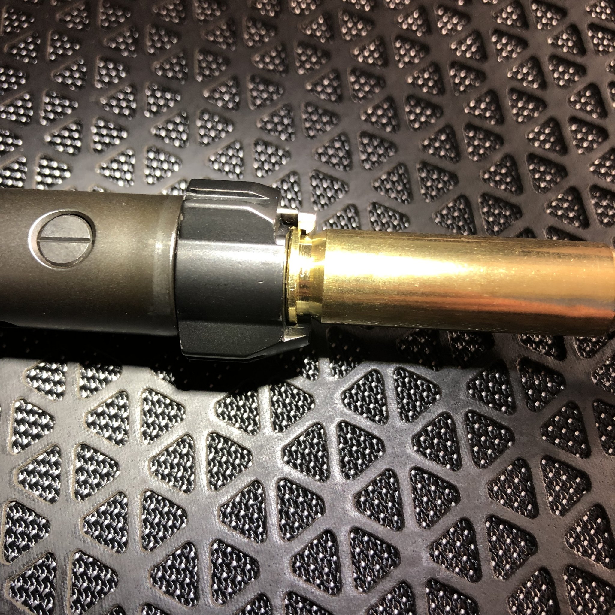

I put the barrel on yesterday, after setting headspace, tightening the BARLOC, my BARLOC clamp has no gap, and the two sides look to be touching against each other. You are right, when installing the BARLOC with Nut, you are to tighten the nut until you can fit the nut wrench in between the gap in the clamp, then torque the clamp screw to 90inlbs. I wonder if, with the shouldered barrel using the BARLOC clamp, that I'm not getting enough forcing function due to those two points touching under torque?

Without the gap, you are not getting enough force.

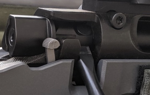

Sir, I could not help but notice that your rifle seems to have some sort of metallic arm sticking off of it on the left hand side of the action. Perhaps the folks at ARC can correct this for you at the same time as they perform the other fix. :p
Edit: Lemme say G'damn to the folks at ARC... add me to the one day turnaround list. I sent in my complete action (to include the Calvin Elite), and while UPS took their sweet time getting it to ARC, Ted and the crew sure as hell didn't take any time getting it turned around... just got the shipping notification that it's headed back my way after only a few hours onsite. Bravo to the ARC team!
Yeah it's weird... All my rifles seem to be afflicted with that protrusion... I did give her a facelift though. She looks good at least.

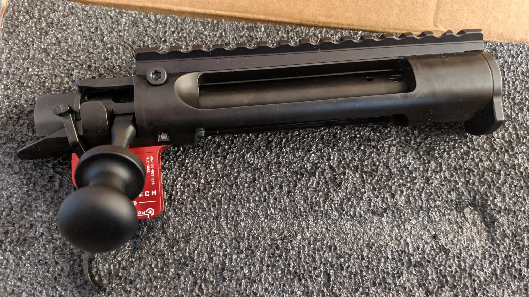

Just got my Long Action back as well. It is much smoother than before. Running a TT Diamond. Much smoother than both my Nucleus' (Nuclei?).
I was hoping ARC would have the updated rail too and have installed.

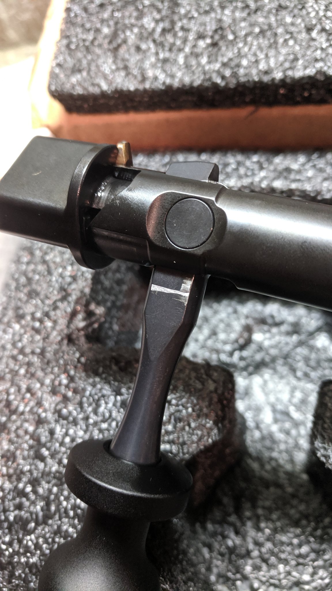

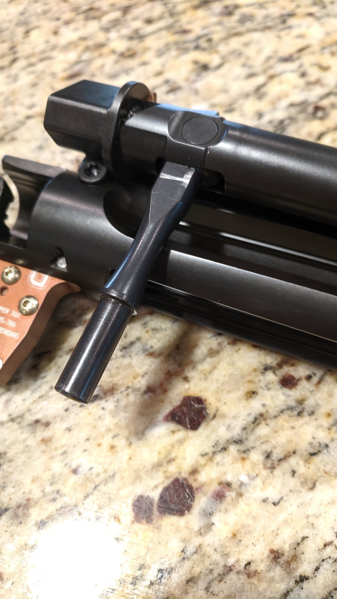

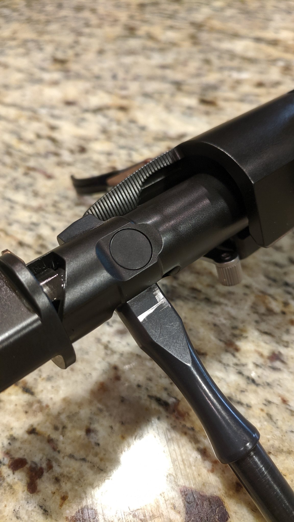

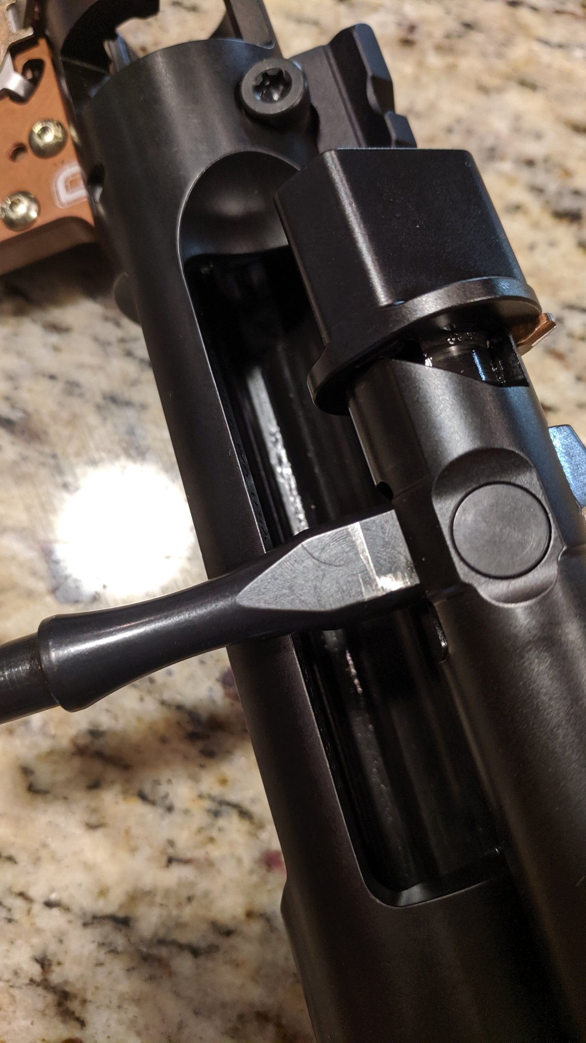

Just got my action back and the bolt handle has substantial wear down to bare metal. I was pretty upset about this as the action was going into a gun being given as a gift. I called ARC and apparently this is the result of running the bolt while testing the trigger. They said this is supposed to be a wear point. I wish they would have treated the handle to help prevent this. It's an awfully expensive action to have bare metal visible with the bolt closed.

I haven't sent mine in yet, but I'm pretty sure my bolt looks very similar just from cycling it. Mine you can't see when the bolt is closed and since the hardening they use is in the metal and not the finish, I'm not worried about it. I was planning on using mine anyway not entering it into beauty pageants.
Of note, when I covered the worn area with sharpie and cycled the bolt a bunch of times, it came back in the same spot.
I'm still not worried about it, but if you call ARC on Monday, I'm pretty sure they'll make everything right.

Mine is clearly visible with the bolt closed. It's right there on the top. No one is shotting in beauty pageants but this build was going to be surprise for my wife and I'd sure like to give her a rifle that didn't look used.
These comments are disheartening. This is a new action. Bare metal showing on a bolt handle without primary extraction. Blame the customer for a damaged finish.

It was the suggestion that it was there before being sent back. That is not a wear mark. There is no feathering, those scratches if happened during cycling would suggest to me a lay person in metallurgy that that contact area needs some work.

I added a pic to my last post. The one I have has a similar, but not as pronounced wear mark in the same place. I couldn't readily tell exactly where the rubbing is coming from. It's something different for sure, but there's never really been an action that works this way, so I'm sure there are going to be some differences.

I'm was looking at it closer and it looks to me that since they turned down the rear of the bolt a little bit it can now be push up to hit the action just barely. Looks like if the bolt handle was trimmed a few thousandths it couldn't reach the action to do this.

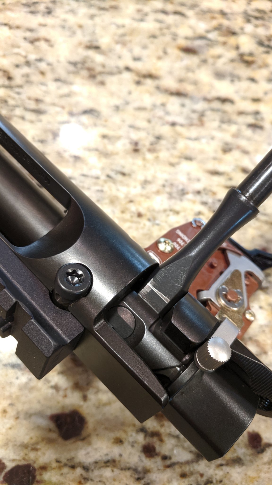

The lever touches the action as it slides. There is a corresponding ramp on the action, the arm touches as the bolt slides forward and backward.
The extraction thing is what gets me, that was the key feature of the design, it feels like we got the trammel of Archimedes instead of the lever.
That picture is straight out of the box and I dont have a single bolt action rifles that has bare metal on the bolt handle from running the bolt.
You should, the extractor cam on most actions gets the finish rubbed off of both surfaces. While the Arch doesn’t have an axtractor cam, can you not see that the bolt handle stops on the receiver body when in the full up position?
Yes, you’re out of line.
A few posts above yours.
I hadn't heard of anyone having extraction issues. Is that what you mean by this statement?
The action I received has 1/8" of free take up at the bolt handle before the lever does its magic and that only retracts the bolt ~0.031" and more than half of that is given away under the extractor.
