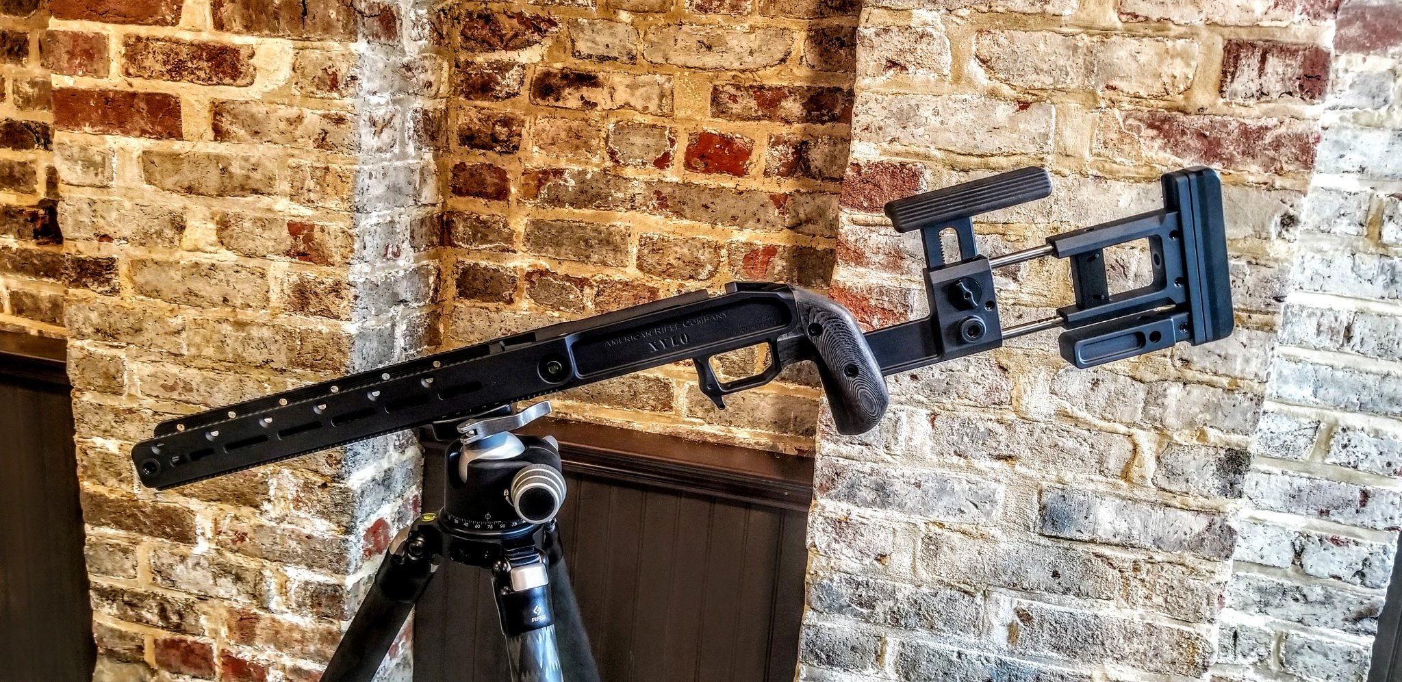

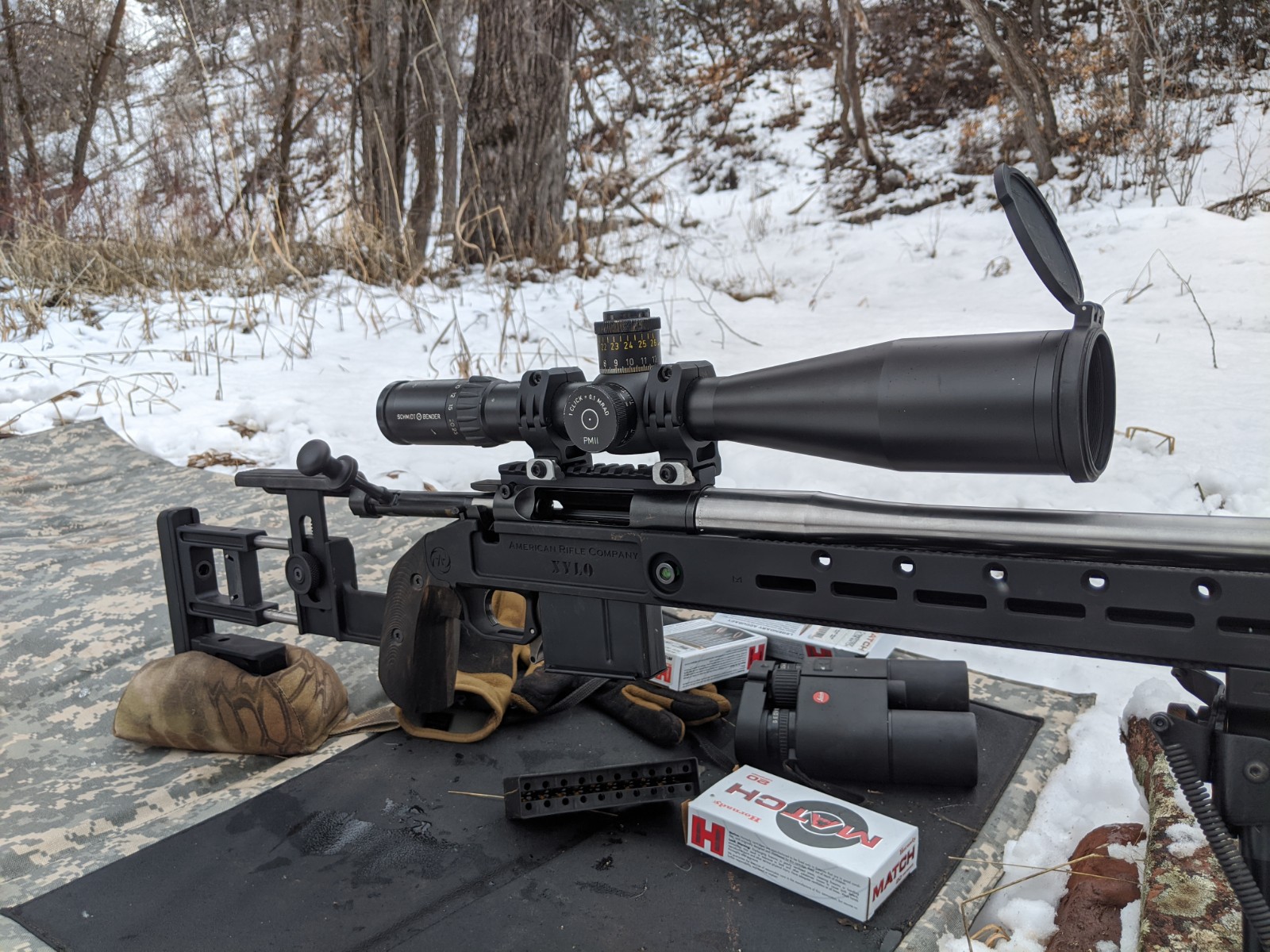

Just unwrapped my Xylo last night. Cant test run it for a while, but well worth the weight. Heavier than I personally wanted but it is a sturdy rig that I bet will work well for comps! Excellent fit and finish. Rear stock adjustments are quick and sturdy. Well done Ted and thank you!
Is there anything obvious that could be done to reduce weight without sacrificing rigidity?

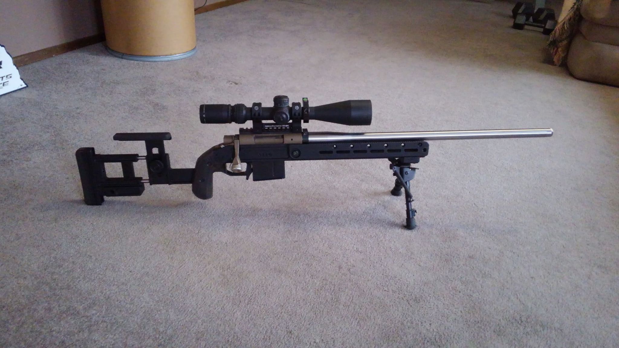

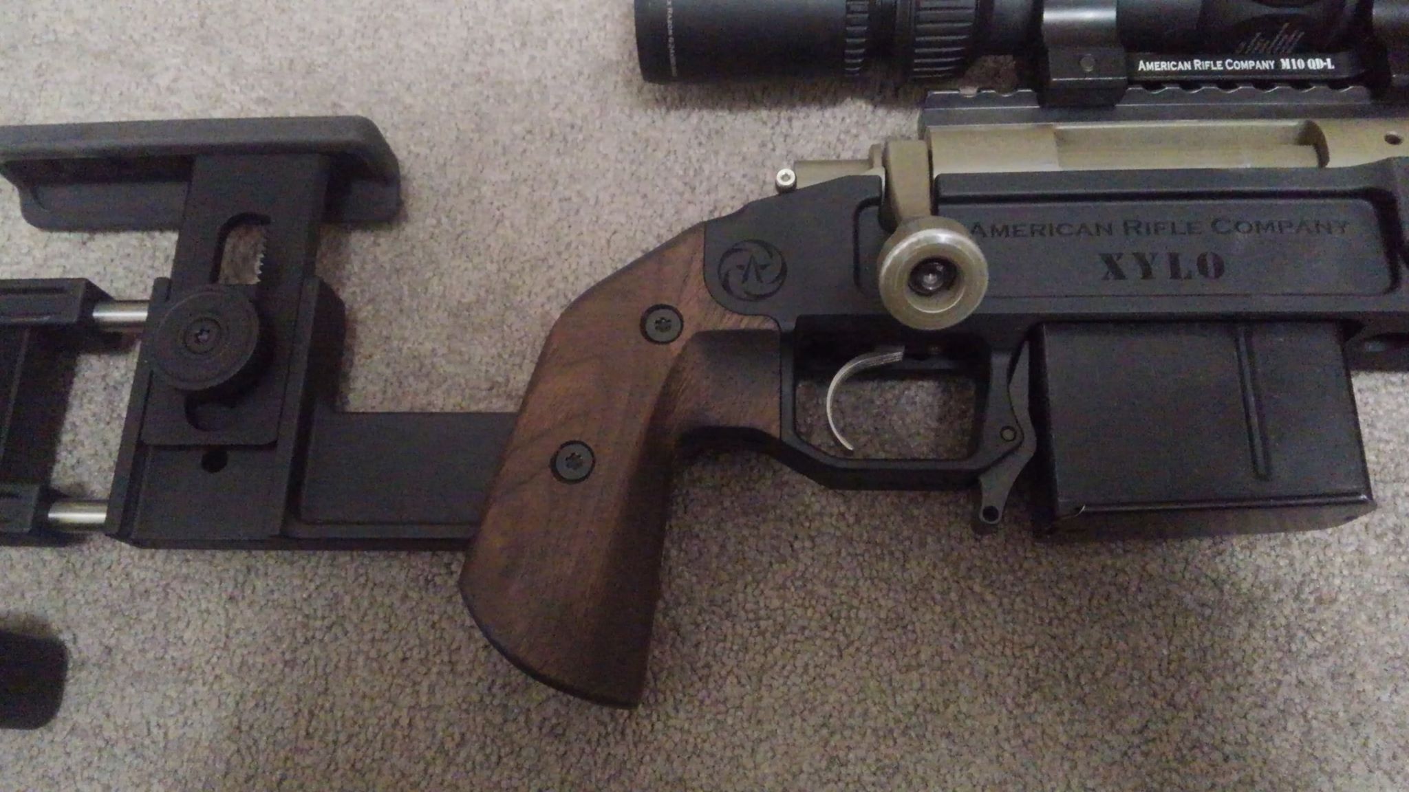

I'll get pictures up tomorrow. I had to fit the magazine latch. MDT 223 mags have to have the rear support rib removed. The grip is basically roughed in so blocked the sharp corners.

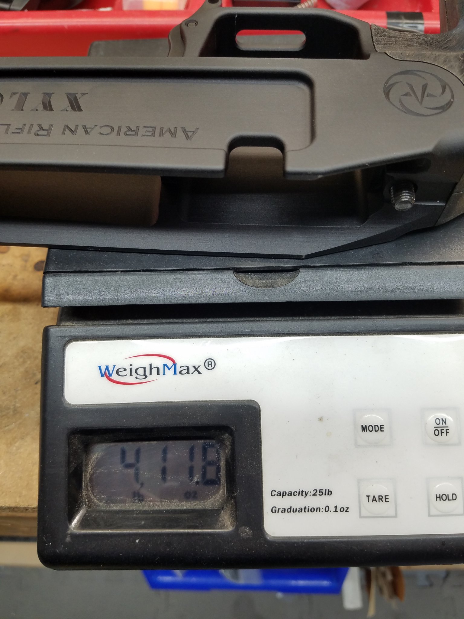

A W3 Folder with angled bag rider and minimal spigot weighs 5 pounds. The Xylo is the same length as the W3 with the spigot, uses 1/3 the individual fasteners, and the adjustments are easier.
Shot 50 rounds of 223 today. The Xylo is very stable, the adjustments are easy and precise, and the grip is natural. I plan on sanding dow the grip and restaining it.

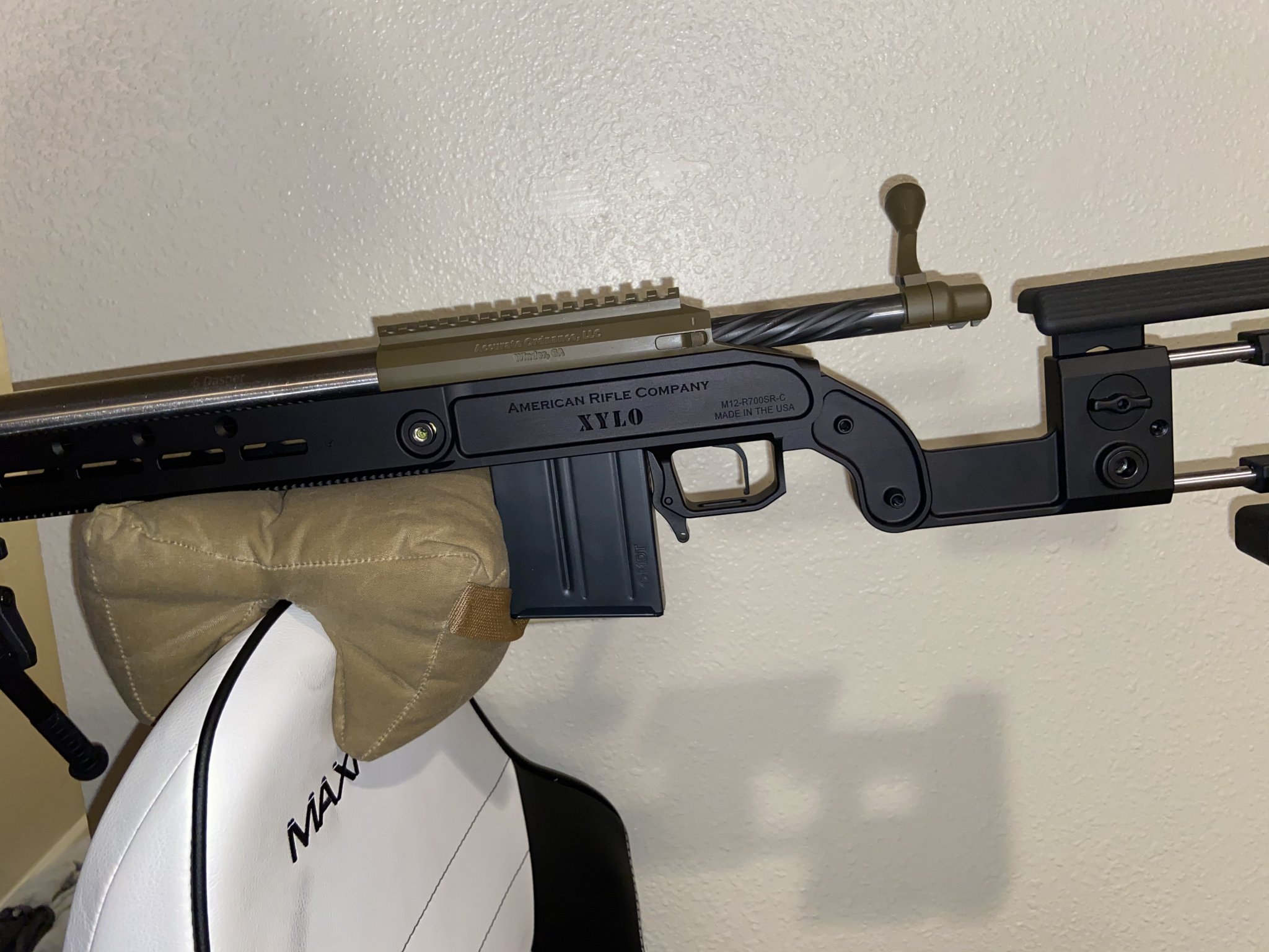

I have all MDT magazines (plastic 223, metal 308, and metal WSM). None of them initially fit. The latch was too long. The latch comes out pretty easy and I filed it down. The MDT plastic mags have a rib that interferes with the bump on the lever, I zipped it off with a Dremel and the mags work perfect. Overall the Xylo loads like most other chassis, there's nothing to get hung up on inside so mags just go in.

- I wish the grip was a little larger for my big hands. They mentioned potentially making the grip interface open source so you could easily make your own grips. I will likely be looking forward to this. I do like fact that the grip is wooden.

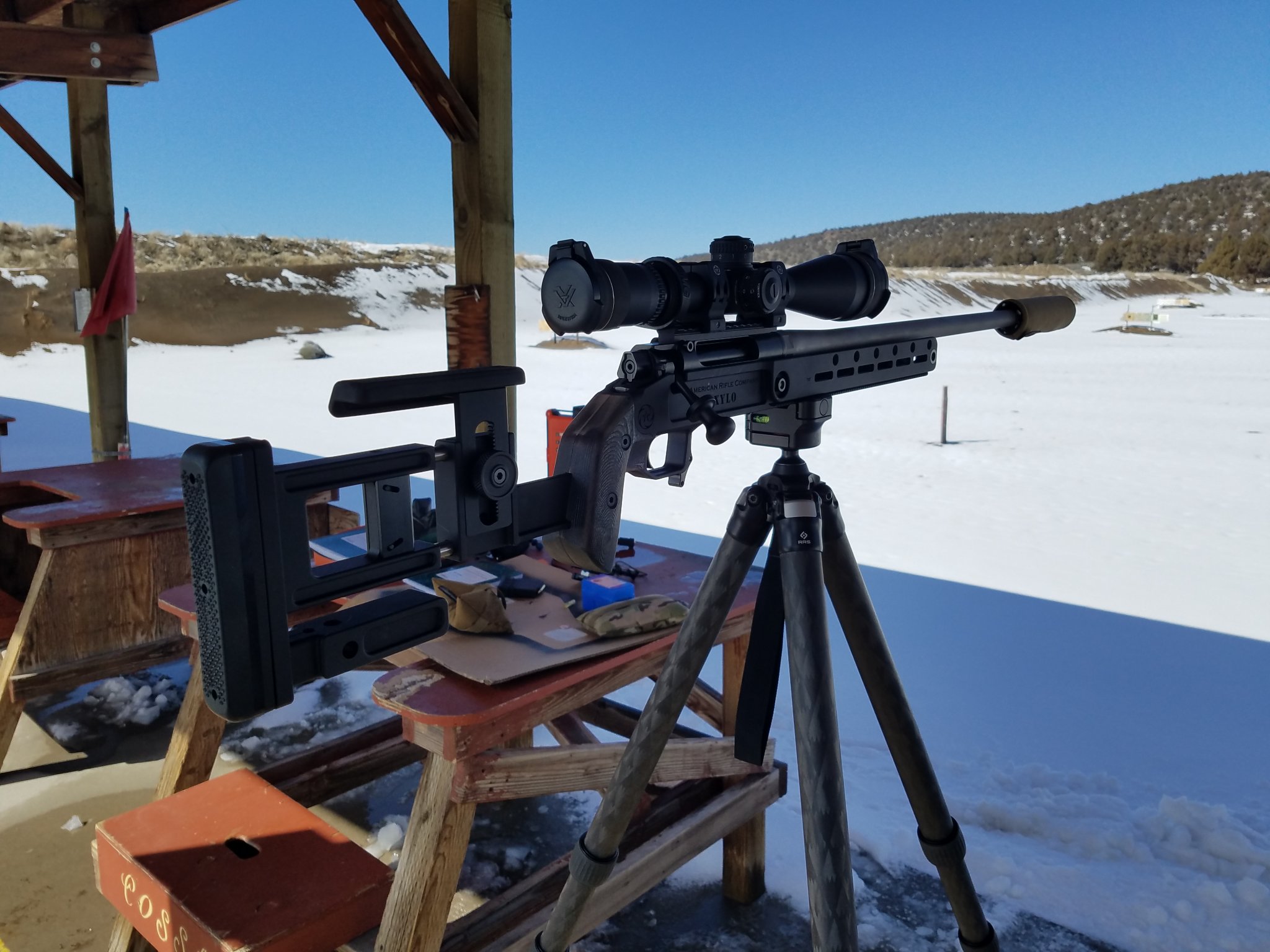

Got mine in today. Initial impression is pretty good. I have tried a few chassis before and the AR-15 grip ones were a "no" from the get-go. KRG has come closest to something I like but I always ended up back in a Manners. Will give this a fair shake. Function checks out so far with dummies and dry fire, and fit/finish are pretty damn solid. Maybe this weekend I'll get some range time in.

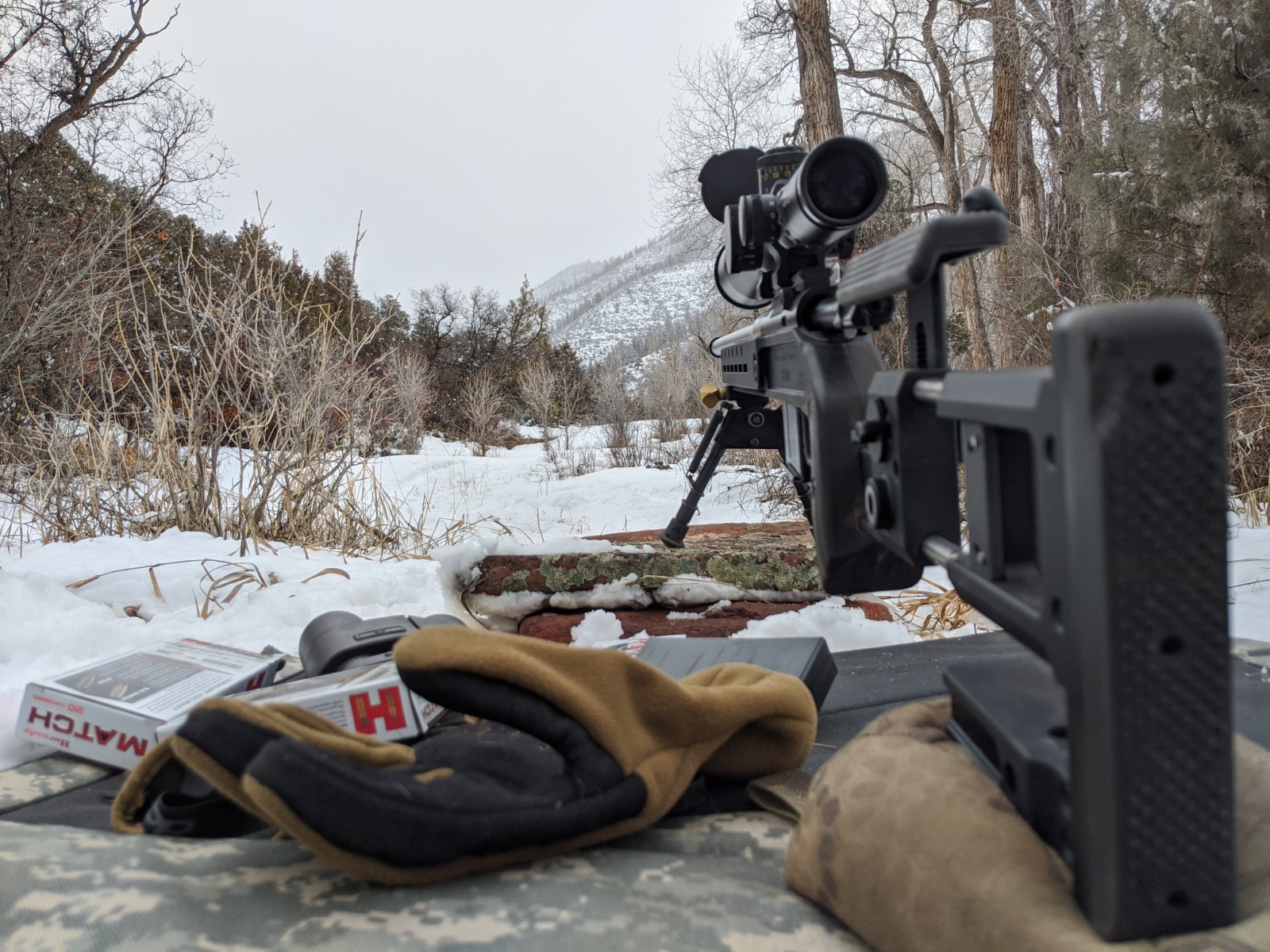

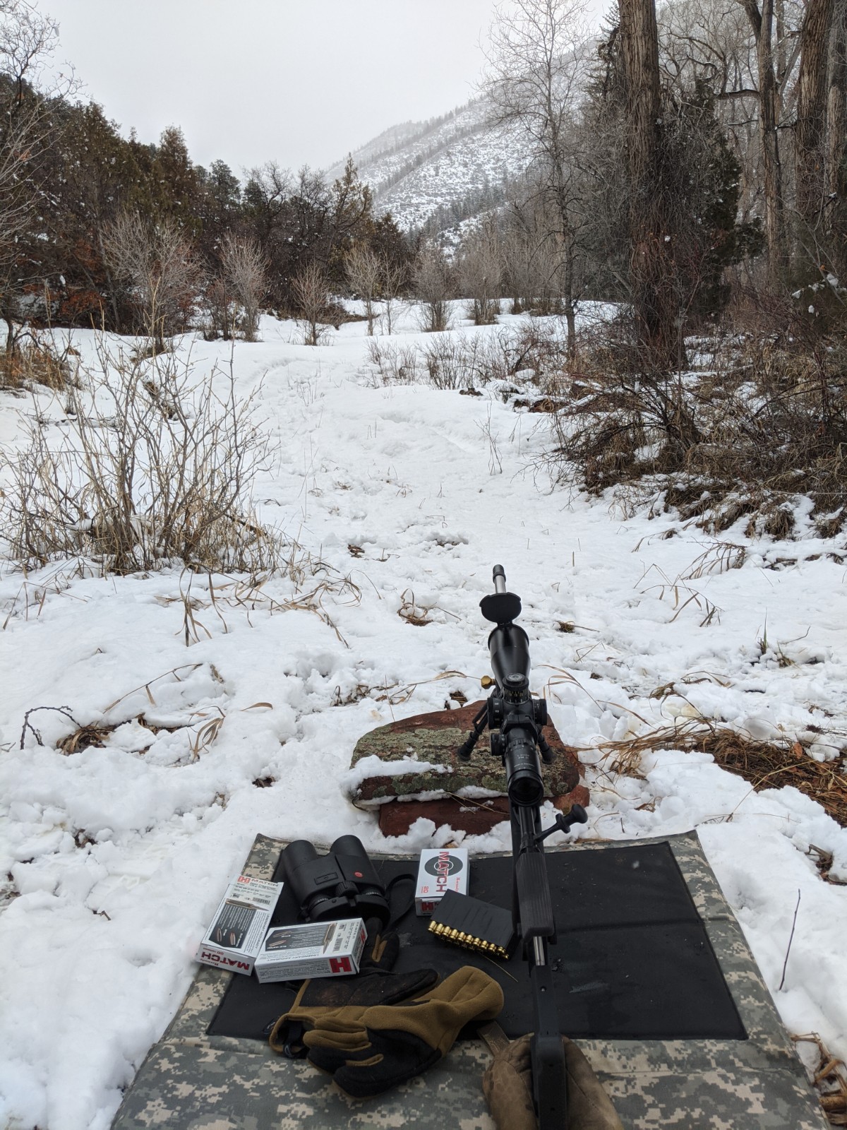

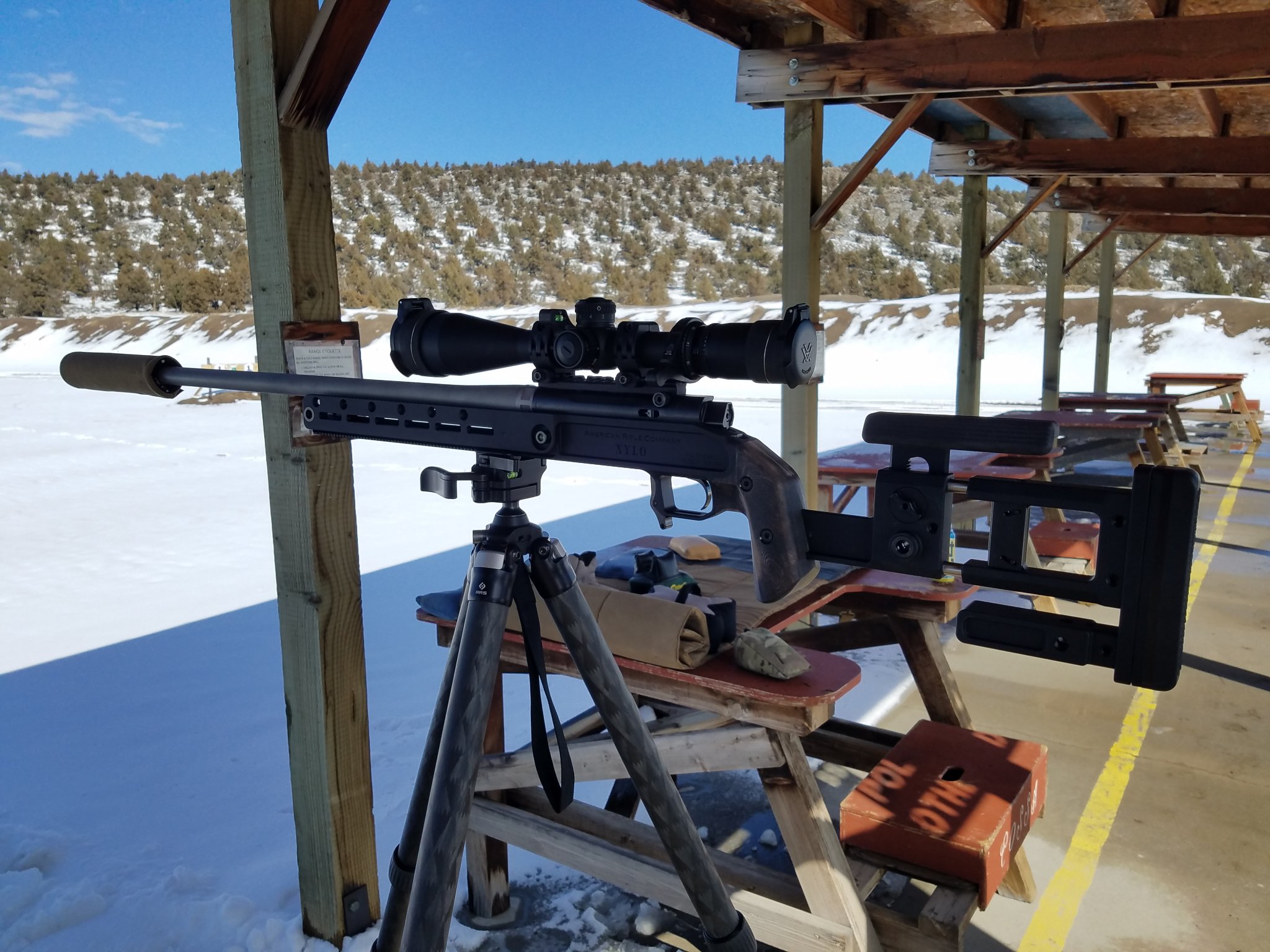

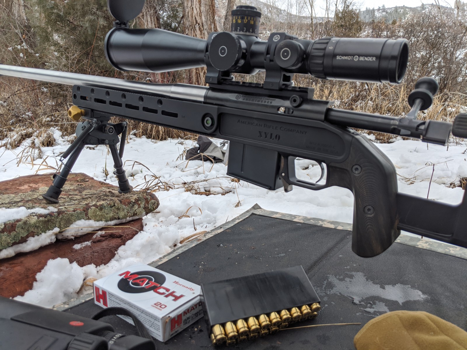

Shooting report

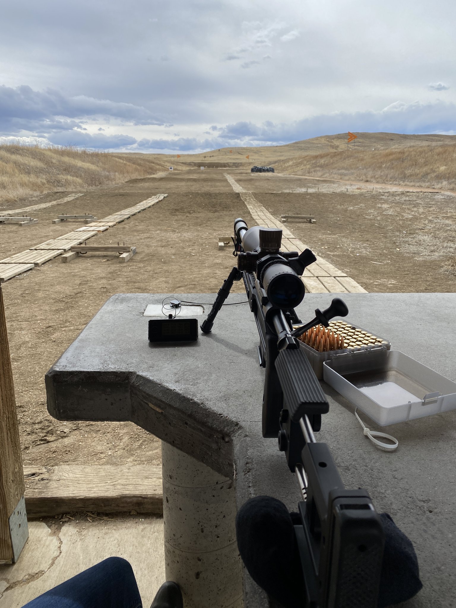

Might not look great, but they're the best groups I've ever had at 300 yards. This is with a 5-15 mph head wind and the chrono hanging off the loud end. Still doing load development. The two targets on the left were shot by my wife who has never touched a precision rifle before now. There are two 3 shot groups on the center target.

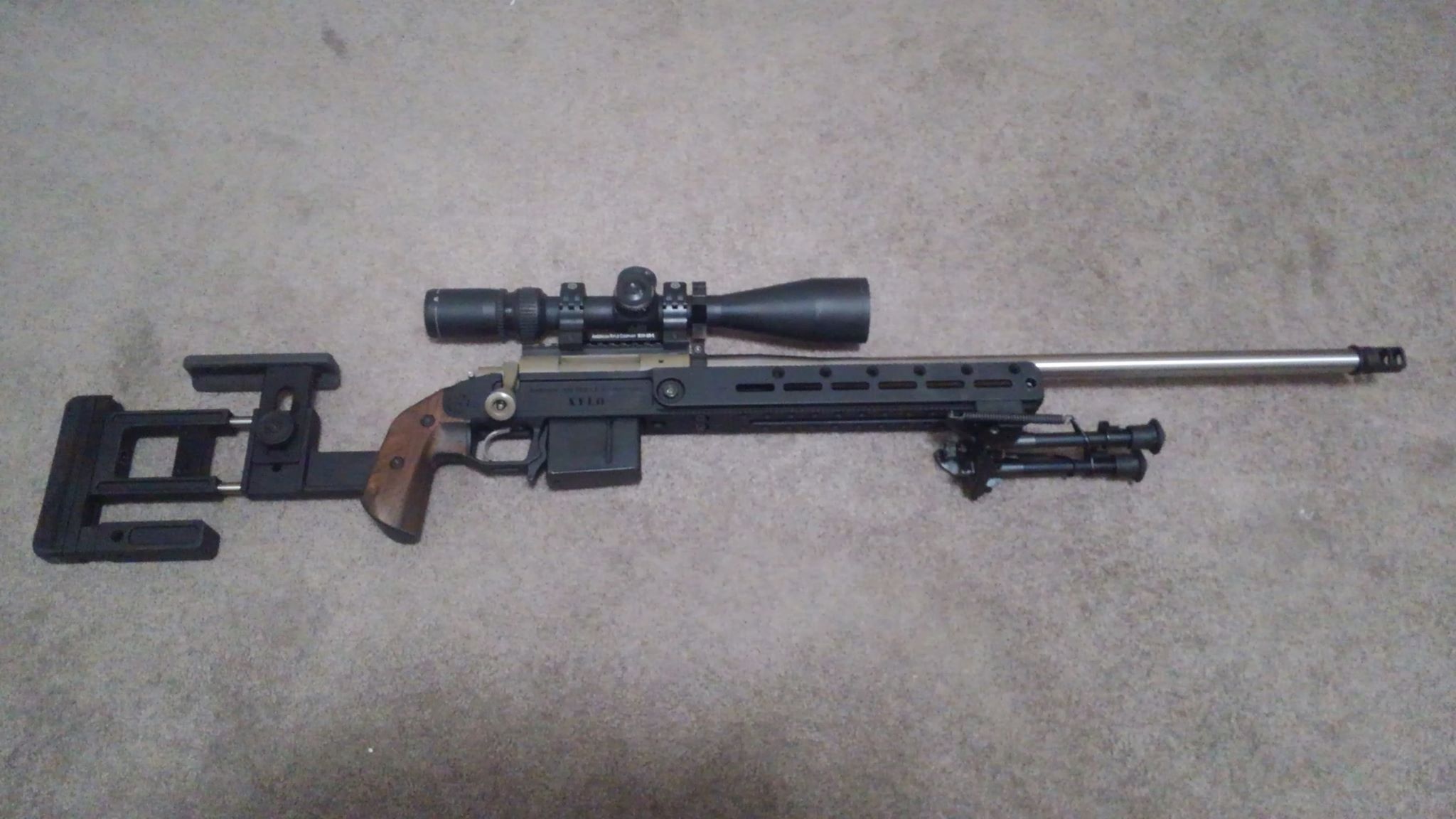

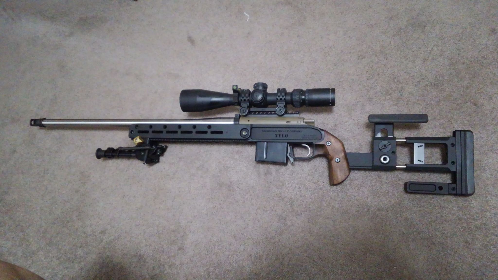

Today I was pulling my Bighorn TL3 out of the JAE-700 that I plan to sell (to fund another Xylo) and I thought I'd drop it in the Xylo to see how it fits.
The thick recoil lug on the TL3 (and the thicker recoil lug on the Origin) will not work in the Xylo with the lug clamp in place. I removed the lug clamp and installed the TL3 barreled action. I found that the front action screw was contacting the lower bolt lug. I did as someone else did above and added a washer under the front action screw (I used a washer from the lug clamp screws).
Now the TL3 fits and functions fine.....except that I didn't check magazine fit yet. I'll report back if I have any issues.
Regards,
Ross
Thanks for the feedback. The screws can be shortened using either a belt sander or a file. We shipped the Xylo chassis with 1/4"-28 x 1" long socket head cap screws. These are available from McMaster Carr and shorter 7/8" screws are also available. https://www.mcmaster.com/91251a441
Alternatively, you can add a washer to accomplish the same thing.
As for the recoil lug clamp, the Xylo chassis shipped with a wedge designed for a 3/16" think lug which is the same thickness as that of the Rem 700. We'll make more wedges for thicker lugs really soon. It's easily done and we can make them quickly. In the meantime, it a simple matter for a gunsmith to remove an amount equal to the thickness of your lug less 0.188 inches for the face of the wedge designed to bear against the face of the lug/receiver.
Ted

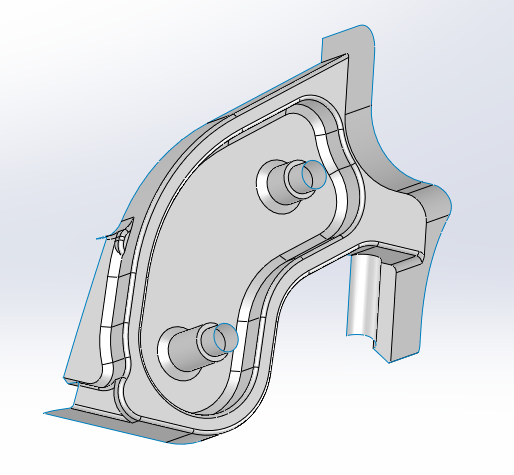

Ted, any way to get the CAD for the grip interface?
I just created a STEP file containing the surfaces you must use for proper inletting. The external surfaces are for you to create. A link to the STEP file will be on the Xylo page of our website just as soon as Justin can get it done, probably later today.
