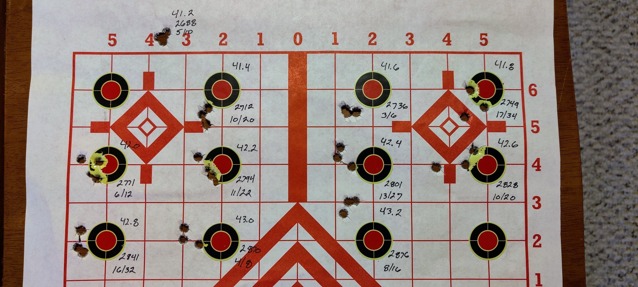

Load development day for Xylo and his wanna be brother. 140 eld-m in Lapua brass harvested from Berger rounds. H4350, CCI 400 primers, 20 thou off the lands. 41.6 looks promising, although a tad slow. Slightly cratered primers on the very top end but nothing ugly. The Savage on the other hand...
View attachment 7389501View attachment 7389502
I was getting great groups with mine shooting 140eldm with 41.8gr of h4350. Peterson small rifle, cci 400. Pretty cool how you are having good groups at a very similar charge.

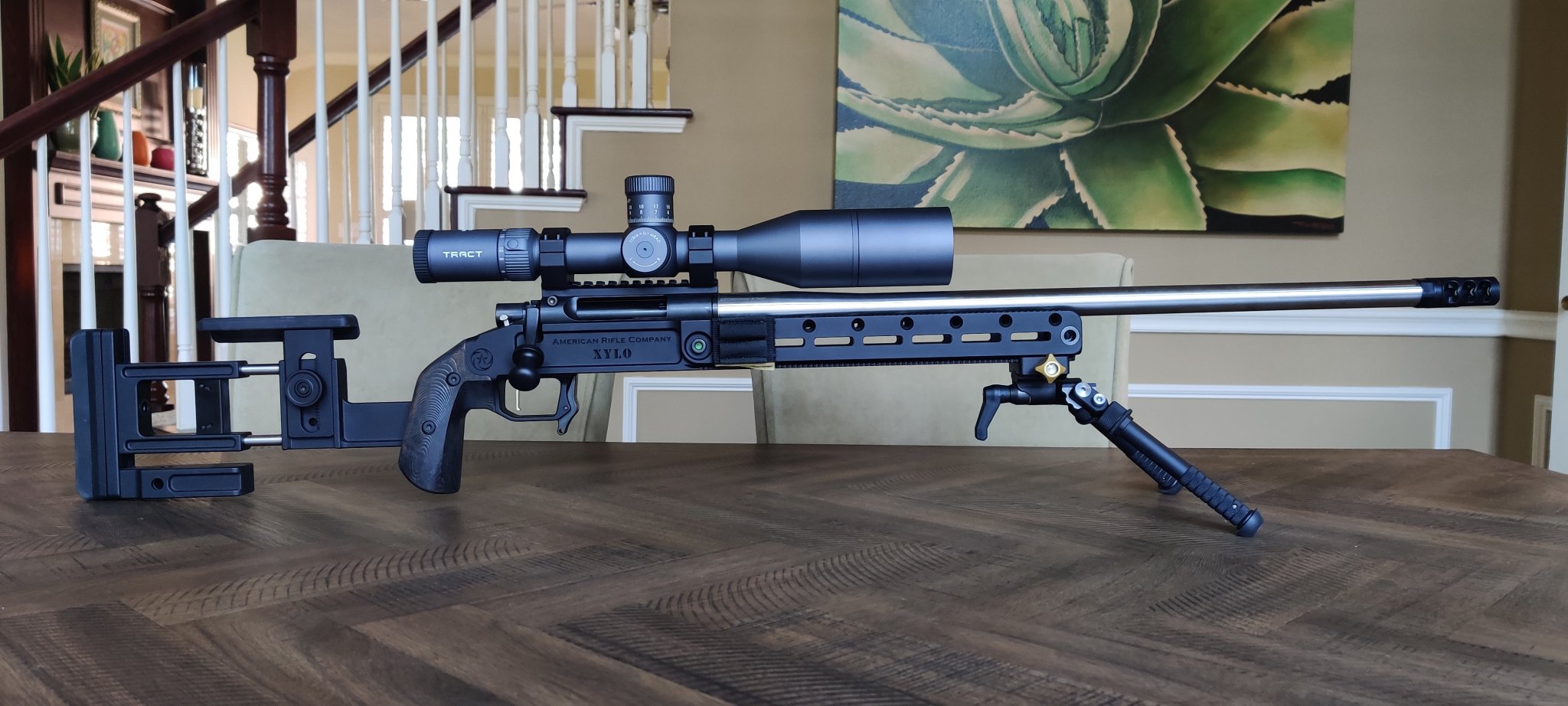

Let me start by saying I absolutely love this rifle & it's a hammer. Thank you Ted for this awesome deal.

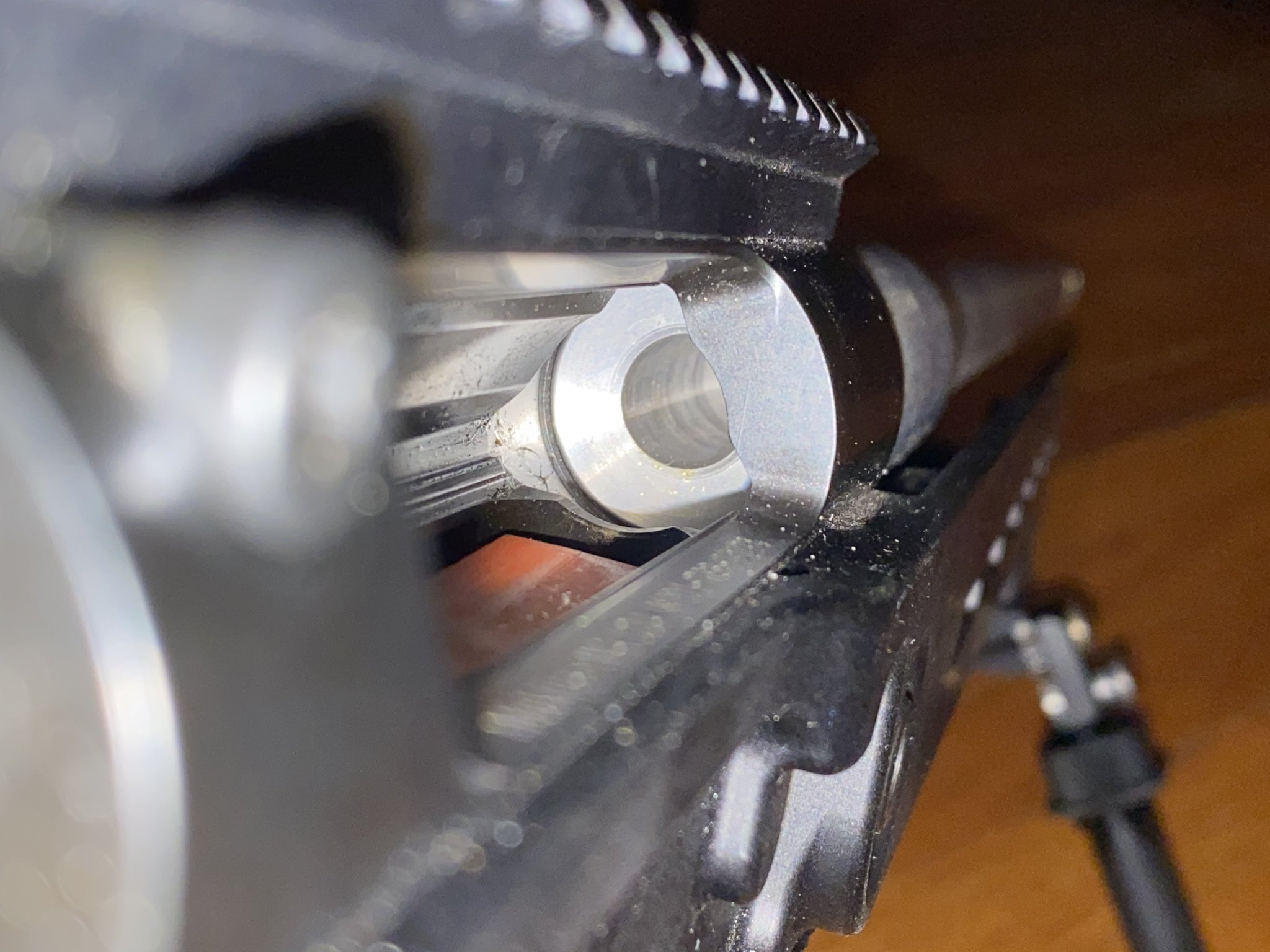

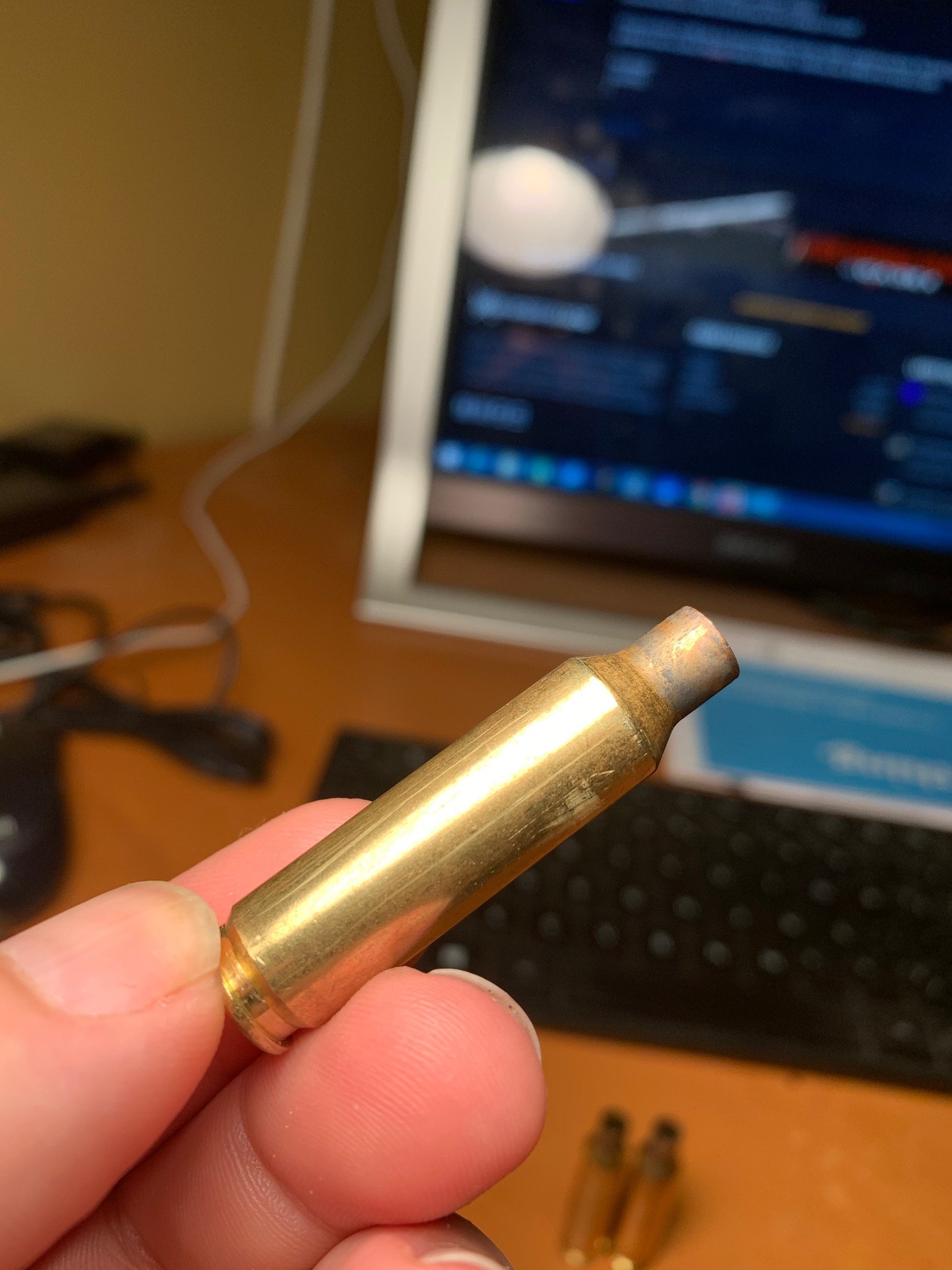

I had the same issue as @**DRB** above when I function checked my (6.5C).
It felt clunky trying to feed a Win 125grain round from the mag, it hung up before going all the way in and then very hard bolt close.

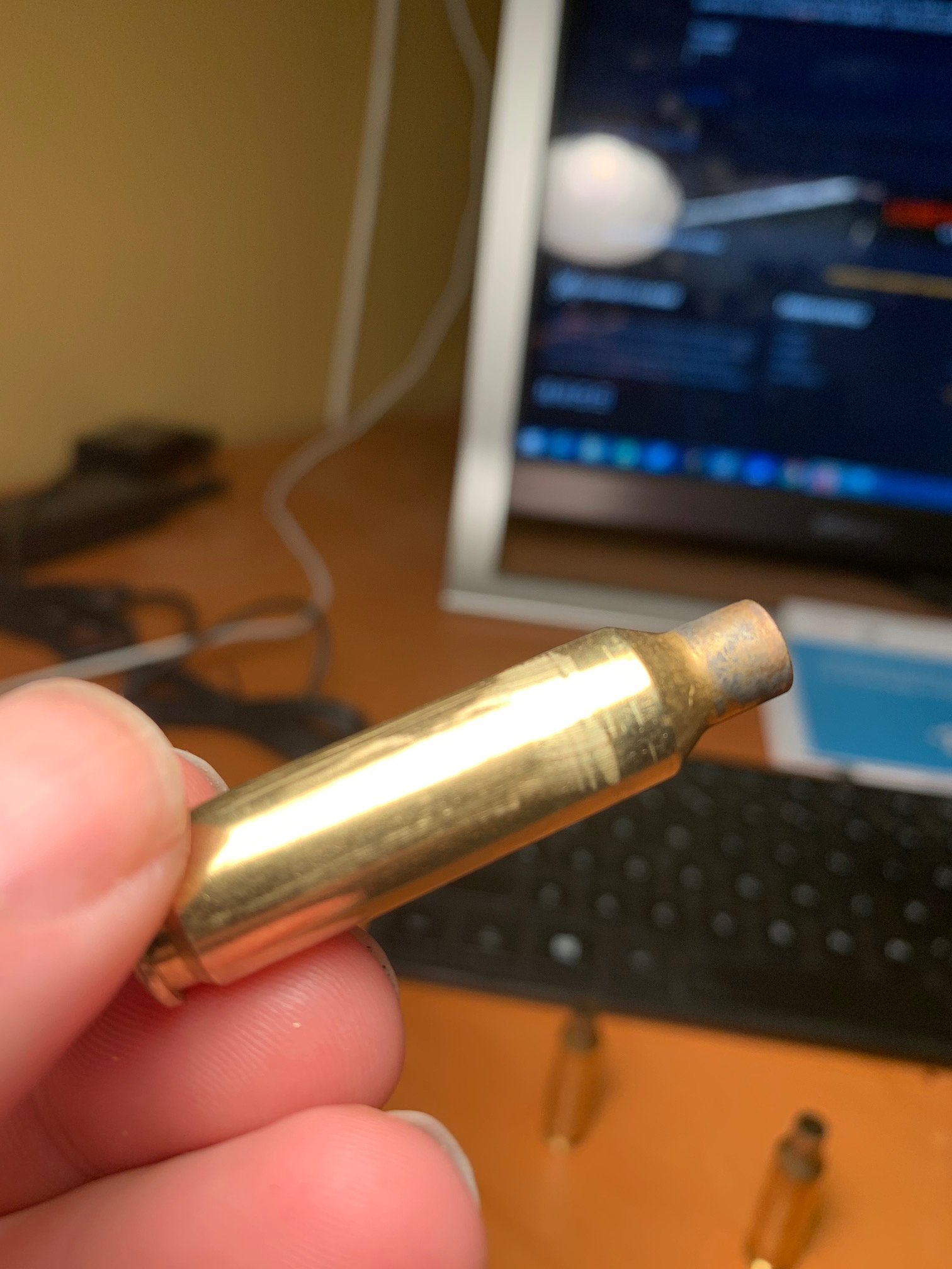

I then checked brass pattern. Picture on the left (not relevant to hard bolt close) shows scratches from mag feed lips. Pic on right shows where brass was scraping on entry to chamber. obviously these pics were taken after firing the rounds, scratches looked worse before firing.

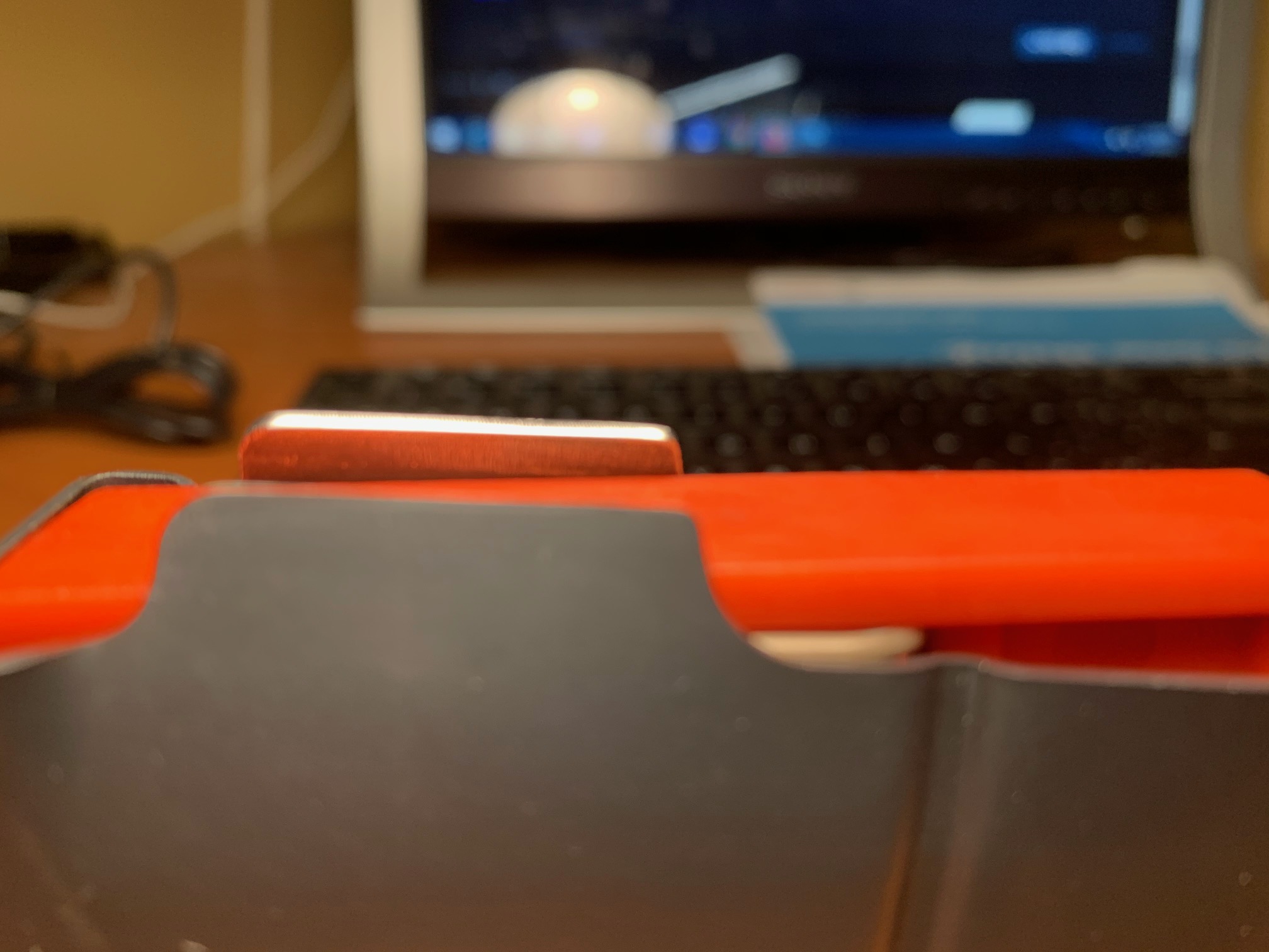

Sharp mag feed lips is standard and an easy fix on a convoluted deburring wheel followed with a little 600 paper.
The chamber scrapping issue is what I think the culprit is for hard bolt close.

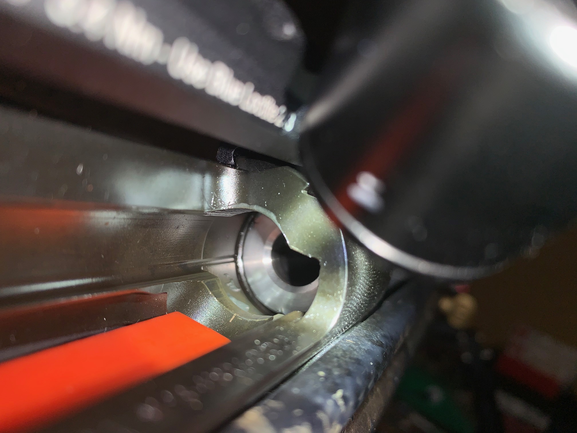

Here's my theory:
For the controlled round feed the case rim is released from the mag, but not yet fully clipped under the extractor. It appears to me this happens as the shell begins to enter into the chamber. As it straightens into chamber the case rim is pulled up into the extractor. On mine the case was biting on the sharp edge of the chamfer instead of just pulling up the rim. I suspect brass shavings were then causing the hard close.
It stands to reason that the chamfer geometry @ back of chamber would be more important on a controlled round feed like these.

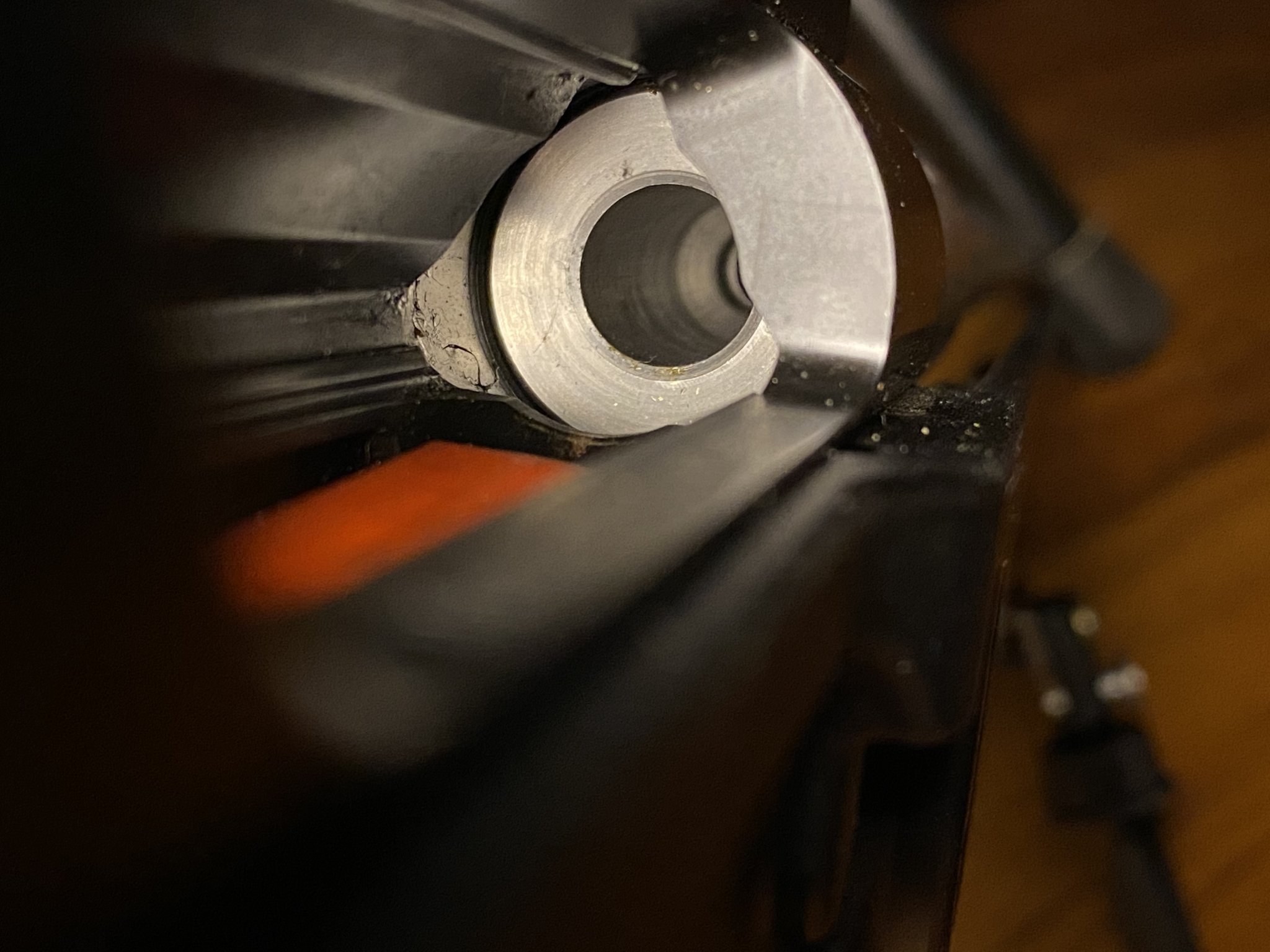

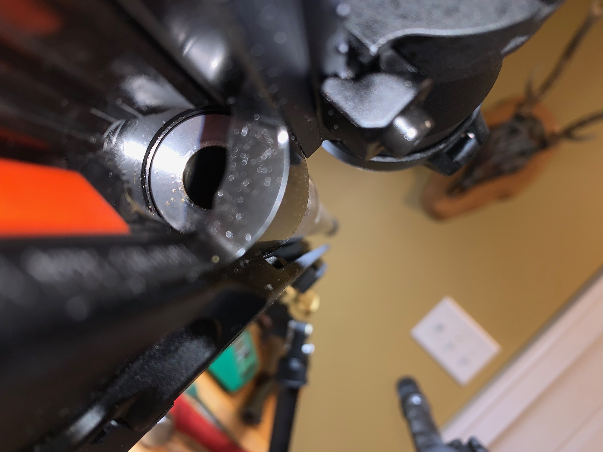

Look at this picture showing chamber chamfer at back of barrel. I suspect these did not have the edge between chamfer & chamber polished & chamfer is minimal. Note this picture was taken after I did some additional chamfering & fired 60 rounds. If you zoom in you can see all I really did was break the edge.
I have an unmodified PVA Creedmoore barrel here for comparison (pic on right with about twice the chamfer).

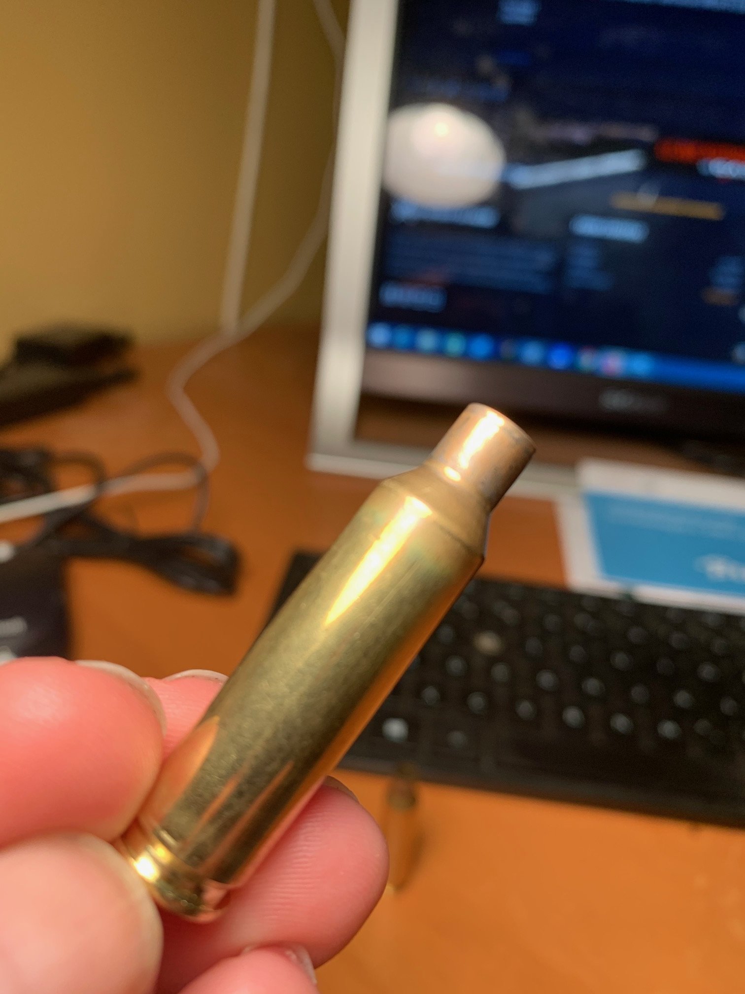

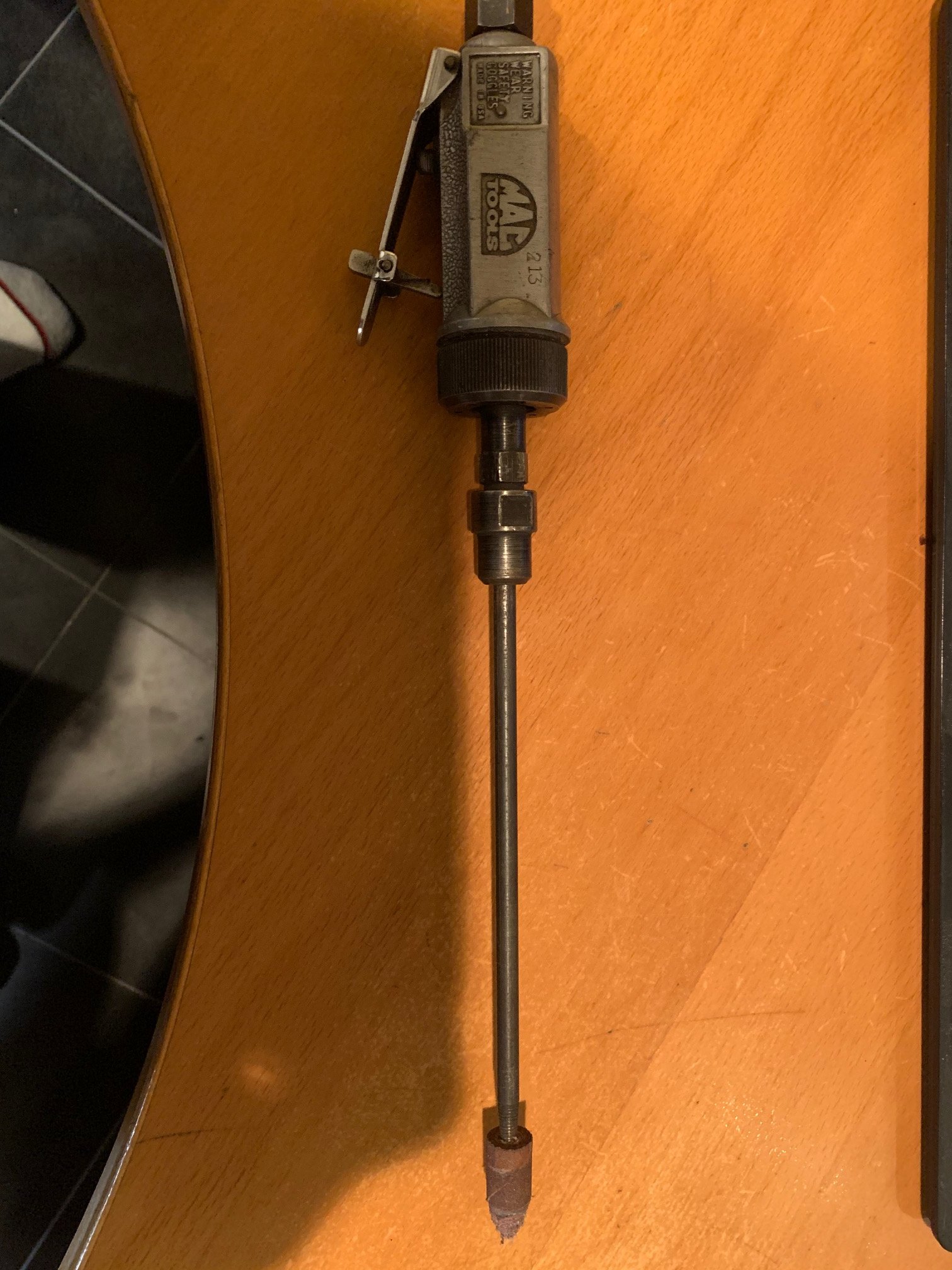

To fix I shaped a fine cartridge roll to about 50 degrees on a bench grinder (while spinning on die grinder). This trues it to the die grinder & removes most of the grit from the shaped edge. I then went in and kissed the chamfer to brake/round the sharp edge a little.
This was a little crude but I wanted to getur done and head to the range. I'm sure there are better methods.
The picture at right is a fired Berger Lapua case showing result.
After the above I ran 60 rounds through it Sunday. 4 different factory loads all fed flawlessly. None had hard bolt close & brass had no marks. For the hell of it I chambered a fired Lapua case & the bolt closed without any additional effort.

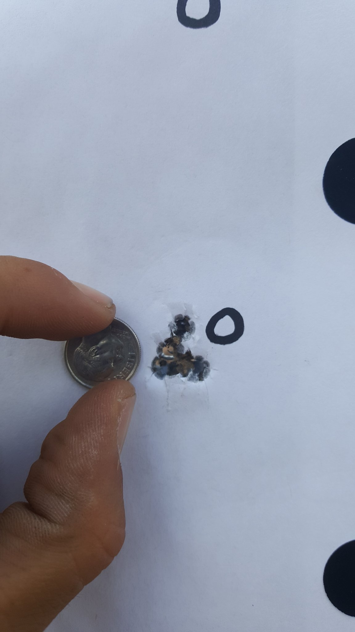

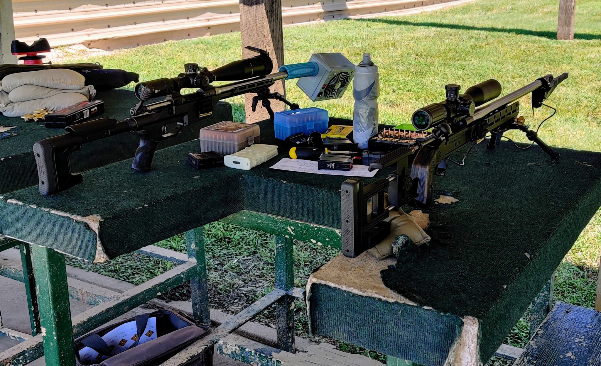

Here's the first 12 rounds out of the Independence day special. Shooting off bench with bipod & rear bag @ 100 yards. I'm no pro shooter. As of yet untrained, but improving.
First 4 were Winchester White box 125grain open tip range. Bottom left is first shot for scope zero aiming center large diamond. Next 3 after adjusting scope. squares are 1"
Next 3 are Hornady 140 ELDM (only had 3 left). POI slightly left.
Next 5 were Hornady 147 ELDM

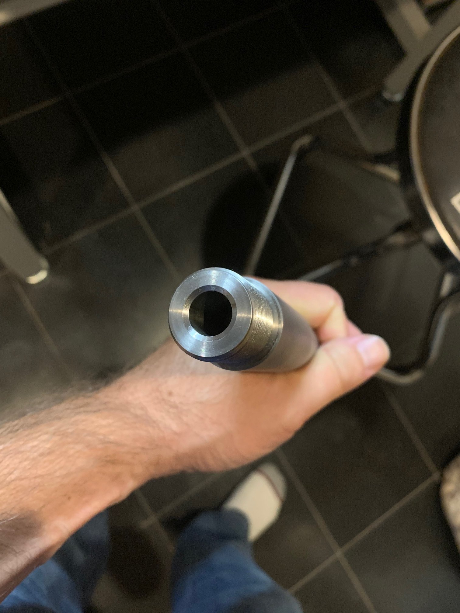

@**DRB** - Did you check the chamfer on your chamber?
I now have a 3rd PVA Shouldered ARC barrel pictured below (6GT). Made sure the chamfer edge was not sharp before screwing it on.
It chambers/extracts without issue.
Compare to the 2 pics I posted #107 up thread. The 4th of July barrel has about half the chamfer of the other 2.

Wow, mine looks nothing like that. Very interesting. Thanks for the reference and info, this is very frustrating to have this rifle run worse that my $700 Ruger

DRB, did you ever get yours sorted out?
Working to a resolution. It appears there might have been a few things going on.
Interesting to note, Josh / Joe from PVA commented that the smaller than previously seen barrel chamfer is 100% on purpose and should have NOT caused the issue Im experiencing. While the issue is not completely resolved, I will hold a final opinion. I will say to this point both American Rifle Company (Justin) and Patriot Valley Arms (Joe / Josh) have all been spectacular to deal with. If we can get this sorted out between both companies I will certainly own a lot more ARC / PVA product in the future.
