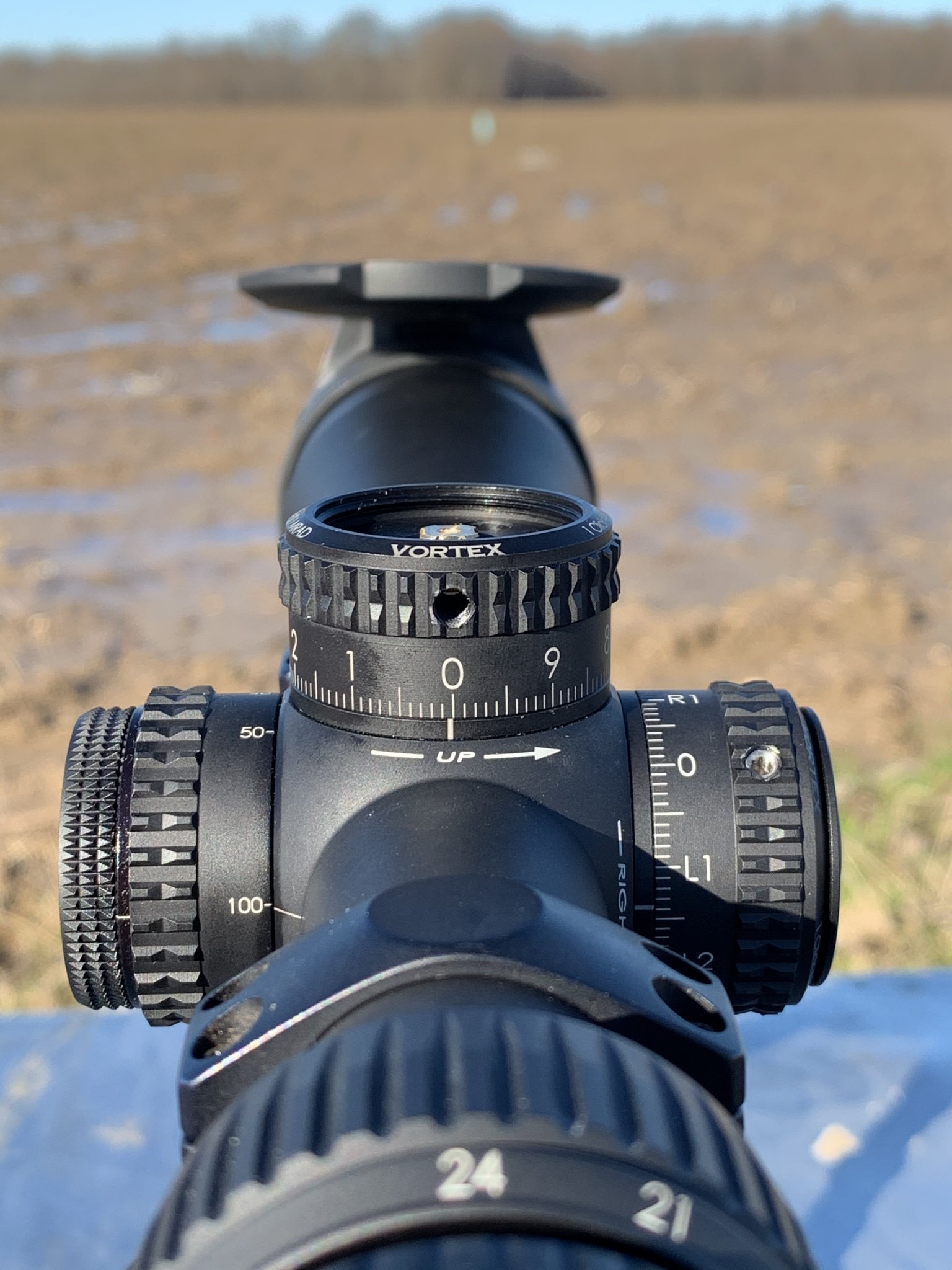

    Is there a way to correct this? I’ve got the turret disassembled but it doesn’t seem like there is anyway to slightly move the teeth to get the lines on the turret and turret body to line up.
    This is what it looks like. It’s usable but bothersome to me. If it can’t be adjusted I’ll just have to wait until hunting season is over to send it in.
    Reactions: Genin
    I’ll worry about it after hunting season. I’ve almost got all my SS fireformed and am gonna do load development soon. Was just curious if it was fixable.
    I had the same issue with my AMG. I called Vortex they emailed a 2nd day air shipping label. Just got it back, they replaced both the elevation and wind age turrets as well as did a full checkout The other cool thing they did was include a reference of the scope settings I had before they changed out the turrets. Scope is like new and GTG
