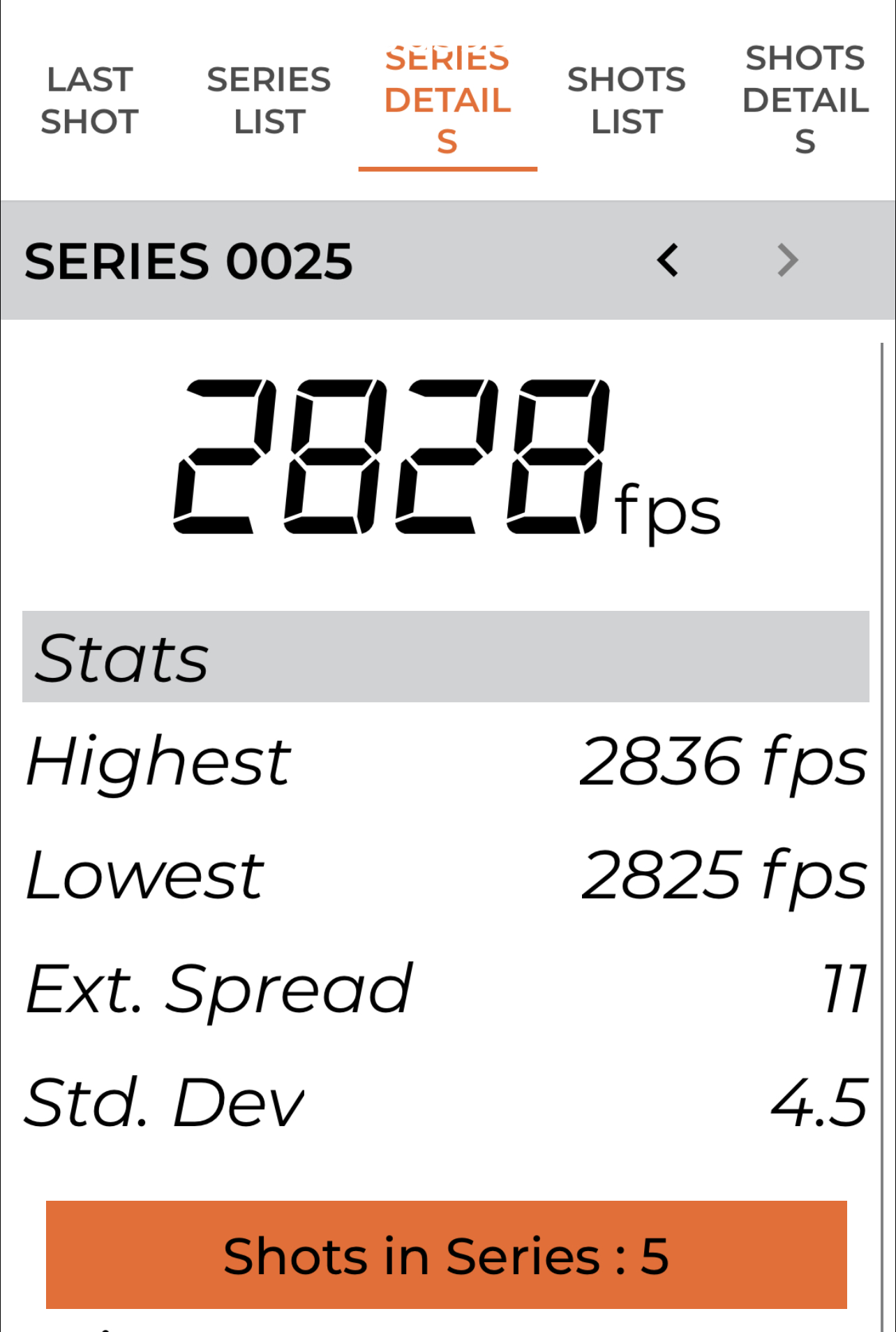

    In the testing that I've done I haven't seen an ES/SD performance change from annealing. Virgin vs. 1x fired vs. 1x fired->annealed all produce about the same results for ES/SD over 30 shot strings. However, the average MV moves around.
    If you tried mixing 4x fired and 1x fired brass, I'd bet you'd see a subtle increase in SD. Annealing would likely work to mitigate that.
    My take is that the AMP is great for extending the life of brass, and is probably the most consistent commonly available method. If you load so hot that the primer pockets are toast in 3-5 firings, you're wasting your time annealing, but if you're losing cases to neck splits or noticing significant springback/hardness in the necks, it's probably worth it and you'll start losing cases to head separations over 2-5x the life span.

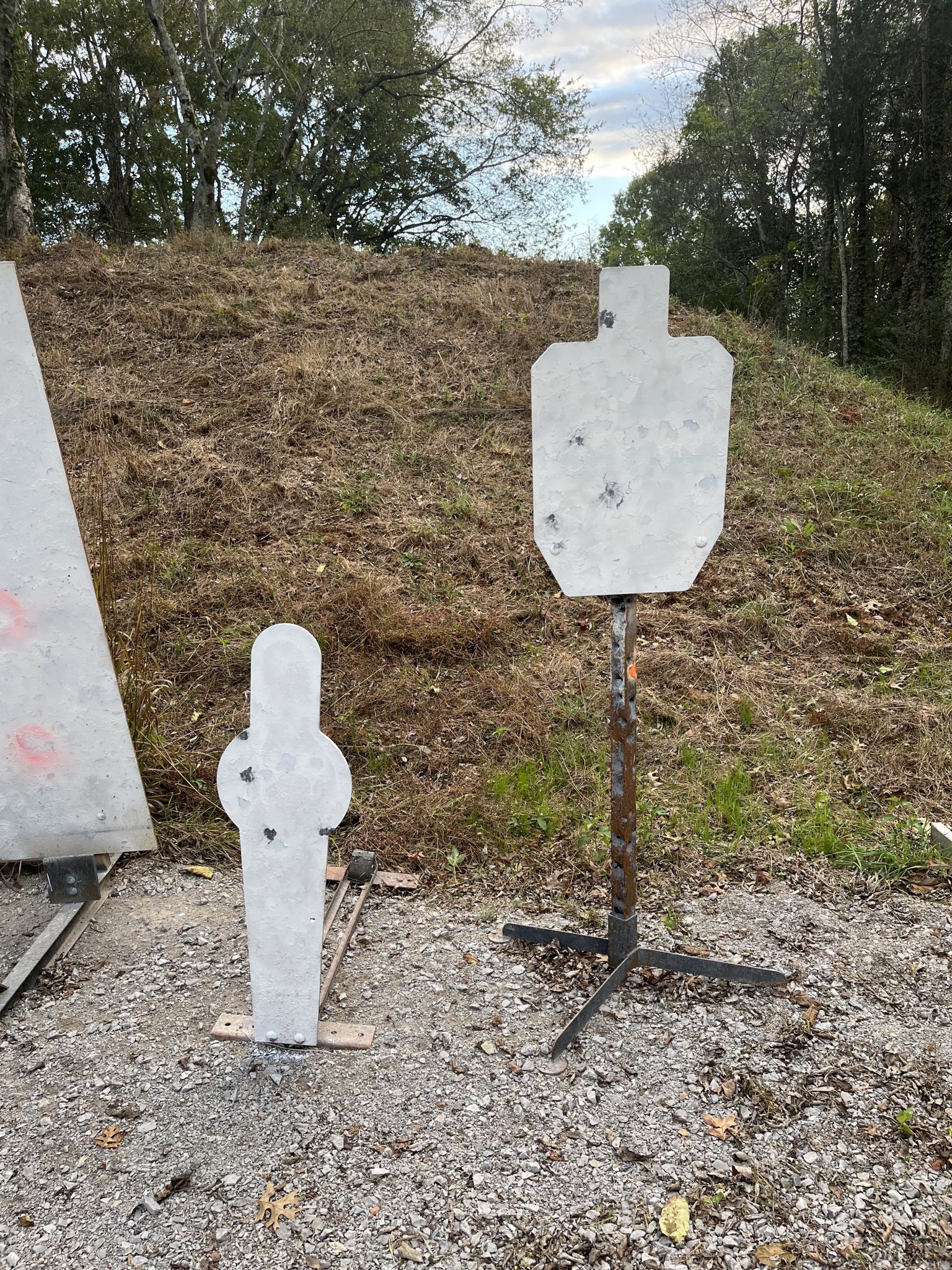

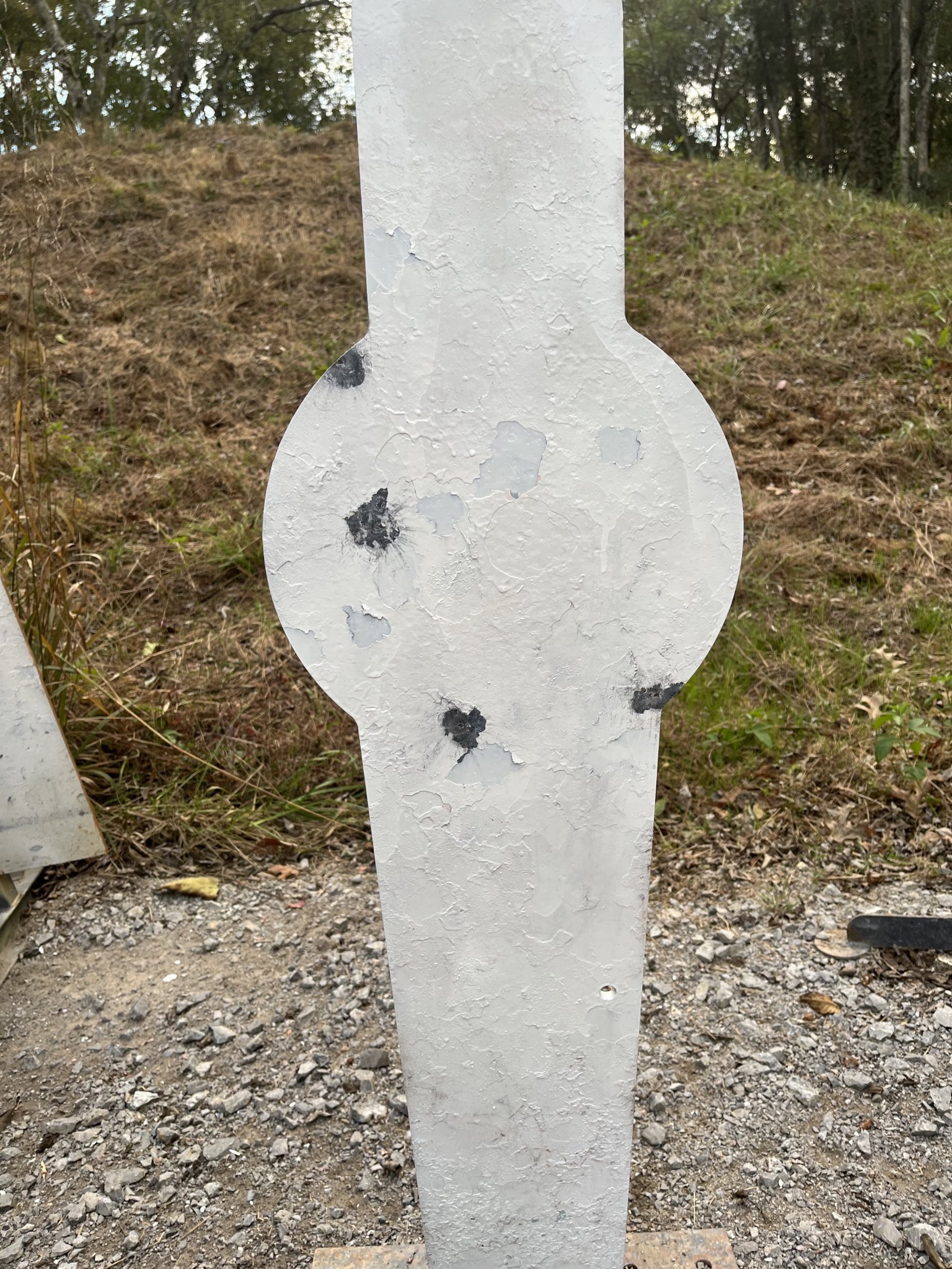

    Here's 10 rounds going back and forth between an IPSC and a popper at 1,250 yards from the other day, 9/10 impacts... since I started using the AMP, shit like this keeps happening on the regular (and I don't believe in coincidence):
    View attachment 7731313View attachment 7731314View attachment 7731315
