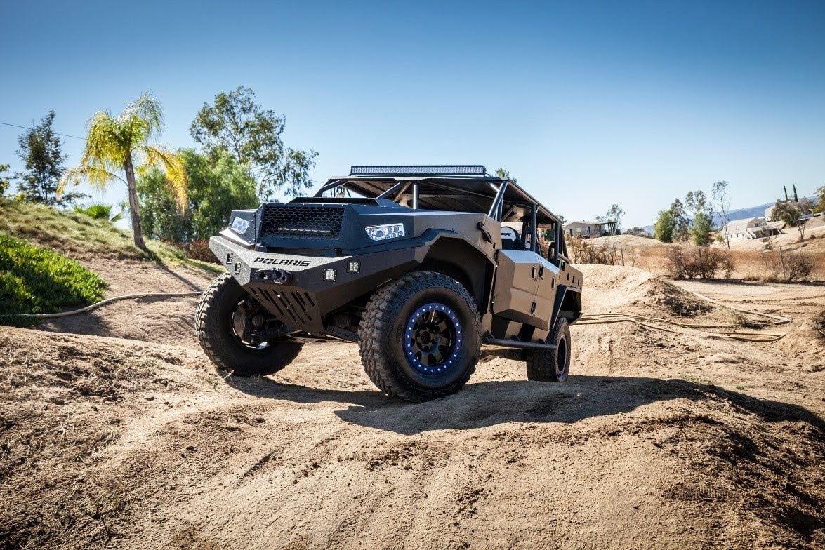

    Ok, so since I got a metric ton of PMs and people begging to tell me what it is...
    Dun Dun Dun
    Google Polaris DAGOR. I want to build at least one, and possibly improve on it.
    My fab guy I work with says its actually an easier fab build job than an MRZR as its frame/chassis + drivetrain and then a bunch of custom panel fab work. He's looked at pictures of it from 100 different sides and says its not a hard build for him at all. We can easily procure the ring turret and it'll give me an excuse to build a M2.
    The problem is, I'm pretty sure the reason Polaris does not want to disclose anything about it, is because its not actually made by Polaris as in, Polaris doesn't make full sized vehicle frames and engines. This is pieced together.
    I have all of the dimensions, weights, etc I'm trying to figure out what frame was used or would be an upgrade/good frame to use that can be modified to the same end result, as well as what engine/drive train would work with said frame that would meet/exceed the output the DAGOR has.

    Tube chassis, 4cyl diesel that's readily available with a stout transmission and axles. Maybe Chevy colorado duramax? Dodge eco-diesel? Kubota tractor motor and hydro-drive?
    I'd think a chassis designed to fit your size and weight requirements will ultimately be less work than trying to modify an existing one. A salvage donor vehicle of opportunity for the drivetrain, etc.
    I don't know that I'd try and copy it (unless you're just going for a mill-sim), but fabricate something usable with commonly available drivetrain parts for the inevitable breakage.
    Most 4x4 fab shops would be able to build it. Look into shops that specialize in tube buggy's and rock bouncers. Check with the guys over at www.irate4x4.com (pirate4x4 is dead). You might find someone who has already built something close.

    Roush built the chassis. Drive train is the unknown.
    How do you know about the Roush part?
    Seems a bit niche for an 'off the shelf' claim that they make about it.
    If it is Roush, what is it based on? I dont think they produce anything; just modify existing cars? Would almost point this right to a Ford Super Duty frame.

    I dont need to clone the drivetrain, just get at the level of performance (or better) so its not a dog. Doing a little research, the competitor to this was using a V6 Turbo Diesel out of a Cherokee and has almost identical curb weight and payload.

    If you get the wheel base you can pinpoint what chassis was used. Thats where i would start. Im guessing ford or chevy, you can see the frame rails. What motor? Ford? Gm? That will also help narrow it. If your just building a clone, go with the chassis that is most available to you with the most aftermarket support and easiest to work on.

    Had I known I could have looked at a couple since they bring them here all the time. It is a Polaris build but I am not sure who else took part in it?

    I will say that I have seen those dagors get wrecked out here in rotations. Light doesn't always equate to strong, but then Joe can break anything.

    How much do you trust Wikipedia?
    The DAGOR was developed under contract from elements of the United States Special Operations Command (SOCOM), Canadian Special Operations Forces Command(CANSOFCOM) and international Special Operations Forces (SOF) customers.[33] The design using (COTS) components enables procurement of spares worldwide. The vehicle is produced by Michigan-based Roush Industries with deliveries commencing in November 2014
    ZERO TO 60 DESIGNS Design & Fabrication
    From the article on the civy unit. Seems that's the guys to talk about the chassis to. But given their reputation, I'd bet they're tight lipped.
