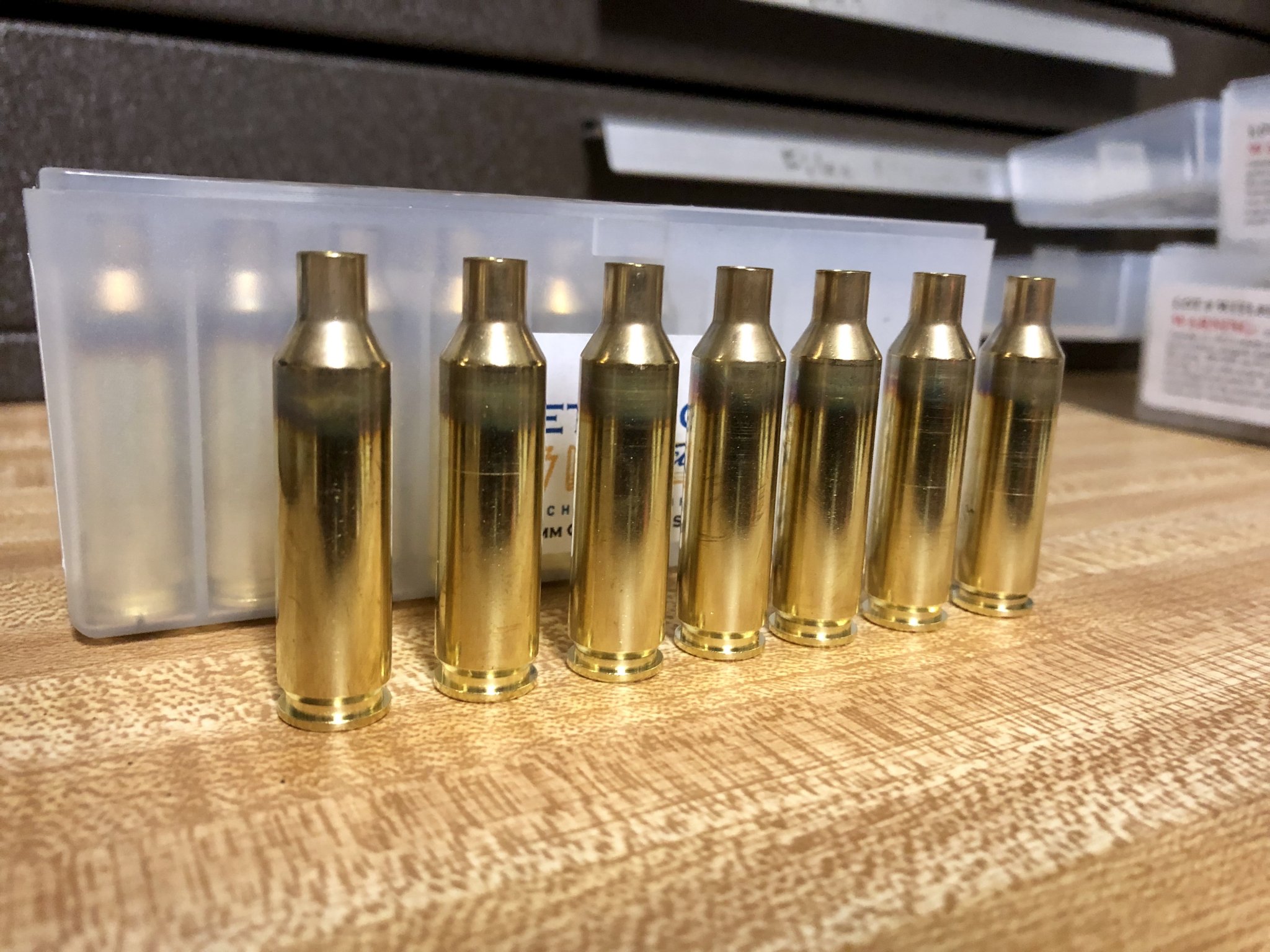

Can I get a visual critique on the brass that was ran at my final setting of “38”?
Hard to get a true color representation
The look dependent on case cleanliness. Put a dab of 750 tempilaq inside the neck away from direct flame contact and corrdinate its time in the flame to end right when the laquer turns clear.
Some 0000 steel wool on a small brush or something will scrape the tempilaq out of the neck once its been cooked.
But the tempilaq is the only (easy) sure way of knowing when you have hit a temperature.
If you have a regulator and a decent sized tank of gas so that the torch always has the same flame output you should just have to return to the previous settings and not have to tempilaqu proof the set up each session.

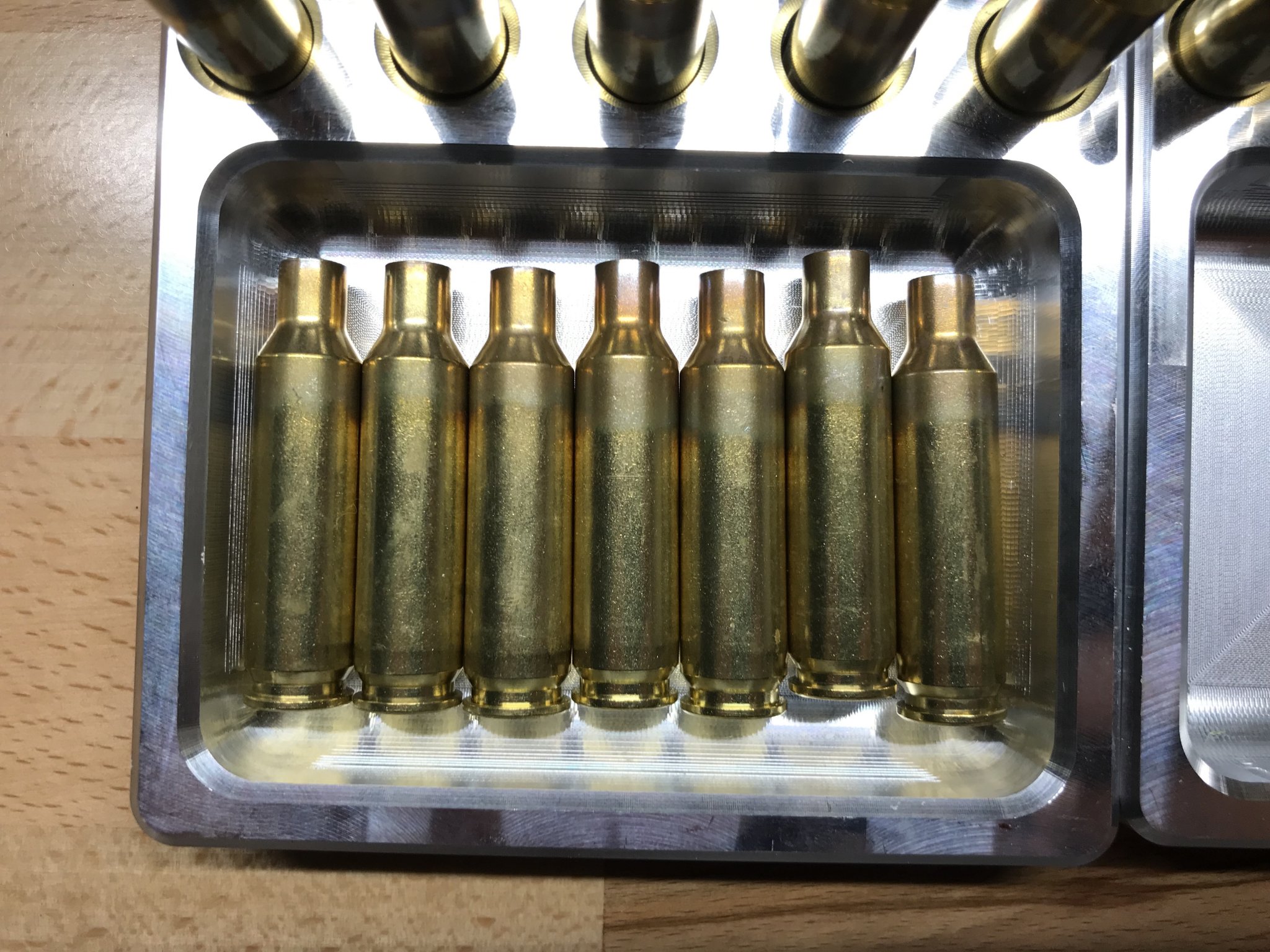

FWIW, with Tempilaq 750 inside the case neck, my setting of 38 (which I was originally concerned was TOO slow) was UNDER-annealing the necks. I wound up turning the flame up to be 1/4” off the neck/shoulder junction and left it at 38.
Tempilaq turned black inside the neck and get pulled out maybe half a second later. Tempilaq 750 on the body shows 750° doesn’t move down the body more that 1/4”.
I’m calling this setting good and just working on getting them to turn now.

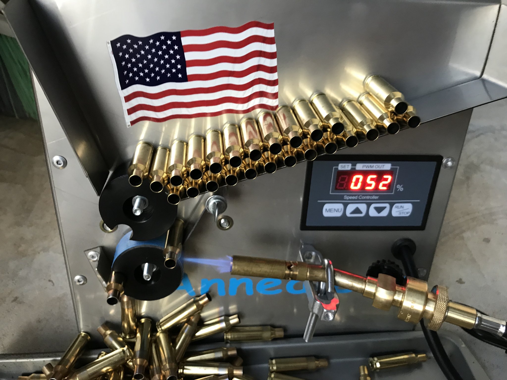

Here's mine and the settings I ran, 750 tempilaq inside of the neck and the case rolled away as soon as it went clear, posted a video on annealers anonymous on FB and Jeff Buck said that was perfect and not to change a thing. I had zero issues with my unit.
