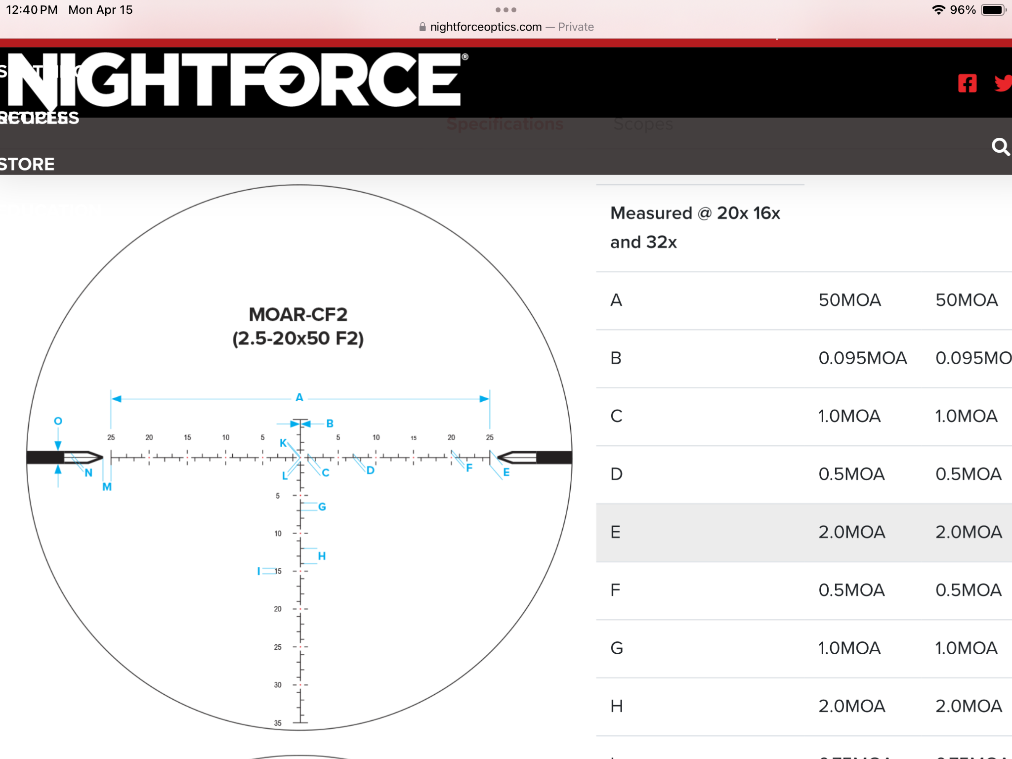

I have a Seekins SP 10 in 6.5 CM. I have never had a scope more expensive than $700 (Vortex PST 6-24x50) until now. For this rifle (SP10) I bought the NX8, 2.5-20 in 2nd FP. I primarily hunt and prefer 2nd FP MOA reticle mainly due to the FFP reticle getting thinner on low powers. The wider field of view on powers lower than 6x is nice for closer hunting shots. The illuminated reticle is nice and I use it early and late. The XT reticle (MOA or Mil) would be better for PRS application. But for hunting, I really like this MOAR CF2 reticle. Not too busy, but everything I need. And on Black Friday sales it was $1700.
