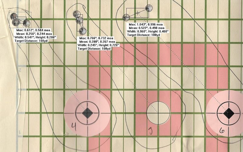

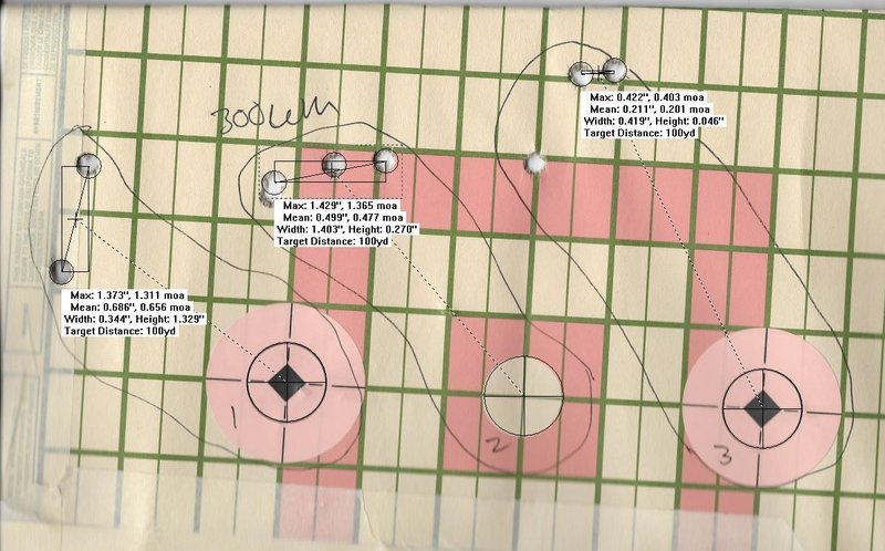

I went out and shot OCW's for 3 different rifles the other day, a 300WM, 7RM, and .260 Remington. I just want some input so I know that I am looking in the right spot.
From top to bottom, 300wm, 7rm, 260.

I only have groups 4-6 for the .260 because I accidentally threw away 1-3 (I'm a dummy). To me on the 300WM, it looks like I should go with 4, on the 7RM the fact that group 4 shifted to the right and then 5 came back left leaves me questioning, and on the .260 it looks like 4-6 group together.

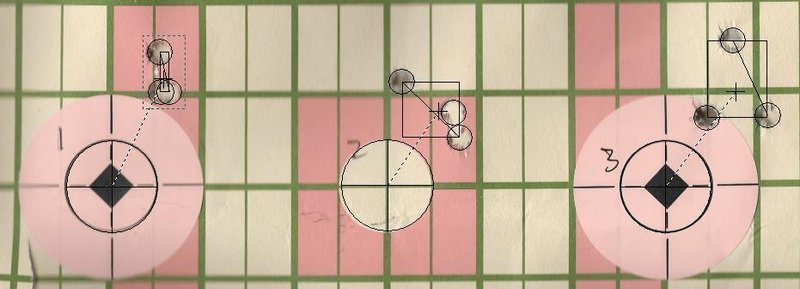

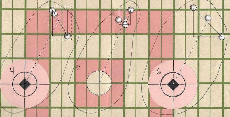

Just so its easier to see the 7 stuff
[IMG2=JSON]{"data-align":"none","data-size":"full","src":"https:\/\/www.snipershide.com\/shooting\/filedata\/fetch?photoid=6587911"}[/IMG2]
[IMG2=JSON]{"data-align":"none","data-size":"full","src":"https:\/\/www.snipershide.com\/shooting\/filedata\/fetch?photoid=6587912"}[/IMG2]
What are the charges? Are they fine increments or is there be a half grain in between each?
Without any actual data I would say group 2 and start refining it down a bit but really thats just a shot in the dark without knowing what Im actually looking at.
Edit: get more than 18 rounds through the gun and come back later once its settled in because like above its hard to parse anything from this as there is a consistency issue from one to the other.
I noticed the 7 "stuff" was all grouping about the same clock position. Charges for each group are as follows with a 1% difference between each charge. Why group 4 swung out, and then 5 swung back in, I am not sure.
66.336
67.027
67.718
68.409
69.1
69.791
