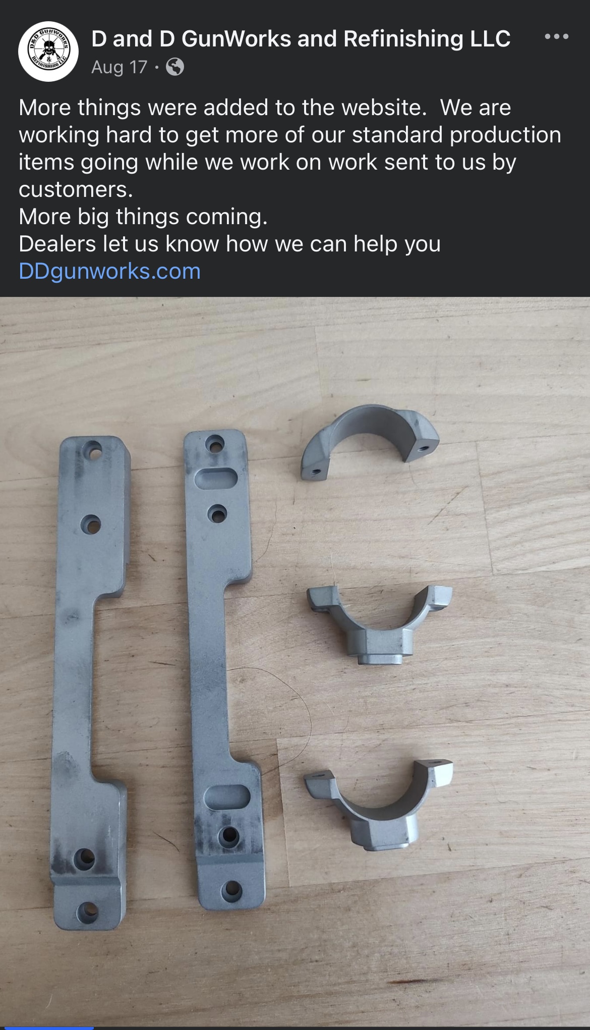

I have no dog in the fight, but stumbled across this group out of NC that are former USMC guys that are coming out with a replica Unertl M40A1 mount. D&D Gunworks and Refinishing is the group. Looks like they have been working on it for some time and will have something out sooner than later. For those still searching for a respectable and cost efficient solution, this might check several boxes.

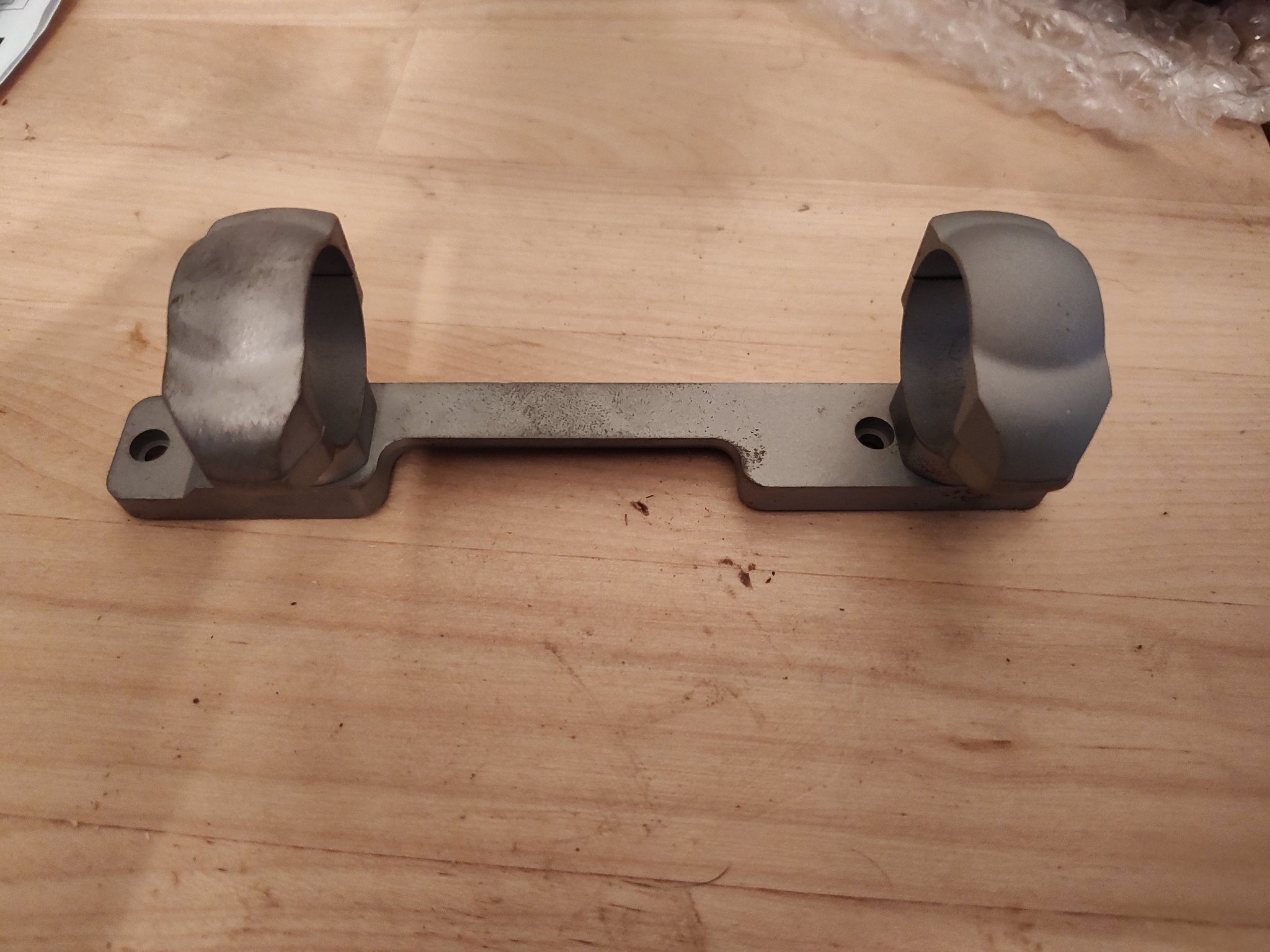

I purchased one of their A1 replica mounts as a holdover until I get a better option. Guys are good to deal with. Mount is better than pictured. The rings are NOT turn in as it was a cost prohibitive option for them to machine. You can pick them up “in the white” or blued. Good quality from what I’m seeing.
