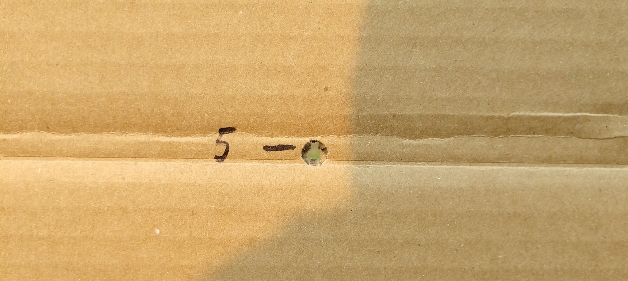

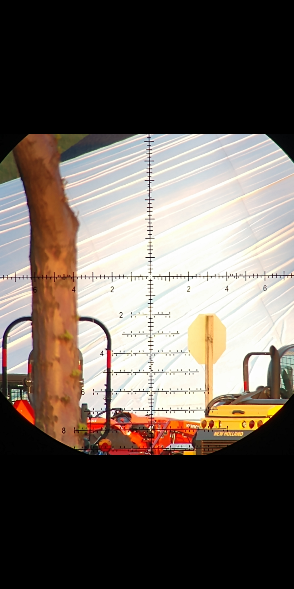

Took both scopes out last night. I wanted to perform elevation confirmation on my Tarac unit, so I also ran tall target test on the ZCO. It was spot on, just like the TT -- perfection. Hung out till dusk, I thought lowlight performance was similar--extremely good. Forgot to compare illumination at distant targets--next time.

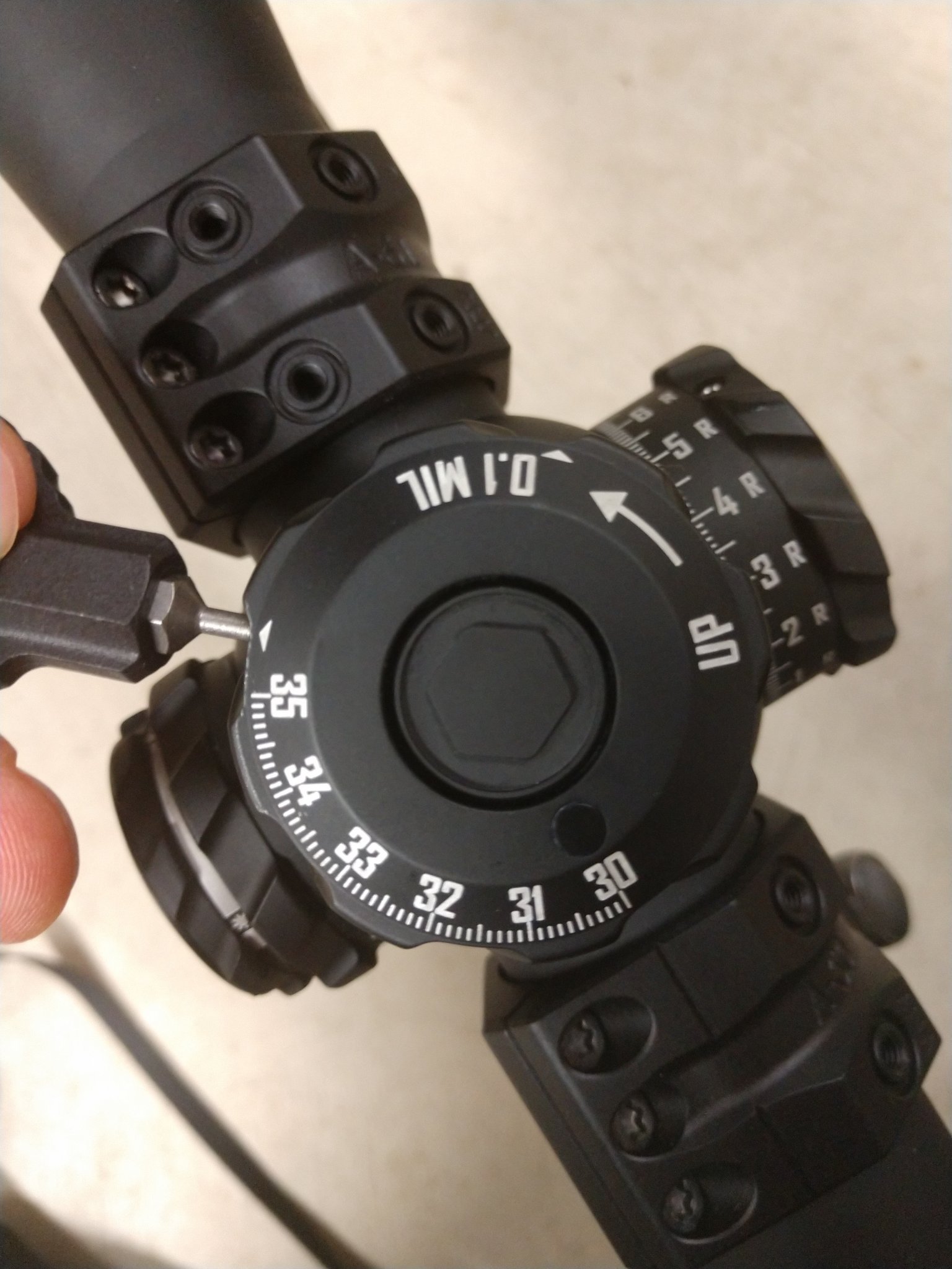

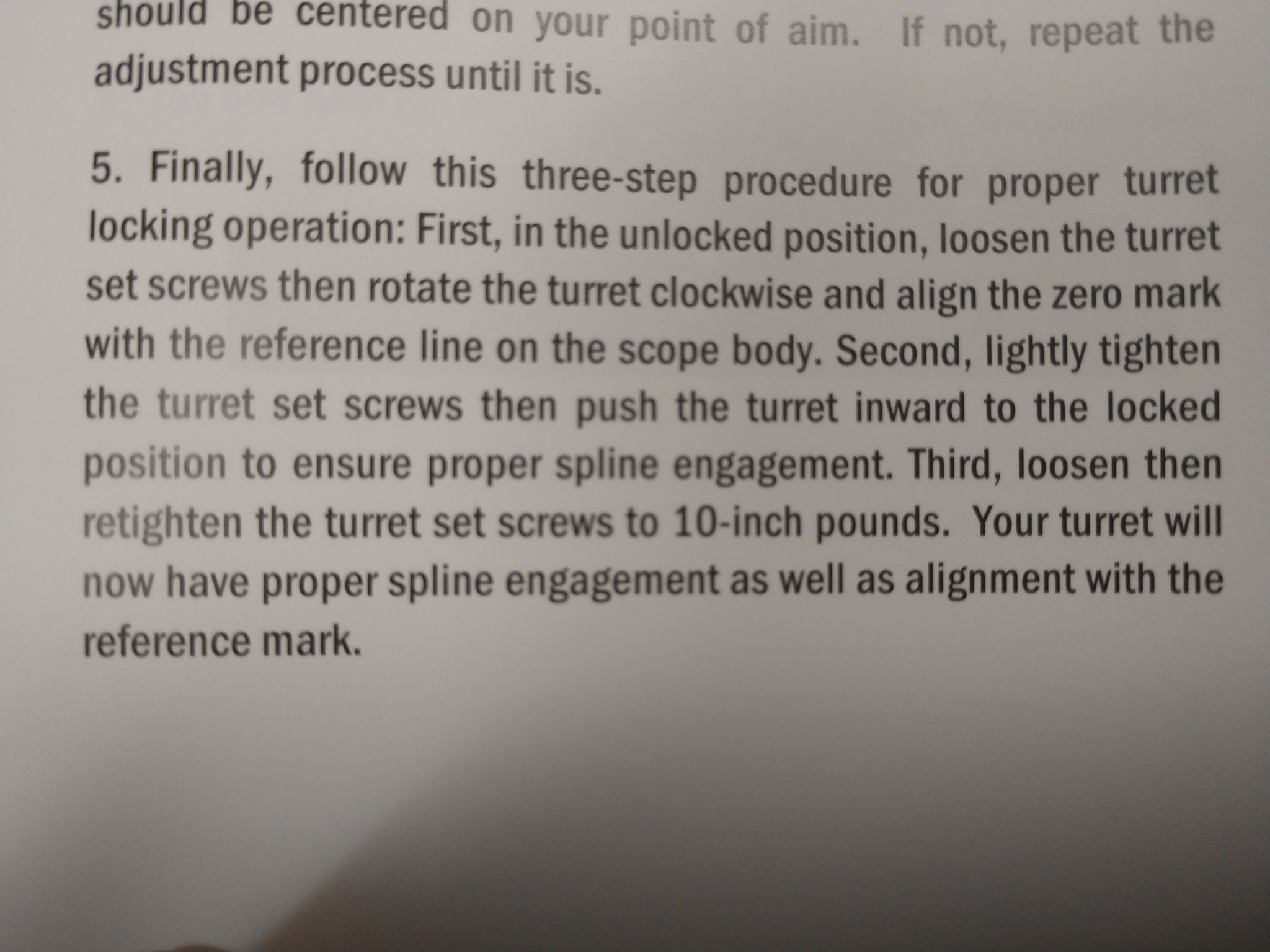

How is setting the zero on the ZC compared to the TT?
Obviously not as quick or easy compared to tooless of the TT. Also of note, I did find it a little picky in how you set it so the turrets don’t start drifting on you.
It’s a 2 set screw system, but you have to
1) unlock turret
2) loosen set screws
3) slip turret back to 0
4) start to tighten set screws
5) slide turret about half way down the lock position
6) tighten set screws
Of note though is that there is a small minutia of play in the turret when the set screws are lossened that if it’s not exactly in the middle of that play, and you tighten it up, it might start drifting on you in the higher elevation numbers.

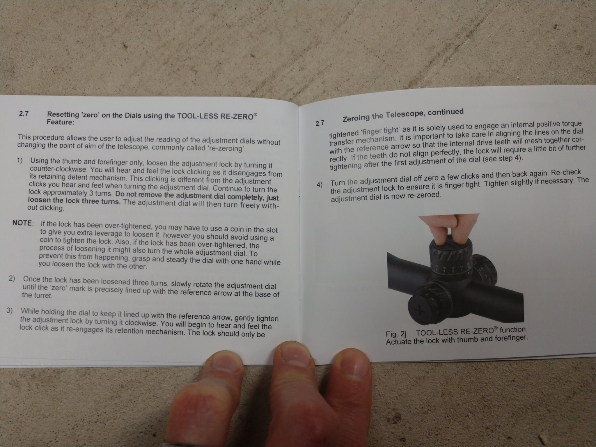

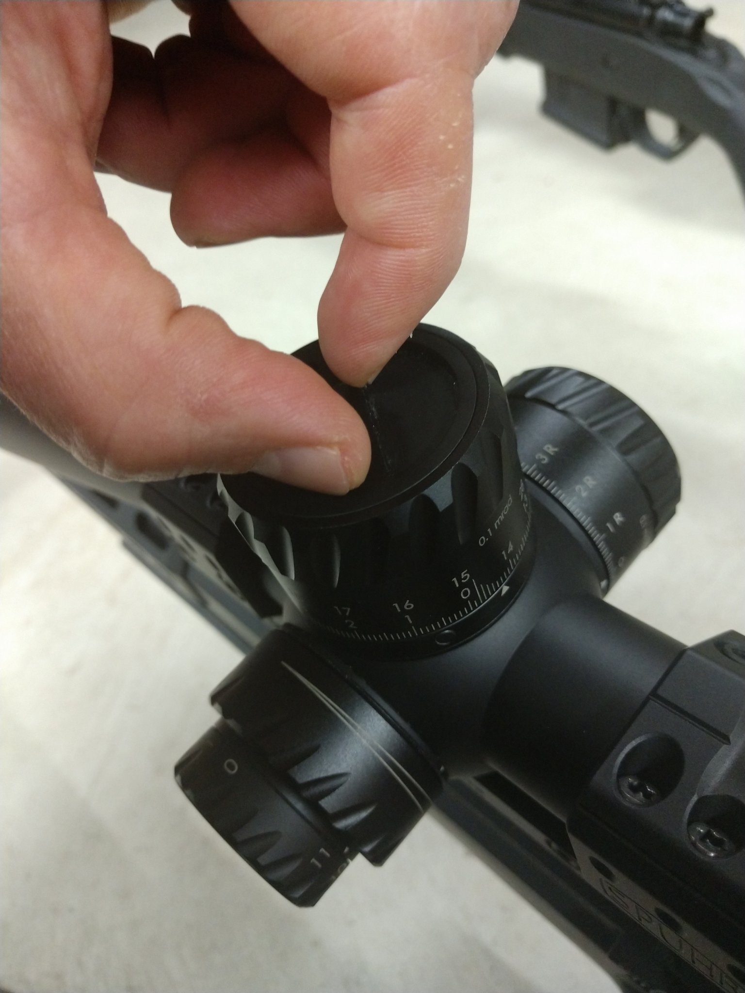

They are similar (in terms of loosen-zero-tighten) but ZCO requires a tool vs tool-less on the TT. The ZCO is the typical two allen head set screws indexed by marks on top of turret. The TT --just hold turret while loosen screw cap with opposite hand. Otherwise once turret cap is loosened both just turn to zero and tighten accordingly. The ZCO has a fool proof methodology they want a person to follow to ensure proper spline alignment --see pic of manual instructions. Once operator understands what's needed, it's very simple. They both have approx .5mil zero stop that is automatically set with turret zero.
See pics -- first two are ZCO and ZCO instructions from manual. Last two are TT.
