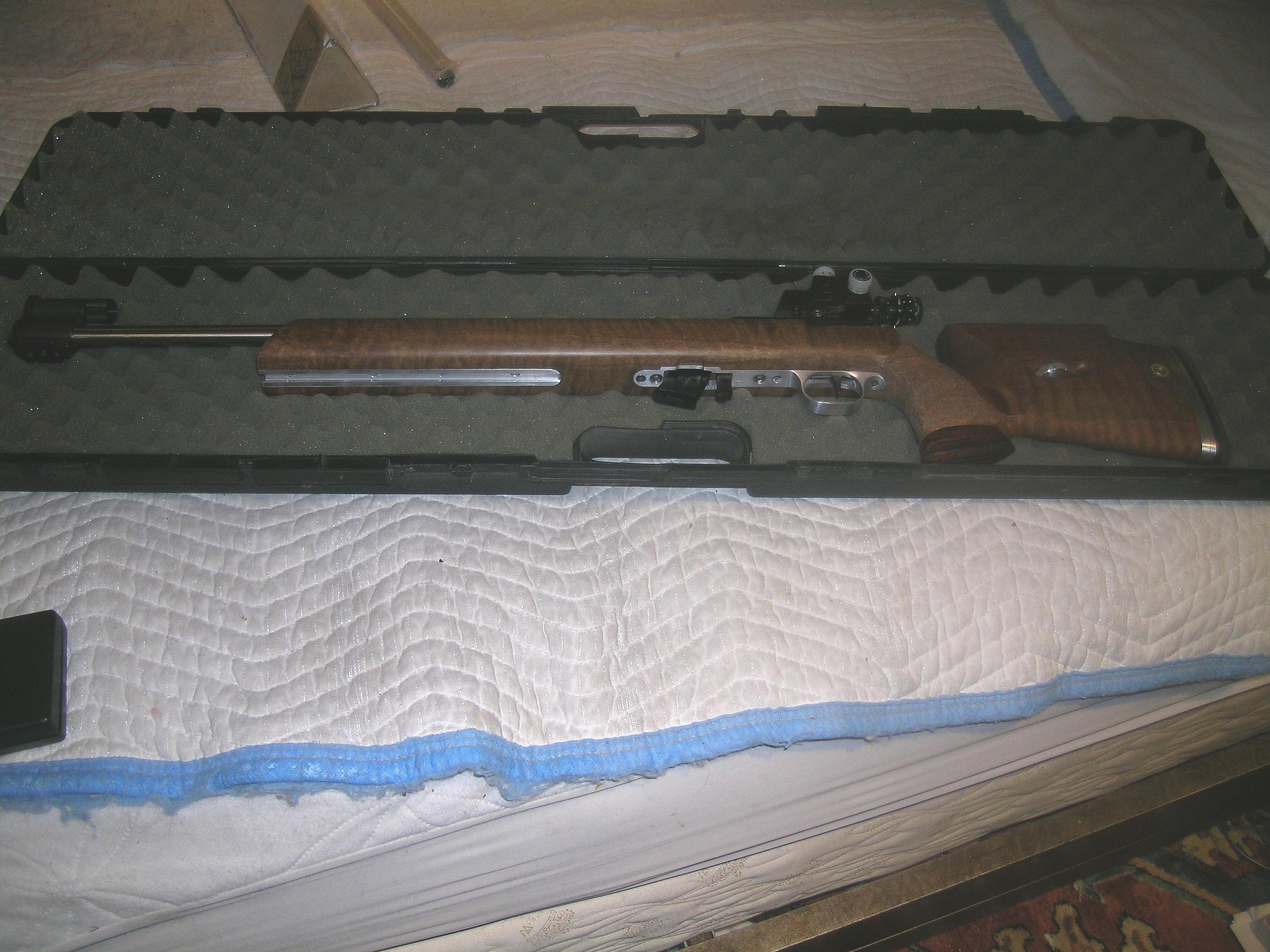

This would be the perfect action for a can! Wish the rules were different here :( New 28moa AI mount that sits lower but still allows room for the NV. I like the look of this scope height better. Could drop it another .1" if I went with the 30mm mount instead of the 34mm but close enough for now :)

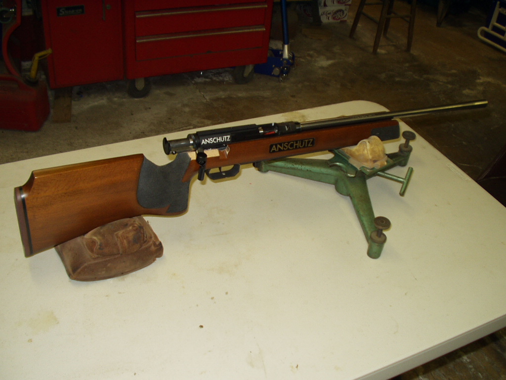

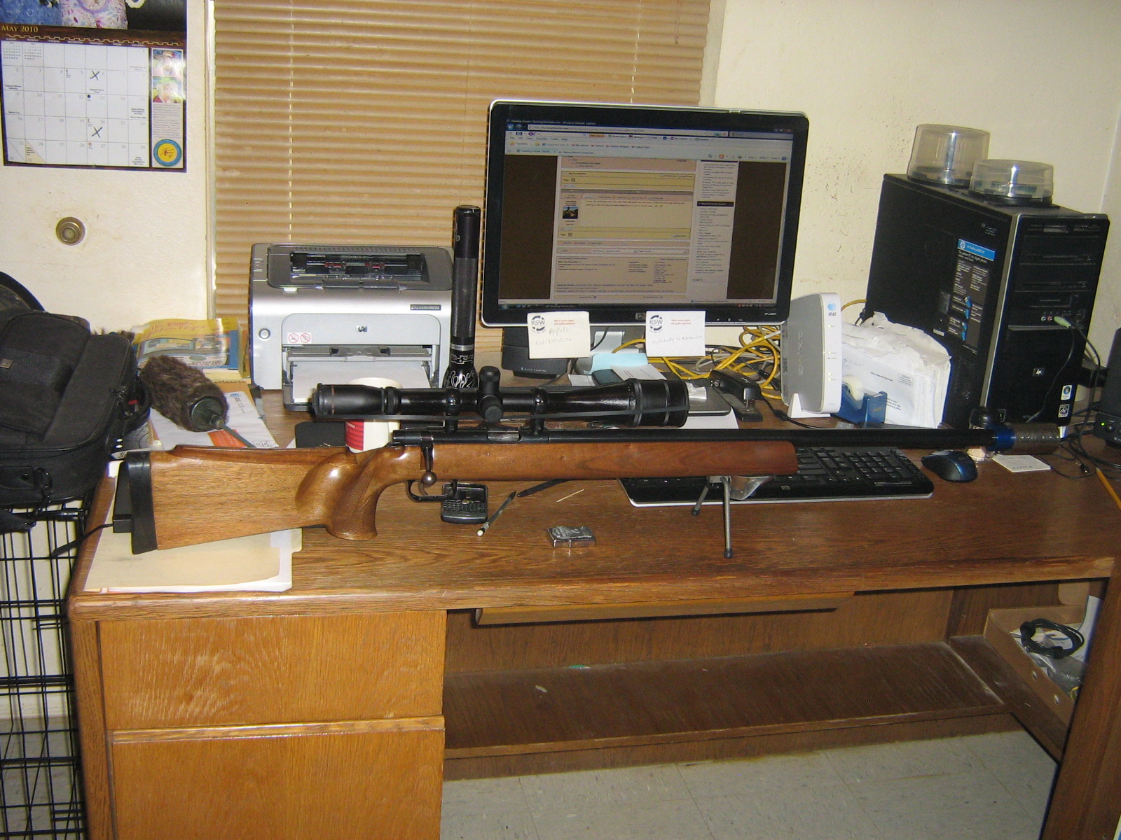

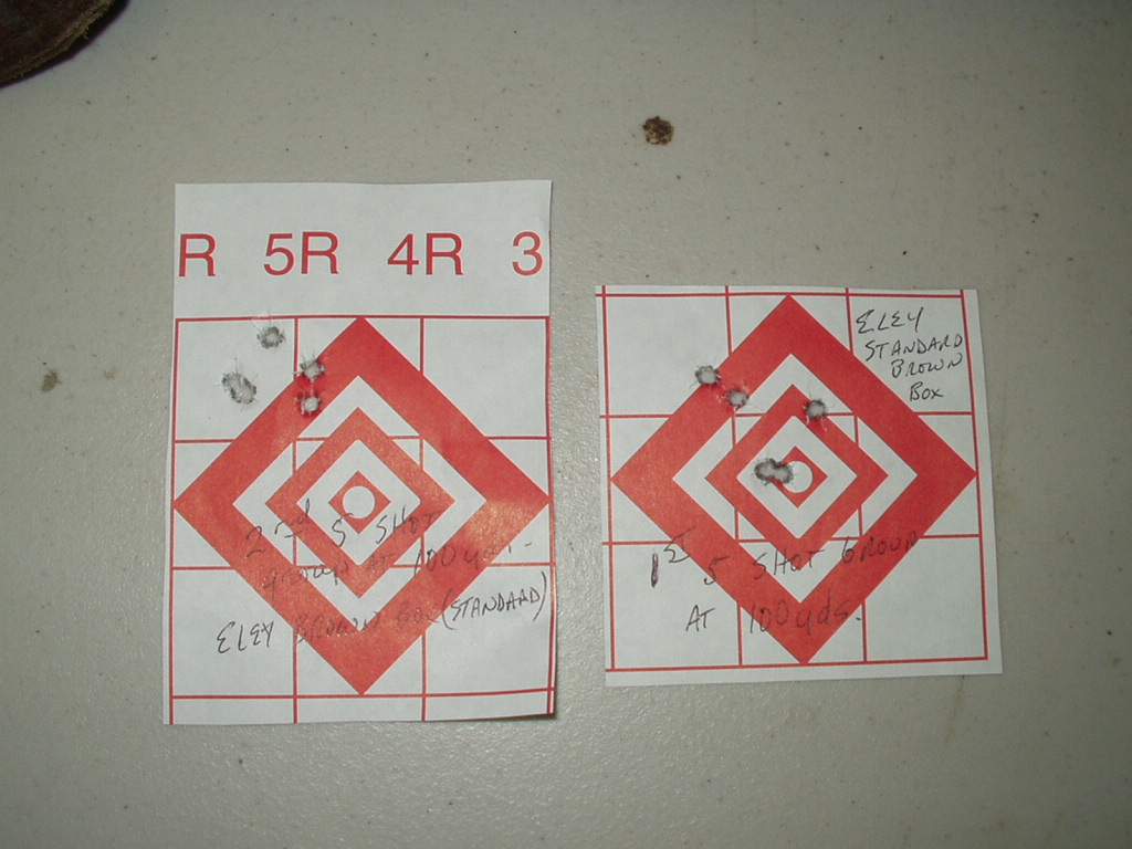

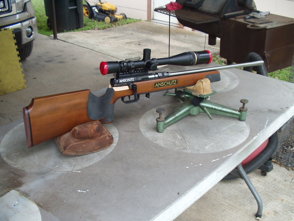

Just came across this thread. Very nice setup. I jumped into one of these rifles last summer. Couldn't be happier with the rifle, but wanted to see how it would be in a silhouette stock. I found a used one and did a little whittling and came up with this. I like it even more. On a still day bout an inch at 100.

Those 1827's always get me. I think that's the prettiest one I have seen. Some CS allowing you to pick the action and the stock separate.
Brad at Nordic Marksman was absolutely great with everything. Helped me again with a custom stock to add to my LOP and even prefit it on his rifle to show how much length I could get. Thanks on the comments, I am loving the wood on this!

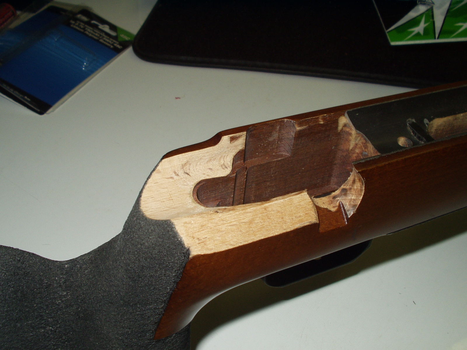

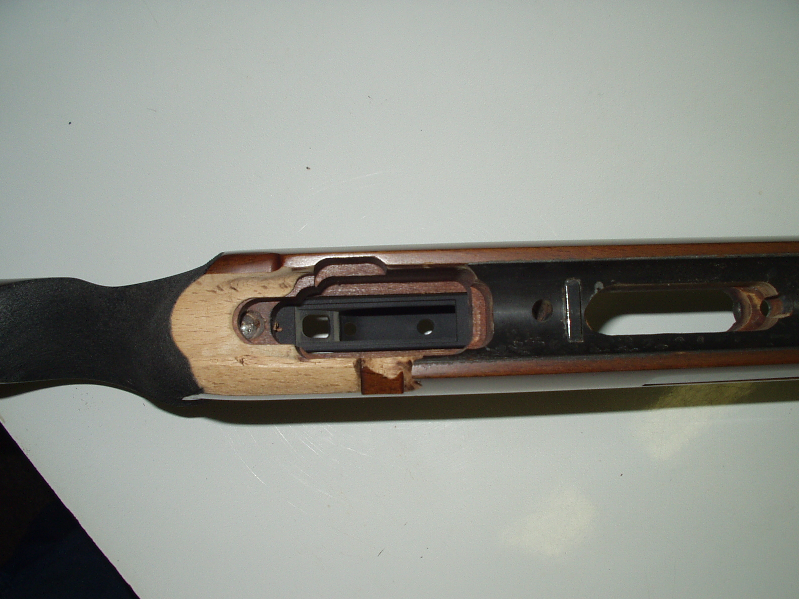

cwmoss- How hard was it to mod the inlet to allow for that action in a (54?) stock?
And now with the new MEC Contact III buttplate and 10rd mags and extras, might play with how low the bottom hook will sit at but this make me smile now!
Actually not hard at all. It has almost the same footprint as the 54.18MSR. You have to clearance it at the rear and then on the side where the bolt moves rearward. I "practiced" on a stock that I had REALLY whitled on many years ago. I then started looking for a 54.18 MSR stock and when found, kinda knew how much to take off. I'll take some up close pics and post them.

Look forward to seeing the pics! I asume the two action bolts spacing is the same? Is the bottom footprint of the action the same too. If all that is required is the clearances at the rear and at the side by the action then that would open up a lot of options for stocks.

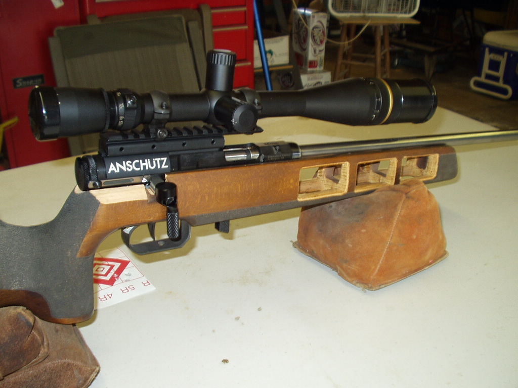

The action bolts spacing are the same. Here are a couple pics of the stock that I "Opened" up at the rear. This stock had been glass bedded by the PO. I didn't do any rebedding, just clearanced the rear, bolted it in and went shooting. I will probably refinish the stock at some point. There is a pic of the first "very whittled" stock that I opened up. Also, here are a couple groups fired at 100 on a still day.
